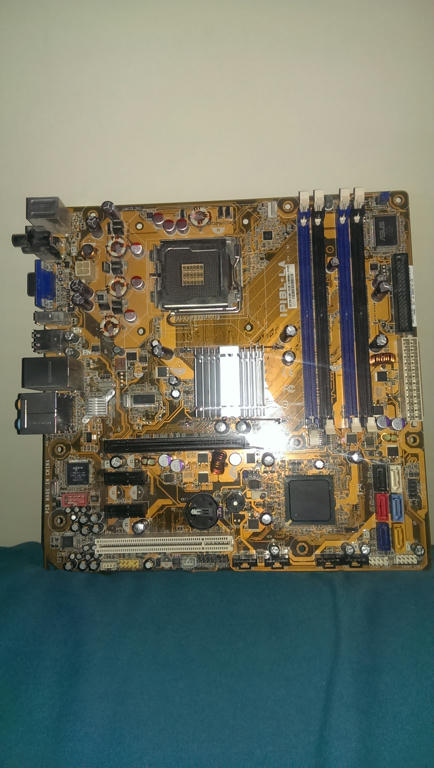

                      Re: why the fuck? (HP Asus IPIBL-LA)
                      I just bought an ipibl-la that was bad on ebay paid just $5.
                      First thing I did was take a toothbrush and a container of 91% alcohol and removed the north and south bridge heatsinks. Drenched the board front and back and brushed every square inch.
                      Waited a few hours and popped a e6750 in there and it posted video over integrated first time.
                      Now it won't post lmao and all the caps look good.... Any ideas?? Replace caps anyway ??

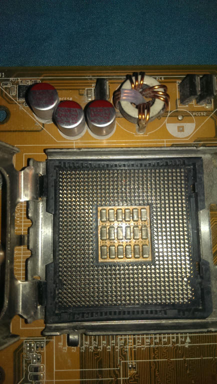

                          Yeah? Thx I know it posted prior to modding the socket to lga771 for my Xeon... Posted the e6750 first try.
                          Very stumped because all pins r good.....

                                  Mine boots up no beeps with no ram or cpu installed. I use it as a ADD2PSU basically so it requires like 1W to run the 1000W PSU for my other rig's (3) GPU(s).
                                  Anyway I'd like to get it to post. It posted prior to the lga775 to lga771 mod. I removed the tabs in the socket with an exacto knife. I do this all the time no issues. I didn't damage any pin(s).
                                  Would it be safe to try and bake it at what 350F for about 5-8 minutes? In case of a potential bad solder joint?
                                  I'll take pics and post them of the board in high def.
                                  https://www.mediafire.com/folder/h5k...7it9aay/shared

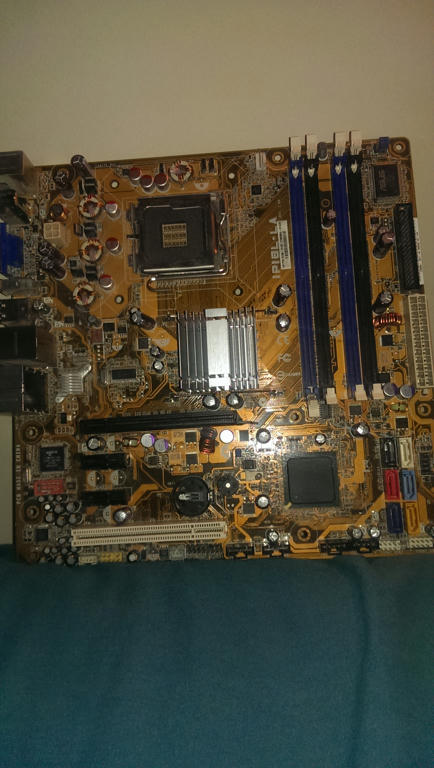

                                    I see your board has quite a few bad capacitors on it.Those need to be replaced before anything else.
                                    Also, please attach pictures with the forum's built-in feature.
                                    That's not a very useful test, though.
                                    You need CPU and RAM as a minimum to test it (some motherboards will also require a fan to be connected on the CPU FAN connector). If the board turns ON and then turns OFF quickly afterwards, then it could very well be a MOSFET on the CPU VRM. Without CPU and RAM, most motherboards will refuse to output proper voltages for Vcore and Vram.
                                    I'm sure you know how to do the 775>771 mod, since you've probably done it before, but just make sure your LGA771 CPU is oriented the correct way . I know - common sense, but I've overlooked similar simple stuff like that before myself and then wondered why the thing isn't working.
                                    No, do NOT bake PC motherboards unless you remove all of the caps. Otherwise you will pop those caps and that can cause more problems than it fixes.
                                    If you want to try and reflow the CPU socket, you could use a heat gun. Harbor Freight Tools often has one for around $10 on sale and Micro Center has one for under $20 IIRC.
                                    Just make sure to do the reflow from the undeside of the board so you don't melt the plastic on the socket. You will also need some no-clean liquid or paste flux. Do NOT use plumber's flux.

                                      Anyway thanks yeah originally posted first try e6750 1 stick of ram. With CPU and ram same e6750 and ram in slot 1 it boots and stays running.
                                      Maybe my cleaner didn't fully dry but its odd I cleaned it let it dry first then it posted first try.
                                      Pulled CPU ram to test another board and since hasn't posted. I'm thinking its guck or dirt bridging connections somewhere. What's a safe solvent to submerge the board in for 24 hours? Then allow to dry for 24 hours? I'm not entirely certain but my gut tells me it needs s thorough cleansing and rinse/ purification.

                                        As momaka said,replace those bulging capacitors you have on the board and then start troubleshooting, Especially replace the ones around the northbridge,as I've had a board unable to boot due to bulging capacitors around the Northbridge.
