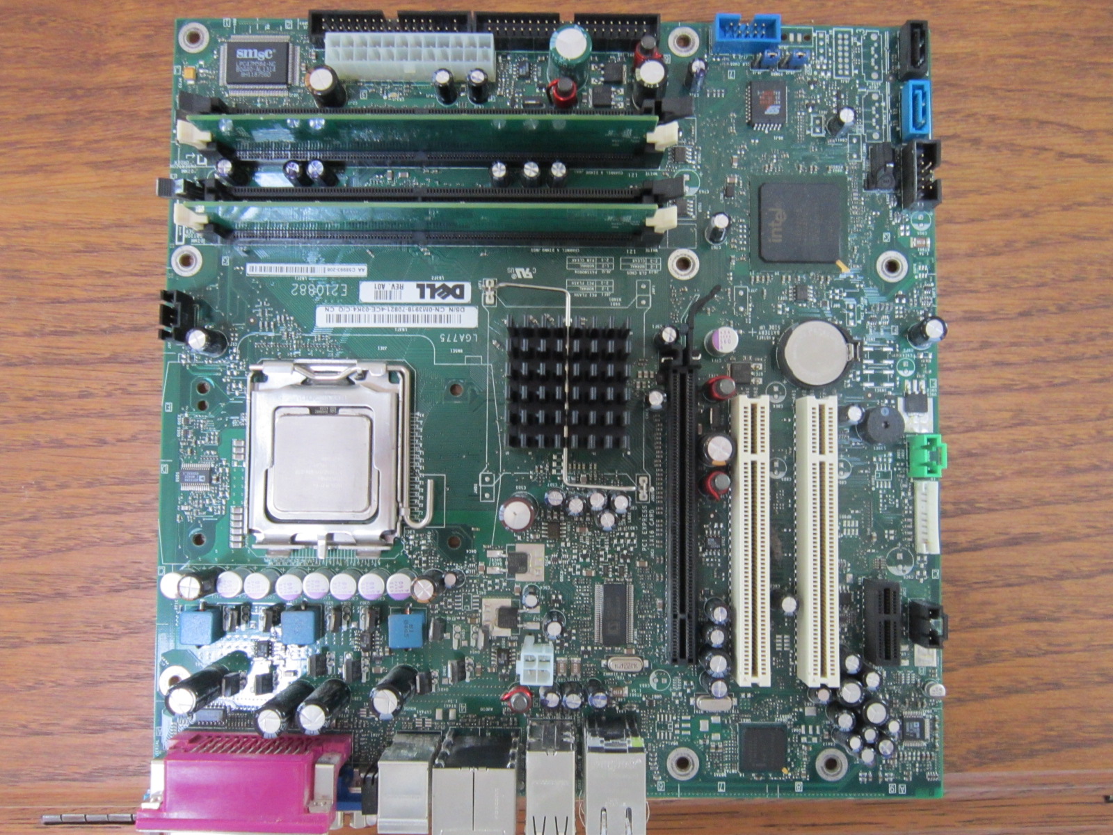

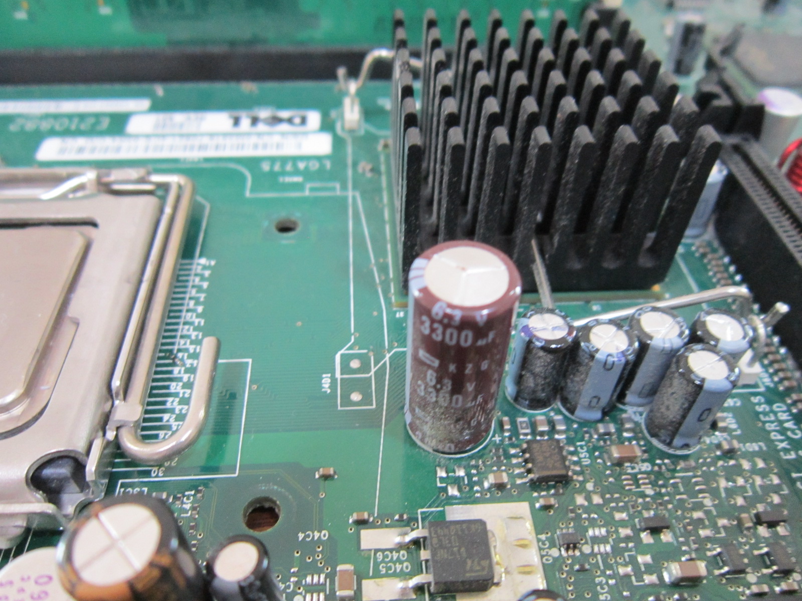

    Hi everyone.This is my first post(well after my intro yesterday) requesting help.My dimension 4700 has stopped working;no posts or beeps,shuts off after about 3 secs.I've replaced first the PSU and then CPU(another Pentium 4).They don't correct. In examining the MB I see one capacitor that is bulging; the 3300 uF. I have enclosed a picture of the entire MB and one showing the bulging capacitor.
    I have a number of questions but there are 2 foremost ones?Is this MB worth repairing? The machine is about 8 years old but is fine for my purposes particularly with the upgrades I've made. If I can get another year or two out of it I'm satisfied
    Second would that one capacitor be enough for the MB to fail?
    BTW in examining the MB I find no evidence of capacitors leaking or any type or scorching.
    Any advice is appreciated.
    thanks

    Hi and Welcome to Badcaps Philpc
    The question weather it's worth repairing or not can only be answered by you...
    It looks like your mobo only has one capacitor of the model UCC KZG?
    If so it is likely to be all you need to replace, do be forewarned that KZG can fail without bulging so if there are more replace them aswell...
    That capacitor probably controls the voltage to the chipset and if that is out of whack the computer wont be able to start...
    Note that you need to replace it with a low esr capacitor matching the one installed currently, e.g. Radio Shack do not sell suitable replacements...

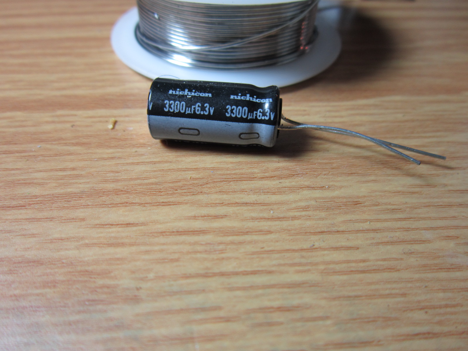

            Forgot to check back I bought a Nichicon;same voltage and capacitance.It's a little shorter but I figure that should not matter. Please advise if I'm wrong.

              that is not enuff information. u need to provide the series/model of the capacitor as well. general purpose caps will not do. generally a suitable nichicon replacement for ucc kzg shud be hm, hn or hz series. the best is to provide a pic of the replacement capacitor.

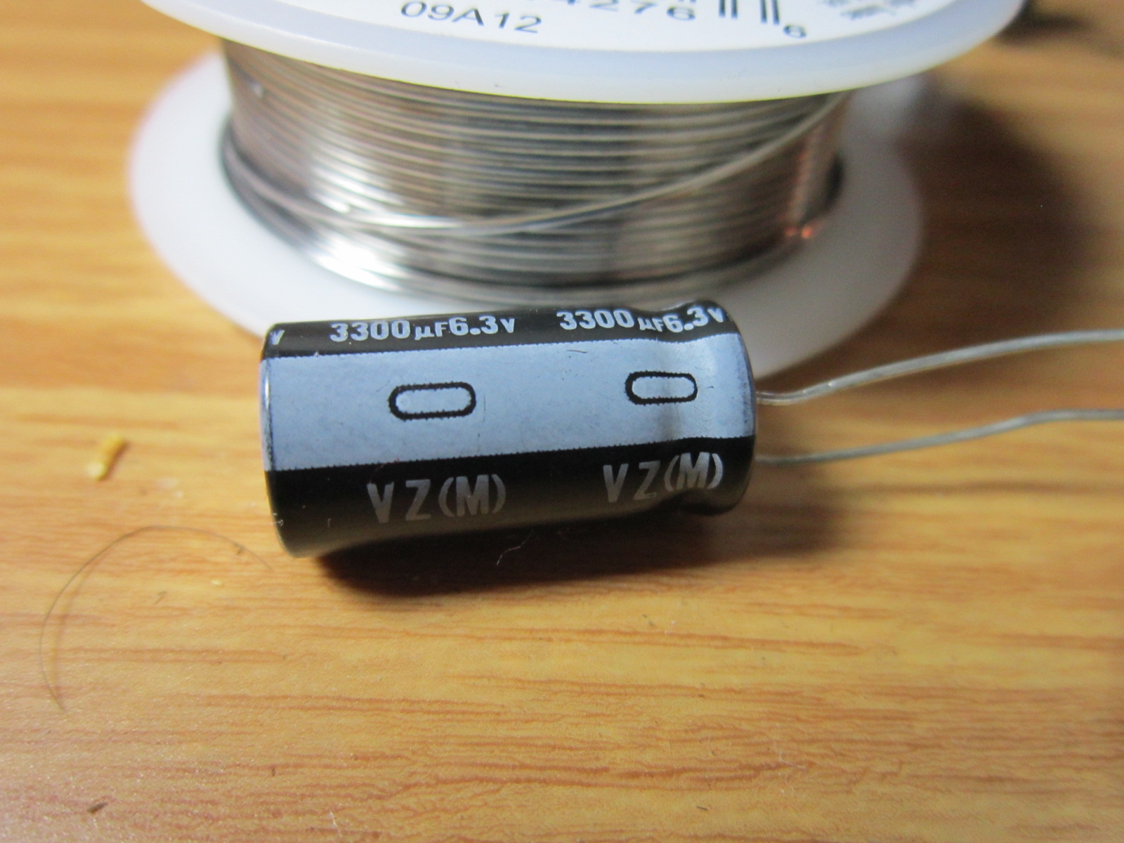

                Glad I asked.This capacitor has "VZM" on it It was sold as a low ESR but did still buy the wrong thing? Here are a couple of pics.

                  That isn't low ESR.

                    that looks like its probably the input vrm cap for your northbridge. You're looking for a nichicon HM or HN
                    nichicon VZ is a general purpose cap

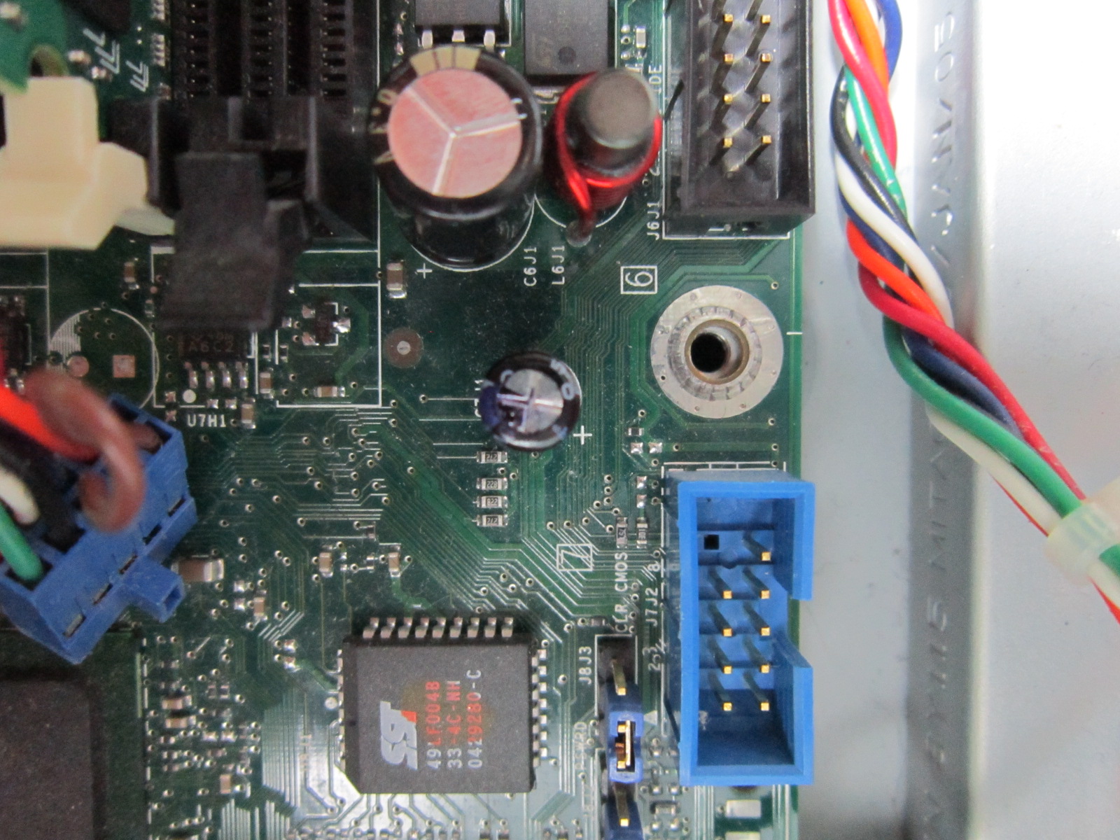

                                    Got the recommended capacitor from digikey. System still does not boot. I'm about to just replace the mb but did reexamine the other capacitors and am wondering about some other ones.
                                    I have picture of one of them and am wondering if it is shot;it's the one to the left of MB screwhole. There are some others like it.I don't know if the coloration on the cap surface is a sign of being shot or just a defect of sorts with the surface paint. If this not these then I'm just tossing the board.

                                        There's nothing wrong with the cap in the center of that picture above. However, the big cap above it is Chemicon KZJ - those are known to fail (and many times without any visual signs either). There's also Nichicon HN (and possibly HM) capacitors on your board. Nichicon is actually very good but they had a problem with the HM and HN series manufactured between 2001 and 2004. The replacement Nichicon HM you got from Digikey is fine. However, the original Nichicon HN and HM caps on your motherboard may be affected. Both Nichicon HN and HM will have a date code on them. It usually looks like "H####" where "####" is a 4 digit number in which the first two digits indicate the production year. So if your Nichicon HN caps have date codes H01** to H03**, they are from the affected batch and should be replaced too.
                                        Also, just as a simple check, but did you solder the new Nichicon HM cap the right way with the white stripe on the cap lined up with the white stripe on the board? I don't mean to insult your intelligence with this or anything - just making sure something simple wasn't overlooked (I do that all the time so that's why I ask).
