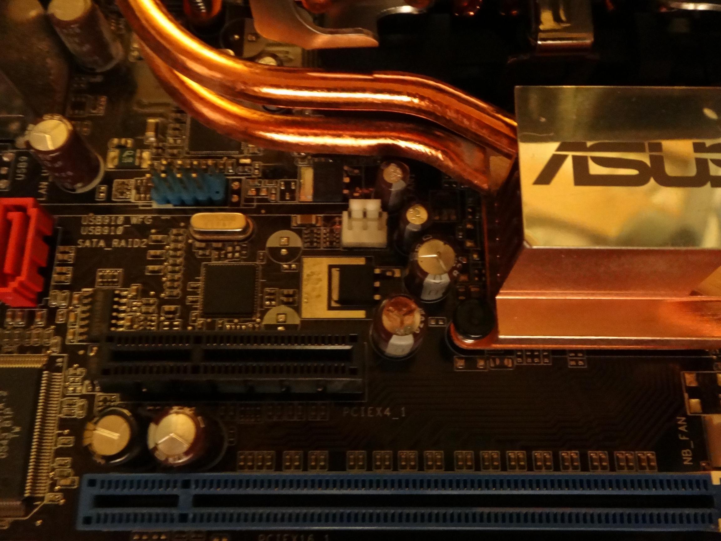

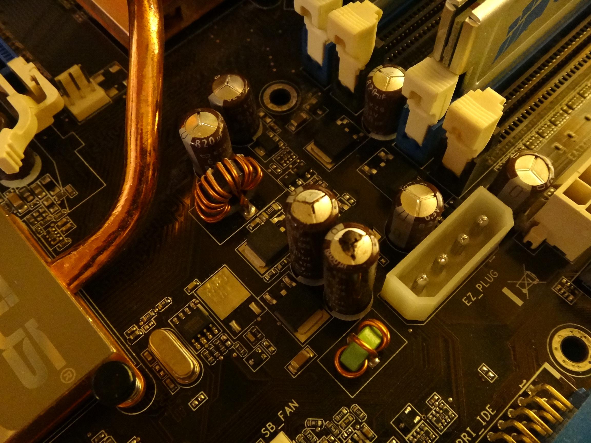

      This thread is probably dead lol, but if your still here, put a small fan pointing down on that copper heatsink by the mosfets, that nforce chipset is sure to run hot and fail after a few years.
        Re: ASUS A8N32-SLI Deluxe
        Thanks for the replies. I ordered the parts including the 100uf the day before Player2 replied XD. That's good to know that the 100uf should be okay. Since I already got the parts, I just replaced all of them except the Panny FJs. Computer seems to be working fine for my typical normal usage.
        To mcdaydavies: Are you saying the nforce chipset will die or the mosfets due to the heat from the nforce chip? Unfortunately my case doesn't have support for a fan blowing on that copper heatsink. In fact my case actually sucks. It's poorly designed for airflow; It's the Lian Li pc-v2100 and inverts the board so that the cpu is at the bottom which I believe is causing more heat to be retained inside the case. Which probably lead to my caps leaking

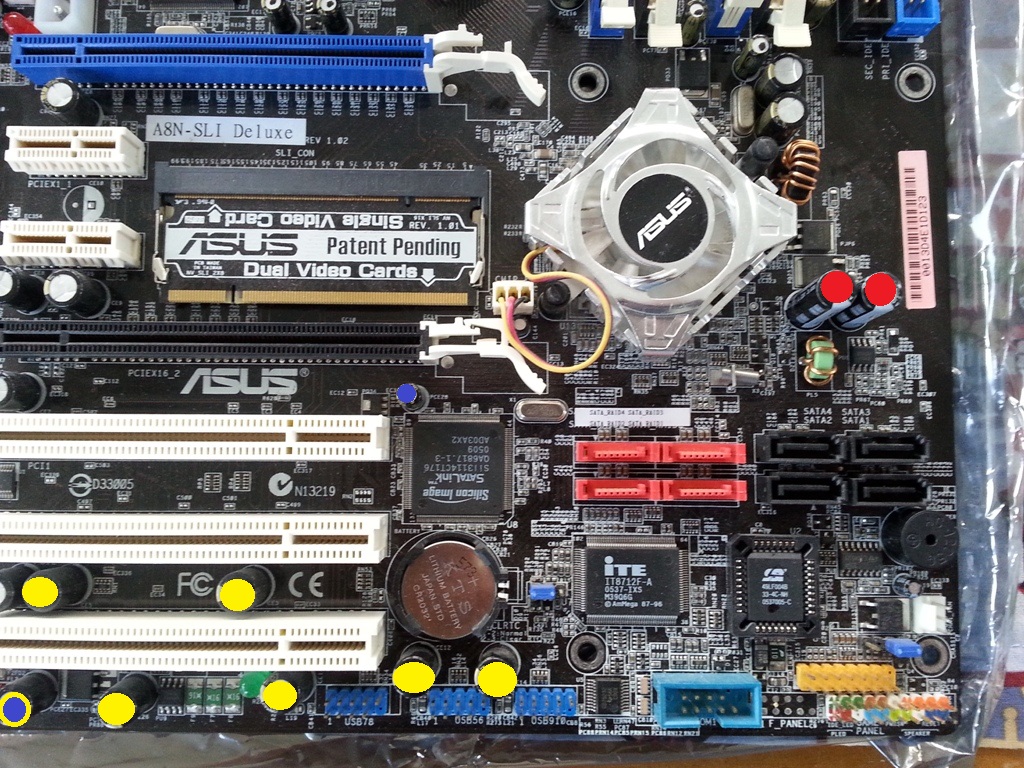

              I am here to try and recover my A8N-SLI Deluxe without the "32". I had given my computer to someone to try and build a server out of it with parts I had been collecting.
              He reported a number of caps are bloated and I need a new MOBO. I do not have the MOBO in front of me but will pick it up in the next day or so I would like to try and revive the board.
              Will my MOBO have the same selection of caps as the "32" listed here? Which ones should I replace to prevent future issues on the board?

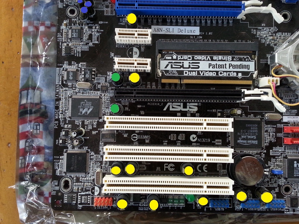

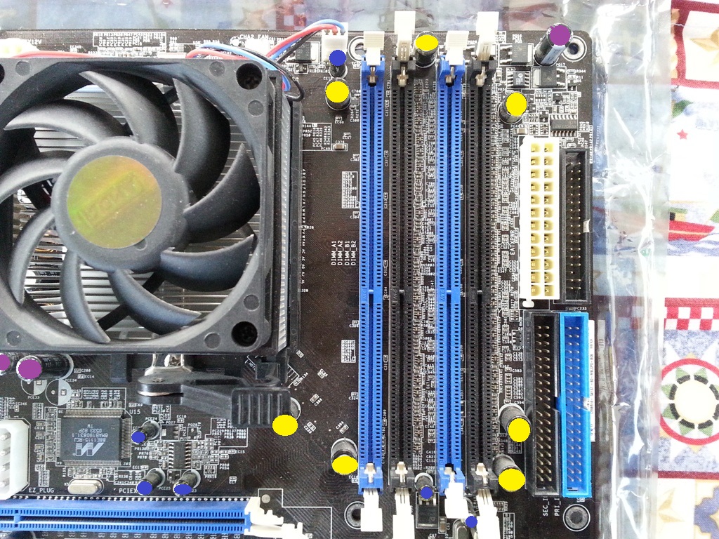

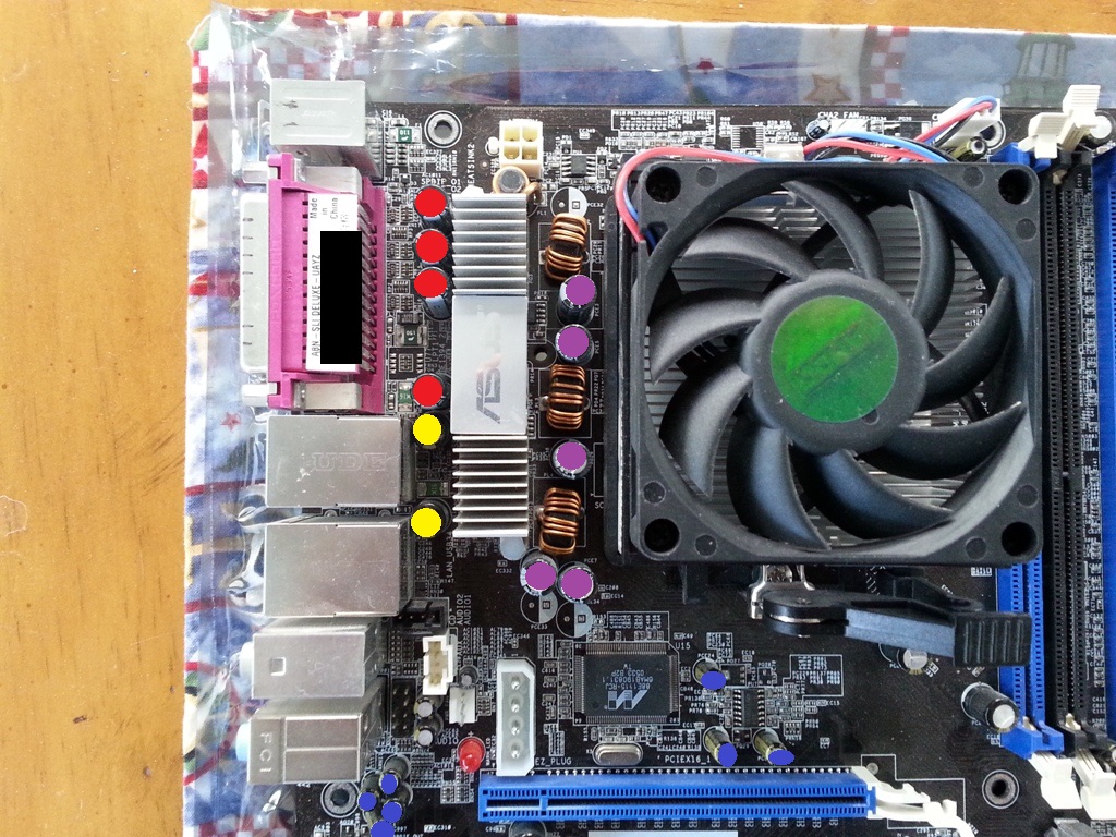

                Okay, after finally locating my A8N-SLI board, I have a cap schedule for this model. I have the A8N-SLI Rev 1.02, and the attached pics are of it. This board had the UCC KZG's, I used the Nichicon HM's as replacements. The Panasonic FJ's are original as well as the Rubycon MBZ's. I haven't had a need (yet) to replace the nonvented Lelon TK 100uF 16 Volt caps.
                I marked the caps as below:
                Green - Nichicon HM 470uF, 10 Volt, 8mm diameter
                Yellow - Panasonic FJ 820uF, 6.3 Volt, 8mm diameter
                Purple - Rubycon MBZ 1500uF, 6.3 Volt, 8mm diameter
                Dark Blue - Lelon TK 100uF, 16 Volt, 5mm diameter
                Red - Nichicon HM 1000uF, 16 Volt, 8mm diameter
