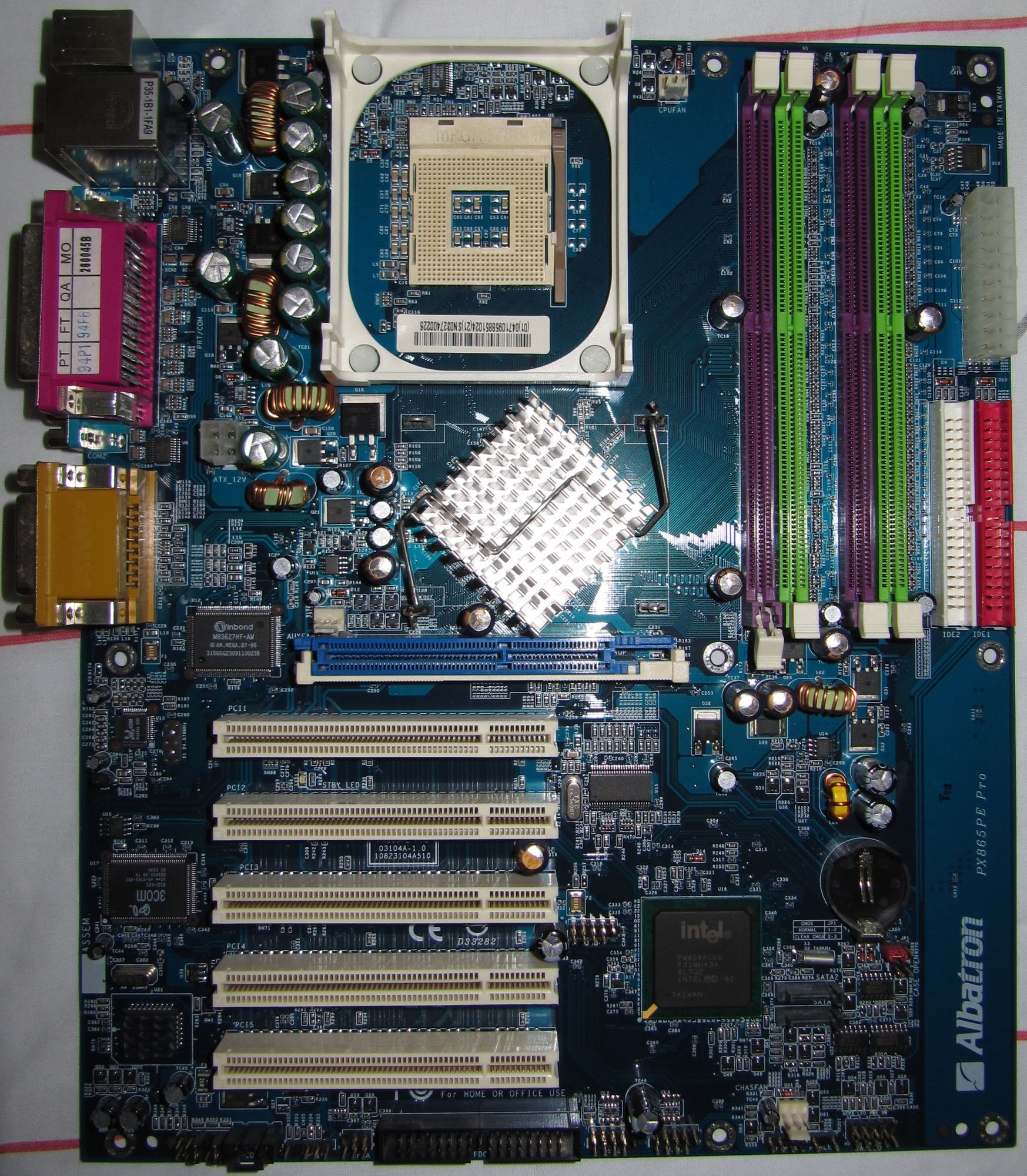

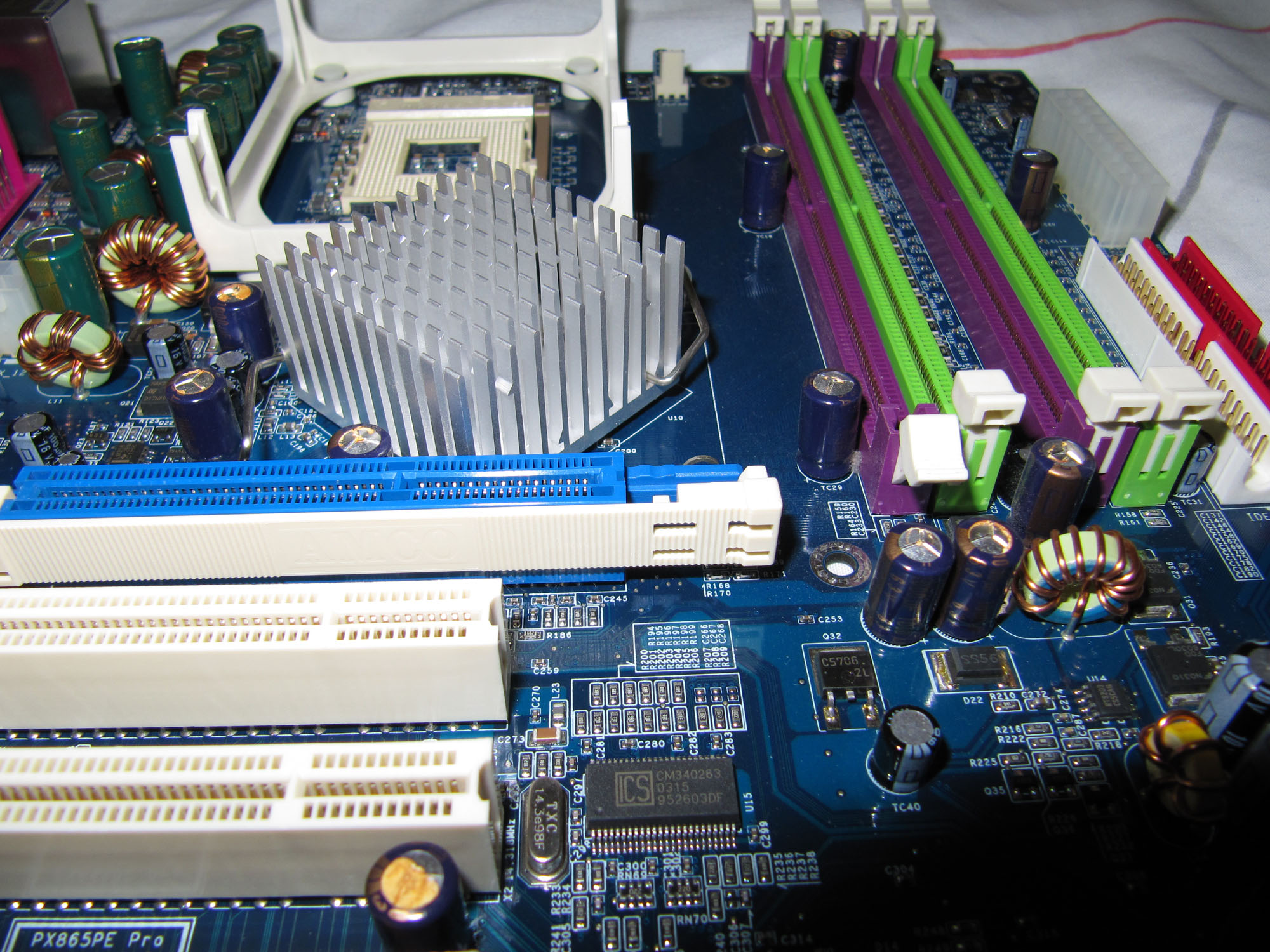

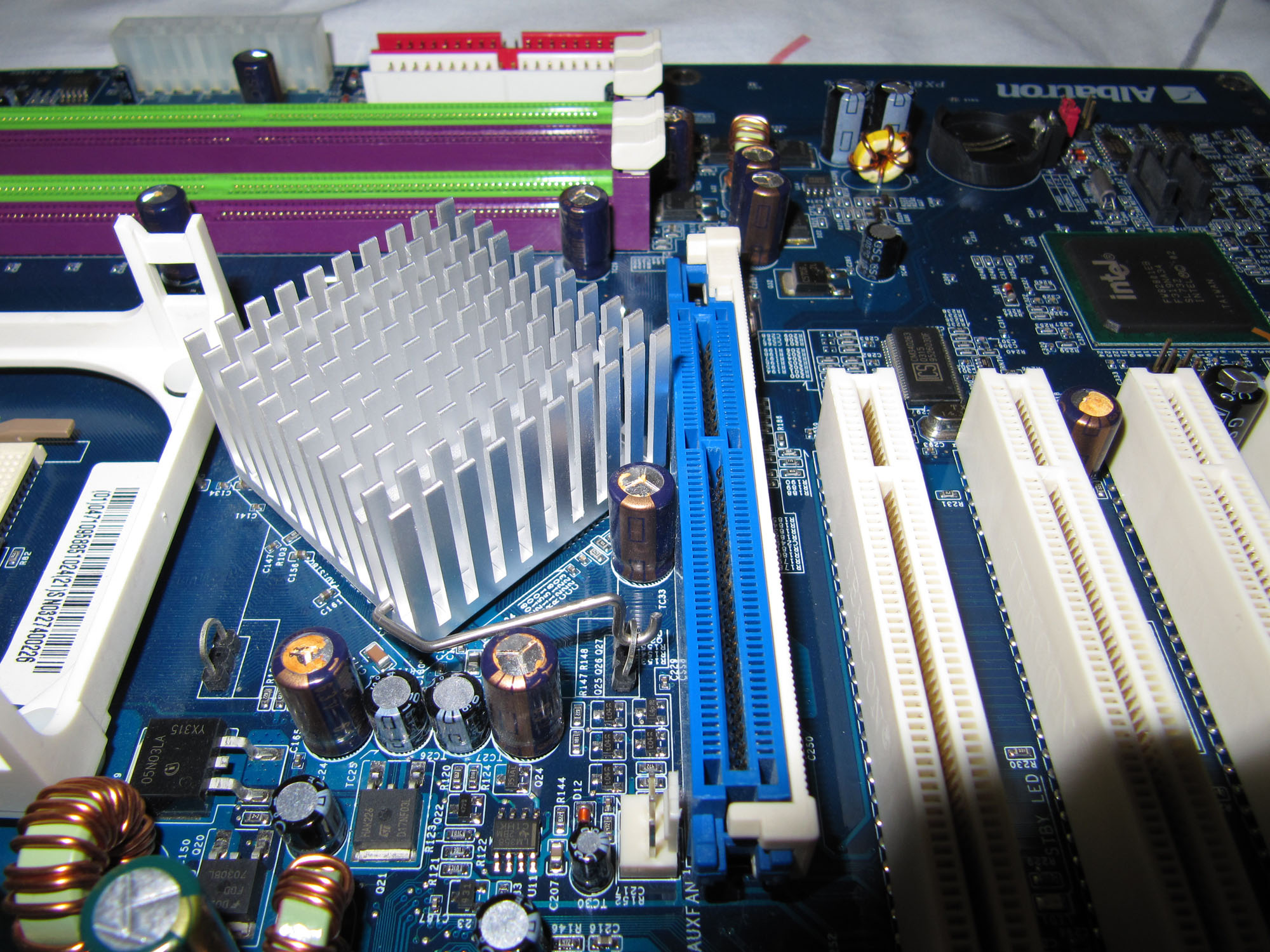

    Albatron PX865PE Pro full of bulging GSC
    The title speaks for itself, I just want to add that there are 11 GSC LE 1000uF 6.3V 8mm, all bad. The rest of the small caps are GSC too, not bulging though.
    I am going to recap only the bulging ones using caps from dead motherboards.
    Photos will be posted on the bad caps photo montage thread too.

    Re: Albatron PX865PE Pro full of bulging GSC
    I'm sending my snake your way...
      I used OST RLZ
              I ran out of stock and used 2 KZGs too... They have much lower esr than the original GSC caps that were there. I hope this may help them last.
              I replaced only the bad caps, so there are still GSC on that board... Too ashamed to post pictures...
