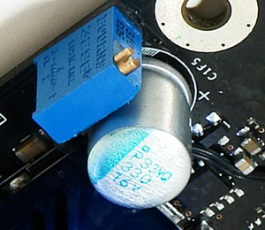

          If that is the case, then how did this guy use all solid caps???
          http://vic.expreview.com/read.php?27&part=2

                  Anyways..back on topic. If I need the following caps, then what are the equivalent solid caps? Sorry, but I'm a n00b in training when it comes to all this. Not sure by what you mean by half capacitance...
                  (3 total) 6.3V, 3300uF
                  (19 total) 10V, 470uF
                  (3 total) 10V, 1000uF
                  (4 total) 16V, 470uF
                  (4 total) 16V, 1200uF
                  Oh, and the guy that used all solid caps was able to over clock an additional 60MHz to the FSB compared to using the stock caps. Now that is pretty damn good! I am planning to run a 4*400MHz or 1600MHz FSB and 2*400MHz or 800MHz DDR2. This will be a 1:1 FSB:MEM ratio. I want the board to be rock solid stable and also showcase a little bling!

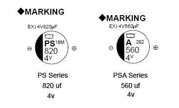

                            Re: Intel D975XBX Cap Mod Questions
                            He is using chemicon PS series (the blue silver caps) you could use chemicon PSA series which are just slightly better and available from digikey.
                            PS Series
                            here is an example of the markings so you can read off from his photos what he used in each position.
                              #34
                              when i say you can use half capacitance in polymer to replace wet electrolytics. This means that if you have a cap say Rubycon MCZ 1000uf 6.3v
                              then you can replace it with a polymer nearest to half capacitance but better exceeding half
                              so you would use Chemicon PSA 680uf 6.3v
                              capacitance is measured in uf which is microfarads
                              problem is that Chemicon PSA is not available in 330uf 16v like the PS series he used on the 12v lines on the board. I dont know where to obtain polymers in 16v presently.
                                the other caps he used are sanyo oscon SEP.
                                you can read off the values easily, like from the left of the pic 470uf 6v, 820uf 6v, 820uf 6v. I dont know why he used SEP series because their specs are quite inferior for polymer caps. probably he used them because of availability? SEPC would be superior.
