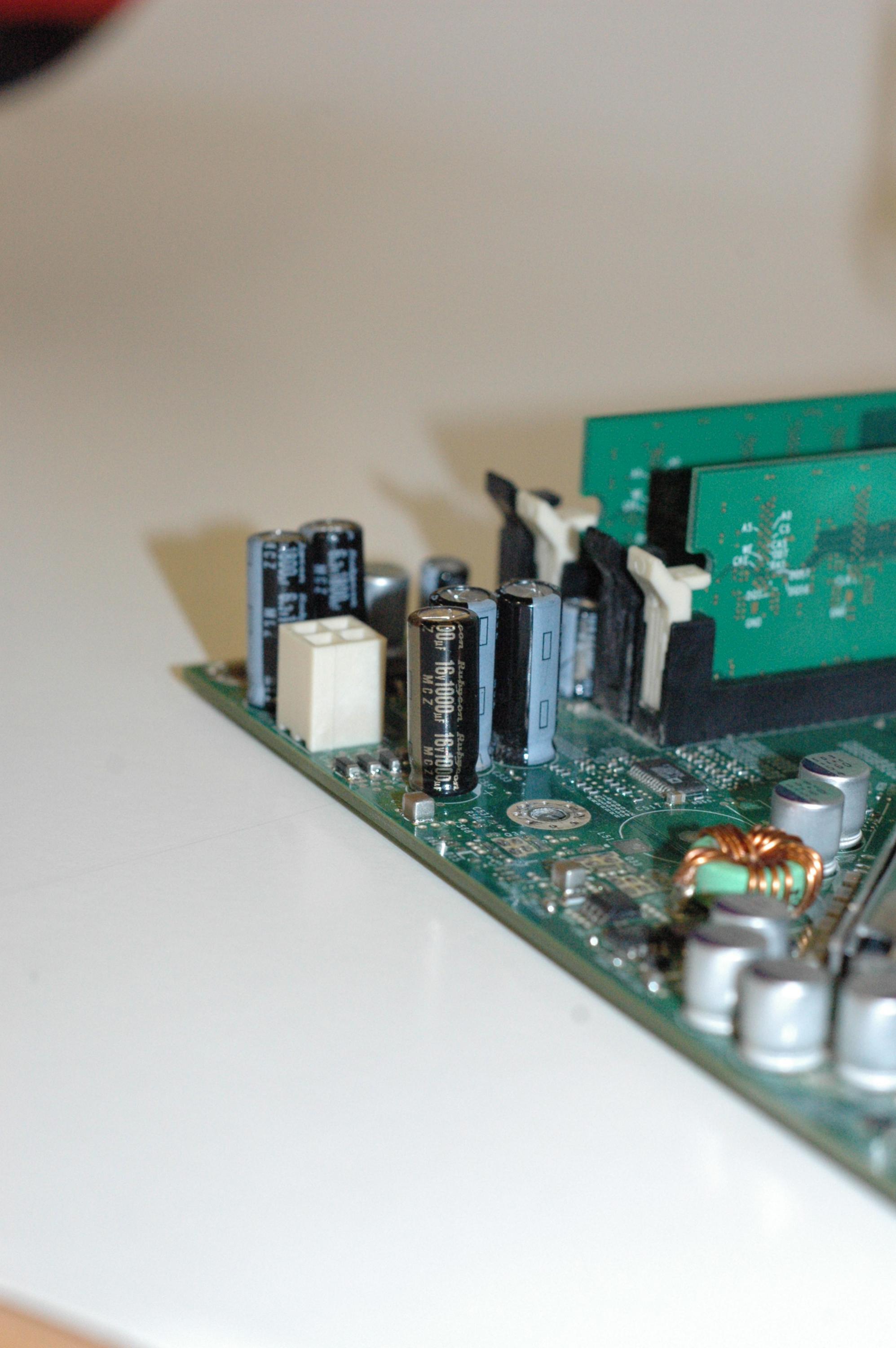

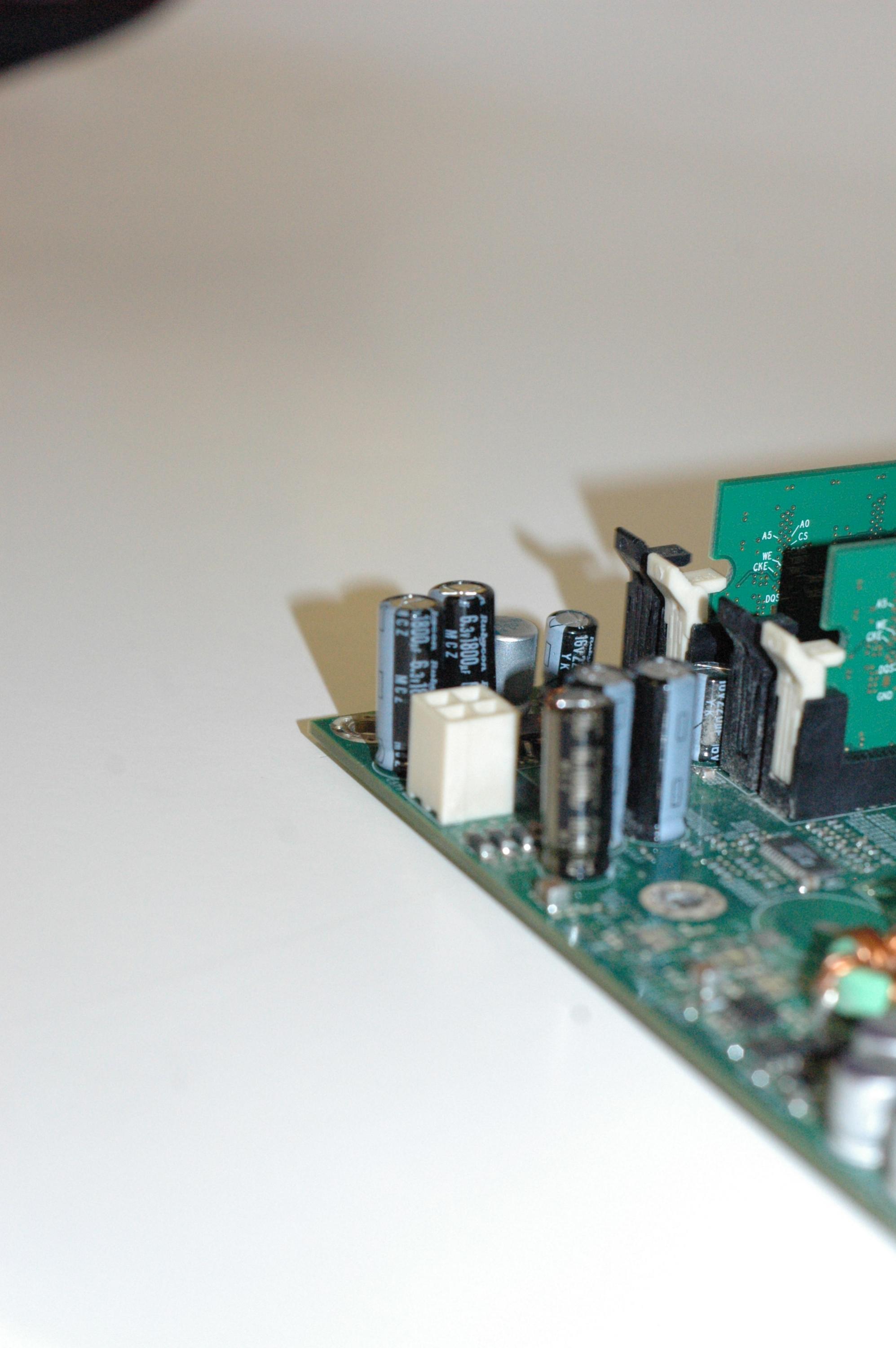

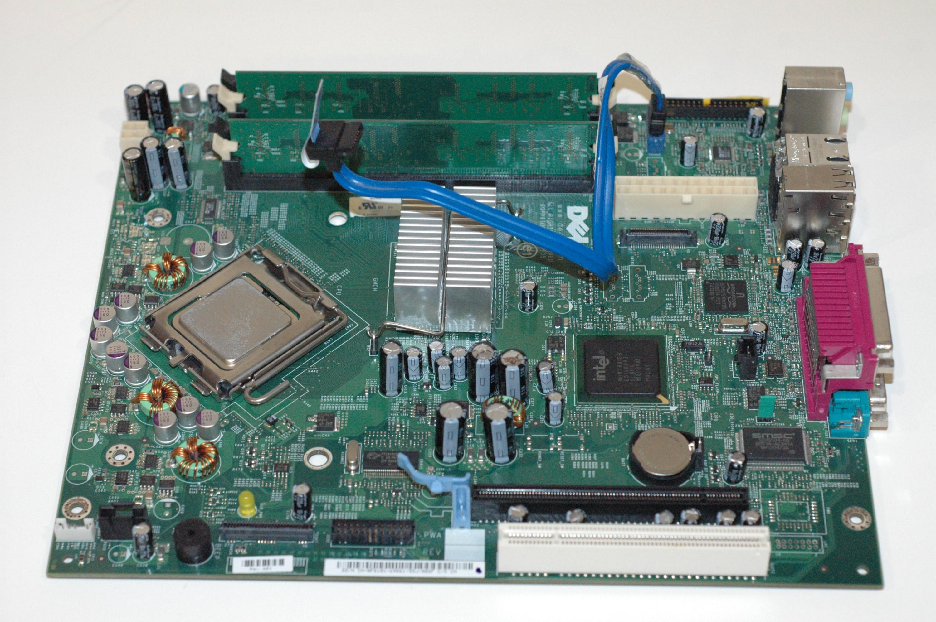

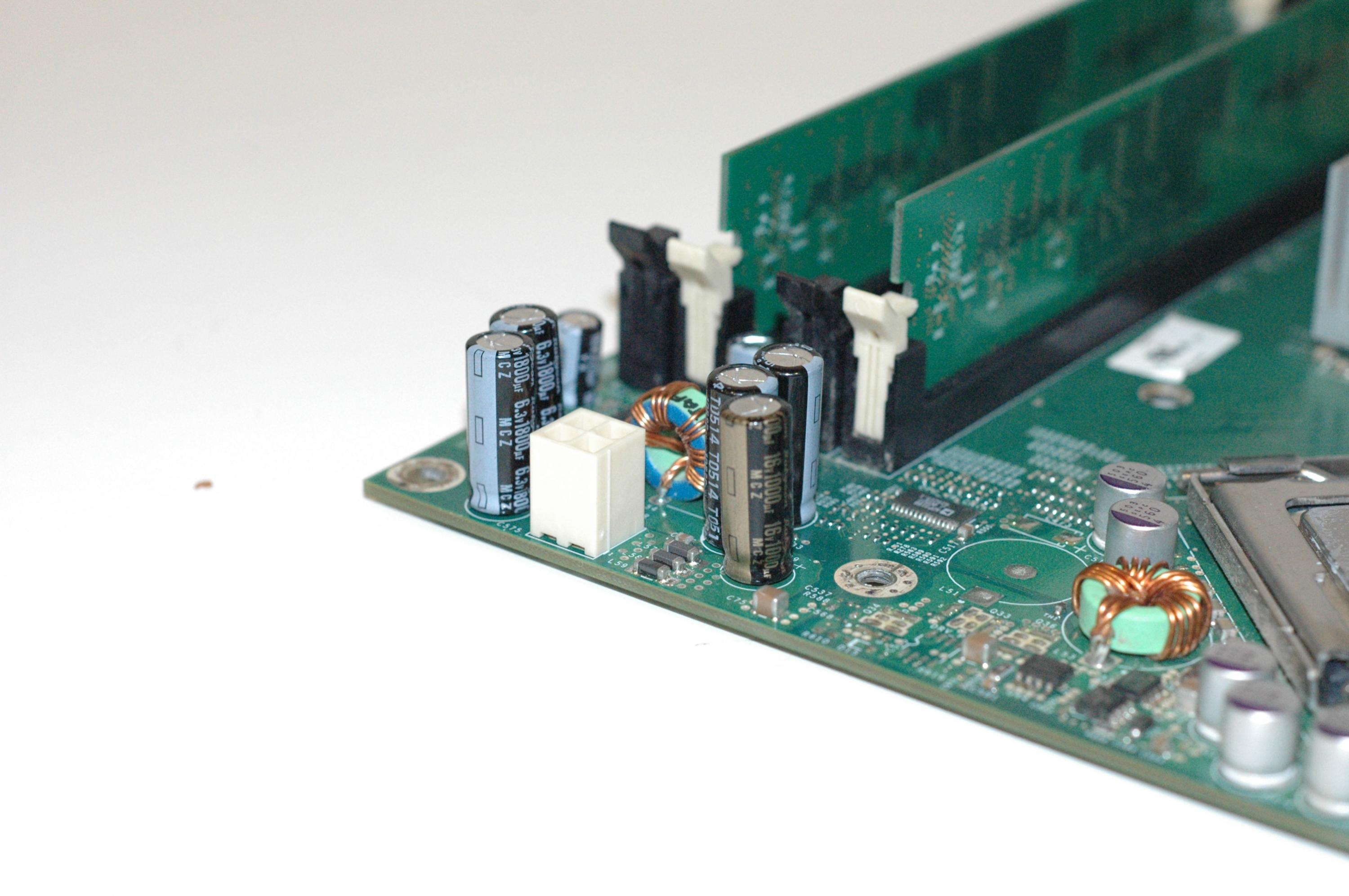

    Hello Guy's I have a Dell GX 620 Motherboard that has two bloated Rubycon's on it. I should mention that the system runs fine and I had it up for 24 hours without a problem.
    I have a couple questions. First, are these fake Rubycon's. The five next to the motherboard are especially suspicious one of them has a black gold label and the others have black gray even though they are the same series.
    Second what Caps do you recomend replacing? I will be reselling and I need a Hard drive and a OS so I don't want to spend a ton on a Recap. Also, it is running fine so. I was thinking about replacing the (4) MCZ 6.3v 2200Uf, the (5) MCZ 6.3v 1800Uf and the (1) MCZ 16v 1000uf. Should I just worry about the (4) MCZ 6.3v 2200Uf.

    No, these are not fakes... The first time I saw a vented Rubycon was a few weeks ago when I picked up a tower GX520 or 620 and one of the Rubycons had the "K" split... It wasn't bloated, the "K" was just split with some crusted electrolyte.
    The only black/gold one I see is the 8mm one... That's fine.

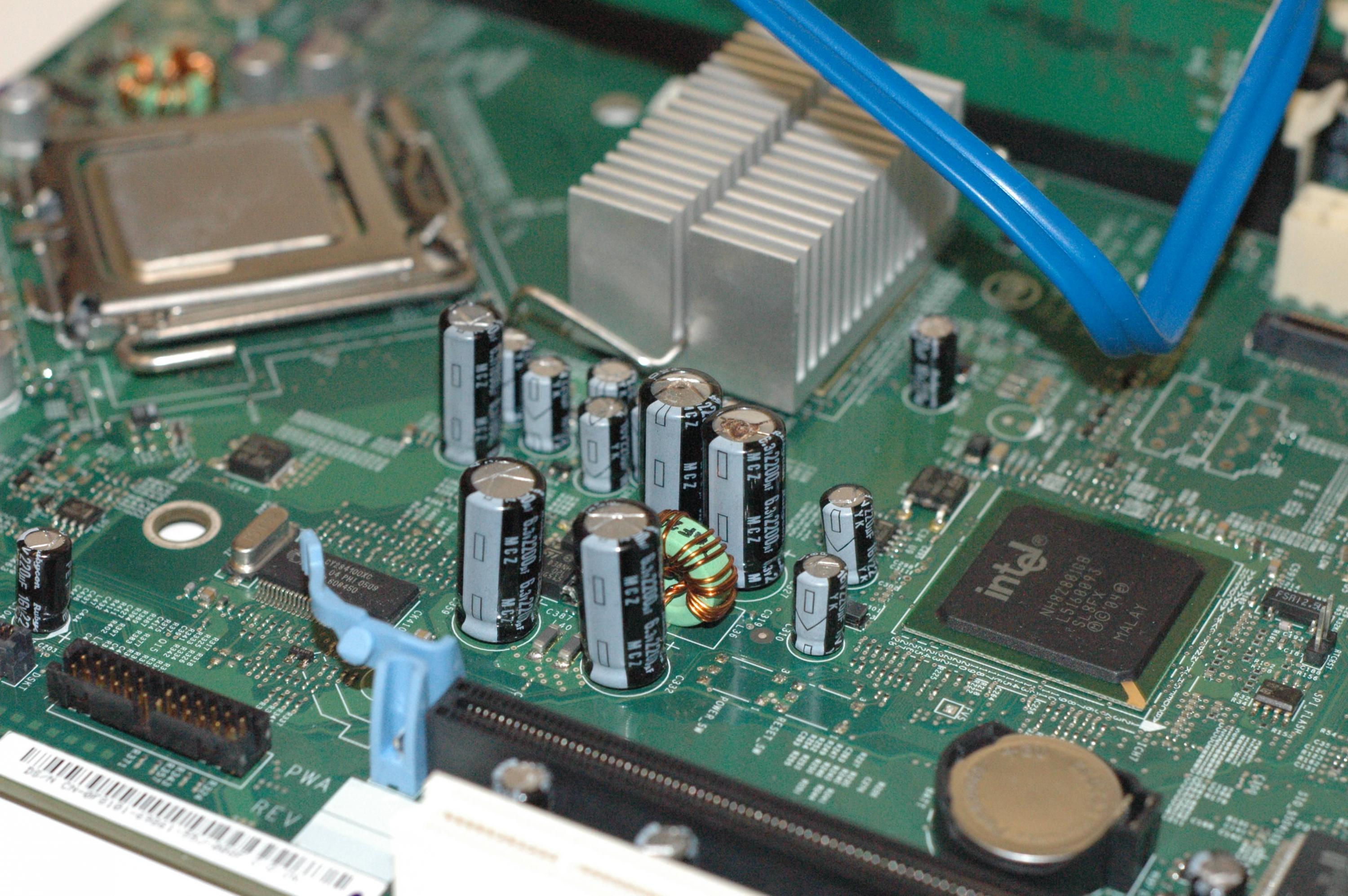

    In this case I would personally do a total re-cap (Not the polymer VRM chips, obviously)... But that's not half of your problem... You need to take a look at what caused this... The PSU! Crack that thing open and you'll see that the inferior caps passed so much ripple to the motherboard that it caused the Rubycon caps to bloat.
    I would also replace the small cheap "YK" Rubycons with something more reliable, preferably a non-GP cap.
    Replace the MCZ and MBZ with Nichicon HN. For the values where you cannot get HN, it is OK to replace MBZ with HM, but MCZ must be replaced with at least HN. HZ is good too. If you had an ESR meter, you could test the caps, otherwise, be safe and just replace them.

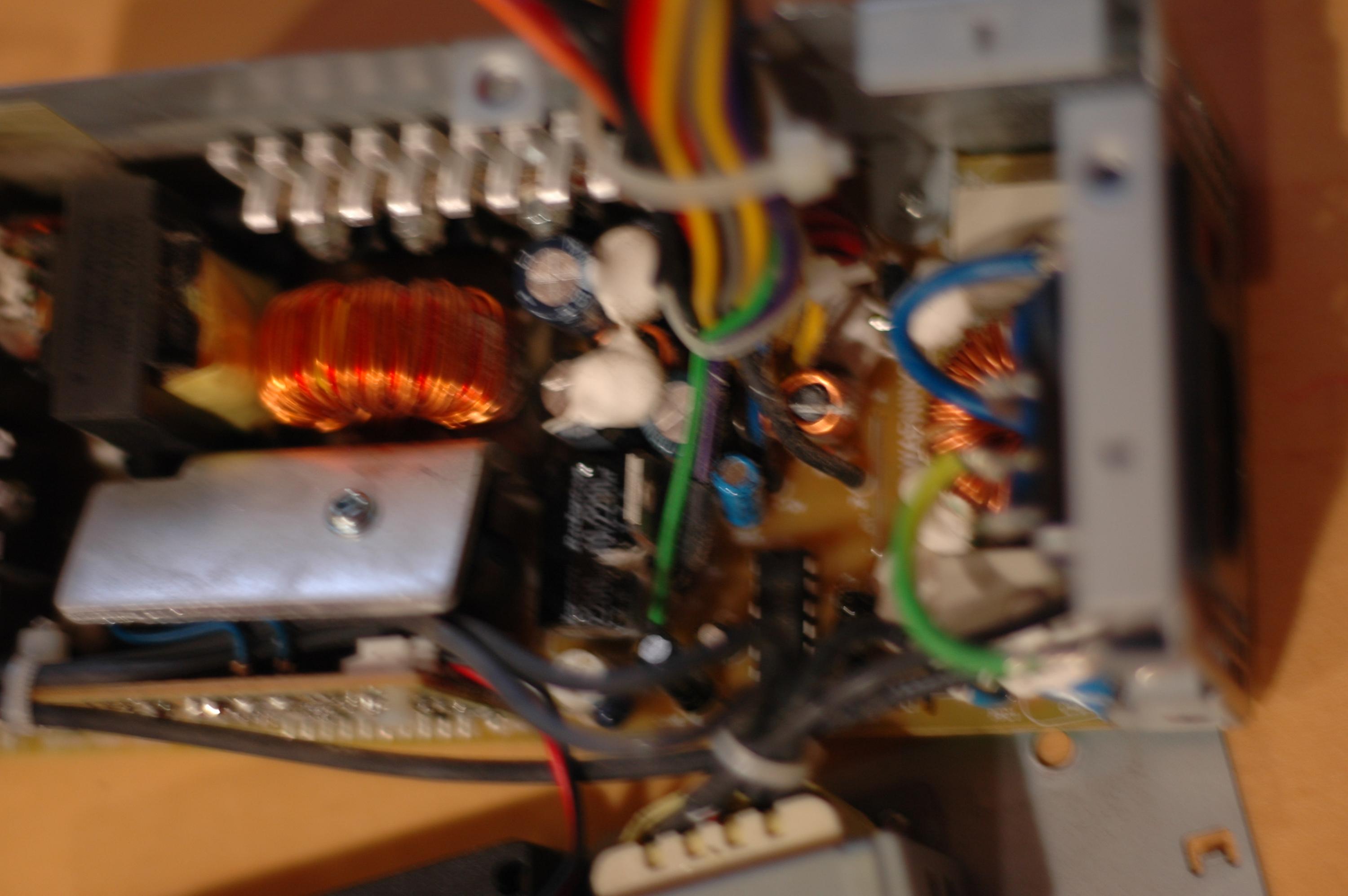

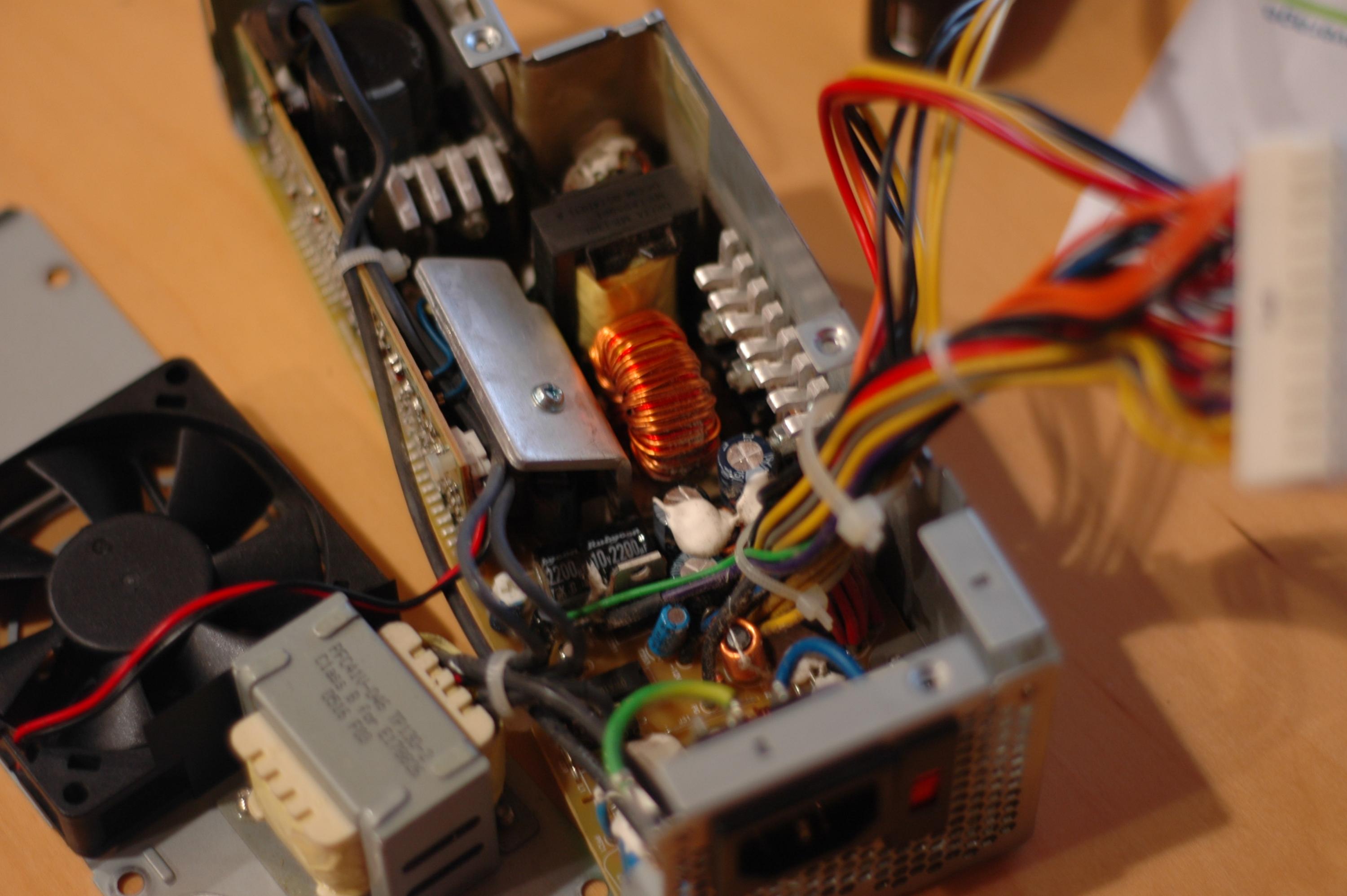

        Post some pics of the PSU innards... Caps don't always bloat, sometimes the electrolyic just dries up on the inside. Good question about the small caps. If someone else can comment about the location of the small ones and their function, we can get a better answer regarding that.

          Just by the way, I have a GX620 here, SFF, same as yours, PSU model N275P-00 / NPS-275BB B REV 02 / NPS-220BP. All electrolytic caps on the motherboard look ok. Combination of Rubycon 6.3 2200 10mm, 16V 1000 and 6.3 1800 8mm. Small caps in my case are UCC SMG as opposed to your Rubycon YK. SMG is a pretty good series, I'm going to leave them. Looks like they stopped using Nichicon VR/VZ for the small caps, thank G-D. Computer is unstable.
          I opened up the PSU, all the caps look fine but I know better. Most of the caps are LTec "LZG series (Delta likes to use LTec Caps), a few Taicons, and a single UCC KZE. I had to desolder the heatsink with a couple of MOSFETs attached to get to some caps underneath, and I also desoldered the PWM/Fan Controller daughterboard which is 19 pins.
          I can't test the caps, but I'm willing to bet that the replacements I ordered from Digikey will solve the problem.
          If you want to know what I used, let me know I can post the list.

            I do have a kit for this board.... Only the MCZ series on it will ever give you any problems.
            https://www.badcaps.net/store/produc...roducts_id=105

              Should I suspect the MCZ if they look ok? I guess I should really test the system with a good PSU to find out.

                    Re: Dell GX 620 Motherboard Recap

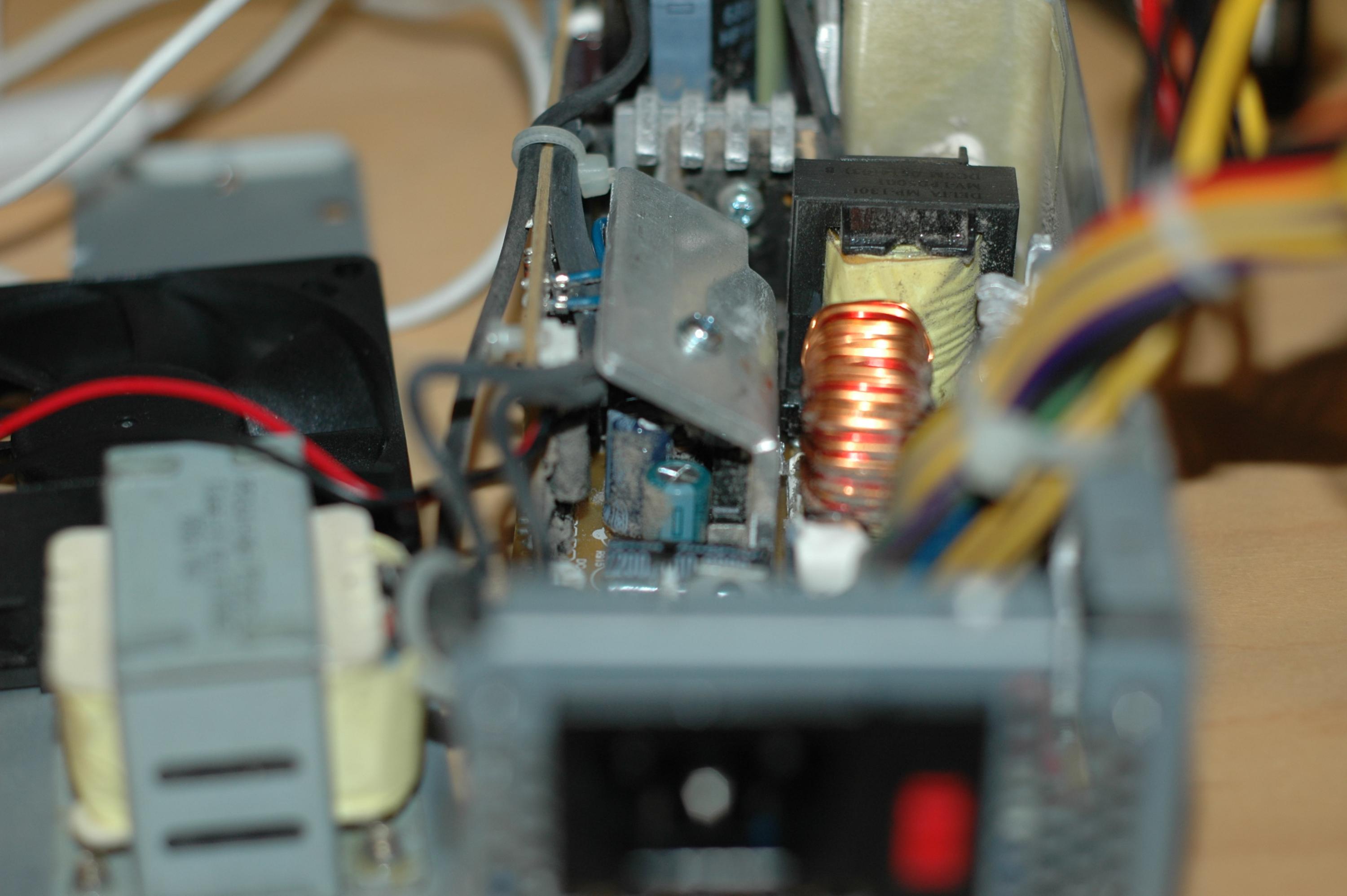

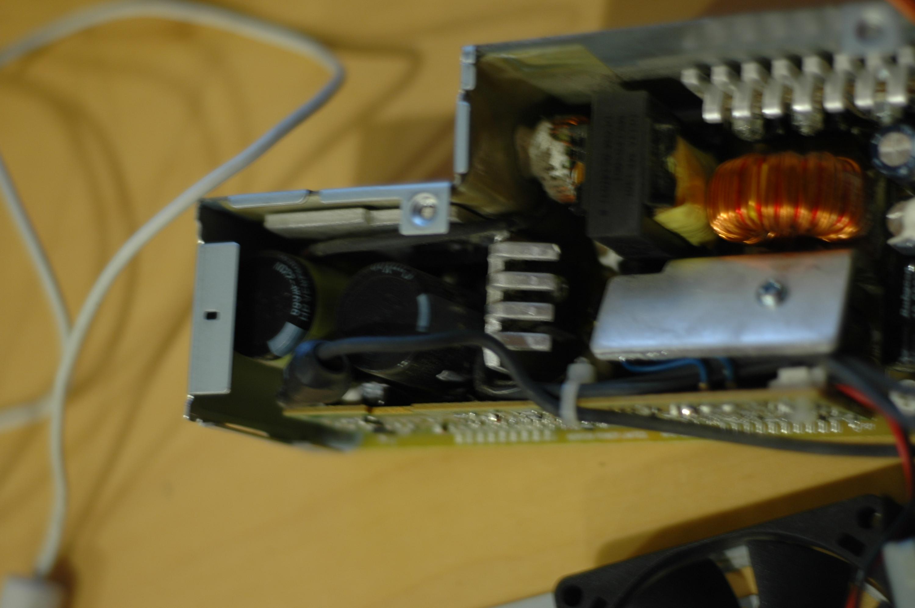

                    Here are some Pictures, sorry they aren't that great, there isn't that much Room to take photos.
                    They Psu was really clean like literally had no dust in it so I think someone has replaced it. The system also ran fine in its current condition.
                        I'm pretty sure I had the same PSU. I don't have it anymore, but I still have a complete mapout and list of parts, which I make for all PSUs I re-cap anyway. I even have the list of caps from Digikey if you're interested. Let me know.
                        By the way, you will need to desolder that daughterboard and the heatsink with the two FETs to get to some small caps. Also, check if the Delta model is the same as the ones as I posted above.

                          So what about the ~20 small Caps on the motherboard. The Badcaps kit doesn't have them should I really worry about them?

                            I don't have the motherboard anymore, but for the small 16V 220uF Rubycon YK caps, if you really want to replace them, you can go for something like this:
                            http://www.digikey.com/product-detai...154-ND/3134112
                            That's probably the highest rated cap that exists in 16V 220uF 6.3x11mm. It's not implicitly listed in the datasheet, but based on the size, the ripple for it is 700 compared to 280 for the YK...
                            Also, YK is not as shabby as I thought... So you should probably leave them alone...
