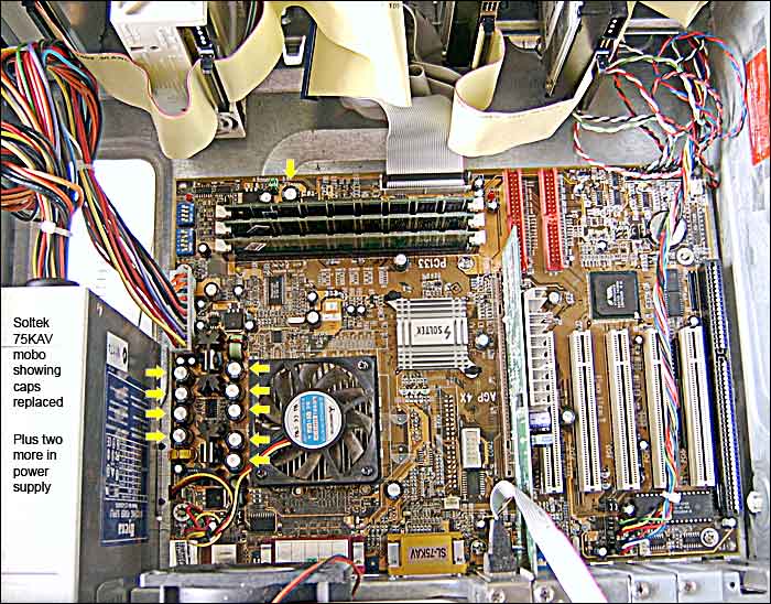

      Pic 1 - Soltek 75KAV mobo showing caps replaced
      Yellow arrows show cap positions, new ones in-place.

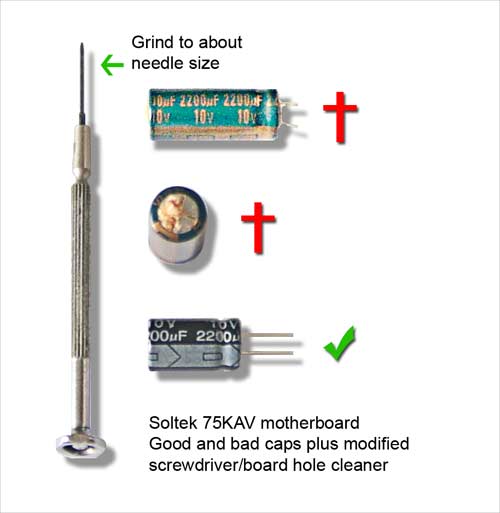

        Pic 2 - Good caps, bad caps and hole tool
        Cap removal method to follow.

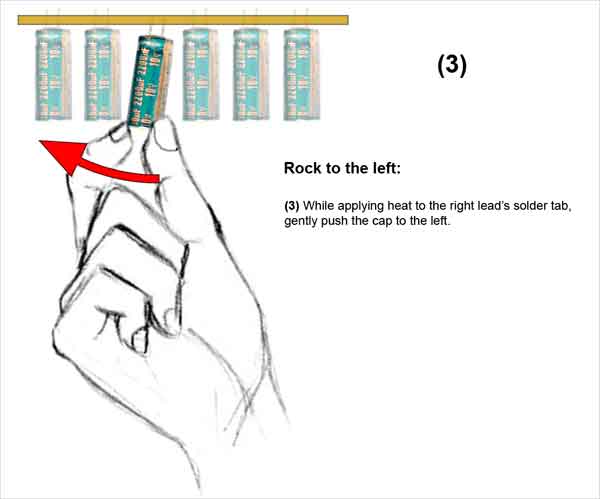

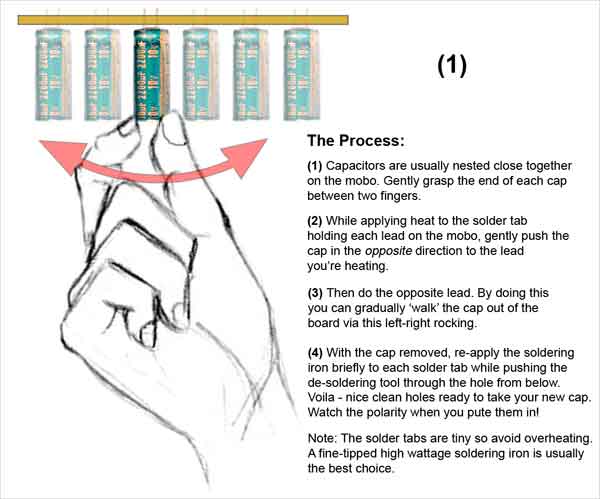

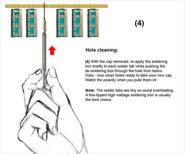

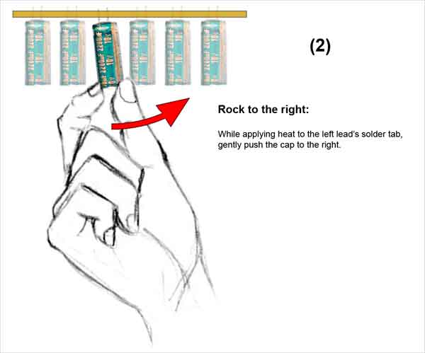

          Cap Removal Process - Rock it out.
          4 images show how I removed the crap caps successfully, and relatively quickly.

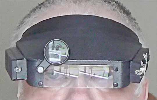

                        Magnifier Headband
                        Worth its weight in gold for cap replacement. This one has 3 levels of magnification - I used all three of them!
