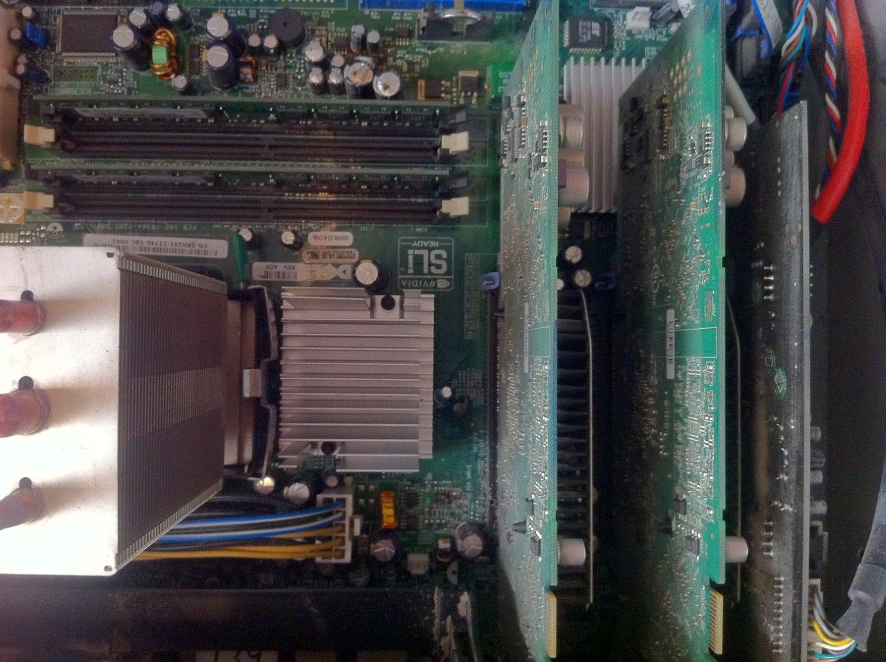

    Dell XPS 600 GS375 Motherboard

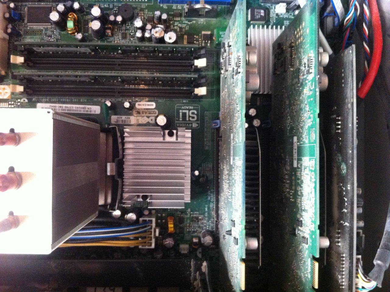

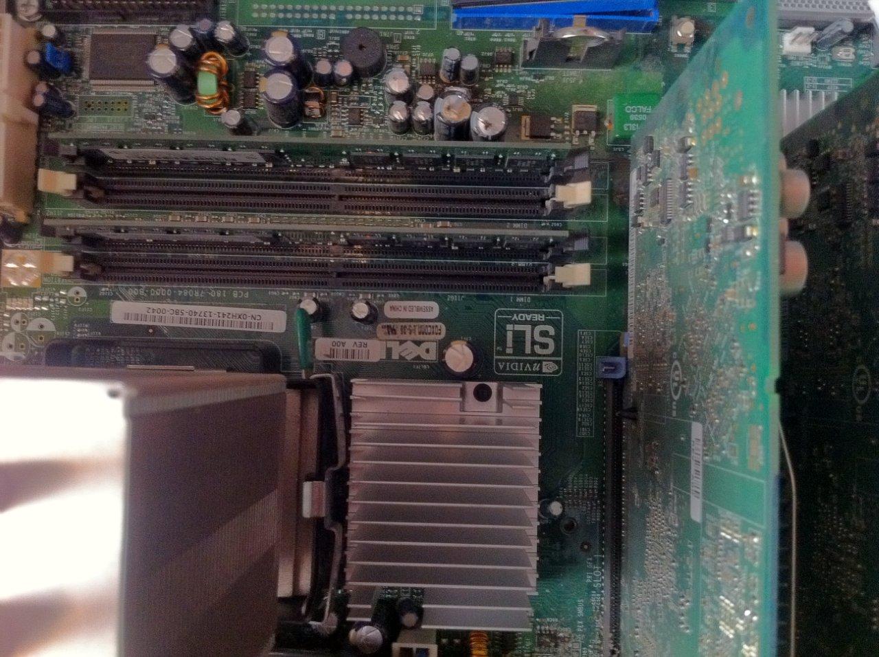

    I have a Dell XPS 600 with a GS375 Motherboard with.... bad caps!
    Two questions:
    Is there a cap kit for these? I would like to try doing it myself.
    On the attached picture the board looks sort of brown around the bad caps.. Might this indicate that they took other items out too or is this par for caps going bad?
    Thanks,
    -Tucker

    Re: Dell XPS 600 GS375 Motherboard
    Yikes...
    Busted Rubycons... That means that it's getting really hot inside or that it was a cascade failure. Can you show a picture of the whole board? Also can you look inside the PSU?

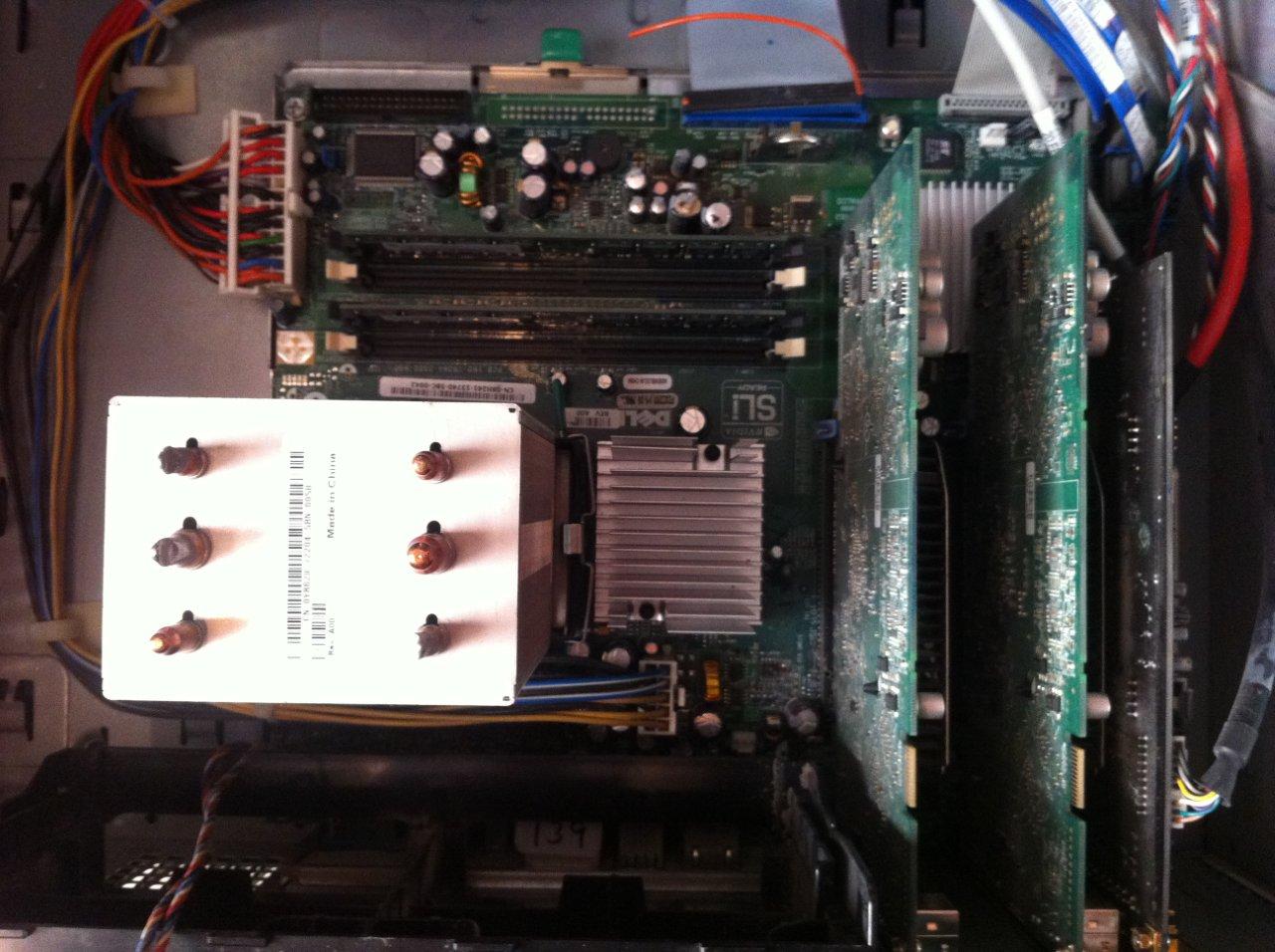

      I don't have pictures inside the PSU yet but can get those tomorrow.
      The 5 year old computer was power cycled on off on off on when an electrician was doing work... it never came back. I get an orange light on the mobo and a diag status 4 light.

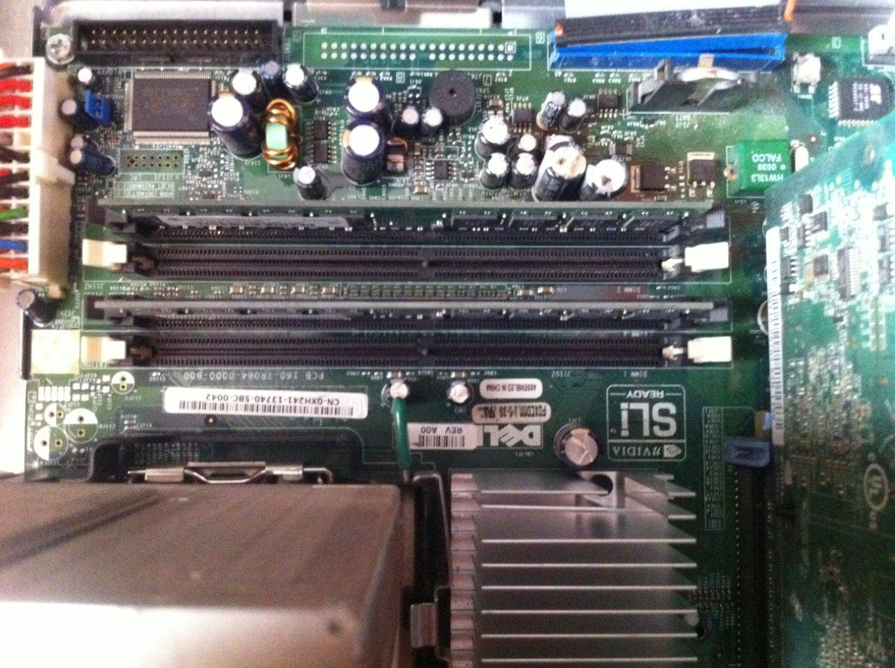

        All the caps that I can see are Rubycons (Though I can't see the CPU VRM caps, the heatsink is in the way). Needless to say, some of them have failed from either excess heat or excess ripple from a failing PSU.
        So yea, take some pics of the PSU as well. Most likely you'll either have to repair it or get a new one.
        Another problem I see is the SLI nVidia video cards. According to Dell's specs, these are either Geforce 6 or 7 series. I suggest you test them in a different computer to see if they work.
        In the meantime, if you can take the machine apart (And you might want to give it a good cleaning, as well as clean the CPU and bottom of the heatsink so you can apply a fresh layer of themal paste later) and list the capacitors, I can point you in the right direction.

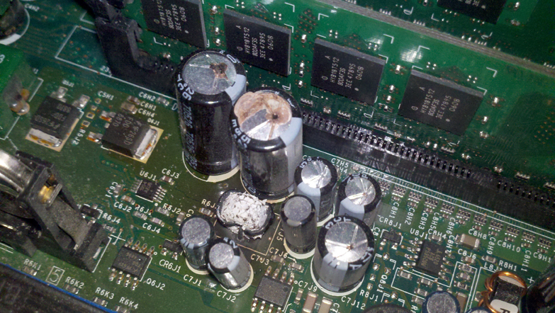

          Bad caps don't usually take out other components, but in your case they have. Notice the fluffy white component next to those bulged capacitors - that's an inductor, and the white fluffy stuff was once wire (and maybe glue) that has now all burned off.
          You need to replace that inductor. If anyone here has an idea of what inductance this inductor should have, then perhaps you may be able to find an exact match. If not, then look for junk motherboards that have inductors of the same or similar size.
          Also, because of the burned inductor, you will also need to remove and test the two MOSFETs in that area.
          At this point, I would say this motherboard is in the realm of repairable, but it seems that it will be a little more than just a simple recap job. So it's up to you to decide how you want to proceed. If you want to repair it, let us know.
            Agree.
            Note darkened PCB at MOSFET to right of blown caps.
            Bad MOSFET might have been the cause of bad caps vs the other way around.
