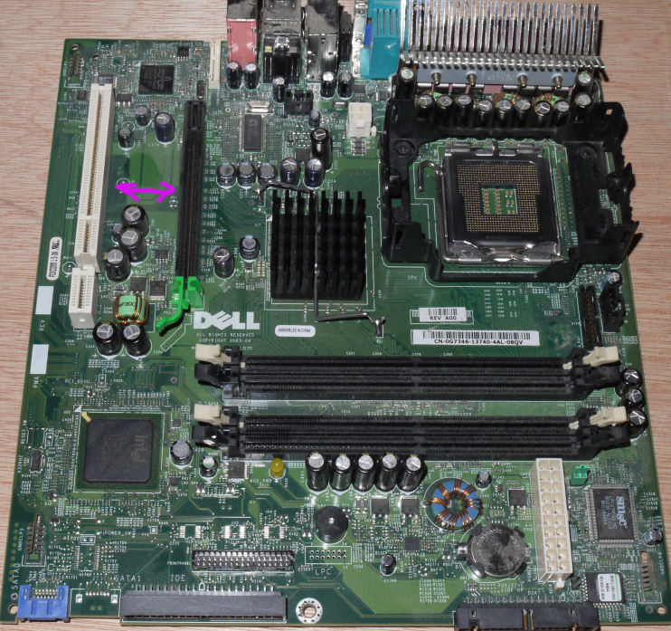

                    I have a small desktop GX280 that is mostly dead. I thought it was a cap problem, but after reading this thread there's another possibility, a cracked solder under a BGA, and I don't think I can do much about that.
                    The caps I've seen in repair kits are 1500uF 6.3V and 1800 uF 6.3V, and there are nine of the latter next to the CPU socket.
                    Did anyone ever successfully repair this board (see attachment) by recapping? Which caps were replaced? How did the caps fail?
                    In addition to the 9 caps next to the CPU, there are 2 unused spots, presumably for the same 1800 uF cap. Can I just add 2 new caps there and leave the old ones in place? The sum of total capacity should increase by about 3600, and the ESR should go down somewhat, and if the problem is with the caps it should make a noticeable improvement.
                    Currently, it starts posting maybe 1 out of 10 times (but never finish booting), and about 6 out of 10 times the fan just goes crazy.
                    TIA

                            We've repaired over 50 Dell boards, 270s, 280 and 745s that have what we call "runaway fan".
                            The easiest test we've found is to push down on the top of the fan on the CPU heat sink, if it boots with the added pressure your problem is cracked solder balls under the 775 CPU socket.
                            There are all kinds of voodoo ways of trying to re-flow the solder balls, you can wrap it in a blanket, heat it with a hot air gun, put it on a pancake griddle. None of the quicky ways gives great, consistant or guaranteed results. We have an IR solder station and still only cure 9/10.
                            Sometimes we can re-flow the socket sometimes we have to remove it nad put a new one on.
                            Of course you should change all the caps before you do anything to the BGA socket, start with the easy stuff but if after all the caps have been changed the fan still takes off like crazy try booting it with some additional pressure on the CPU

                              Good info, thanks. Thing is, I'd like to find out before recapping if it's the caps or cracked solder balls, so I think I'll just "spring load" the HSF first to see if that makes any difference.

                                        I attached a photo with the location and type of obviously bad caps, but I went ahead and ordered a full recap kit.
                                        Are you saying the moral of your story is that I should not even try to recap this board? I'm okay with junking it if needed.

                                          Recapped the entire board, and ItWorks)tm) !
                                          Not entirely sure why, but I highly suspect the PSU has thrown some abnormal voltages at the motherboard, causing it to give way
