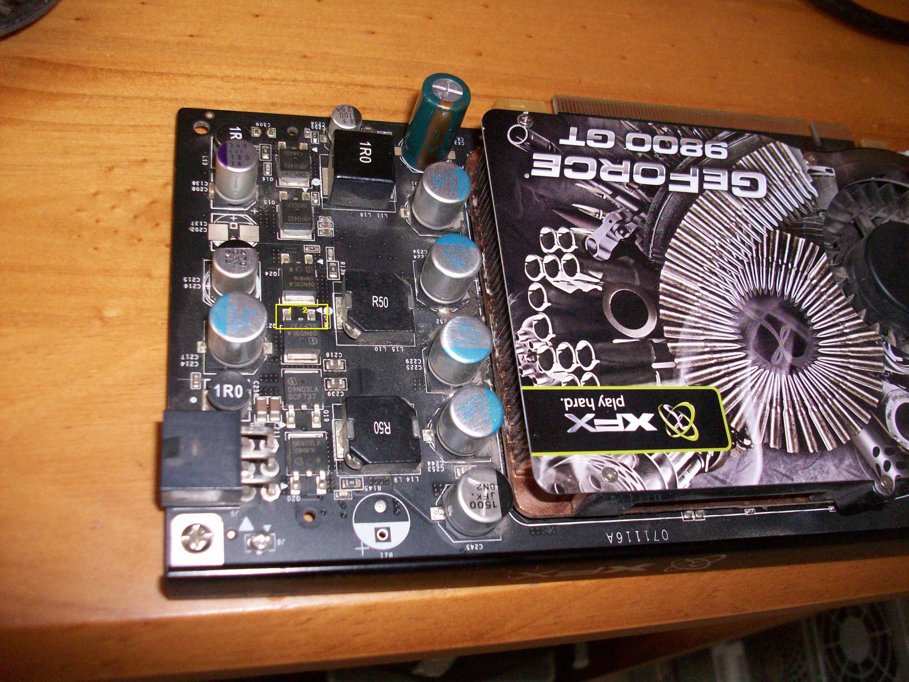

            Here are the readings from some components of my card (see pic1.JPG)
            06N03LA (Red Square 1)
            Black probe / Red probe
            1-2: 622
            2-1: 668
            2-3: 0 (continuity)
            3-2: 0 (continuity)
            1-3: 622
            09N03LA (Red Square 2)
            1-2: 622
            2-1: 1 (infinite resistance)
            2-3: 0 (continuity)
            3-2: 0 (continuity)
            1-3: 622
            09N03LA (Red Square 3)
            1-2: 0 (continuity)
            2-1: 0 (continuity)
            2-3: 0 (continuity)
            3-2: 0 (continuity)
            1-3: 0 (continuity)
            SHORTED???
            06N03LA (Red Square 4)
            1-2: 622
            2-1: 668
            2-3: 0 (continuity)
            3-2: 0 (continuity)
            1-3: 622
            D452 (Red Square 5)
            1-2: 1
            2-1: 1
            2-3: 467
            3-2: 1500
            1-3: 624
            0472(Red Square 6)
            1-2: 652
            2-1: 1
            2-3: 0 (continuity)
            3-2: 0 (continuity)
            1-3: 590
            0472(Red Square 7)
            Replaced, was blowed, but still shorted the card. I see this issue when I connect the 6-pin power supply, the mother won't power on.

              Looks like it may be. Remove from video card and test it again. If the readings are the same or you found the problem.

                    I found two 09N03LA in a damaged Gigabythe Motherboard! Unsolder it and put in the graphic card. I noticed one leg of the mosfet left with a little layer of the board that was the contact...so... my question is, where it go? I don't see any track to another component...the same happens with all other transistors, if I turn the card I see In the same position another equal transistor but I don't know if they're related...
                    Any sugestion? I don't want to power on the graphic card without checking this...
                    Thanks.
                    • spleenharvester
                      • Mar 2010
                      • 903
                      Re: Xfx 9800 gt
                      Take a picture mate. There doesn't need to be a trace visibly leading to it for it to be relevant in some way (may well be multilayered PCB)

                        thanks spleenharvester, I power on the graphic card and worked, post screen appears but only for a 2 or 3 minutes, then suddenly power off. I tried to power on again and graphic card is shorted again.. I check the new 09N03LA and it's shorted as the original transistor! Another component is shorting the transistor, any idea to check?
                        • Guti904
                          • Jun 2012
                          • 71
                          • Argentina
                          Re: Xfx 9800 gt
                          Sorry, I have a correction... I made a mistake and unsolder the botton transistor 09N03LA instead the damaged.. then I had to resolder both transistors. Now, the shorted transistor is not the same before, is the number 2 (see pic) instead number 3 replaced.
                          • Guti904
                            • Jun 2012
                            • 71
                            • Argentina
                            Re: Xfx 9800 gt
                            I'm a idiot! I replaced correctly 09N06LA (see pic, red square number 3) but below I put a 06N03LA instead the another 09N06LA! Maybe they shorted because is smaller than 09N06LA? I'm going to unsolder it and put again the 09N06LA, I hope this work, it's my last transistor! If anybody can help me before power on the card, I'll thank you.
                            • Guti904
                              • Jun 2012
                              • 71
                              • Argentina
                              Re: Xfx 9800 gt
                              See red square number 3, leg 1... what's the destination of this leg?? The PCB layer lift just where the leg was solder so, I don't have any contact there... anyone can help me?
                              • Guti904
                                • Jun 2012
                                • 71
                                • Argentina
                                Re: Xfx 9800 gt
                                I resolder the 09N03LA mosfet and the graphic card comes alive again, but only for 3 hours... then power off. I want to know (see new pic) the destination of the legs 1 and 2, the contact of leg1 dissapear and I don't know where to solder it. In the opposite side of the graphic card, in the same place of each mosfet there's another equal mosfet. Could be each opposite pair connected?? Anyone can tell me what another component I must to check that may be causing the mosfet burn?? Thanks
                                • Guti904
                                  • Jun 2012
                                  • 71
                                  • Argentina
                                  Re: Xfx 9800 gt
                                  A friend suggest me to change all transistors 09N03LA and all 06N03LA because maybe they are not really good and are the cause of shorting the first mosfets... and could be the mosfets working in paralell with the mosfets of the another side of the board?? Anyone can help me?
                                  another thing, I found a IRFZ44N, can be a spare to 09N03LA? (25V-50A)
                                  Can I change all 06N03LA with the same spare of 09N03LA?? (I see 06N03LA datasheet and they are very similars)

                                    Re: Xfx 9800 gt
                                    Please post more pictures of both sides of the video card. I understand what you are describing but I still would like to see what the video card looks like. Make them so that your camera is positioned straight above the video card and not angled.
                                    I can't promise it will work for sure, but I have done similar MOSFET substitutions in a few video cards myself, and they did work. So most likely the 09N03 will work in place of the 06N03.

                                      thanks momaka, and what about the missing tracks? The track where each leg is solder dissapear... where I can't solder the transistor If one leg is missing?? I'll post pics tomorrow
                                      • selldoor
                                        Slow Learner
                                        • Dec 2010
                                        • 7870
                                        Re: Xfx 9800 gt
                                        Can you do a very close up picture of the end of the transistor where the pad has lifted.
                                        I have looked at a really clear pic on another post and there does not seem to be any surface traces.
                                        When you are doing the pics try holding the board up with a very bright light or the sun behind it and see if any traces show through and take a pic.
