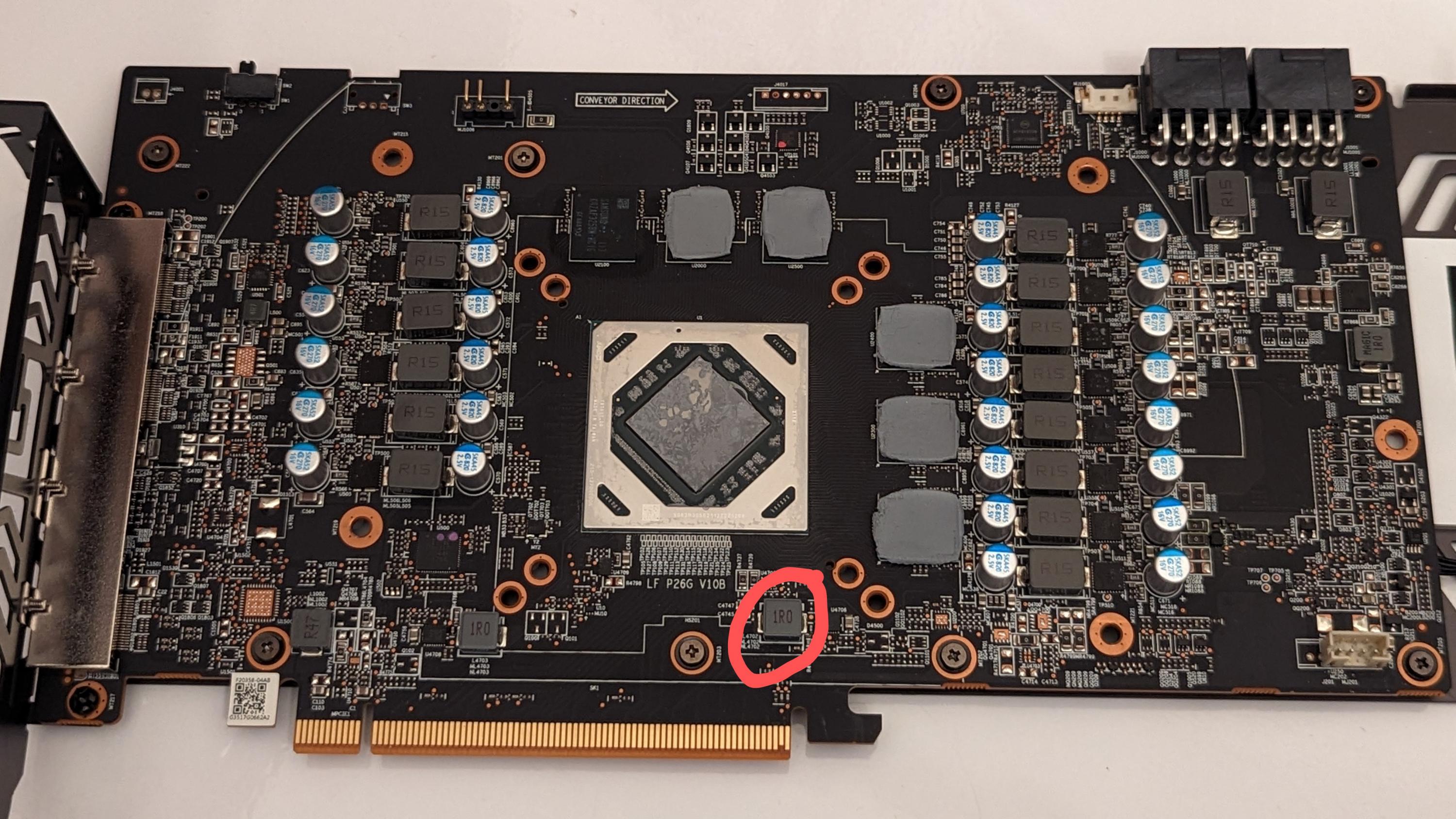

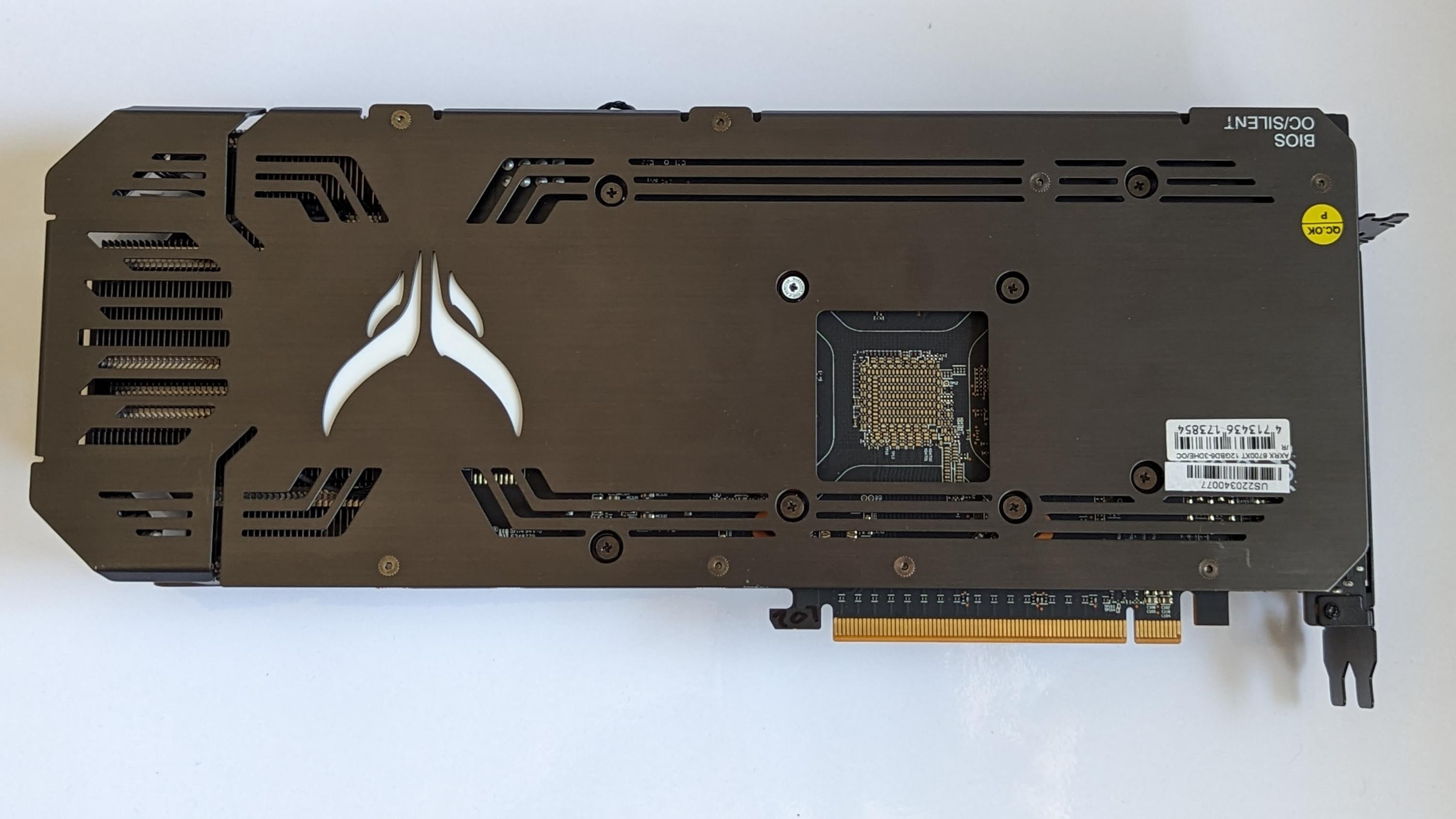

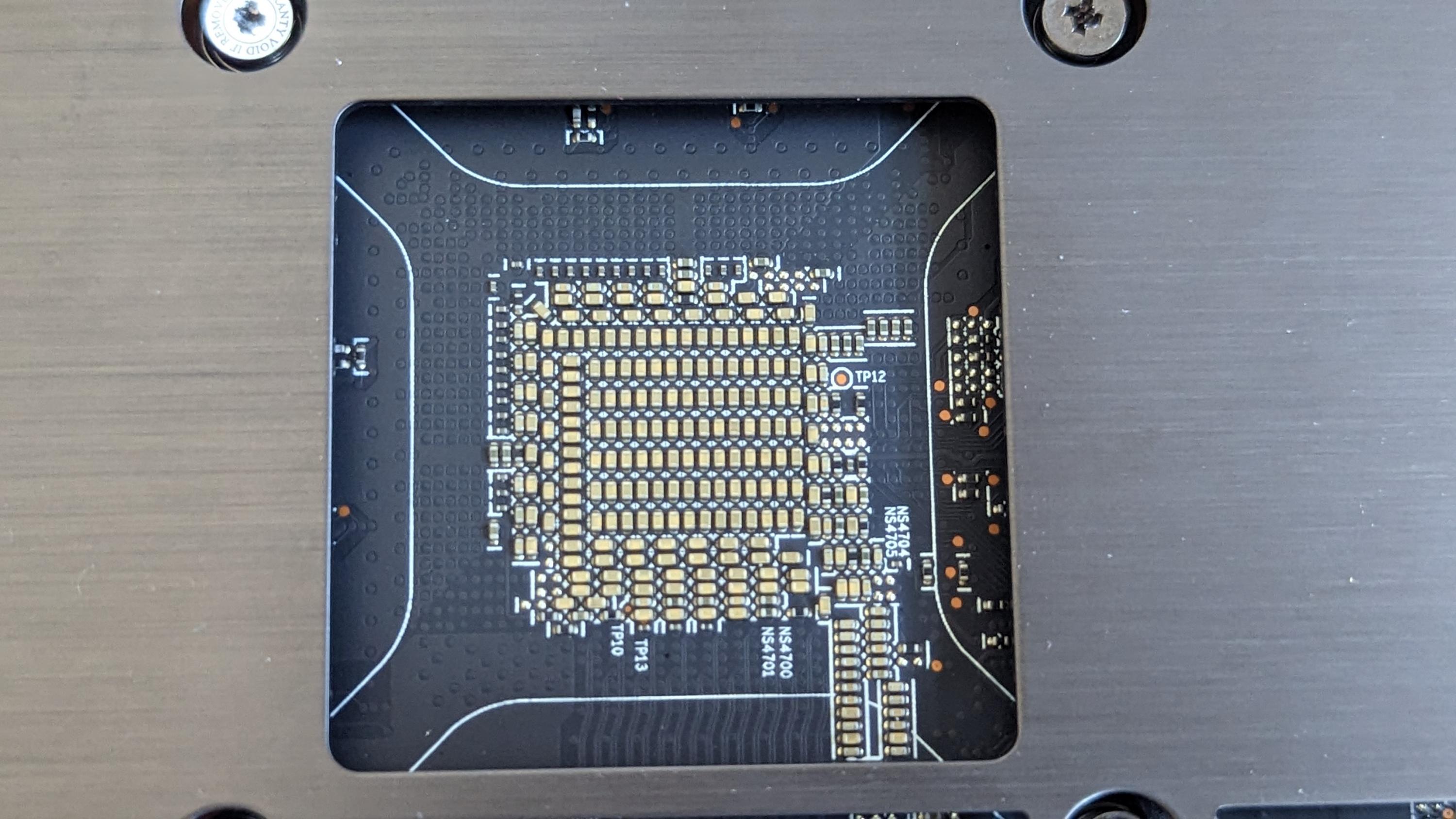

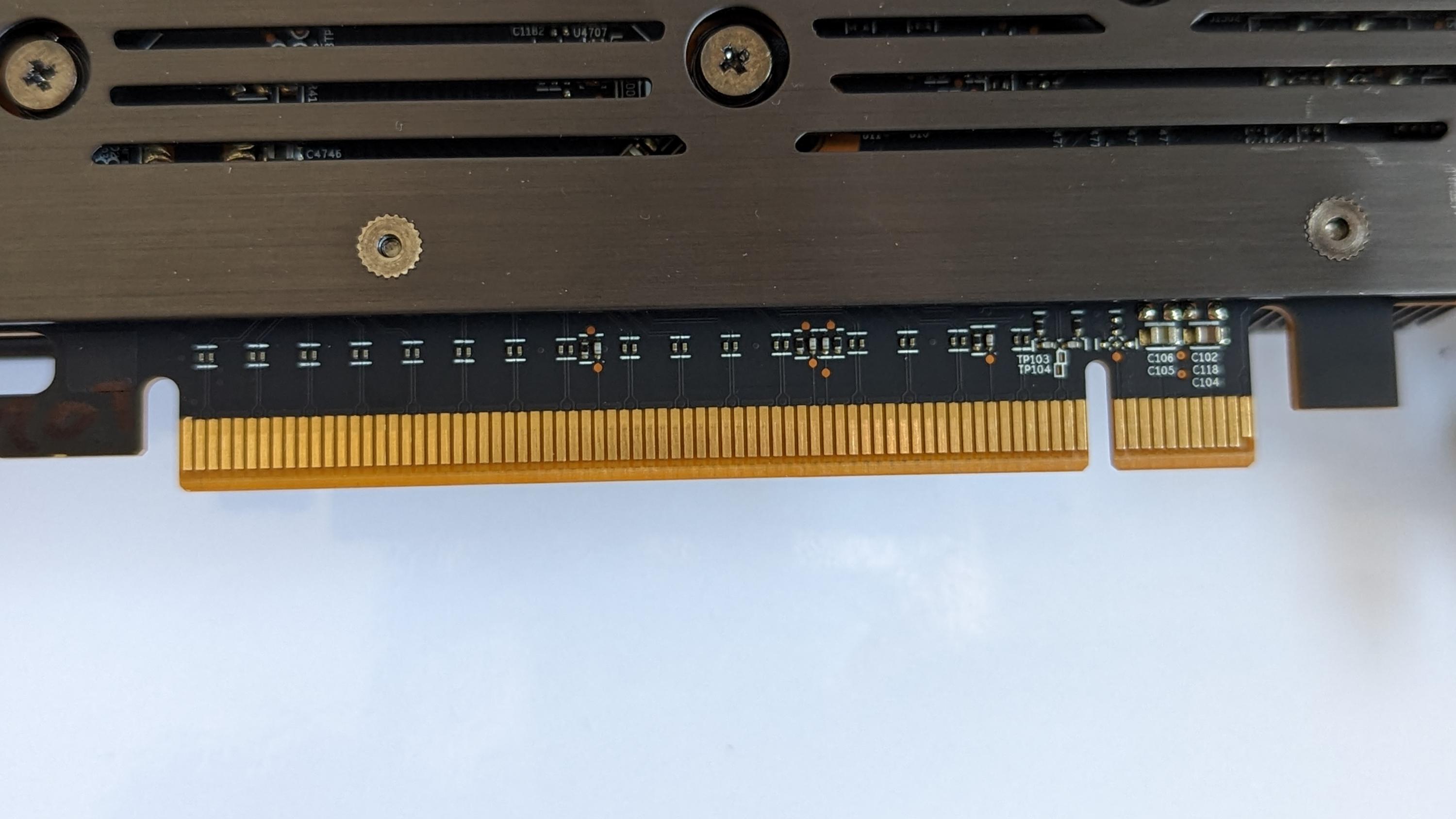

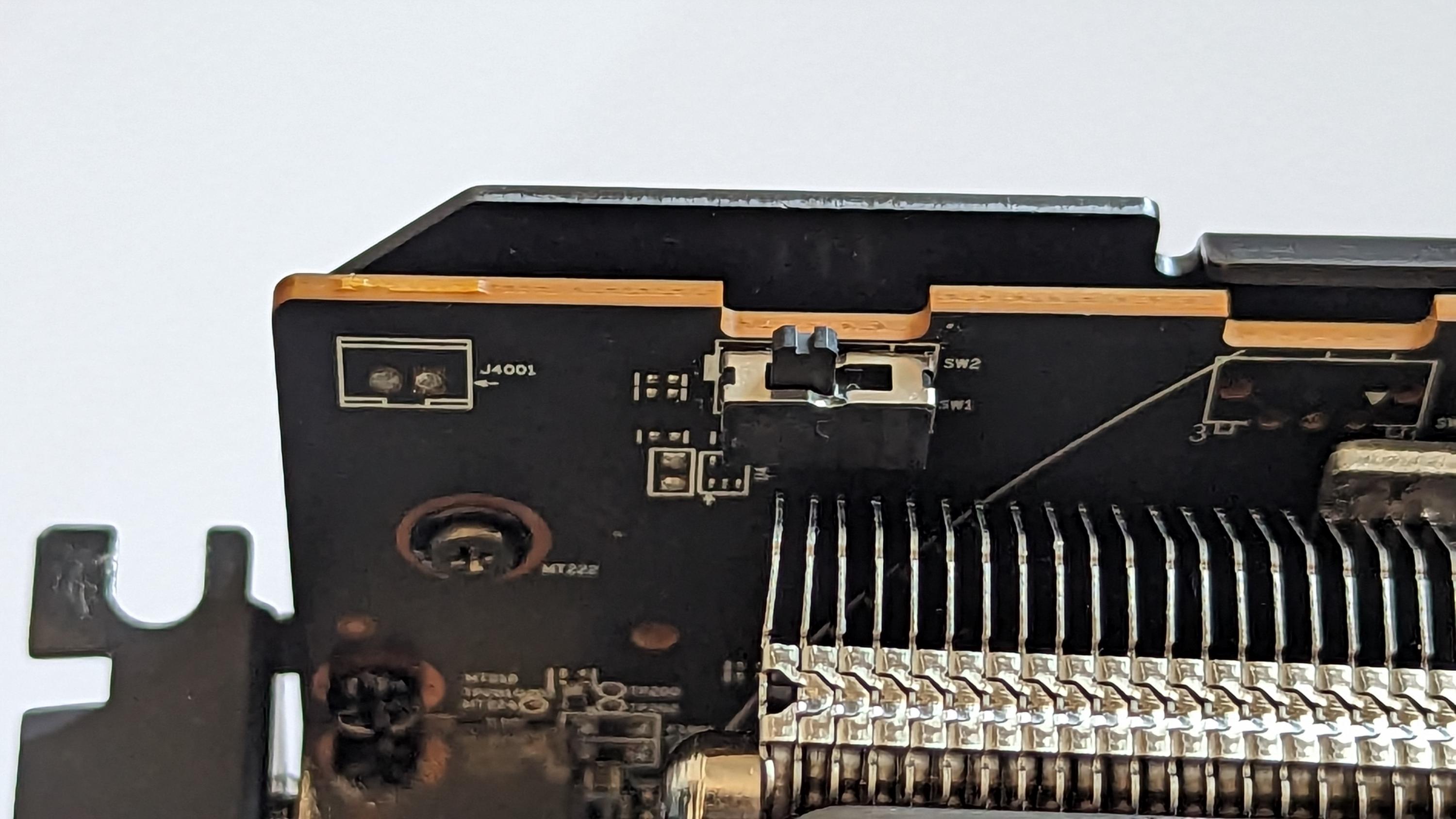

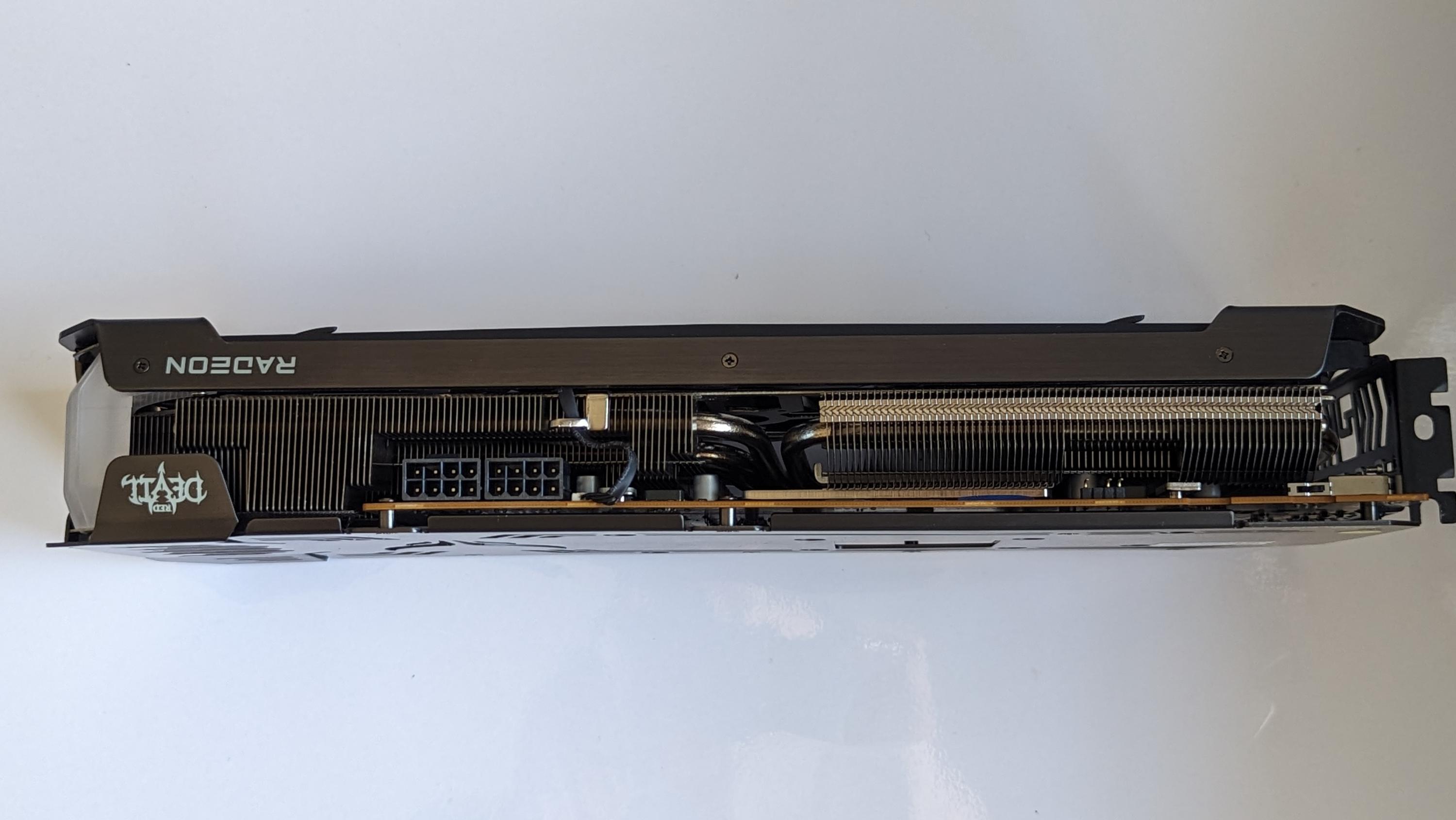

    RX 6700 XT PowerColor not recognized in any OS
    The title explains the issue. The additional information is:
    - GPU was never disassembled
    - not recognized in Windows/Linux, not even with error, totally not recognized like it's not plugged in
    - GPU fans don't spin but work. When I turn on the system, the fans twitch for that second when I press the power button. Same thing happens when I power off the system.
    - GPU does not get hot no matter for how long I let it run even though not recognized
    What I have to done so far:
    - played with the BIOS switch without any luck. OC/SILENT no result
    - opened the GPU replaced thermal paste and pads, inspected the hardware. GPU looks like brand new, no burns, corrosion etc. No luck.
    If there is anything else I can provide to resolve the issue, let me know. I will provide all necessary information.

        • martimarti
          • Mar 2023
          • 5
          Re: RX 6700 XT PowerColor not recognized in any OS
          That's the short according to the multimeter. Diode mode, 0.021v is what I'm getting. The one on the left reads 0.64v. How can I find the correct shorted component?
          • WorcesterSauce
            • Nov 2021
            That circled 1R0 component is an inductor, my dude. You should get very low resistance across that. It should not short between either side and a ground plane, however.
