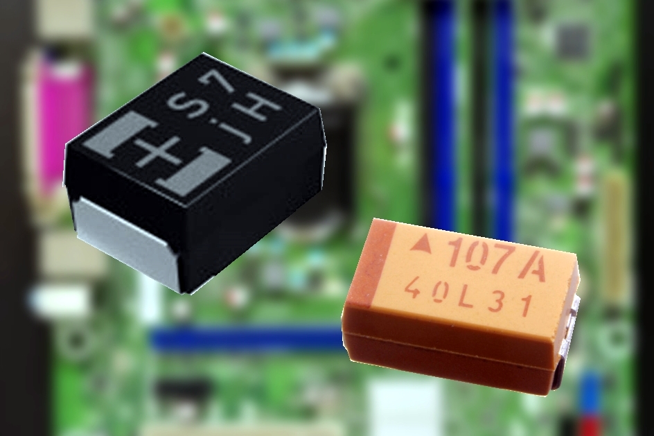

    Identifying SMD diode
    Can someone help me identify the diode shown in the image.
    Marking is E7 (first line) and Ed (second line). Case excluding terminals is 2.8 x 3.5 x 2.0mm (H)
    I can't find it in any of the SMD marking databases.
    Thanks.

    Re: Identifying SMD diode
    Thanks.
    No image attached ?
    https://www.s-manuals.com/smd/e7
      Where did you get the idea that this is a diode, this is actually a polymer capacitor.
        https://cdn.badcaps-static.com/pdfs/...f8a3c59886.pdf
        as lotas suggests its a capacitor now you have updated the post with a image its easy to identify
          This is a series from Panasonic. (POSCAP)
