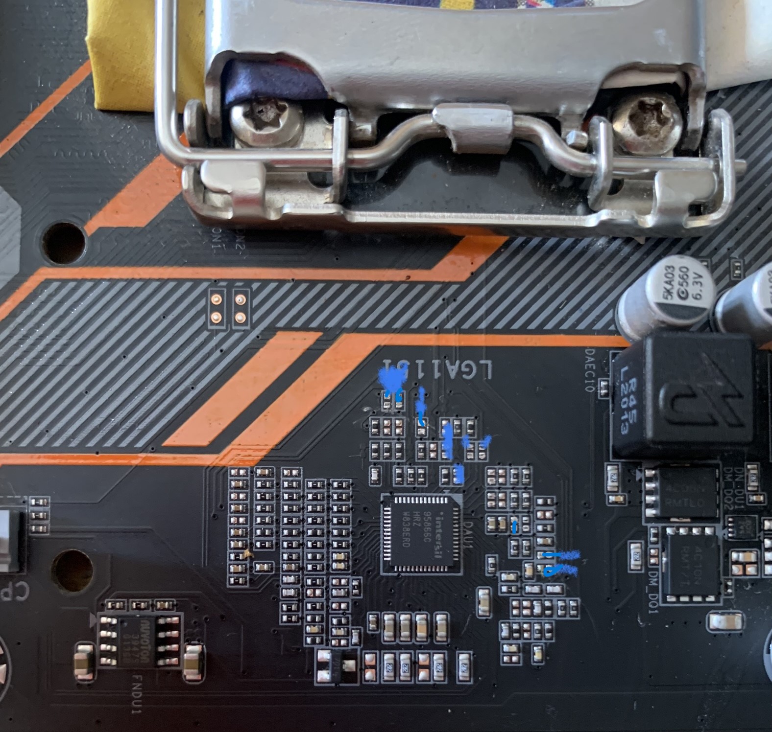

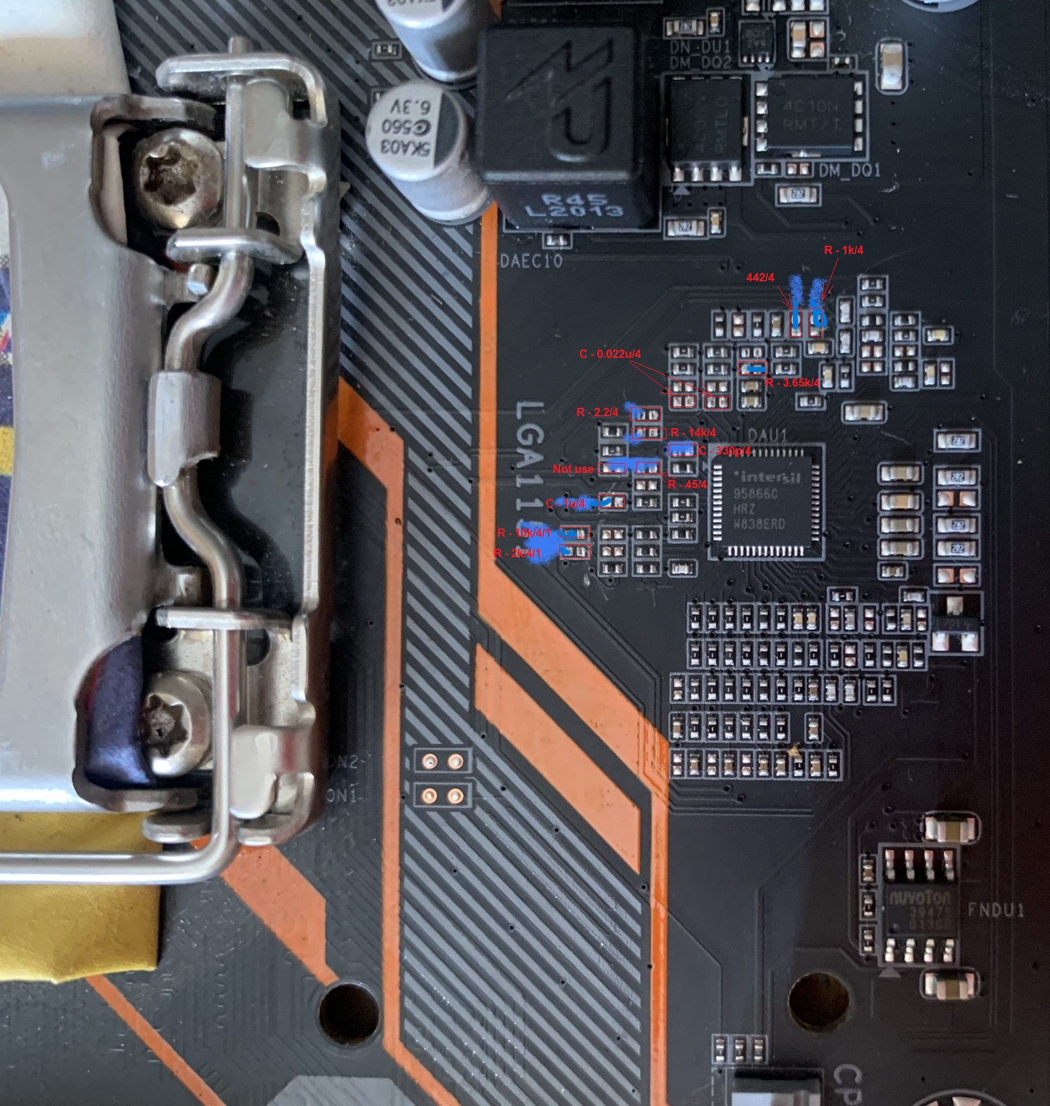

Hi guys i've got Gigabyte B365 M AORUS ELITE motherboard with missing components please can anybody help me identify the missing components marked with blue and it's values. There is no schematic for this motherboard
Help me find missing components on B365 M AORUS ELITE
Re: Help me find missing components on B365 M AORUS ELITE
Here you areAttached Filesif you find these attachements useful please consider making a small donation to the site
