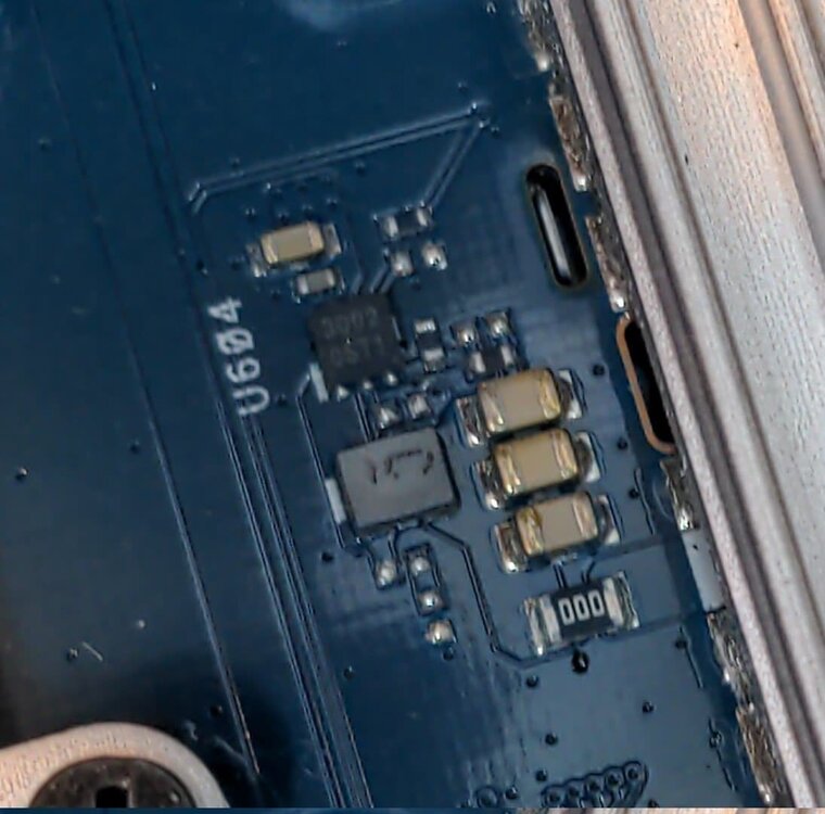

    Hi Can anyone help identify this component pls
    The Asus RT-AX88U router is dead & fault finding brings it to a DC to DC convertor. 3.3v goes in, but nothing comes out. The IC is marked "3002 0ST1"
    There is a 2nd working small IC marked "3001 0gt1" that converts 3.3v to 1.8v, both power separate CPu's on the board.
    I have also searched for a schematic for it, to no avail.

    Check the if the output is shorted to gnd via the caps too.

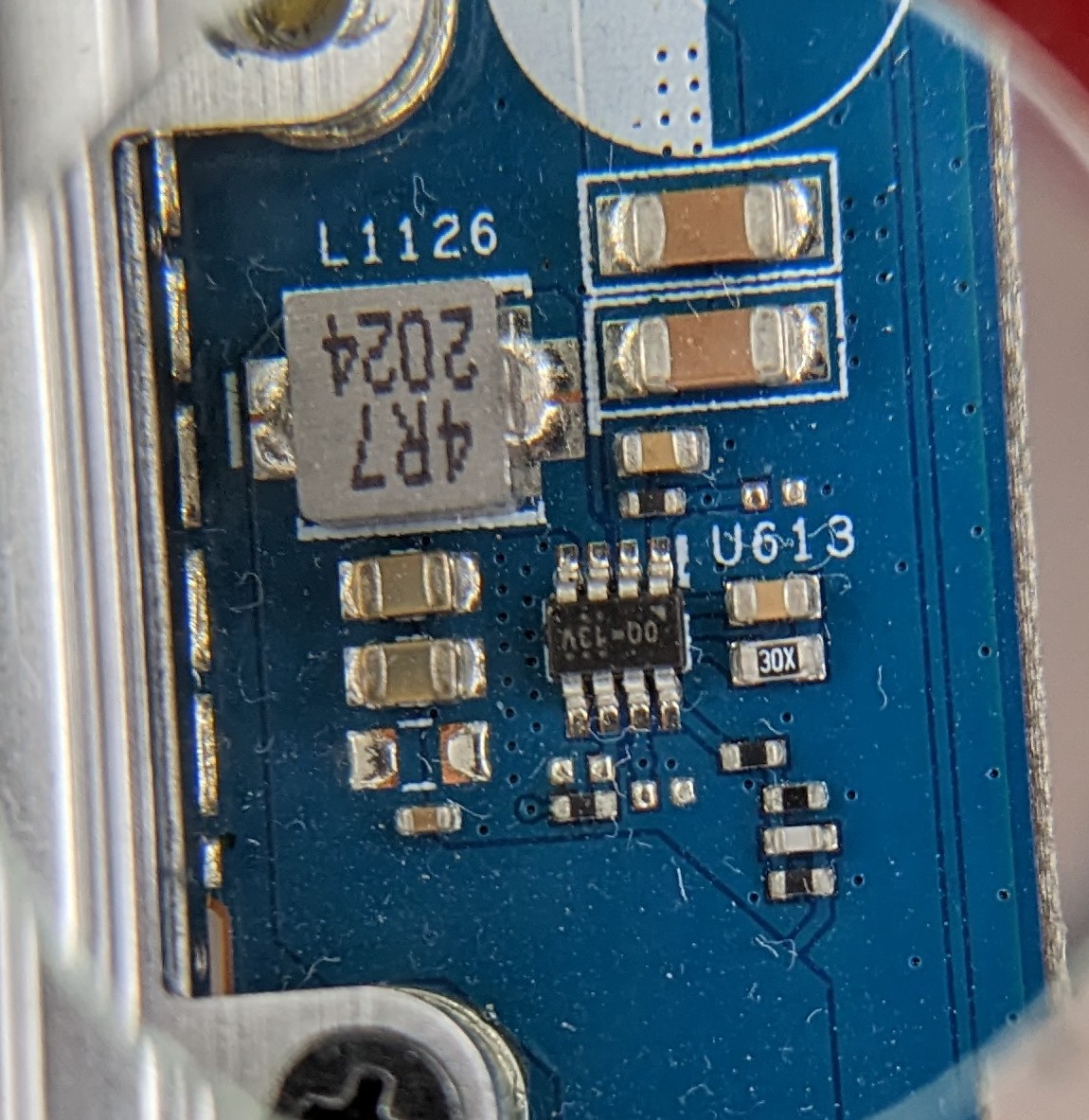

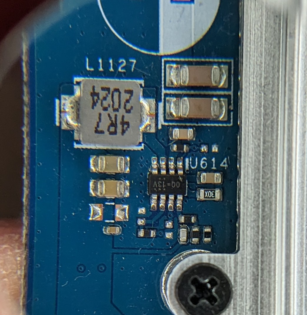

        I'm trying to repair the same model but in my case it appears to be a different fault...
        https://www.badcaps.net/forum/showthread.php?t=113203
        Would someone with the same router be so kind as to help me identifying U613 ? I'd like to confirm whether U613 is the same as U614 on the PCB or not.
        If I can resurrect that thing I'll definitely keep you posted.
        Cheers,
        Michael
        • waveslinger
          • Dec 2022
          • 2
          Re: ASUS RT-AX88U router DEAD
          Hi Michael,
          On my board, U613 and U614 are both 0Q=13V
          Thanks,
          Martin

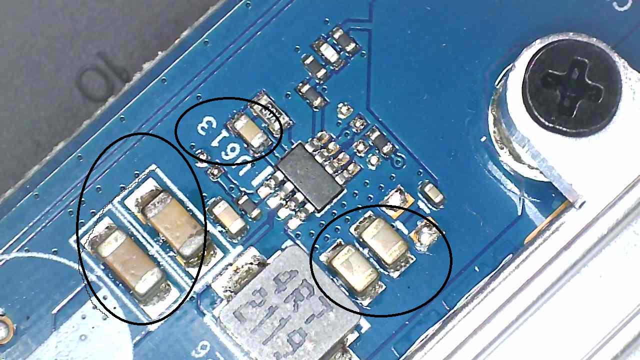

              • matusalens
                • Mar 2023
                • Brasil
                Hi I have one RT-AX88U Dead, but in my case is caps of L1126 area, after remove 5 caps and test with energy power, my router come back to life.
                Someone can please tell me caps specs??
                  Hi there to all,
                  In my case, a cap on the L1126 area was clearly cracked. Router was dead, apparently the power supply was shorted. I removed it and router came back to life. Unfortunately I don't have the specs but I'm planning to replace it with a 4.7uF 50V 1206 X7R. Since I could see many other caps in parallel and the router already works without it, I can only guess it's not that critical. I will post my results.
