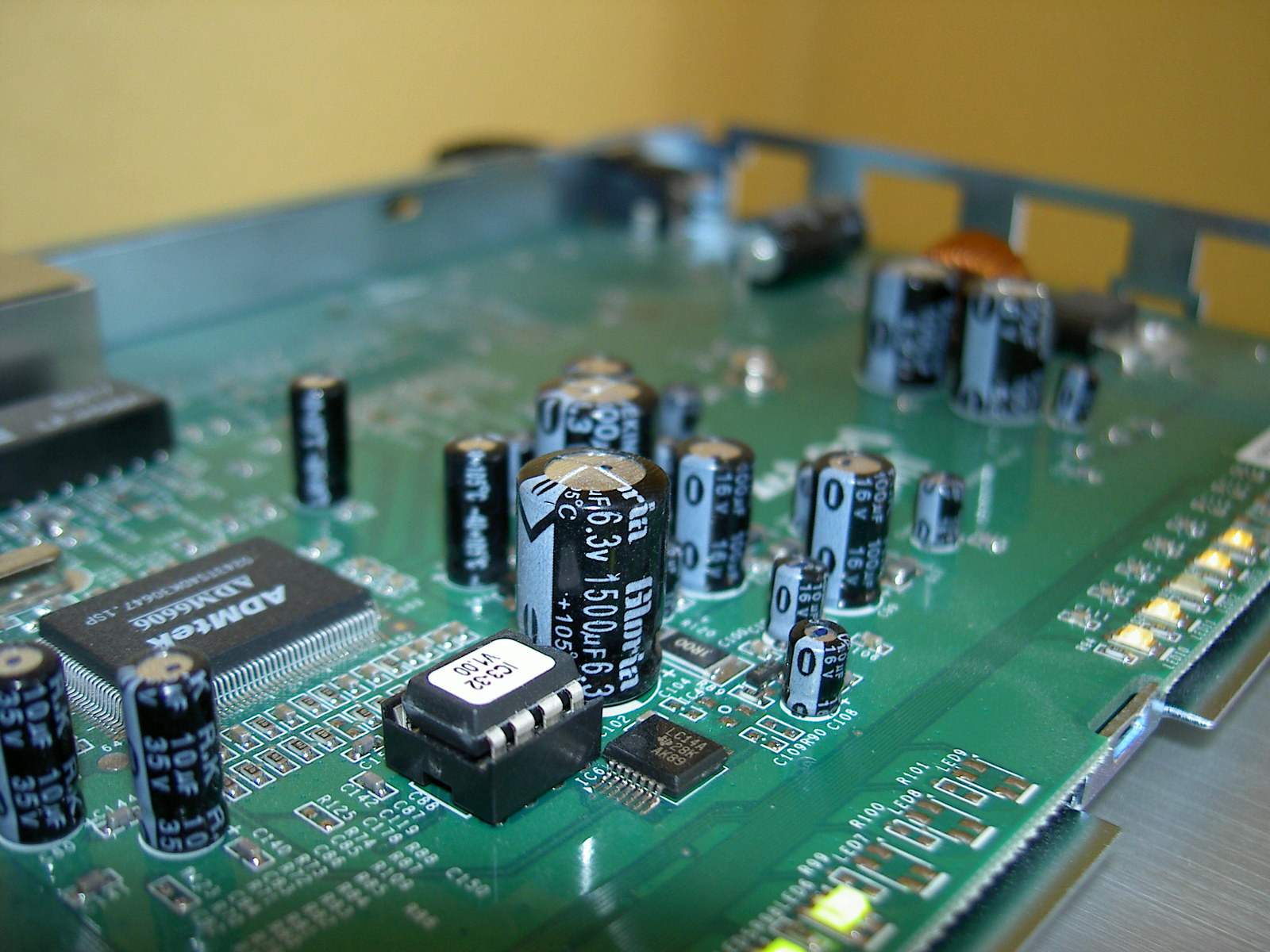

    A simple 5 port switch from 3COM, has these cap brands in it:
    Rifeking
    R.K
    Gloria
    Canicon
    There is only one Glora cap in it and guess what; it is bulging... (Good thing the rest is of so good-name brand )
    As can be seen on the pic it's a 6,3v 1500uF part

    you got 4 majors there, one bulging, one near the bulger, 2 near the coils and what is that near the power cable socket? if they are 1000uf and above best replace them all. 3com was using crap in their officeconnect.
    is the unit making a fizzing sound?

      Re: 3COM OfficeConnect Dual Speed Switch 5 plus
      The one right behind the bulging cap is a Rifeking, the two near the coil are also Rifeking, all are 1000uF 6,3v
      The one at the very back is a Axial Canicon 470uF 35v cap
      Since these are of different brands than the one that actualy is bulging I'm gonna hold off swapping them out, I'm also gonna check if this bugger has more than 1 year warranty before mocking with it
      The unit was making a high-pitched noise but it was the coil that was making it, they did not put any glue on it so that was the reason...

        rifeking and canicon are also crap. if the unit's warranty is out, I'd suggest you recap it, willawake has done so successfully. Don't bother replacing anything under 470uF.

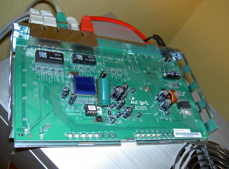

                  Thought I'd update this thread with how the Switch works now 8 months later...
                  Still no more bulging caps... Added a heatsink to the ADM6606 chip because it became burning hot...
                  Put hot glue on coil to silence the coil-noise it produced...
                  All in all I am very satisfied with the switch, I wished I had bought the 8-port version though...
                  EDIT; hmm, looking at those empty solderpads makes me wanna do a fun project; add the 3 missing RJ45 ports... I want to see a picture from the inside of a 3com OfficeConnect Dual Speed Switch 8 plus first though; it might use a different firmware and/or different ADMtek switch chip...
                  It would be fun to do some SMD component soldering...
