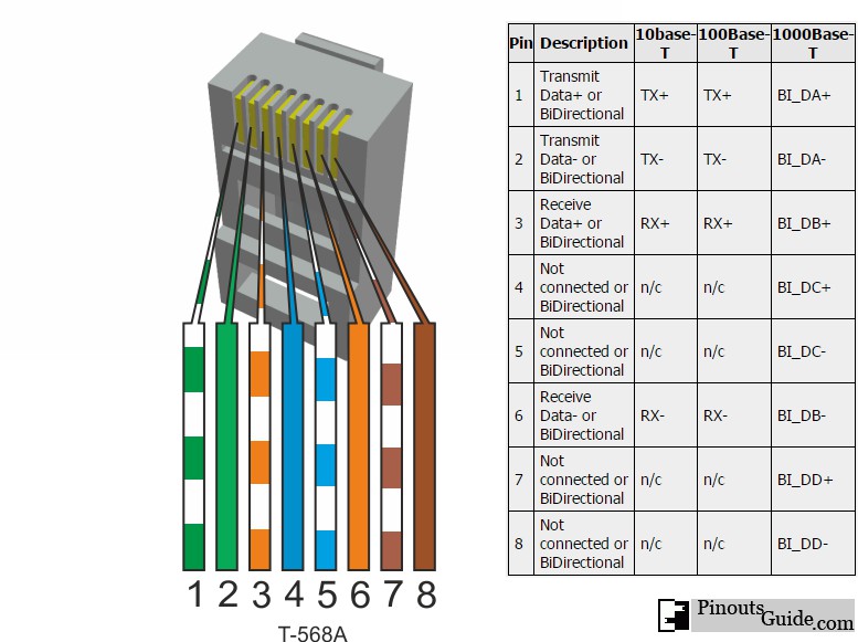

          I've uploaded a picture. Pins 4, 5, 7, and 8 don't actually have signals going through them, right? Those are the ones they use to twist around pins 1, 2, 3 and 6, right? If they're not grounded, how do they prevent the interference? Thanks!

                    Only 2 pairs are used for 100-Base-TX (100Mbps). All 4 pairs are used for 1000-Base-T (gigabit), and for 100Mbps with POE. Install all 4 pairs using the appropriate standard EIA/TIA-568A or 568B (your choice, but one building should only be wired one way).
                        Are you sure the other wires aren't being used? I don't necessarily mean for data. I'm trying to understand how they prevent interference and if differential signaling is being used, it'd make sense to me, but that would mean those wires are being used, right? If they're not being used at all....how do they prevent interference, with 100-base-TX?

                          Uniballer, nevermind, I think I see where I was going wrong. Differential signaling is used, but only on the two pairs, for 100-base-TX. We use T568B in this house. So, white orange and orange will carry a differential signal, then white green and green will carry a differential signal. Blue and white blue won't be used, and brown and white brown won't be used. At least with 100-base-TX.
                            10 and 100 Mbps ethernet over twisted pair only use two differential pairs: one pair for transmit and one pair for receive. Some early installations used the other pairs for telephone signals, or a second ethernet connection, but this was deprecated a long time ago. Gigabit ethernet uses all 4 pairs for signaling. PoE can be carried on the pairs that 10 and 100 Mbps do not use, but on gigabit the power can be on any/all of the pairs carrying signal.
