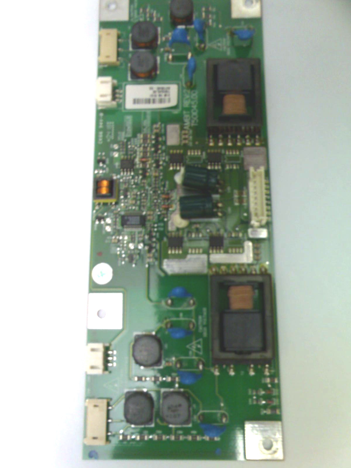

    Pls, help me for Ambit T501045.00
    My Dell W1700 is dead again. Ihave buy from Lcdpart a new backlight inverter, but after 15 days is dead also. So i resend for exchange. At today my wonderful screen is blank. How i can for repair the original backlight inverter? It have two Teapo caps 220uf 25V 105°. I attach a pic of inverter failure. Hope in your help....

    I think you should make sure the capacitors, when replacing them, will be following type:
    PPS (Poly Phenelene Sulfide).
    In general they offer a higher temperature range, and can deliver a higher current.

      I have found broken Q80 2 Fused and two condensers c80-c43
      is q80 a 4600 what it is? a MOSFET?

        where I can purchase on Internet the four HEXFETs 4600 of the inverter Ambit T501045.00
        Can I replace them with equivalent?

            I got some at Mouser electronics www.mouser.com I don't remember how I got the cross ref. but I ended up with part #512-FDS8958A . I am not 100% sure this is correct as I still am trying to figure out why it blew the new 80 cent apiece fuses as soon as I hooked it to power.I have two of these boards on my desk and I replaced both caps and fuses on both Found 2 shorted Mosfets changed all four(man that was tough) I still have two piece of s--t for inverters. But my soldering skills are getting better I only have two 2nd degree burn blisters on my hand now. Good Luck!

                I have no hair on my head or I would have pulled it all out trying to figure out WHY the fuses blow on these two inverter boards I have here,when everything I check against a working board appears to be good to go.
                I guess I am going to bite the bullet and cut my loss and buy 2 new inverters. This is one severely over engineered piece of s--t and I'll just bet I am not alone in my thinking.
                I have read all the posts on here and no one really says why (other than the bad caps) ,that there is any other reason it craps out.
                The one thing I have learned about electronics is ,if you change all the stuff that checks out bad ,there is some other little part hiding on the board somewhere laughing it's ass off watching you go crazy trying to find it,I am almost there,crazy that is.
                I usually am not a quitter but I have about had enough of looking at this trying to figure what is common to both sides of this inverter that connects them both together that could blow both fuses at the same time.

                    well dont know about those inverters but the transformers have been known to go.
                    I do remember a discussion (don't think it on these forums) about this
                    it was advise to put new ones in as well...(like if you can find them)
                    (in one model inverter)
                    If fuses are popping then it obviously too much current being drawn this means a fault is still there ..the question is why
                    and no I DO NOT recommend what you are suggesting.
