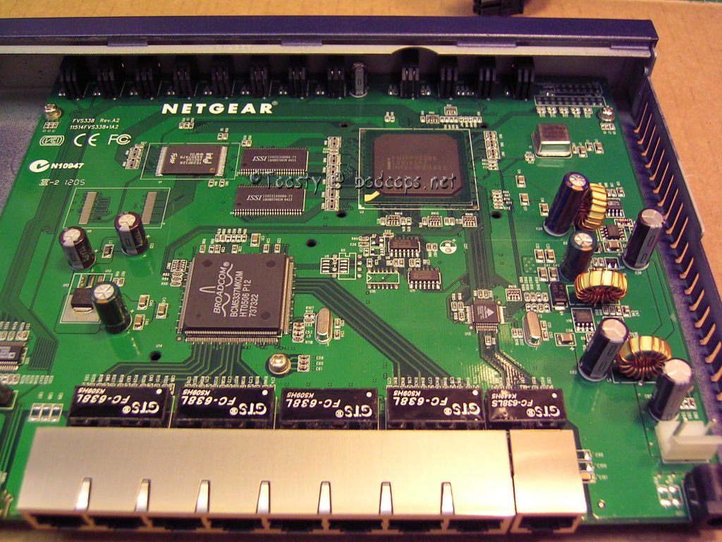

    Device is incoming to shop. Had to leave it in place as it is partially working and they need to close out the days business.
    Customer complaint of dropped internet connections and "stuttering" connections. On-off-on-off, partial page loads, IM that drops and then comes back, etc.
    Visual inspection thru vent slots revealed 1 domed cap in power supply section.
    Pictures and cap list to follow when it lands.

    Update:
    Unit was completely recapped and back in customer's hands this AM.
    Went this afternoon to verify operation and upgrade the router firmware. Perfect!
    It also resolved 2 issues. One was a connection to a website (banking) and the other was the use of the registered version of Malwarebytes'. They could never get into the online portion of the bank site from the website home page and had to use a direct link to the page. Malwarebytes' would always hang the system and would only run the free version.

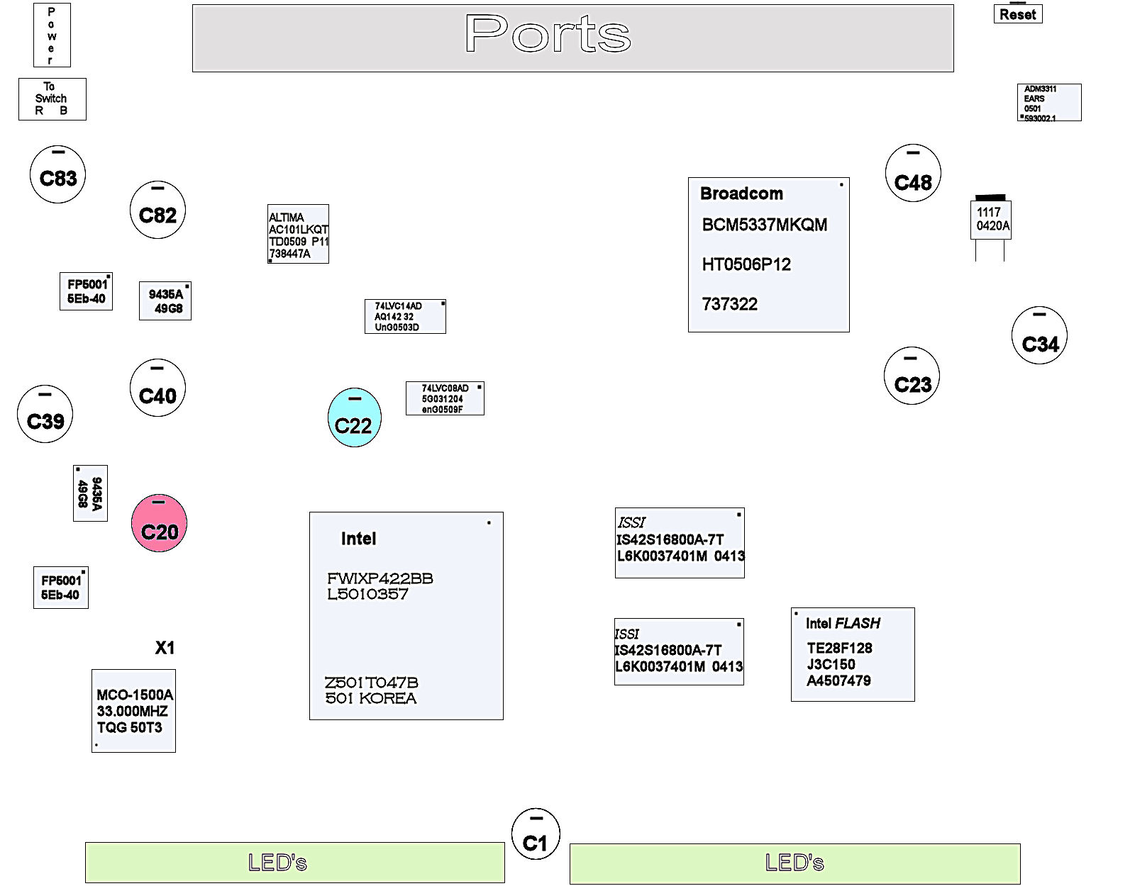

      Board Layout
      First image attached is full size 1600x1250. Second is reduced 880x688.

        Original caps were Teapo and UCC.
        Note disparity between C23 & C34 ESR.
        Last column indicates the replacement series used from Nichicon and Panasonic.
        Code:
        C1  - 100/25 - SEK - 6.3 x 12 - 0.45 >> KMG
        C20* - 1000/16 - SZ -  8 x 21 - 0.02 >> HM
        C23 - 470/16 - SEK -  8 x 12 - 0.02 >> HN
        C34 - 470/16 - SEK -  8 x 12 - 0.11 >> HN
        C39 - 470/25 - KY -  8 x 18 - 0.03 >> FM
        C40 - 470/16 - SC -  8 x 15 - 0.02 >> HN
        C48 - 470/16 - SC -  8 x 15 - 0.02 >> HN
        C82 - 470/25 - KY -  8 x 18 - 0.03 >> FM
        C83 - 470/25 - KY -  8 x 18 - 0.05 >> FM
        * Domed cap. ESR was in spec. Capacitance was 170uF. Read as shorted on leakage test.
        C27 - No cap installed from factory. Measured as 1.5v and traced line to Intel CPU chip. Installed 560uF/4v SEPC Poly.

          Re: Netgear FVS338 ProSafe VPN Firewall w/ 8 port 10/100 Switch
          Looks like it was well worth saving. Slightly OT, but how you determine what caps to put in the blank spots? Measuring the voltage across I can understand. But after determining that this one went to the CPU, how did you decide that it should be a 560uF poly?

            Lowest capacitance in poly I had at the time. Never hurts to kill any ripple on a CPU power line. It's more about ESR than capacitance anyway.
            This was an overnight job (received at 12 midnight) and had to be back in customer's hands by 8 AM that morning. No time to order in say a 120uF which may have been more appropriate.
            ** Correction to Post 4. Cap that was poly'd was C22 not C27 which doesn't exist. **
