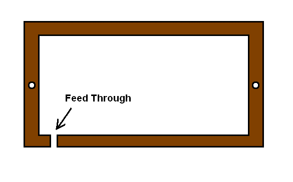

        I have run through vent ducts before by cutting the pictured spacer out of 3/8"-1/2" plywood.
        Remove the vent grill.
        Run cable.
        Install grill with spacer under it [and cable through the gap] using longer screws.

              I'm already wired for gigabit. There's a 16 port that chills out with the modem and router and another 8 port gigabit switch in my room.
              Can't really do stuff in the vents. There are tennants downstairs and if the city housing inspectors see that, we are liable for a crap ton of fines (you are not allowed to run cables through vents as they pose a fire/smoke hazard, regardless of what they are carrying). We also can't go downstairs.
              Also, I'm really iffy about nailing or screwing stuff into the walls as the landlord is still on edge after spending thousands to repair the place the last time.

                Obviously I haven't seen the layout so I dunno what downstairs has to do with it.
                I'll press the "I believe" button on that one..
                Well that's just stupid. - Whoever made that law/rule is a moron.
                Aren't running power, they aren't going to cause a fire.
                If they going to smoke it's because the place is burning down -from something- else and they're going to smoke no matter where they are.
                In fact if anything being in the vent duct would delay that from happening...

                    I figured inspections would be a problem. You can still run them just as long as you keep a label around from the box or a receipt to show proof that you bought plenum utp cables.
                    It's better not to run them and save you and your landlord a ton of fines.

                                  It's not that it can cause a fire, it's that if it burns IN a fire, and it's not plenum-rated cable, it can give off very toxic gas.
                                  And can actually spread a fire that would otherwise be isolated by non-combustible material.
                                  We have to use plenum-rated cable for runs in the drop ceilings of office buildings, because the space above the ceiling tiles is considered a plenum.
                                  That said, I have a few runs of cat 6 in my cold air return. (plenum rated, but might still be against code)
