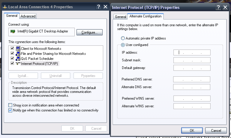

    You can set one wirless device to have two static IPs... I haven't tried a static/dynamic combination...but see if this works...
    From the Network Connections window, right click your network connection, and select properties. Highlight Internet Protocol TCP/IP in the list, and click the properties button. Leave the General tab as dynamic. On the Alternate Configuration tab, enter your static IP info.
    If you have an Intel wifi card, download the Intel Proset software. It has many more options than the Windows zero configuration utility.
    If that doesn't work, My suggestion would be to automate it using a .bat or .cmd file.
    A combination of netsh and ipconfig commands should do everything you want...look up the parameters or run them with /? Make two batch files, one to configure it for static mode, and one to return it to dynamic mode. At least that way, once you figure out the commands, you can get it down to one click.
