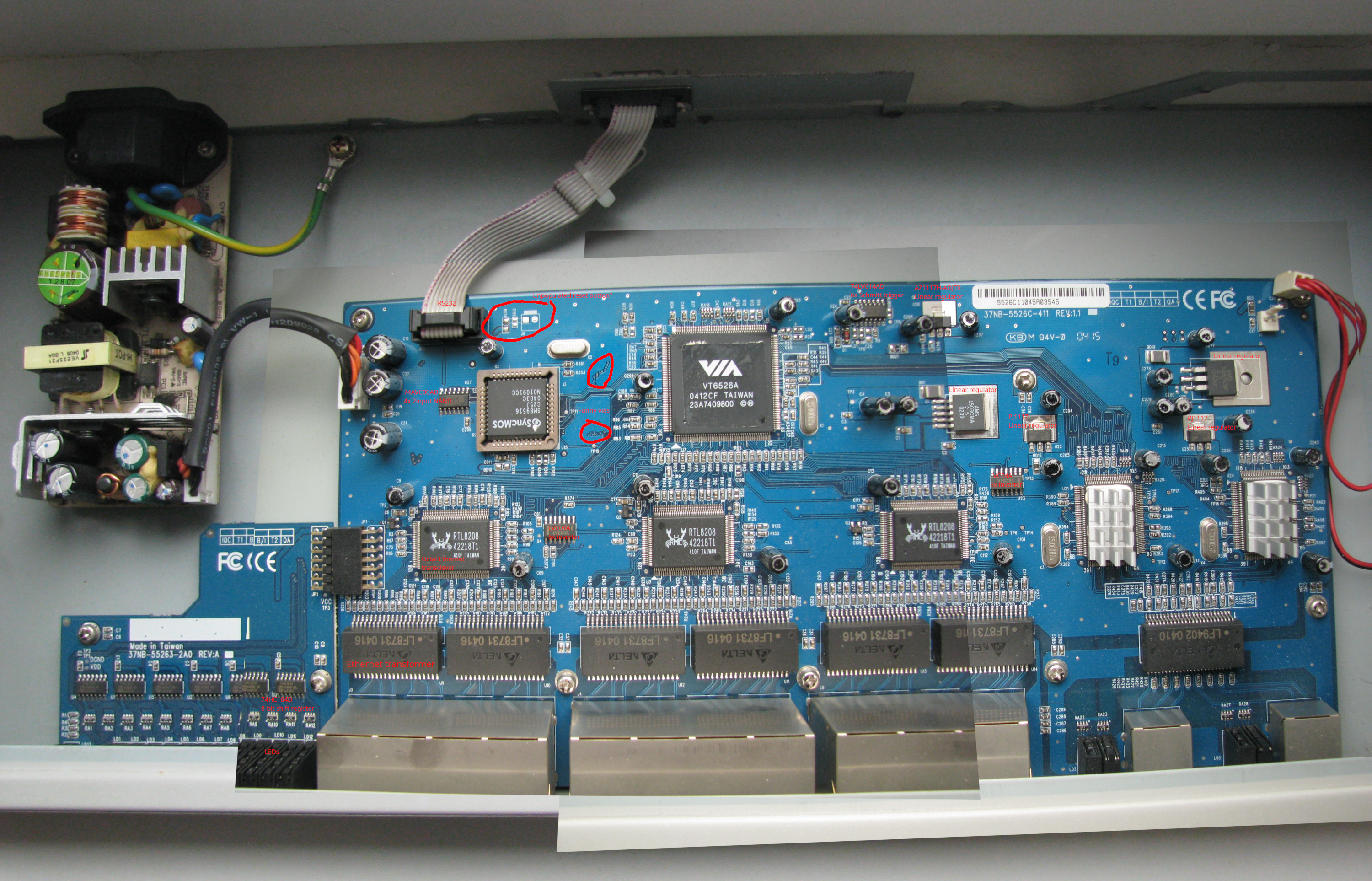

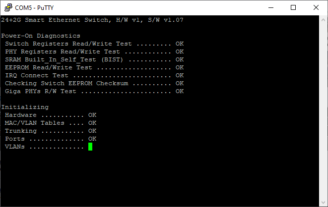

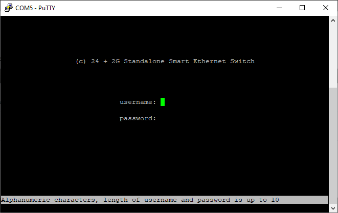

    So I have a Repotec RP-G3224V that a friend recently gave me so I can try to sell it or reuse in other way (can always disassemble for parts, but that's the last option). He bought it used online in "as is" condition many years ago. I tested the connectivity between the ports and found some configured isolated groups (see port isolation map.png). I want to reset this configuration so all are connected together, however there is no reset button anywhere and the credentials for admin access over RS232 console are not "admin / admin" or "admin / 123...". I considered brute forcing my way in but one username and password test takes about 300 ms (in a little program I made in Go) and the password could be using the whole 10 characters of abcABC123 charset (as seen on the bottom of prompt.png) so it could take absurd amounts of time (>1 000 000 years). Maybe the EEPROM could be read to find the credentials or wiped manually and that's why I came here.
    Possible solutions:
    1. EEPROM reset?
      Where could the EEPROM be? In the 64KB flash of SyncMOS SM89516? It's an MCU with flash used for program storage. How to avoid wiping the program? Why would the manufacturer put it in a socket? Should I worry about the EEPROM checksum (mentioned during initialization, see init.png)?
    2. Unpopulated reset button?
      What could the unpopulated J6 near console cable connector be used for? Couldn't this be the reset button connector? I tried shorting the appropriate BD14 pad (ferrite BeaD, which the J6 is connected through) to ground, it made a tiny spark and then supplied about 20mA. Didn't accomplish anything.
    3. Decrypt communication between MCU and EEPROM to find password?
    The VIA VT6526A is an Ethernet Switch Controller, very difficult to find info on, no datasheet, only this: https://hexus.net/tech/items/network...ch-controller/
    The SyncMOS SM89516 datasheet: https://cdn.badcaps-static.com/pdfs/...9d89632815.pdf
    You cannot find info on this model on Repotec website (anymore?) and only a handful of other results online. But I found another device that uses the same board by the name of "Eusso UGS5224-RS ", see http://www.eusso.com/Models/Gigabit/...UGS5224-RS.htm. However, the manual doesn't mention any way to reset it without admin access. It uses the same board based on this Ebay listing: https://www.ebay.com/itm/193040957052
    I know this doesn't make financial sense because the device is from like 2004 and is of medium quality (?), but I don't care about money because it's sort of a challenge and a learning experience.
    For reserve engineering the board, I took photos and annotated most ICs on the board, see collage.jpg.
    Any other ideas? What makes the most sense here besides scrapping it?

        I have tried these right now and failed:
        • admin admin
        • admin 123, 1234, ... 123456789
        • guest guest
        • guest 123, 1234, ... 123456789
        • blank blank
        • blank 123, 1234, ... 123456789
        • root root
        • root 123, 1234, ... 123456789

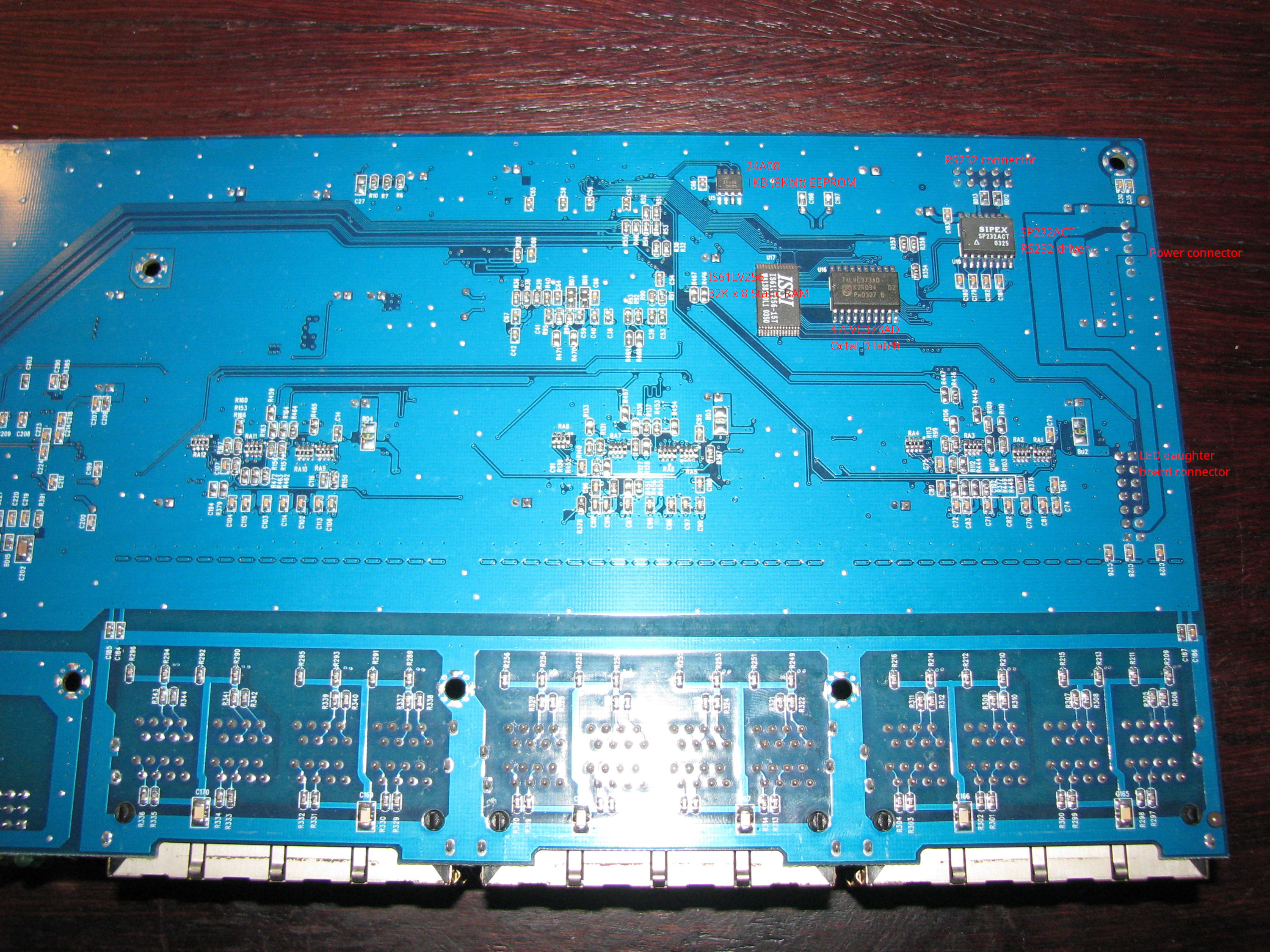

        is the other side of the board empty?
        Haven't thought about that for some reason.
        The bottom reveals:
        • 24A08, 1KB I2C EEPROM:
        • SP232ACT, RS232 driver:
        • 47LVC373AD, Octal D latch
        • IS61LV256 32K x 8 Static RAM:
        • The funny vias lead to traces on the bottom side, but don't lead anywhere on the top so the board must be more than 2 layers, interesting.
        The discovery of a little SOP8 EEPROM is good news. So the config is stored in this? 1KB seems like enough, the username and password needs about 20B (ASCII char encoded to 1 byte, 10 characters, twice). How certain can I be this contains the config and that wiping it will not break the switch? Will the credentials return to defaults (probably "admin admin") when I write zeros to the EEPROM?

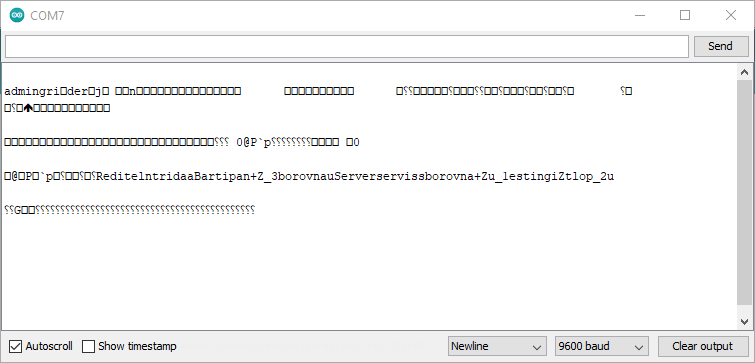

                So I desoldered the EEPROM using a heatgun and I am trying to read it using Arduino UNO according to a video guide, but I chose to pull the write protection (WP) pin high to avoid overwriting any data inside it. I based my code on the one in this guide: https://www.instructables.com/Readin...-Using-/#step5.
                This was my initial Arduino code (similar to C):
                Code:
                #include <Wire.h>
                #define EEPROM1 0b1010000 //defines the base address of the EEPROM
                void setup() {
                 Wire.begin(); //creates a Wire object
                 Serial.begin(9600);
                 Serial.println();
                 unsigned int address = 0; //first address of the EEPROM
                 for (address = 0; address < 1024; address++) {
                  byte d = read(address);
                  Serial.print(d, HEX);
                  Serial.print(" ");
                 Serial.println();
                void loop() {}
                byte read(unsigned int address) {
                 byte data = 0xFF;
                 Wire.beginTransmission(EEPROM1);
                 Wire.write((int)(address >> 8));   //writes the MSB
                 Wire.write((int)(address & 0xFF));  //writes the LSB
                 Wire.endTransmission();
                 Wire.requestFrom(EEPROM1, 1);
                 if (Wire.available())
                  data = Wire.read();
                 return data;
                Which gave me output like this:
                Code:
                0 0 0 0 0 0 0 0 0 0 0 0 0 0 0 0 0 0 0 0 0 0 0 0 0 0 0 0 0 0 0 0 0 0 0 0 0 0 0 0 0 0 0 0 0 0 0 0 0 0 0 0 0 0 0 0 0 0 0 0 0 0 0 0 0 0 0 0 0 0 0 0 0 0 0 0 0 0 0 0 0 0 0 0 0 0 0 0 0 0 0 0 0 0 0 0 0 0 0 0 0 0 0 0 0 0 0 0 0 0 0 0 0 0 0 0 0 0 0 0 0 0 0 0 0 0 0 0 0 0 0 0 0 0 0 0 0 0 0 0 0 0 0 0 0 0 0 0 0 0 0 0 0 0 0 0 0 0 0 0 0 0 0 0 0 0 0 0 0 0 0 0 0 0 0 0 0 0 0 0 0 0 0 0 0 0 0 0 0 0 0 0 0 0 0 0 0 0 0 0 0 0 0 0 0 0 0 0 0 0 0 0 0 0 0 0 0 0 0 0 0 0 0 0 0 0 0 0 0 0 0 0 0 0 0 0 0 0 0 0 0 0 0 0 0 0 0 0 0 0 0 0 0 0 0 0 61 61 61 61 61 61 61 61 61 61 61 61 61 61 61 61 61 61 61 61 61 61 61 61 61 61 61 61 61 61 61 61 61 61 61 61 61 61 61 61 61 61 61 61 61 61 61 61 61 61 61 61 61 61 61 61 61 61 61 61 61 61 61 61 61 61 61 61 61 61 61 61 61 61 61 61 61 61 61 61 61 61 61 61 61 61 61 61 61 61 61 61 61 61 61 61 61 61 61 61 61 61 61 61 61 61 61 61 61 61 61 61 61 61 61 61 61 61 61 61 61 61 61 61 61 61 61 61 61 61 61 61 61 61 61 61 61 61 61 61 61 61 61 61 61 61 61 61 61 61 61 61 61 61 61 61 61 61 61 61 61 61 61 61 61 61 61 61 61 61 61 61 61 61 61 61 61 61 61 61 61 61 61 61 61 61 61 61 61 61 61 61 61 61 61 61 61 61 61 61 61 61 61 61 61 61 61 61 61 61 61 61 61 61 61 61 61 61 61 61 61 61 61 61 61 61 61 61 61 61 61 61 61 61 61 61 61 61 61 61 61 61 61 61 61 61 61 61 61 61 61 61 61 61 61 61 64 64 64 64 64 64 64 64 64 64 64 64 64 64 64 64 64 64 64 64 64 64 64 64 64 64 64 64 64 64 64 64 64 64 64 64 64 64 64 64 64 64 64 64 64 64 64 64 64 64 64 64 64 64 64 64 64 64 64 64 64 64 64 64 64 64 64 64 64 64 64 64 64 64 64 64 64 64 64 64 64 64 64 64 64 64 64 64 64 64 64 64 64 64 64 64 64 64 64 64 64 64 64 64 64 64 64 64 64 64 64 64 64 64 64 64 64 64 64 64 64 64 64 64 64 64 64 64 64 64 64 64 64 64 64 64 64 64 64 64 64 64 64 64 64 64 64 64 64 64 64 64 64 64 64 64 64 64 64 64 64 64 64 64 64 64 64 64 64 64 64 64 64 64 64 64 64 64 64 64 64 64 64 64 64 64 64 64 64 64 64 64 64 64 64 64 64 64 64 64 64 64 64 64 64 64 64 64 64 64 64 64 64 64 64 64 64 64 64 64 64 64 64 64 64 64 64 64 64 64 64 64 64 64 64 64 64 64 64 64 64 64 64 64 64 64 64 64 64 64 64 64 64 64 64 64 6D 6D 6D 6D 6D 6D 6D 6D 6D 6D 6D 6D 6D 6D 6D 6D 6D 6D 6D 6D 6D 6D 6D 6D 6D 6D 6D 6D 6D 6D 6D 6D 6D 6D 6D 6D 6D 6D 6D 6D 6D 6D 6D 6D 6D 6D 6D 6D 6D 6D 6D 6D 6D 6D 6D 6D 6D 6D 6D 6D 6D 6D 6D 6D 6D 6D 6D 6D 6D 6D 6D 6D 6D 6D 6D 6D 6D 6D 6D 6D 6D 6D 6D 6D 6D 6D 6D 6D 6D 6D 6D 6D 6D 6D 6D 6D 6D 6D 6D 6D 6D 6D 6D 6D 6D 6D 6D 6D 6D 6D 6D 6D 6D 6D 6D 6D 6D 6D 6D 6D 6D 6D 6D 6D 6D 6D 6D 6D 6D 6D 6D 6D 6D 6D 6D 6D 6D 6D 6D 6D 6D 6D 6D 6D 6D 6D 6D 6D 6D 6D 6D 6D 6D 6D 6D 6D 6D 6D 6D 6D 6D 6D 6D 6D 6D 6D 6D 6D 6D 6D 6D 6D 6D 6D 6D 6D 6D 6D 6D 6D 6D 6D 6D 6D 6D 6D 6D 6D 6D 6D 6D 6D 6D 6D 6D 6D 6D 6D 6D 6D 6D 6D 6D 6D 6D 6D 6D 6D 6D 6D 6D 6D 6D 6D 6D 6D 6D 6D 6D 6D 6D 6D 6D 6D 6D 6D 6D 6D 6D 6D 6D 6D 6D 6D 6D 6D 6D 6D 6D 6D 6D 6D 6D 6D 6D 6D 6D 6D 6D 6D 6D 6D 6D 6D 6D 6D
                Odd, it's not much data and the bytes are repeated many times. Actually, exactly 255 times.
                I chose to read first 1024 bytes because that's the capacity of the memory, right? 24A08 means 8Kbit means 1KByte means 1024 bytes but this data is not useful. I have never worked with EEPROM ICs, is this normal?
                So I tried jumping by 255 blocks, increased the end address to some large number and converted the bytes to ASCII chars in code:
                Code:
                #include <Wire.h>
                void setup() {
                 Serial.begin(9600);
                 Serial.println();
                 for (address = 0; address < 65535; address+=255) {
                  Serial.print(char(d));
                 Serial.println();
                void loop() {}
                 byte data = 0xFF;
                  data = Wire.read();
                 return data;
                Since the EEPROM acts as 4 2K memories with different I2C addresses, I read all of them by changing the EEPROM1 constant to 0b1010001, ...10 and ...11.
                The output:
                And there seems to be the password, or pieces of it. If anything, it's going to be much easier to brute force the password now.
                Also, there seems to be some names of the "islands" configured. It's in my native language and suggests a school environment.
                I cannot copy the text, because the unprintable characters are cutting the pasted text early or something.
                I think I can make it on my own now so thanks to everyone involved.
                Any ideas why I have to skip over 255 bytes all the time? Why I have to reach the limit of Arduino two byte unsigned integer (65535) to read everything?
                EDIT: Is it possible the EEPROM is getting corrupted? "gri?der?j? ??n" doesn't seem like a password to me. I have read that EEPROMs hold data for about 10 years at room temperature, less at elevated temperature. This device is almost 20 years old and it was running at possibly elevated temperatures as a rack switch with fans, heatsinks and 10 W power usage.

                    This is how it looks like in decimal+decoded character:
                    Code:
                    0 0 97a 100d 109m 105i 110n 0 0 0 0 0 0 103g 114r 105i 1? 100d 101e 114r 0 0 0 0 2? 106j 24? 127<space> 0 4? 0 4? 110n
                    Here it is in hex only:
                    Code:
                    0 0 61 64 6D 69 6E 0 0 0 0 0 0 67 72 69 1 64 65 72 0 0 0 0 2 6A 18 7F 0 4 0 4 6E
                    The character is 1 in decimal so that's definitely invalid and untypable on the keyboard. I'd say that's the reason the original owner got rid of it, they couldn't get inside it anymore.
                    Clearly, the password ends before the "j" and "n", since it's limited to 10 characters and that's set to zeros.
                    At this point I'd want to write to the EEPROM and make it "grinder", but I am unsure about the weird addressing thing. I could write just a single byte and see if all 255 bytes change. If not, I could set all 255 bytes to "n". Any chance this has a CRC somewhere? I doubt it because it should be failing by now.

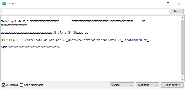

                      Just found out why I was getting the byte repeated 255 times. It's because this EEPROM uses only one byte for the address, specifically the first one you send, which was the MSB. So it read the same address until LSB counted to 255, then moved to the next one.
                      Incrementing by 1 now works fine. Since it's basically 4 2Kbit memories each addressed individually, the stop address should be 256 which indeed reads all the data.
                      This is the updated code:
                      Code:
                      #include <Wire.h>
                      void setup() {
                       Serial.begin(9600);
                       Serial.println();
                       for (address = 0; address < 256; address+=1) {
                       Serial.println();
                      void loop() {}
                       byte data = 0xFF;
                        data = Wire.read();
                       return data;
                      Line
                      Code:
                      had to be removed.
                      This also fixed the values of some characters for some reason and the password indeed is "grinder". The "island" names are more readable now too, there is one named "testing", nice.

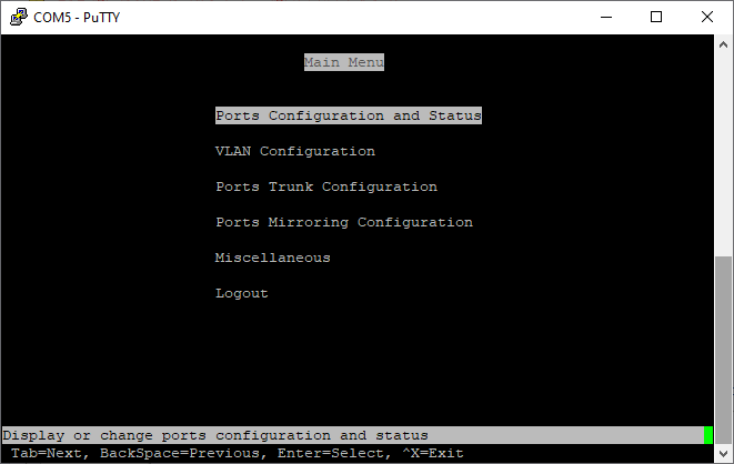

                      I will solder the chip back on and try the password. It should work.
                      As cool as the story of this being sold because of EEPROM corruption would be, it's obviously not the case.
                      • mik13ST
                        • Mar 2023
                        • 8
                        • Czechia
                        Re: Resetting old Repotec/Eusso switch without RST button or admin access
                        Yep. Thanks stj.
