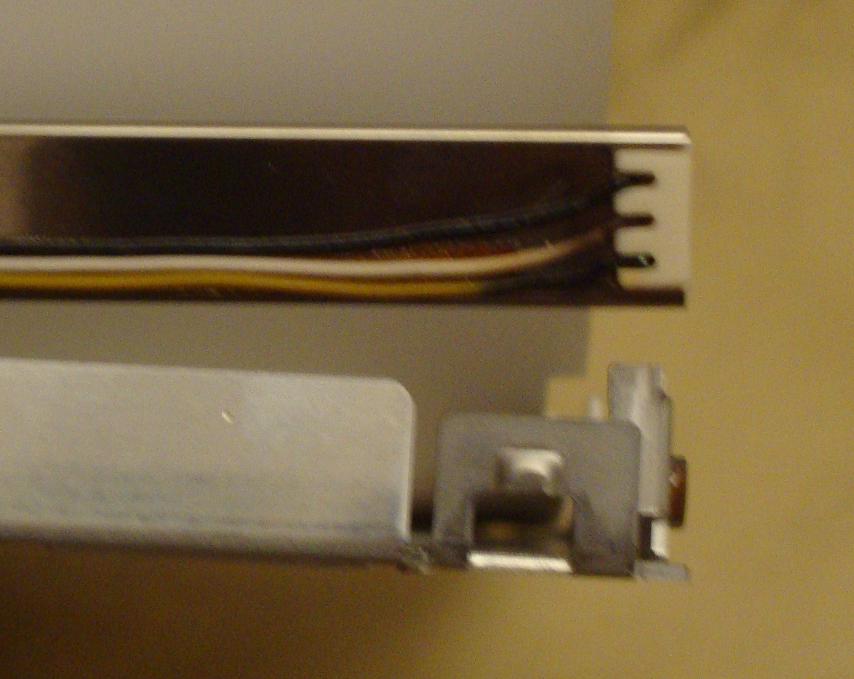

          Re: Samsung 215tw display cuts out
          I found this connection to the ccfl ! Sorry for the bad quality of the picture, it is 10.00 PM by me (no more sun)
          I suppose I just have to cut the burnt part and solder a new wire part ?
          What kind of wire do I have to get ?
          Thank you !
            Good questions!
            Is the wire completely burnt off the bulb?
            If not can you connect it all up and make sure the bulb lights.
            ( I am thinking that if the bulb doesnt light and you want to continue then you may as well buy a new bulb with cable fitted)
            Otherwise you will need to see how far you have to cut back to get to good insulation and wire.
            I dont know if there is anywhere near you where you can buy the wire.
            There is a lot of computer box modding and car modding with ccfls so you might have a computer shop or garage that might sell it.
            Alternatively there is Ebay - My French is not up to it and I dont even understand the selling types but this would probably give you enough wire
            depending on how bad any other cables are
            http://cgi.ebay.fr/A-C-Ryan-Twin-CCF...item4cfffefb1f
            You might be able to find better/cheaper alternatives
                  You dont need to reassemble to test as long as the cables reach the board.
                  That wire at ccflwarehouse is exactly what you need - I didnt know they sold it.
                  I dont know about the 3 wire set up & cant tell from your picture. Where do the three wires go to? - Is there more than one bulb in a cluster? May be two live and a common return?
                    #89
                    It looks like a 3 bulb set up, and looks like the picture shows the burnt out Return wire, which is the norm.A lot of Monitors use very poor quality wire,and if one is burnt, then I usually rewire them all,using KYNAR wire,and have done for a long while, and I find it is ideal.It is usually available on Ebay,in 5m lengths,and very reasonably priced.To secure the return wires to the outside of the Channel, I use some very narrow double sided tape, available from a Local Craft shop.

                        #91
                        Good luck with it.The good thing about Kynar, is that as it is single strand,you can actually wrap it around the contact on the Backlight,so you actually get a good mechanical joint, as well as the solder, and thats what all solder joints are supposed to be like...(many years in the Electronic manufacturing Industry),among others.
                          Unfortunately, it still doesn't work. I get the same symptoms, even after changing all burnt wires by new one (Kynar, so).
                          Any idea ? Maybe the light tubes are bad ? How can I test them, as I have no save tube at home...
                          Thank you !
                            Do the lamps have real blackened ends?
                            http://s807.photobucket.com/albums/y...klight%20lamp/
                            The other lamp assembly is OK?
                              Ouch. When it is - even a little bit - blackened, that means that the lamp is out of service ?
                              Then... I think the six (three up and three bottom) are dead !
                              Edit : I guess if one of the two assembly was OK, I would get an image on the screen... correct ?
                                #95
                                If any one of the six lamp is bad, the detection circuit will shutdown the inverter circuits to protect itself, when the the tube has blacken end (worn/burnt electrode), it will draw more current.
                                A touch of black should be OK, but if the black is about 1/4" or more, then that can be bad, it also depends on the circuit design to tolerate the over current trip point which is set by the inverter designer.
