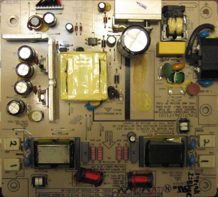

    Victim: Samsung Syncmaster 713n
    Symptoms: Monitor works great for a while and then loses signal or gives OOB error when resolution is correct.
    Solution: FSP Power supply has CrapXon capacitors.
    I need suggestions with what to replace them with:
    Caps (In order from highest to lowest):
    1) 450V/100uF "KM" Series
    2) 35V/330uF "KF" Series
    3) 25V/470uF "KF" Series
    4) 25V/470uF "GL" Series (2)
    5) 10V/1000uF "GL" Series
    Small Caps (Which I want to replace):
    1) 63V/10uF "KF" Series
    2) 50v/47uF "KF" Series
    3) 50v/4.7uF "KF" Series
    Your help is most appreciated.

    Follow the steps listed here. Make sure to compare height and diameter to the original. I wouldn't bother replacing the 450V 100uF cap.

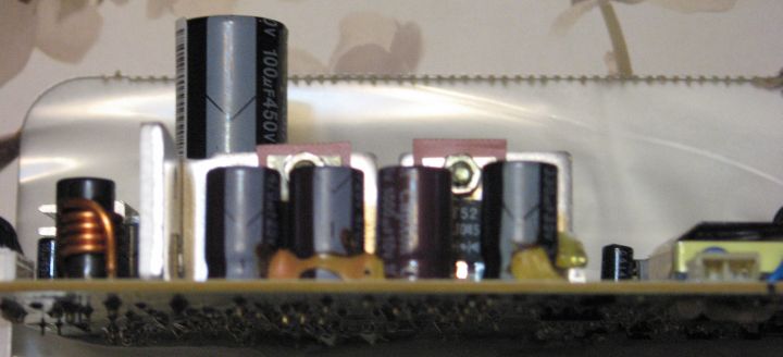

            Just an update:
            Per your advice Bill, I looked up the specs on these caps and referenced some things I thought might match. I'm lost on the ESR ratings, can you be of assistance with this?
            1) 450V/100uF "KM" Series - 18mm x 41mm Ripple = 560
            Panasonic HC
            Panasonic ED
            2) 35V/330uF "KF" Series - 10mm x 16mm Ripple = 1050 Impedance = 0.079
            Panasonic FC
            Nichicon PW
            3) 25V/470uF "KF" Series - 7mm x 16mm Ripple = ? Impedance = ? (A 10x16mm part is listed and its values are 1200 for ripple and 0.076 for impedance)
            Panasonic FC
            UCC KZE
            4) 25V/470uF "GL" Series (2) - 10mm x 16mm Ripple = 1040 Impedance = 0.065
            Panasonic FC
            UCC LXZ
            UCC LXY
            Nichicon PW
            5) 10V/1000uF "GL" Series - 10mm x 16mm Ripple = 1010 Impedance = 0.072
            Panasonic FC
            UCC LXZ
            UCC LXY
            Nichicon HE
            Nichicon PW
            Thanks very much for your help.

              Sorry to be a hard ass about this, but after wasting half an hour on this I'm going to go with my original opinion. CapXon's web site is now in other hands, datasheets are unavailable in a quick search, and the parts were crap to begin with.
              My first choice for the low voltage caps would be Panasonic FMs. If they are unavailable I would take Panasonic FCs, any of the other series you have listed are also good.
              IMHO, the exercise is a waste of time. The original caps started deteriorating the first time power was applied. By the time the warranty expired they no longer came close to specs, but the monitor kept working. ANY good quality part will outperform the original.

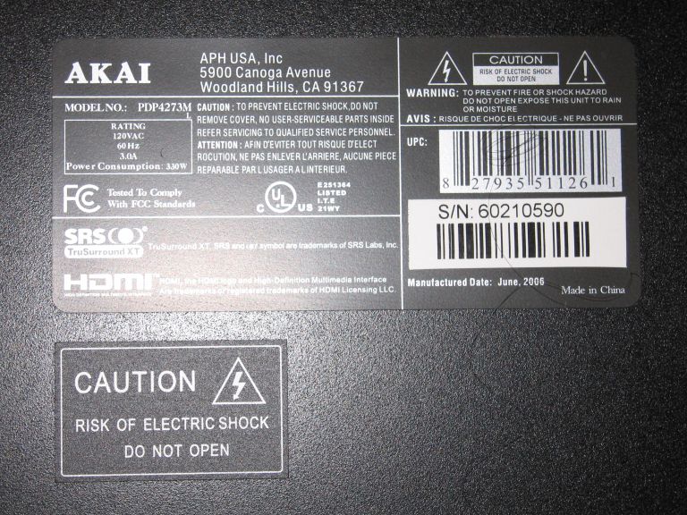

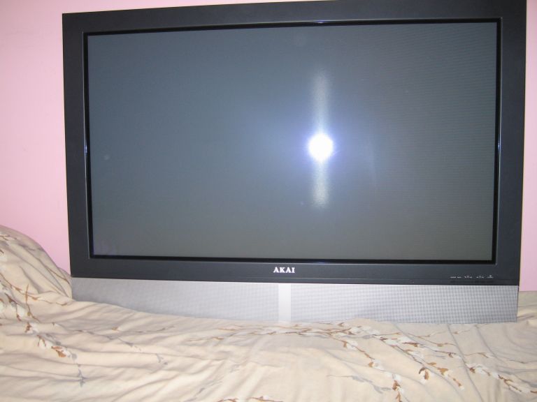

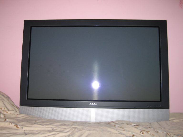

                            I did find an HDTV a few months ago, and I do plan on repairing it. I've mentioned it before. You must be getting old :p
                            Victim: "Akai" 42" Plasma HDTV Model PDP4273M
                            Symptom: I found this in the trash outside a rich Italian's home one cold rainy night. It was in a box for a 52" Plasma Viega (Yes, I call Viera Viegas because the R they use is a Cyrillic G), so naturally I got all excited. Luckily the box had so far protected it from the rain.
                            Brought it back home and fired her up after it stopped condensating. Turns on but the image is distorted and grainy but it *IS* there. The next morning when the TV had warmed to room temperature, it wouldn't turn on at all which indicates to me that it definitely is cap failure. G-d only knows what caps that dingy little factory in China put in this thing, but chances are it uses a Samsung tube.
                            I'm gonna open it up when I have the enrgy one of these days and get to it. How do you fix such monsters Bill, do you mount them first on some kind of a stand or do you just lay it flat on its face and take off the back.

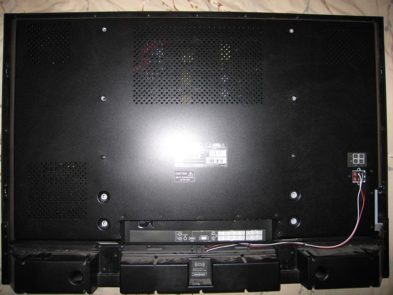

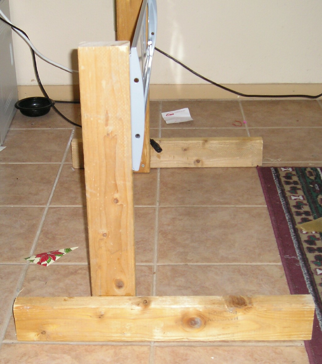

                              I'm not so sure it has a Samsung tube. The published native resolution of that set is 1024 x 1024. Still, speculation is useless untill you get the back off.
                              I lay them face down on the dining room table and take off the back. (I have a very wonderful wife who approves because she gets first choice of the repaired product). I've also tricked up the rough design of a working stand also.
                              The prototype in the picture is more of a 'burn in' stand. It uses a universal fixed wall mount for 37" - 63" TVs that Fry's Electronics had on sale. The frame that was intended to mount on the wall limits access to the electronics too much. I've started to write up a 'How to Make a Flat Panel TV Repair Stand' project, which I will post to the 'TV and Video Sources' section when I get it done. I need encouragement to work in it.
                              The chief modifications involve starting with a full 8' 2 x 4, and cutting it into 2 20" pieces for the base and 2 28" pieces for the verticals. Move the two verticals about 2" closer to the rear than the ones in the picture. The idea is to have the center of the TV over the center of the base. Instead of the wall mount, bolt 1.25" perforated angle iron to each vertical, then run the appropriate metric screws through the holes in the angle iron to fasten it to the TV. Of course, glue and screw the verticals to the base. Carpet stapled to the bottom of the base means you won't have to worry about scratching the floor.
                              I even toyed around with the idea of mounting the verticals at about a 30° angle so you have better access to the back of the TV.
                              PlainBill
