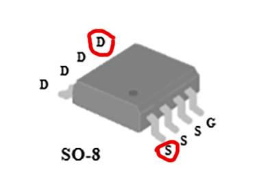

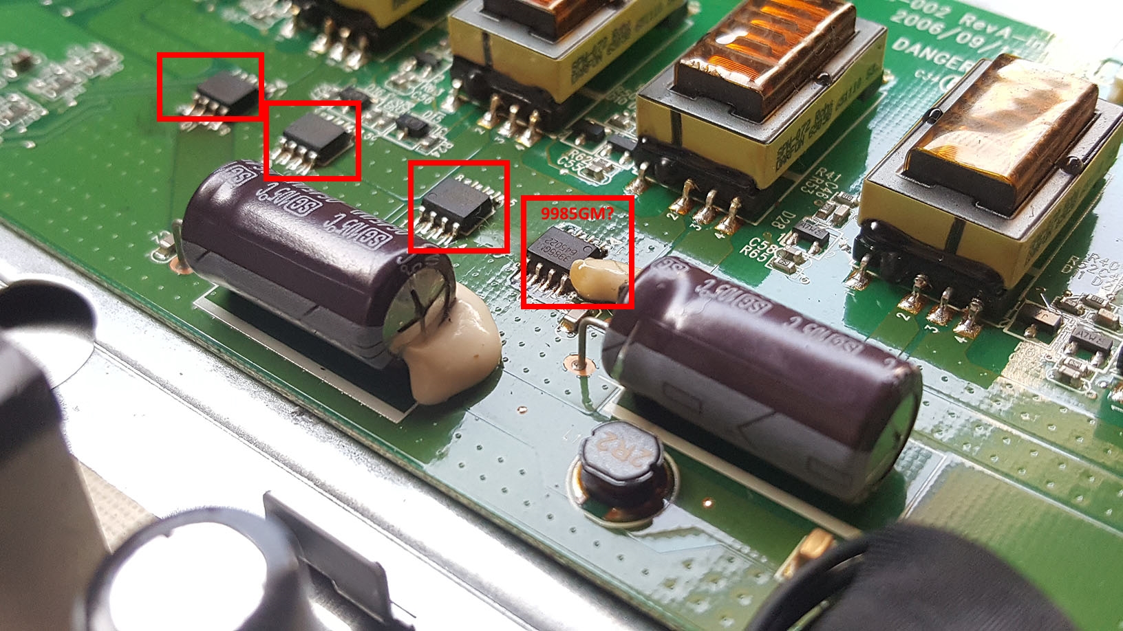

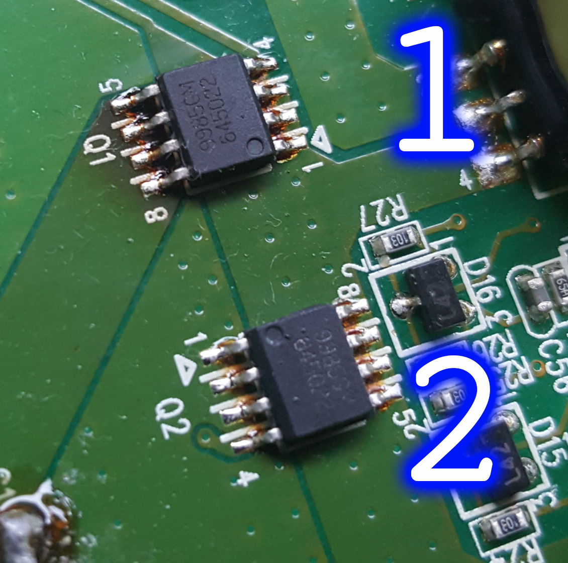

    I can read P/N on one of the 4 Power MOSFETs, 9985GM.
    You need to find out what the other 3 are all the same or not.
    See spec sheet for the Source and the Drain pin of the 9985GM.

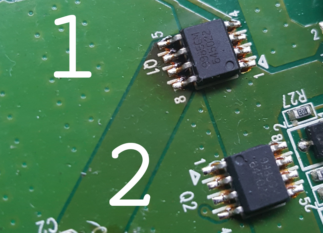

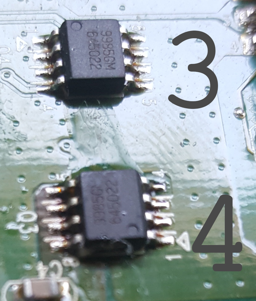

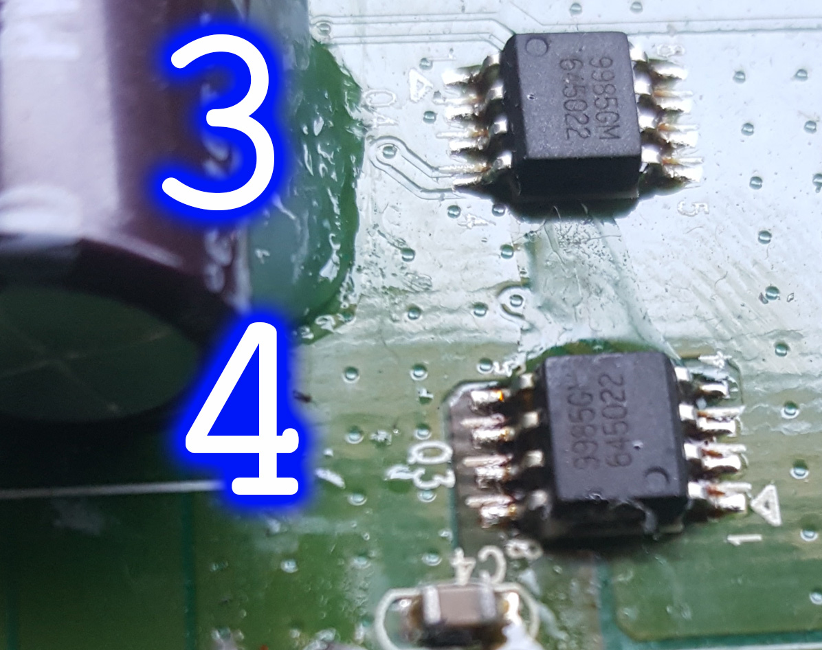

      Well, here are the best photos I could get without getting the big camera out.
      All of them seem to be the same: 9985GM - 645022
      The schematics read like there is 3 source pins and 4 drain pins on the other side. Does it matter which of them I measure?

        Re: Gateway 24" LCD Model LP2407
        I checked on these pins, and got these values (starting away from power cord and going towards it):
        1. 0.04 (200 Ohms)
        2. 2.65 (20k Ohms)
        3. 2.65 (20k Ohms)
        4. 0.05 (200 Ohms)
          #124
          1. 0.04 (200 Ohms)
          2. 2.65 (20k Ohms)
          3. 2.65 (20k Ohms)
          4. 0.05 (200 Ohms)
          #1 and #4 power MOSFETs are bad.
          You should replace all 4 of them at the same time.

            Does it matter that those are mounted facing the other way?

                It does not matter how they mounted on the circuit board, you just have to follow the pins, it is that simple, it has pin 1 ~8, 1~3 are SOURCE which are all connected together inside, 5~8 are DRAIN which are all connected together inside.

                  Do you have tools to do surface mounted repair? we have seen your soldering works on the capacitors so I am not so sure you can do the replacement.
                  Just look on EBAY for the part.

                      I would cut the legs off the MOSFETs, no need to try to remove them in one complete piece.

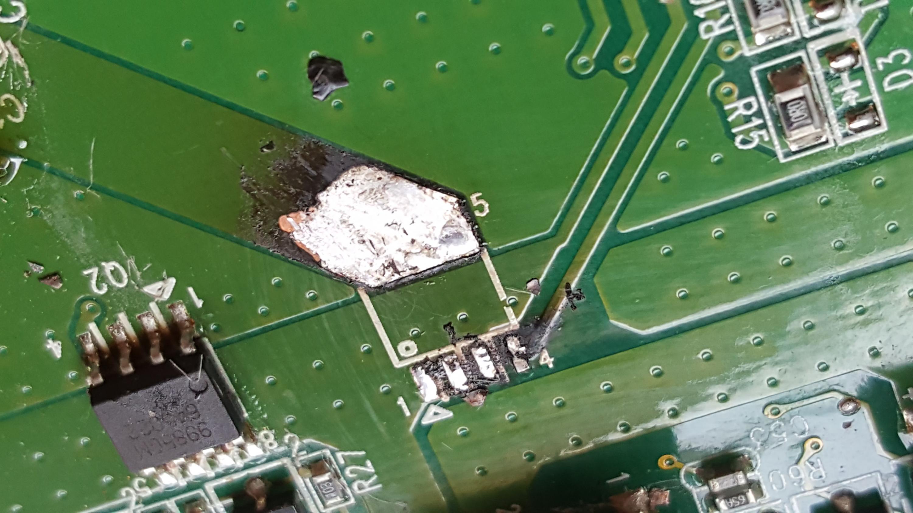

                                      #138
                                      Faaak... I think this new gun gets too hot even on its lowest setting cause it looke like the green burned off the PBC when I was trying to clean up the board to solder on the first MOSFET
                                      do you guys know where I could buy a whole LCD inverter board for cheap?

                                        Don't worry. The board may look burned, but as long as the traces are still intact and conducting, the board will be fine. I've revived much more damaged boards.
                                        Also, it's not actually all your new iron's fault. Judging by this picture:
                                        https://www.badcaps.net/forum/attach...7&d=1468286166
                                        ... it looks like the faulty MOSFET did the damage/burning of the board. So again, nothing you did wrong.
                                        Before soldering the new MOSFETs on, just make sure to clean off any areas on the board that looked completely charred/black (carbon dust/particles are conductive).
                                        Just received these puppies, any suggestions for soldering them ON that could make it easier than just doing each leg one at a time?
                                        Soldering them one leg at a time shouldn't be that hard, even for a novice. As long as you have a fairly steady hand, though. Here are some tips to hopefully make it a bit easier for you.
                                        1.. Make sure pad where the MOSFET goes on the board doesn't have excessive solder and the solder on it is even. Also make sure there are no solder bridges between pads that aren't supposed to be connected (like, for example, Source and Gate or Source and Drain).
                                        2.. Put flux on both the board pads where the MOSFET goes and on the MOSFET legs.
                                        3.. Place board on an even surface where it won't move or wobble. THen put MOSFET on the board and align its leads properly with the board. Make sure pin 1 is where it should be.
                                        4.. Hold MOSFET either with tweezers or apply pressure on top of it with your finger/fingernails (fingernails are fairly heat-resistant, so you won't get burned by the hot iron).
                                        5.. Try soldering one of the corner pins on the MOSFET (to the board). To do this, just touch the board pad. You should see solder flowing from the iron's tip to the board and then to the MOSFET lead. Also, make sure your solder tip has very very little solder on it. If you put too much, it will bridge the pins together.
                                        6.. Once you have one corner pin soldered, you don't need to hold the MOSFET anymore with tweezers or your fingers. That said, be careful because you can still move the MOSFET around a little bit. So next, try soldering another corner pin - preferably one that is diagonal from the corner pin you just soldered in step 5 above. Continue until all corner pins are soldered down.
                                        7.. Once you have ALL corner pins soldered, now you can just go and solder the rest of the pins in the middle. Since your MOSFETs have 4 pins tied together for the Drain and 3 pins tied together for the Source, IT IS OKAY if you actually put a solder bridge accidentally across those pins.
