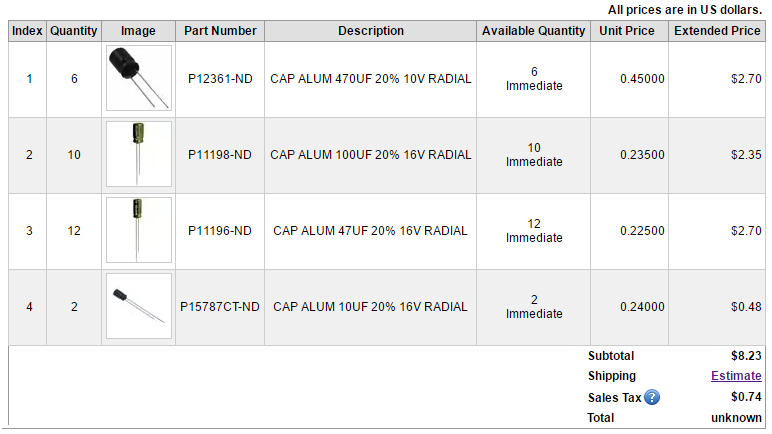

    Here is the order for the Logic Board capacitors, the only one I was a bit iffy on was the last one but I think I got it right as well...

      The logic board caps are here
      Should I start swapping those mofos? Though I could wait for the better iron to see how that one handles the job... What do those readings with the logic board plugged in tell you?
        List looks good to me. For the last one, you could have gone with a 25V or even a 50V cap so that you can find Panasonic FC/FR/FM or other equivalent low ESR caps. But what you got will still probably work. The LCD logic board typically rarely requires low ESR caps.

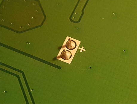

                  Gosh, should I be worried about these little soldering points?
                  How does it work when it comes to "safe areas" for people that use 3 lbs of solder like me?

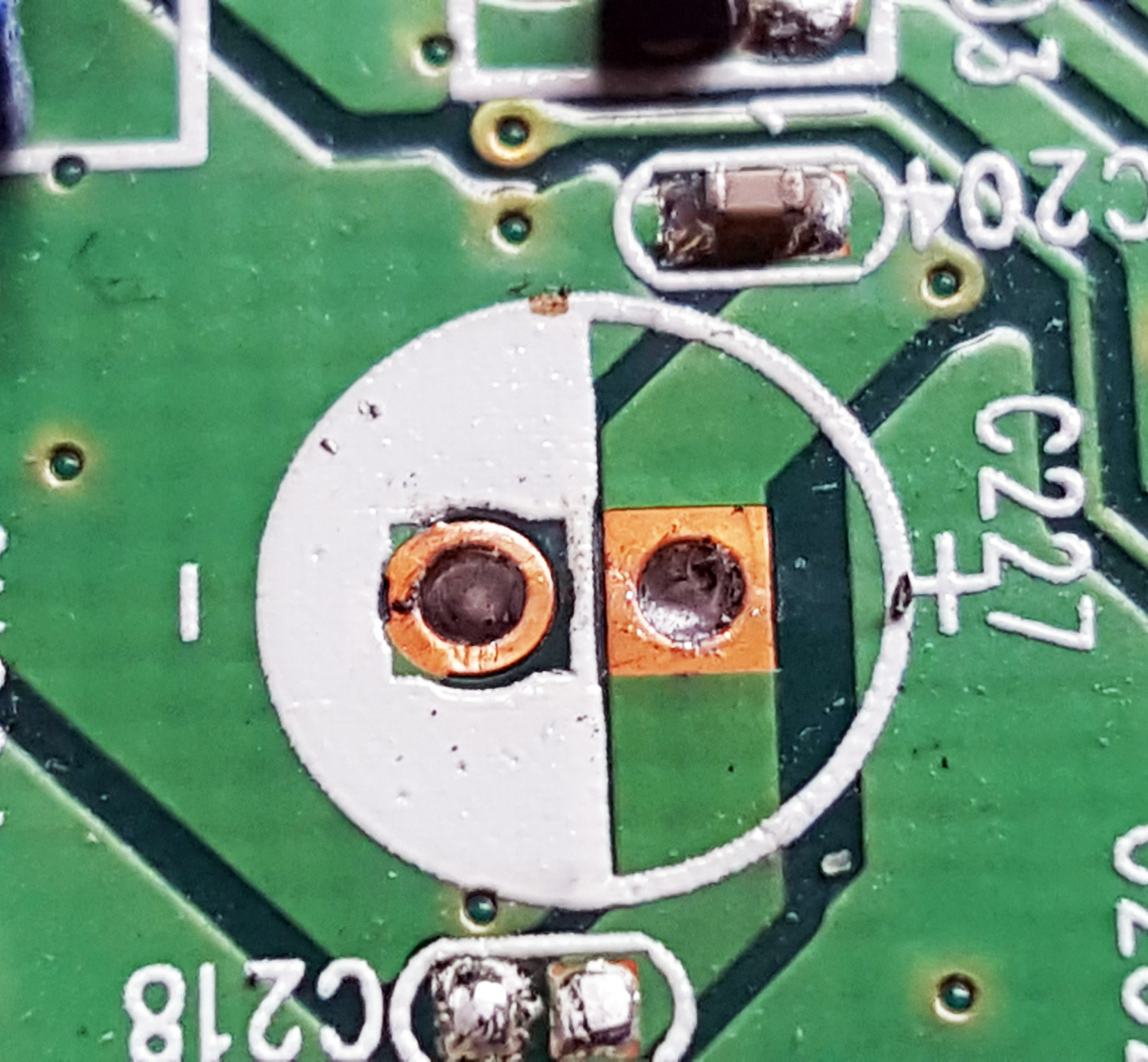

                        %#$@!! Now I have the same issue with another one of those small tight cap holes... is there a trick that helps to clean up the PCB so that I stop getting connectivity between the holes even without a cap installed?

                            Budm, do you have any tricks to cleaning up the PCB? I am getting connectivity between two of those points even without any solder (that I can see) and without a cap installed...
                                      Just use less solder and more flux to re-do the joint until it looks right.
