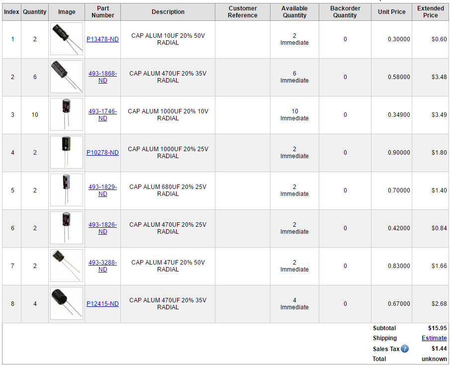

Every time I see "local supply" or similar, I cringe. Most such sources do NOT stock suitable low ESR 105C caps. I trust that you didn't go that route, like RatShack or similar.
Once ALL the electros (bar the large one) have been replaced with suitable caps - including the small ones that are often overlooked - it is then time to investigate the PSU outputs.
Got them thru Warren Electronics (vs RadioShack) ... seem to be good ones (well ... Xicon, KME, San Ching, Jamicon and I heard San Ching makes nice Rolexes). My cap part numbers are in the 600's(M) vs fadec's 700's(M). I found radial 125degC's (Vishay's) in the capacitance and voltage I need, but they are not is stock from DigiKey (the 105degC Panasonics are in stock). Anyone know typical lead time when ordering non-stock items from them?
None of those are suitable caps for power supplies.
You don't need 125C rated caps, just proper low ESR caps from either Panasonic, Rubycon, United Chemicon, Nichicon, Sanyo, or Samxon.
The KME's you mentioned above are likely United Chemicon - however that particular series (KME) is general purpose, not low ESR.
I recommend the following replacement caps for LCD monitors:
Panasonic: FM, FR, FC, and HFQ
Rubycon: ZL, ZLH, YXG, and possibly MBZ
United Chemicon: KZE, KY, LXY, LXZ
Nichicon: PW, PM, HE, HD
Sanyo: WX
As for Samxon, not sure which series are suitable. Check their datasheets. GC and GD might just work fine, though.
Thanks mom ... ordered Panasonic FM's and Nichi PW's. Replacing all the Su'scons on the processor/input board too. I'll lay the upper caps over (above uppermost heat sink where they were 125degC's originally), get them out of the main stream of hot air. I'm a little skeptical that this is going to fix it but it does eliminate a variable ... and it has worked for others. I see those 06xx(M) numbers are date stamps apparently.
Thanks guys, I was experiencing 2 seconds to black and just finished replacing all the capacitors on the power (nearly all bulging) and inverter boards(both bulging)... all with panasonic FM's except the two 50V (47uF and 10uF for C876 and C857 in prior pictures) where my choices were FC's, or use the ones posted previously... digikey 493-3288-ND (Nichicon TS) and 565-1598-ND (United Chemi-Con KY). I had a harder time removing the caps from the inverter since the caps there lie flat with bent leads and had no rocking leverage (is there a trick/tip to this?). I didn't do processor/logic board or USB (hub) board. I also did not replace the large cap on the power board.
For the 50V's I ended up ordering both the FCs and the ones mentioned above but decided to use what someone already had luck with for that reason as well as it stated 5000 hours vs 1000 for the FC but I just noticed that the Nichicon listed was a TS series which I didn't see mentioned as "good caps" in the FAQ... would I have been better off using the FC's? I'm not sure I want to tear it all apart again while it is working better than ever.

I've had a lot of the symptoms described here and maybe a few more. I have two of these monitors and they behave slightly different, but at some point in time both had the logo that doesn't fade away for a long time, slow menu, slow switching sources... one of them also seems to need to warm up before A LOT of vertical lines of different colors disappear, but once it warms up it is the one that looks best of the two I have.
This morning, the one without the colored lines, decided not to turn on. The menu lights lit up, and if I switched sources cheating off the other monitor the lights seemed to respond normally, but the LCD remained black no matter what.
I found this forum (thank you for all your posts!) and cracked the f'ker open (somewhat carefully) without much trouble. I found three bulging caps in the Power Control board, and two on the LCD board. I may be getting the names wrong, but I'll attach photos.
I bought a cheap multimeter recently, and though I am not sure how to test the caps I am game if someone would help me figure that out.
I plan to buy a soldering kit, and could use help picking one out. I am not looking for a pro setup, and hoping to spend around $20 or so, but I do need something that will make the job relatively easy. I am meticulous and good with my hands. I have watched people solder before, but this will be my first time soldering a board. I have to admit I am having fun with this, sans the freaggin' thing not working...
Could someone please help me:
1. Make sure I order the right caps per the photos attached (I guess I should replace ALL power control caps, but if it makes sense I would like to just do the bulged caps and see if I can use it for a couple more years)
2. Teach me how to test caps, hopefully before removal
3. Pick the right starter but decent soldering kit
I still feel a little lost but I went ahead and placed this order based on what other's ordered. I don't think the big cap is included so I hope that mine isn't damaged. I also doubled the order to be prepared for when the other monitor takes a crap. I am tempted to do both but don't want to mess with it unless it dies since the colored vertical lines always go away once it warms up and it has less menu issues that always go away with a quick unplug.
