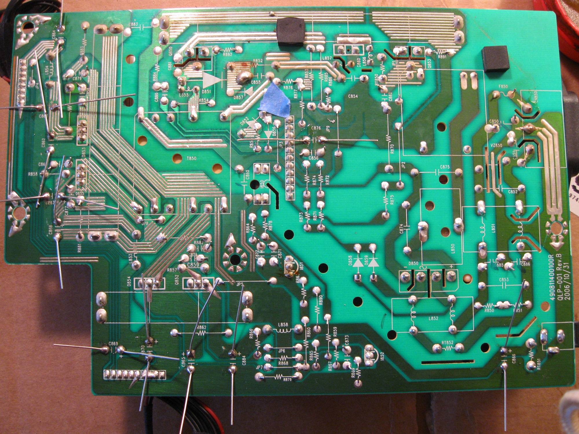

    Here is a slightly updated list I just ordered based on current availability:

                Just wanted to update, but I did get around to attempting this on Saturday....and SUCCESS!!!!
                Ordered from DigiKey on 4/20 and got all the caps in Thursday or Friday. Spent a few hours familiarizing myself with how to desolder caps and solder new ones. I picked up a desoldering plunger and iron stand and went to work.
                Overall the hardest part of it all was removing the back cover....there's 3-4 tabs/clips on each side and its a real pain to get them all off without damaging the bezel.
                As for the actual soldering portion, the hardest part was desoldering the caps and getting off all the old solder. The plunger worked OK for getting most of it off, but the little bit of solder that lingered inside the pad's hole was harder to get off. Maybe some solder wick would be better for that last little bit.
                Keeping the iron tinned was also pretty difficult for me, I guess that comes with experience but it was obvious when the iron was transferring heat well as the old solder melted much faster. Maybe a better iron would've helped here too, idk. Once I cleared enough of the solder I just used a pair of pliers to pull out each cap.
                Soldering the new caps was actually the easiest part of the entire process for me. Each joint went off very smoothly and just like the various videos I saw, with a well-tinned iron, just heat up the pad and tail, then apply the solder to the pad and not the iron. The solder flowed freely after that and formed a little bubble over the pad.
                Here's the end result, very proud of my effort for a first time soldering newbie, thanks again to everyone in this thread, especially the ones that posted the actual part #s and part lists from Digi-Key!!!

                  Congrats and well done!!
                  You might want to put on your flame-resistant suit though for posting that humongous picture in-line instead of using the forum guidelines.

                    D'oh, sorry about that.....can't seem to edit my post, if a Mod can do it that'd be great.
                    Attached resized image below.
