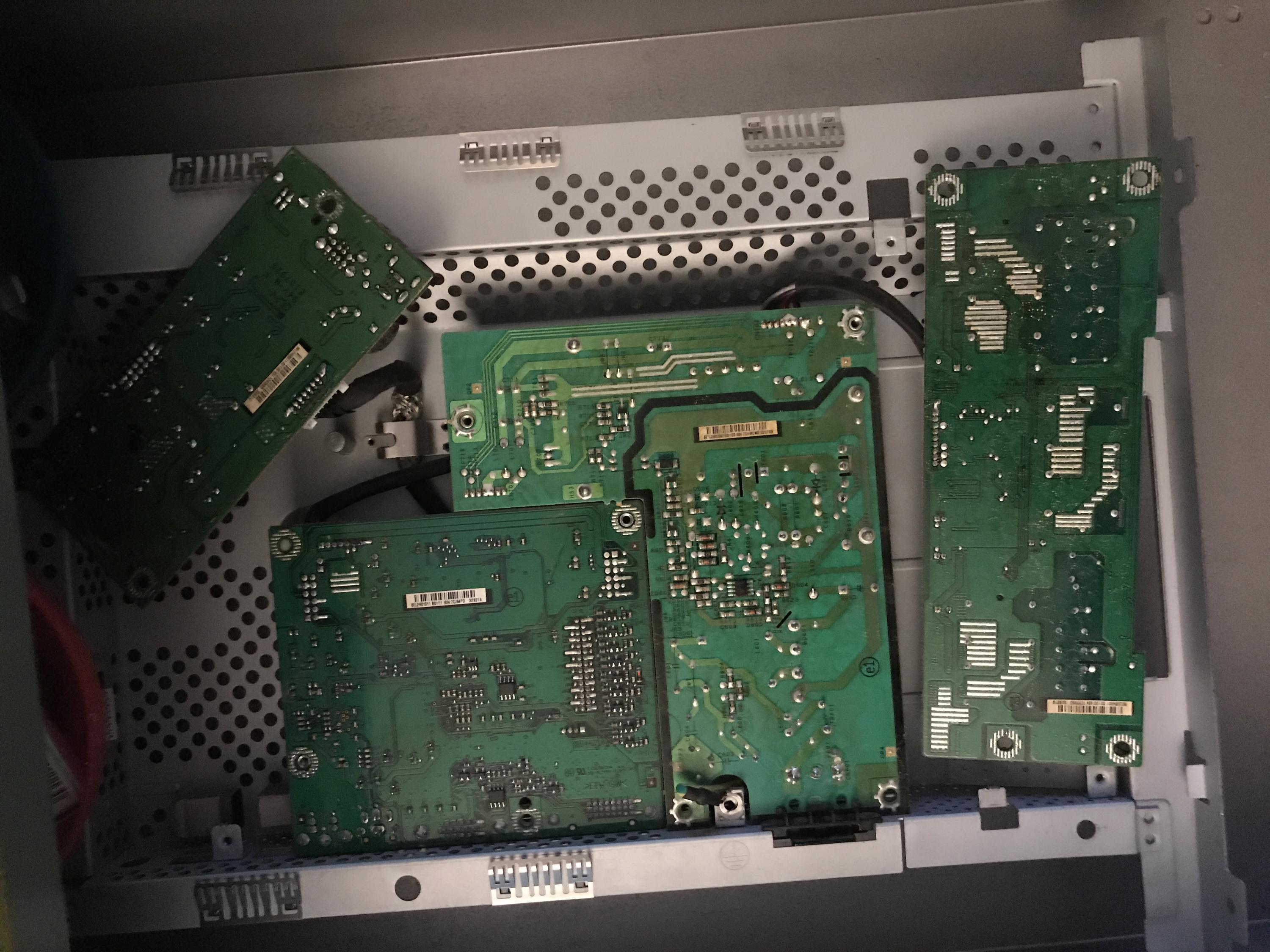

I would like to replace the power pcb, but I can not get it out. I would like to look at the board or something is burned. Burning smell from display. I was working.
Dell 2007 fpb display
Re: Dell 2007 fpb display
Lift the power supply board out while at the same time also lifting the power connector out. Sometimes, the power connector / power inlet can keep the PCB from going out. There may also be thermal pad between any of the heatsinks and the metal case... and if so, you may have to exert a bit of force on the board to get it out (but not too much, of course.)
