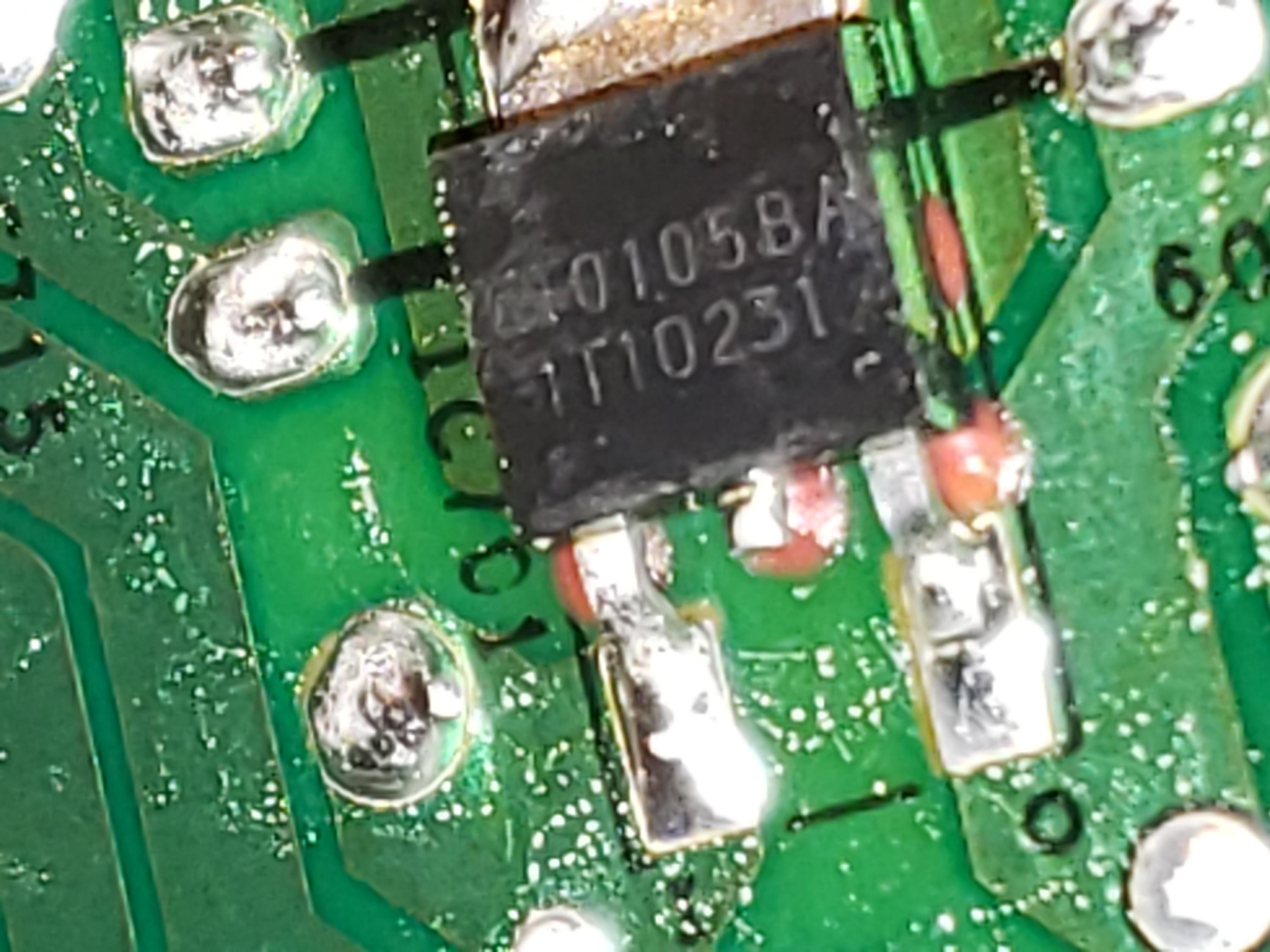

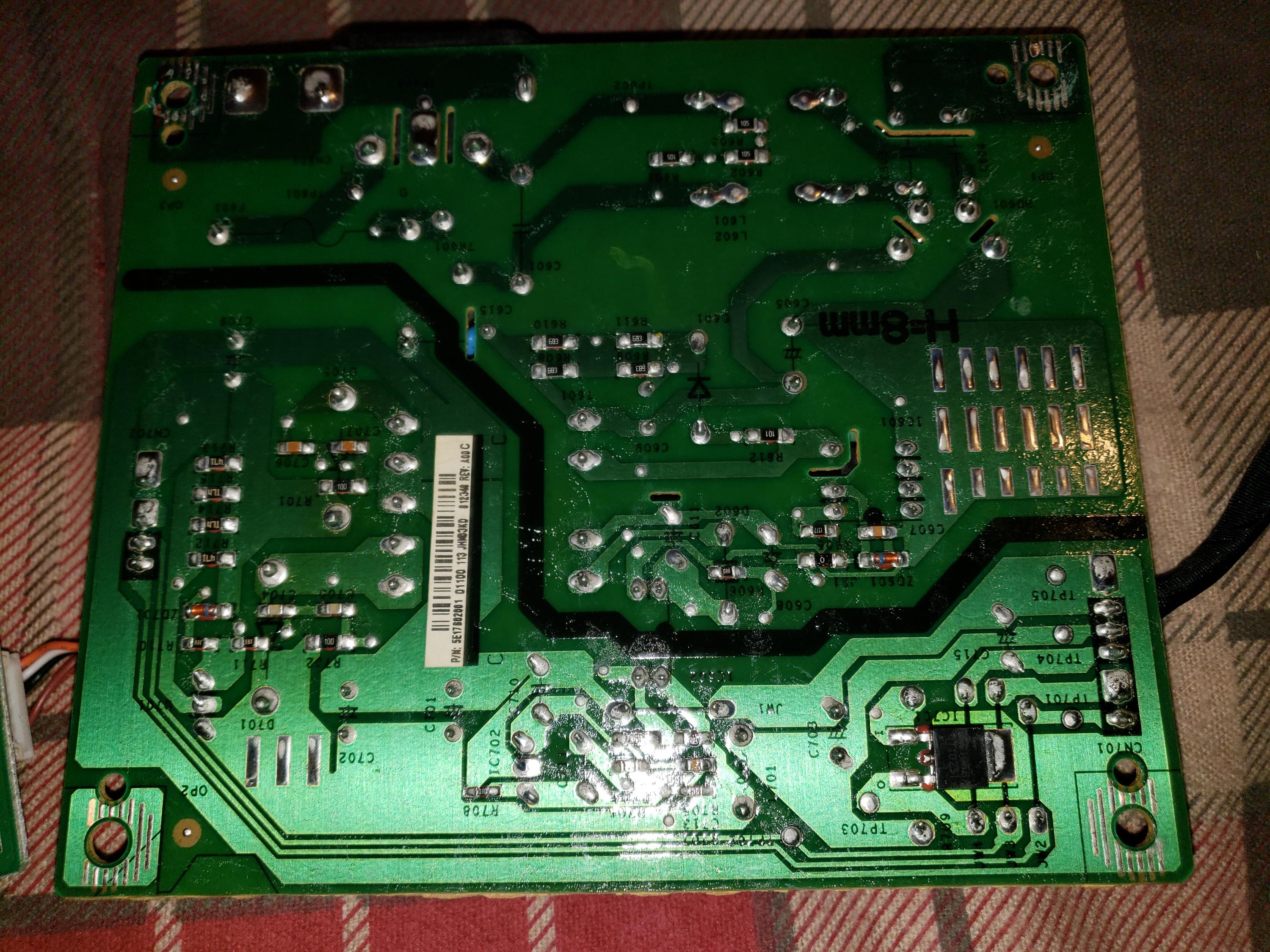

    got this monitor that looks great cosmetically, but no life. After a bit of a struggle, I opened it up. I am getting 160 V across large cap. No voltages on the connector that goes to main board. If this is anything like TVs, I'd expect some standby voltage to the main board.
    I am not familiar with this power supply board 4H.17B02.A00
    I found an IC that's close to the mainboard connector, thinking it might be the standby regulator. Has the folowing numbers on it
    101058
    1T10231
    No luck with any datasheets on this.

    Correction, under a microscope, the I closer to the main board connector is 210105BA (not 101058) But this IC is not getting any voltage, so I don't believe it's the problem.
    Thank you

      Re: Dell ST2421LB Dead monitor
      It's the TOP258PN next to the main cap.

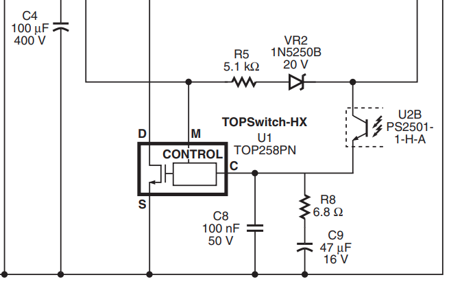

                        I don't have the exact schematic but this one is similar and uses the same top258pn
                        You may need to clean the top of the diode with alcohol to see the marking code.
                            Could anyone help with the value for C607 please. I have the same board 4H.17B02, zener ZD601 appear shorted in circuit but once taken off PCB appear OK. Took off C607 but found pads for ZD601 still shorted eventually found that it was C608 47uF 25V that was shorted. However in the process of taking off C607 end terminals was destroyed.
                            Anyone would could help with value of C607 would be much appreciated.
                            Tried 80nF which gave approximately 5.8V at pin2, ~1.26V at pin1 and 330V at pin4 of TOP258PN.
                            Thanks.
                              C607 seems to be 0.1µf. If C608 was shorted, check if R606 is open or the opto ic could be bad.I would also replace C611. C607 is just to remove any high frequency noise on the line, its not that critical and should operate without it.
                              5.8v on C (pin2) is supplied by the ic, Once the circuit starts, the control voltage for pin 2 comes from D602/C611 through the optocoupler.
