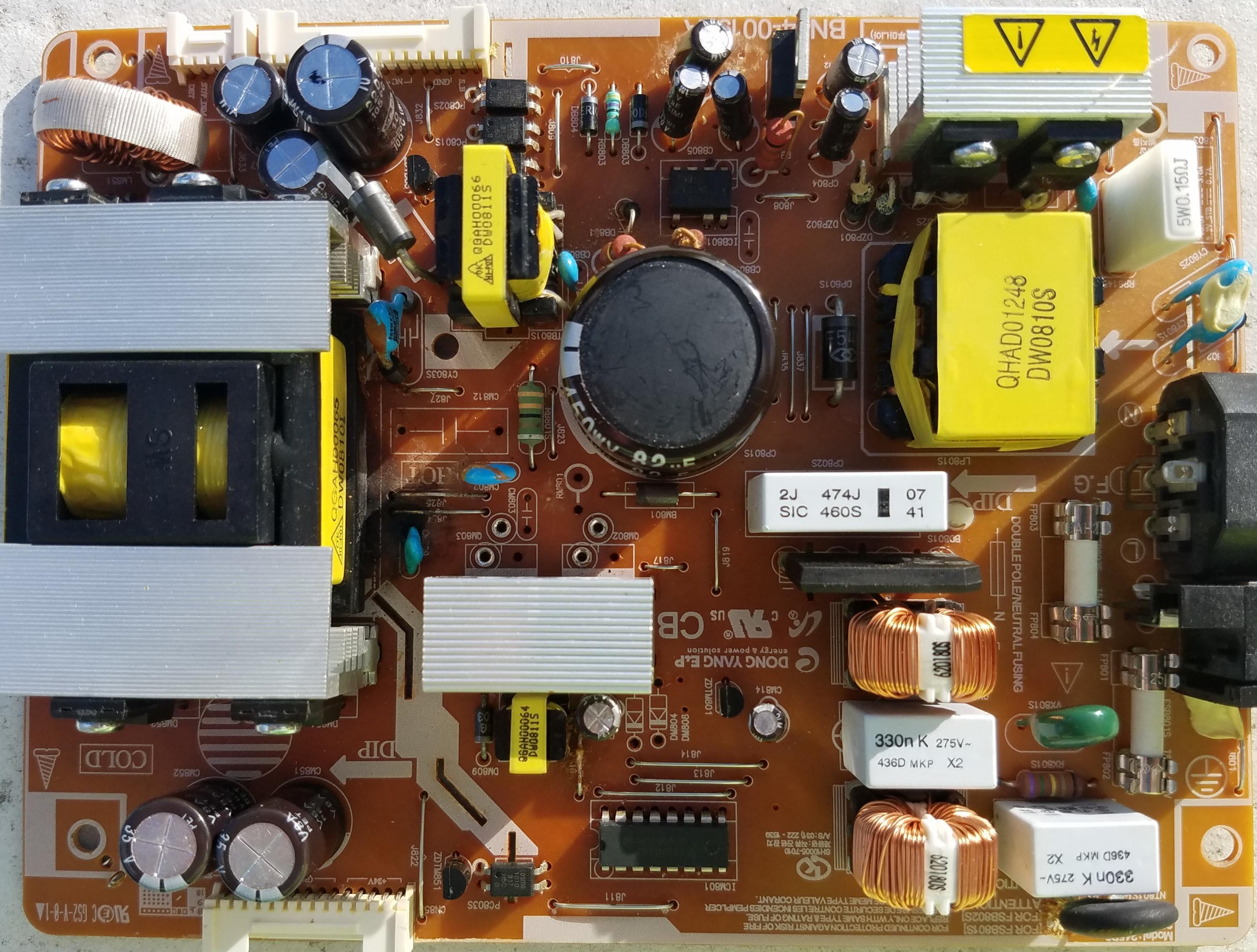

    Hello all,
    First time post here. I've searched here and used up my know-how. I'm at a loss on how to continue with this. I really don't want to blown another pair of mosfets!
    https://cdn.badcaps-static.com/pdfs/...f8a620fd8c.pdf
    Is the schematic that I've been using, not an exact match, but I believe that it's close enough for this board as a guide.
    Here is what was found on initial inspection.
    CM809 47pf obviously blown open on initial examination
    QM801, QM802 FQPF5N50C shorted
    RM801 0.22 1W FR open
    RB801, RB802 100K 2W open
    Checked ICM801, ICP801S, ICB801S for shorts, all appear to be fine.
    CM808 appears to be okay
    Changed all the above bad components, power on bang! PooF goes the
    magic smoke. QM801, QM802, RM801 all toast.
    All other parts that were changed are okay. Obviously I've still got a nice short somewhere...
    Any help or pointers in the right direction would be appreciated.

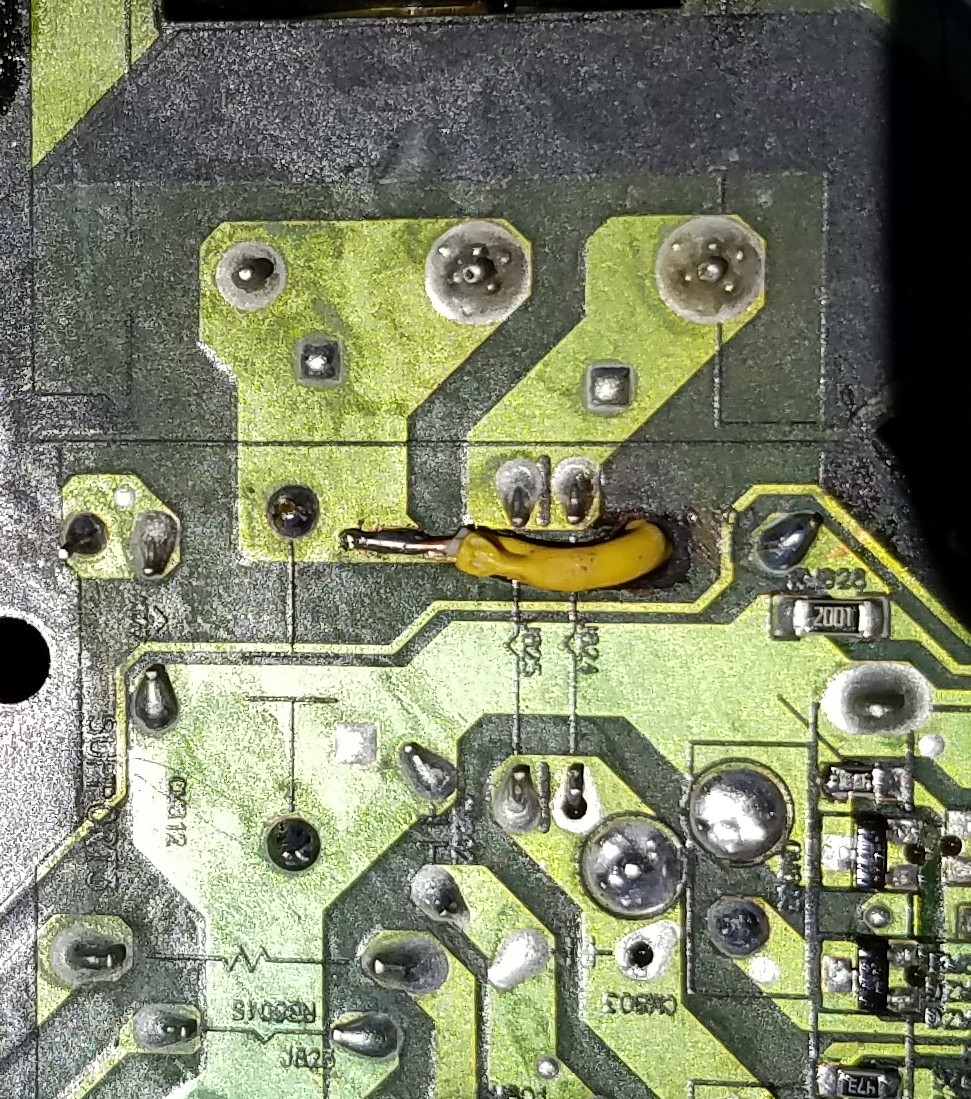

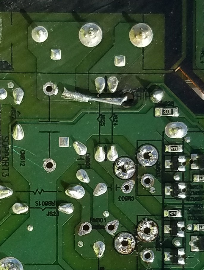

                        Fixed!
                        CM809 was obviously bad upon opening this thing up. The trace on the bottom of the board was gone. I had jumpered it to fix that. Upon closer inspection it looks like one of the jumpers in that area was able to arc over and cause the short. I re-worked that with some insulated wire and a bit of heatshrink. Also cleaned up the carbonized area as much as I could. It would probably be a 12mm hole to get it all gone. Replaced RM801 and QM801/QM802 and all is well again.
                        Thanks for the help and getting me looking at the right area of the schematic. Still don't have a great grasp of this circuit. Ever learning...
