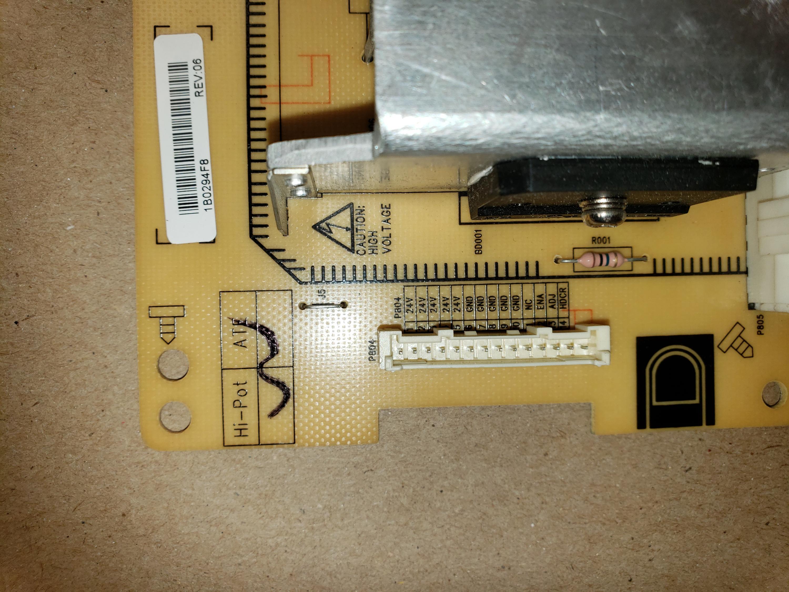

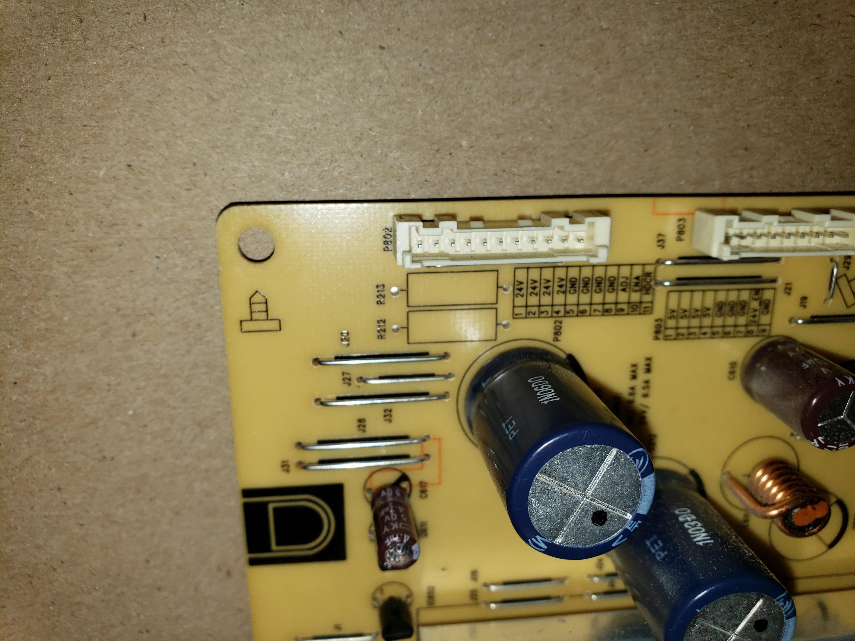

    I'm trying to repair the PS-2201-3-HF board. It has 2 connectors sets (top and bottom)
    Bottom set seems to be just 24V and GND with ENA, ADJ, and HDCR
    Top Connector, P802, is identical, but P803 has 5, GND, 24_EN
    I buttoned up the Monitor so I'm troubleshooting this board on my workbench. To turn all the supplies on, I'm assuming I tie 24_EN to 5V (with a small resistor)?
    Do I have to do anything with the ENA and HDCR pins??

    Looks like 24_EN on P803 is not connected to anything. So I'm guessing the 24 V comes on when the "ENA" is tied high.. So I shorted it to +5V (which does come on), but the 24 V never comes up. Voltage across large Cap doesn't change - 164 V DC. Is this a PFC circuit issue? Looks like this uses the Fairchild FAN7529B. Schematic anyone?

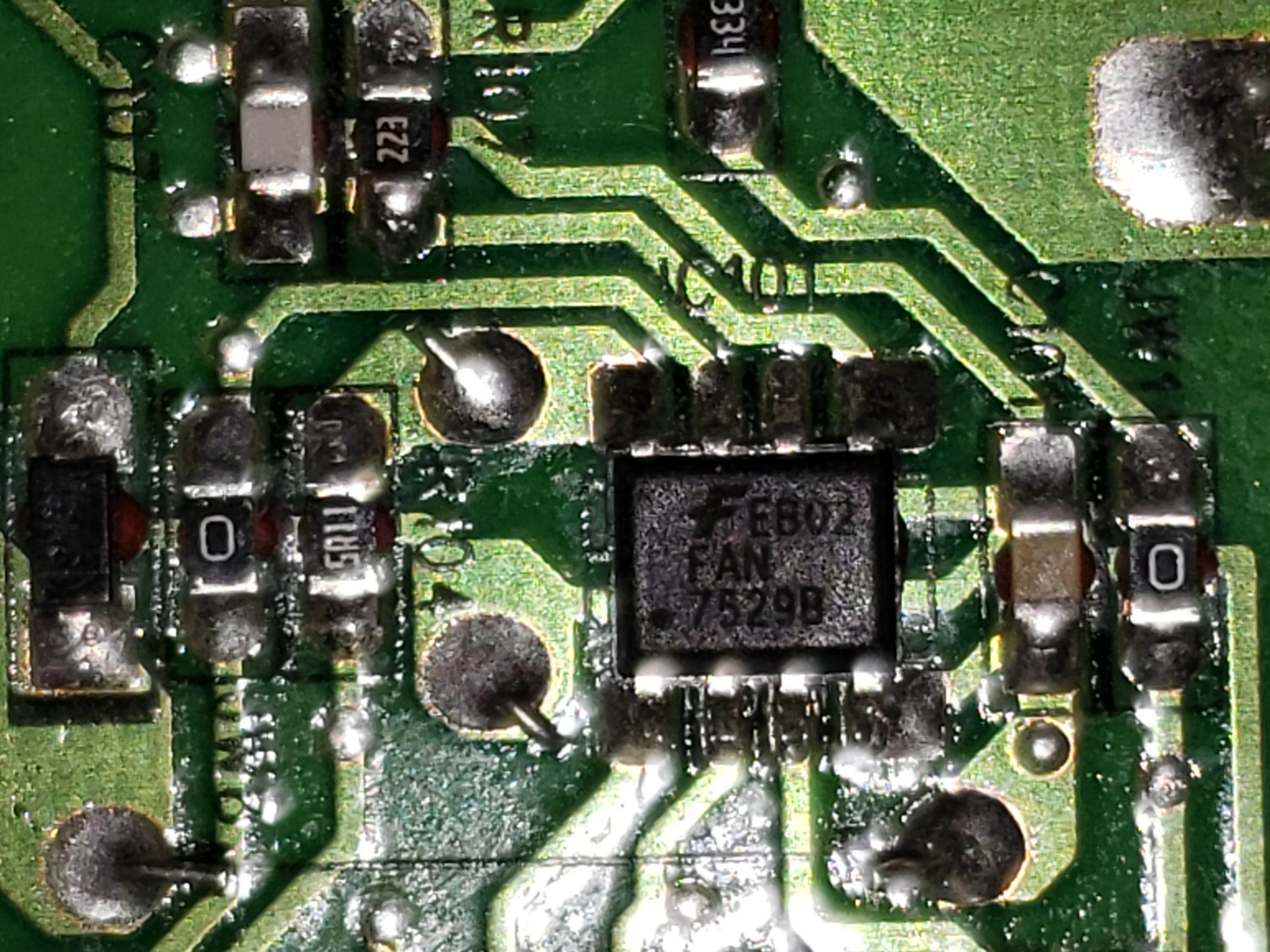

        I'm not seeing a controller between the 5V to the 24V. Simply a transformer, some diodes and resistors and caps. Is that possible? are they modulating the 5V and transformer turn ratio sufficient to generate 24V then filter? is that it?

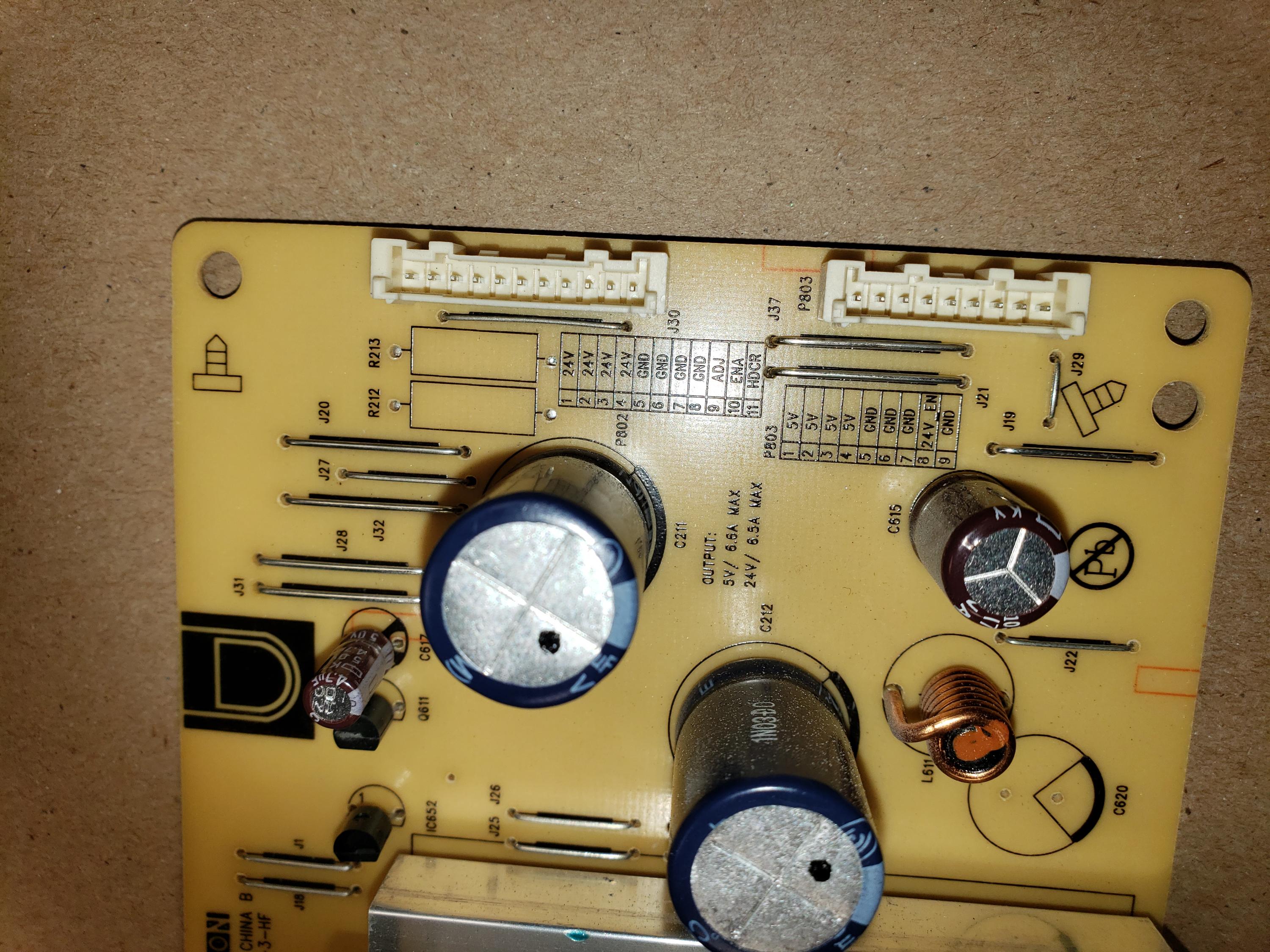

          Re: Dell U3011 - Troubleshooting the Power Supply board PS-2201-3-HF
          Did you check that white fuse in your picture? close to R107.
          • jason123
            • Oct 2015
            • 1060
            That is labeled C107 - I know it's a bad photo. I didn't.. I will shortly and let you know. Seems that the PFC circuit is working - Large Cap voltage goes from 164 to 384 VDC.

                  Hi captainKKK... I found a couple of bad solder joints (actually arching as I move the board) so touched those up, and now 24V comes up to 24.67 V.. However, there is a chatter or relay sound (though I can't find a relay on the whole board)- Audio recording attached.. Seems shorting 5 V to 24_EN is too strong. When I use larger resistors the chatter goes away, but the rail only reaches 20 or 21 V. Any idea what resistance I should put between 5 and 24_EN?
