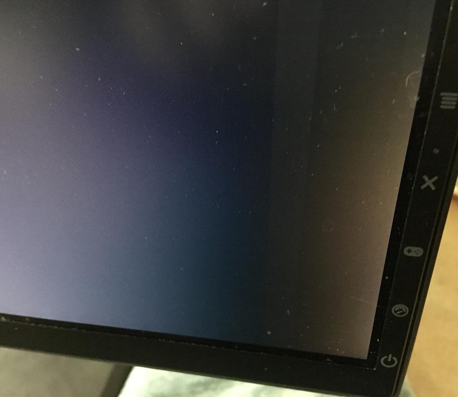

    I'm currently working on a ASUS PG279Q (27", 2560x1440 IPS G-Sync, pretty expensive when new) which shows no image. According to the owner it worked fine one evening and didn't work the next day. No prior change in device behavior, apart from two stuck pixels which have been there since the beginning.
    Things I checked so far:
    - The backlight is fully operational
    - When turned on, the backlight comes on, and the image remains dark. If you look very closely about 2/3 of the panel are fully black while 1/3 are slightly brighter. Some very faint vertical stripes as well. (See attached IMG_....)

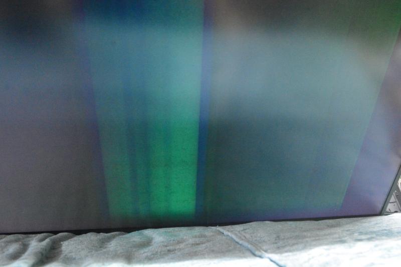

    Very rarely when left powered on with an input signal the panel shows vertical, colored bands. It doesn't always do this, just sometimes. See attached image (DSC_...). (This might be unrelated to having an input signal and just might be due to running for some time: it will always go into standby after a little while with no signal present).

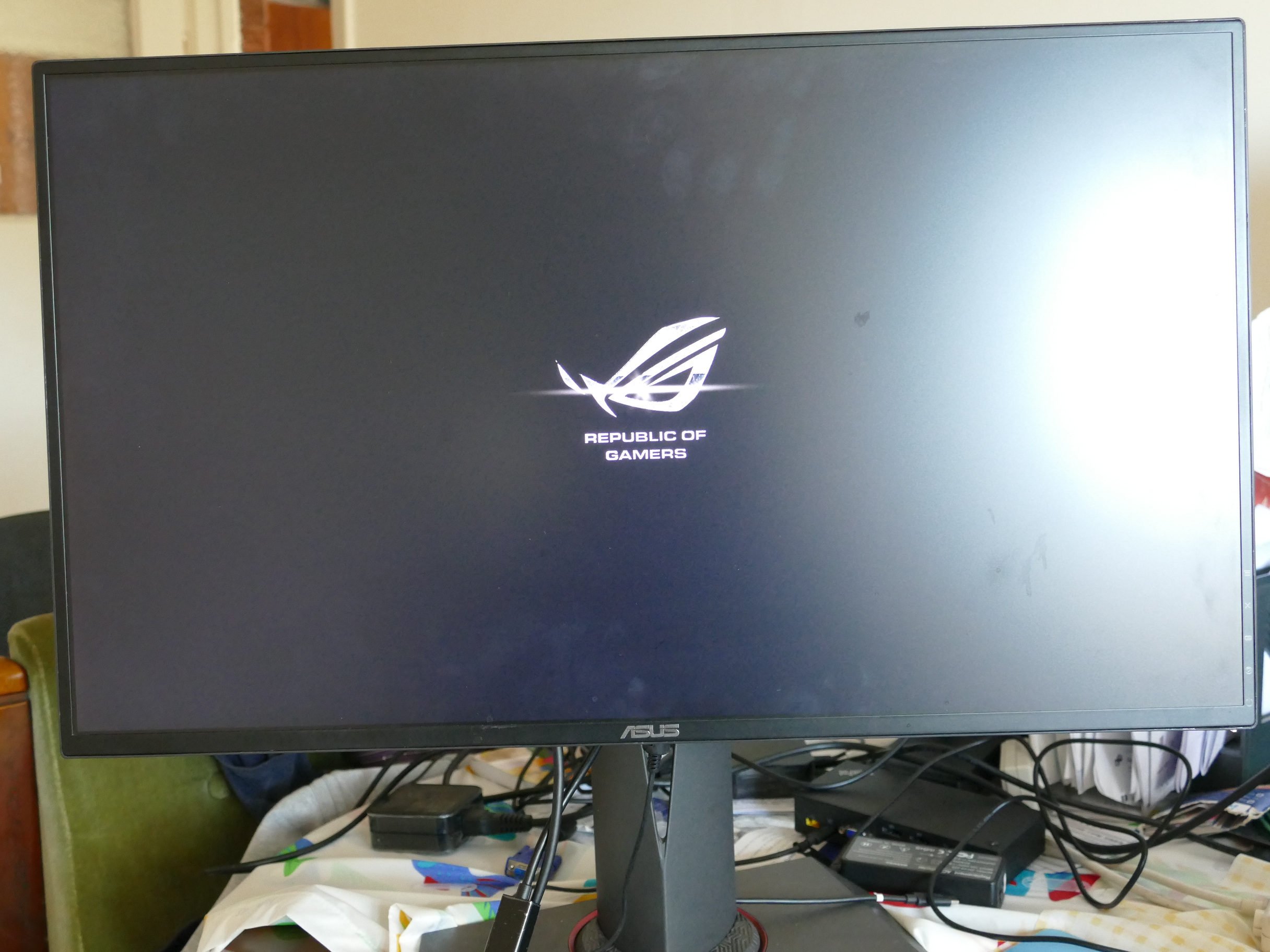

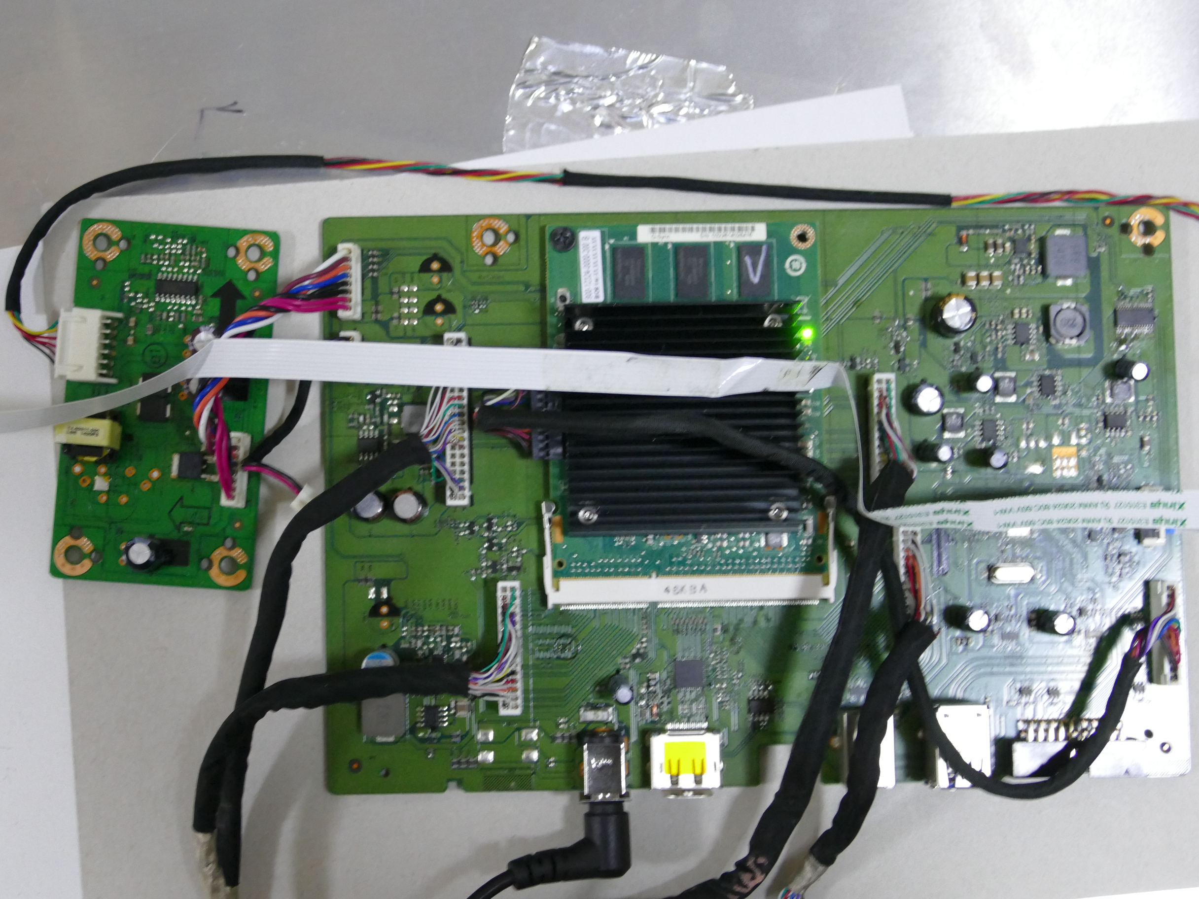

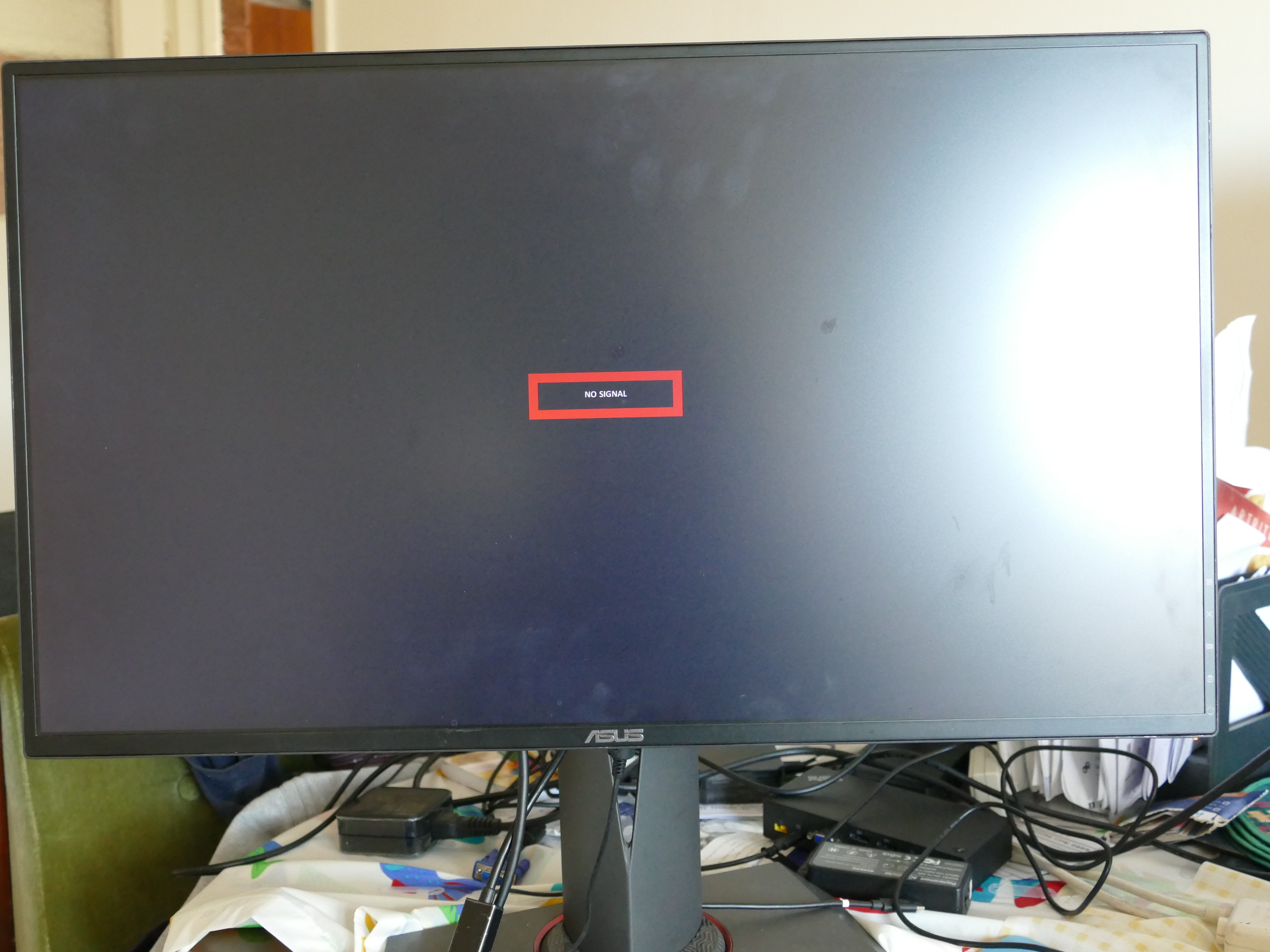

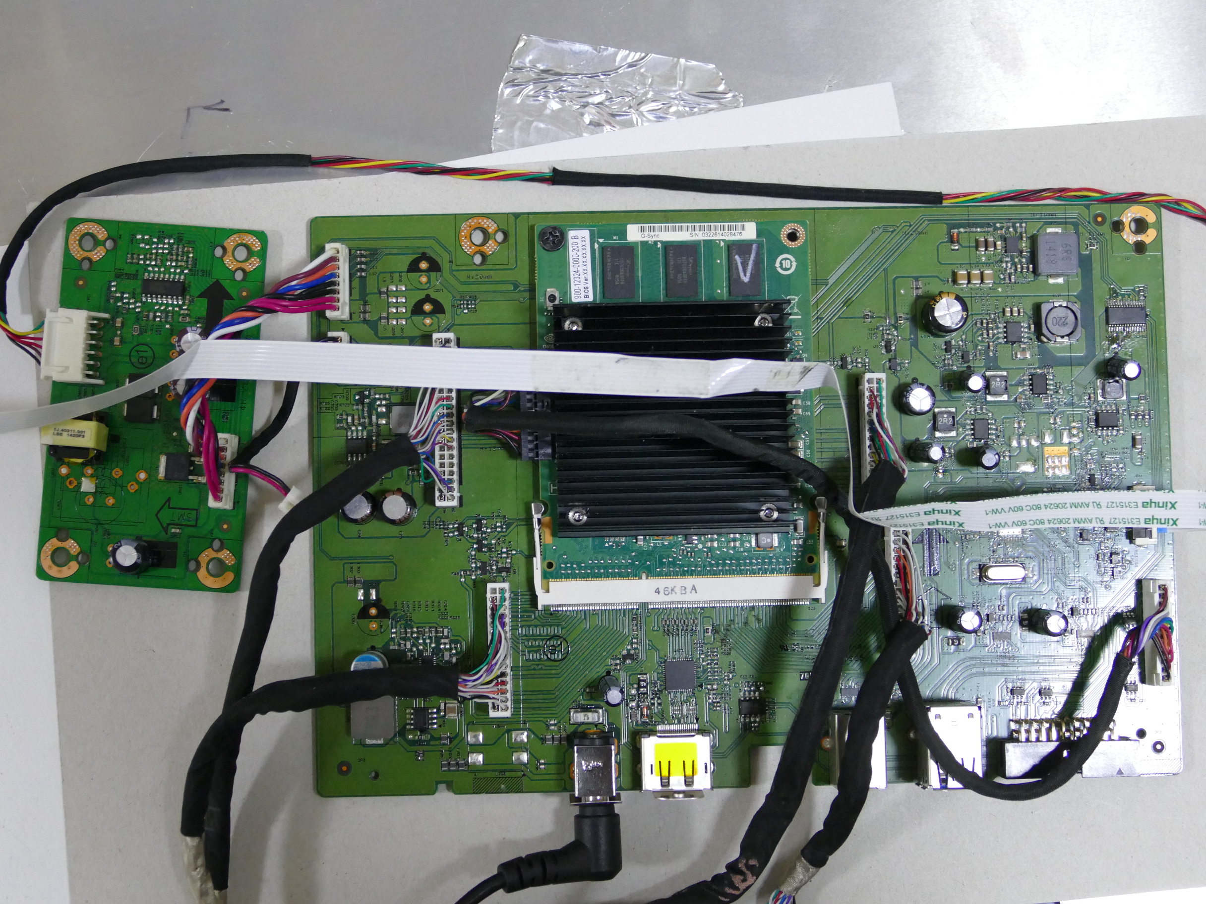

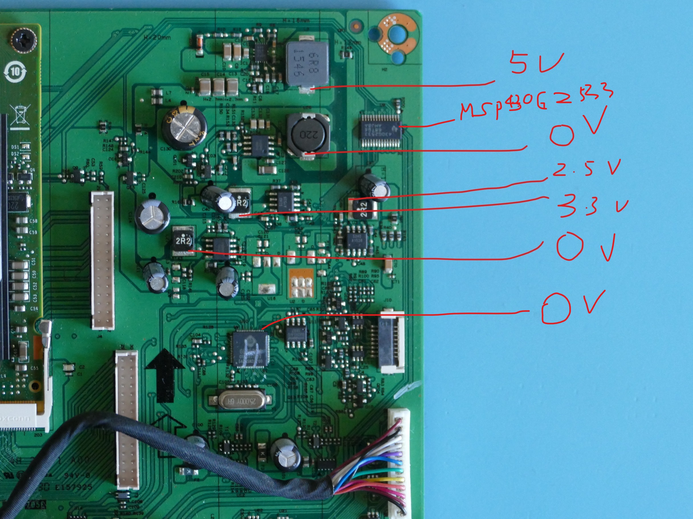

      I got problems on my monitor ASUS pg279q.can turn on , display asus logo,then connected to pc ,no display. display: no signal.press menu button,no OSD. detect it 5v,3,3v,2.5v on mainboard.onthe 2 point no voltages .may be MSP430g2533 IC problem ?
      Can be fix?please see pics

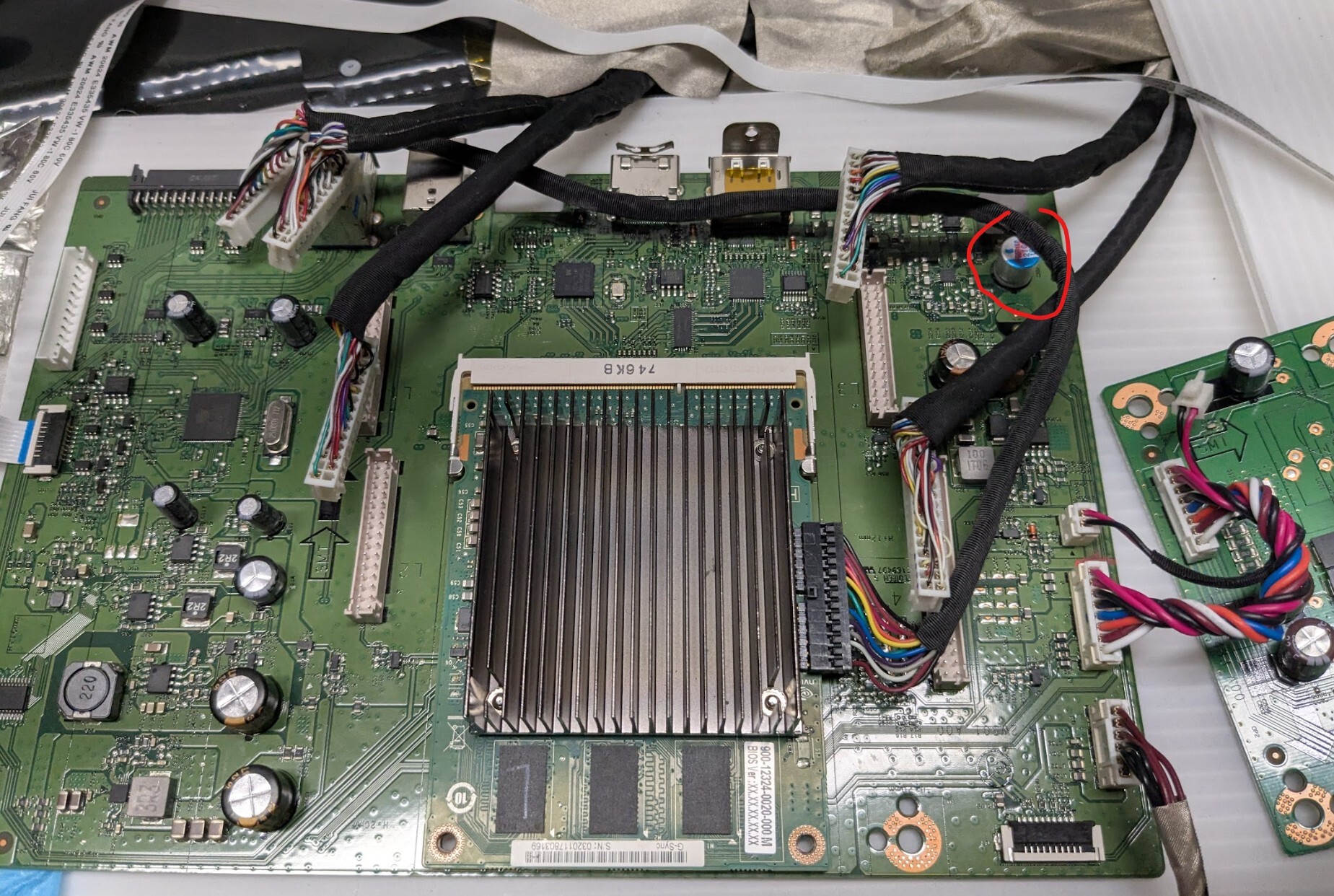

        pics 2
          Re: ASUS PG279Q dead panel
          LED Flashing .
            pics4
              pics5
                Any fix that panel? i have same issue

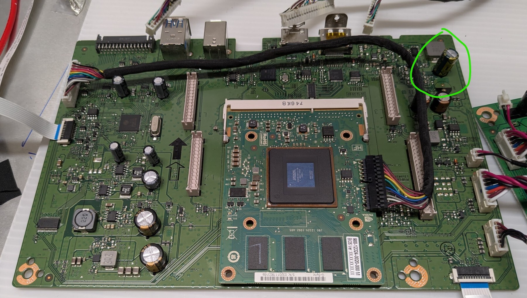

                  I have same voltages but my Asus pg279q can't be turned on. No standby light and no light on g-sync board. All fuses are tested ok. No short on the mainboard.
                  Reading uart from power control chip 430g2533 is successful. So chip is working. Pressing menu buttons caused different output on uart.
                  Does anybody know which chip controls the standby LEDs?
                  Does anybody know the voltages to the g-sync module. Especially the connector of the side of the board.
