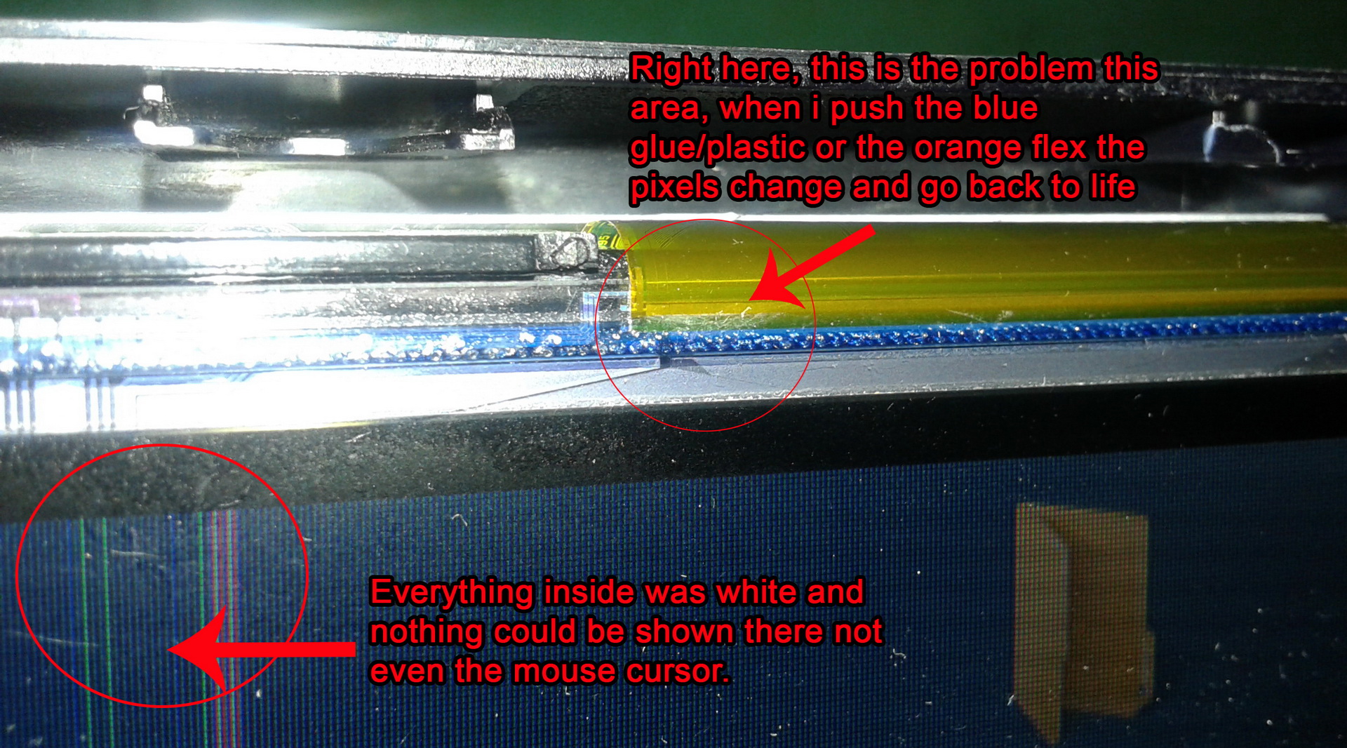

        well i've tried for the last 2 hours and the line won't disappear.
        I literally touched, put pressure, shake, pressed and more with little to almost no force and then i did it with much more "violence" but nothing happened, i did this with all the perimeter of the screen, with my fingers and a plastic spatula.
        I touched the screen, the blue glue, the tab-bonds, the flex cables/circuit, i moved them, let them hang with no screws, pushed them in different ways and still nothing changed, finally i watched the whole perimeter looking for something broken or unusual but nope, visual inspection reveals nothing.
        You get used to this line tho, it's annoying but still works and since you guys told me the conversion process had nothing to do with this problem i won't disassembly again, i thought that maybe soldering the wire to the capacitor or some bad soldering work with the cables (like shorted joints) caused this problem but i don't have any basis to affirm such thing so ill stick to the tabs issue

          the problem is the connection on the edge of the glass itself.
          it can just happen with age, or by moving it when stripping the screen to change the lights.

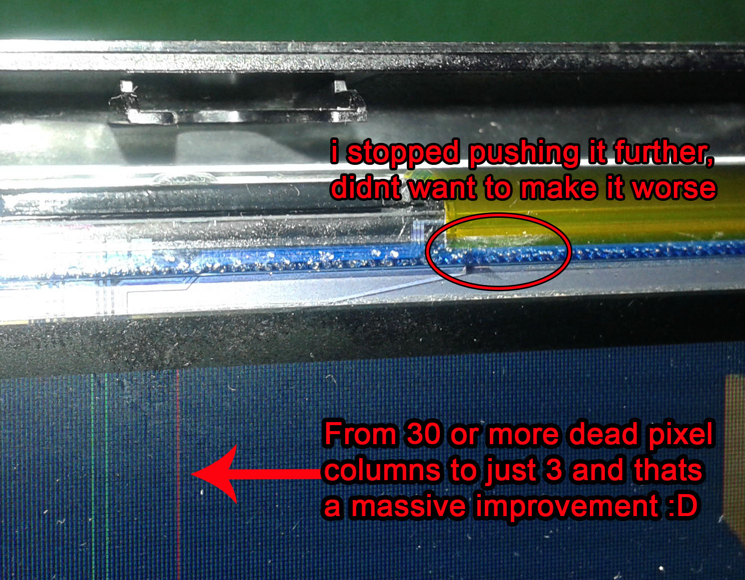

            I FOUND THE PROBLEM and it was exactly what you told me, the connection right there between the flex orange circuit and the glass like in between the blue glue/plastic.
            Right now i just have 2 lines, a green and a red one and that's much better than the old ugly thick vertical white line i had (for anyone interested i uploaded a pic showing that dumb white line, look at page 1).
            Maybe it won't stay like this forever, if i move the monitor or clean the screen i fear that some lines may come back but i could always push it back and remove some or most of those dumb lines, anyway im very happy now lol but is there anything else i could try to keep it like this or remove entirely those lines? btw i did it with my fingernails
            Gonna get some sleep now and see how it behaves tomorrow, thanks once again for all the help

              some people have tried putting a bit of foam between the connection and frame so it presses when it's assembled,
              but one of your pictures looks like the glass is cracked??

                Oh and the glass isn't cracked, that's the way how it is coz every single flex circuit section has the same "crack" when it reaches the glass, well thats what it seems to me.
                I just turned on the computer and found just one green line, i pushed once again with a needle (not the pointy side) till i found the area for that pixel column and now the monitor doesn't any line, like if nothing ever happened
                And yea i could use some foam between the panel and the aluminium frame that way it would give some pressure but hmmm it may or may not work, what i was thinking is maybe i could CUT the aluminium frame and leave that place clear so next time a line appears i could remove the plastic frame and push the glue or the tab, it would be annoying but better than keeping that ugly white line, im gonna make a photoshop picture about this hillbilly idea of mine
