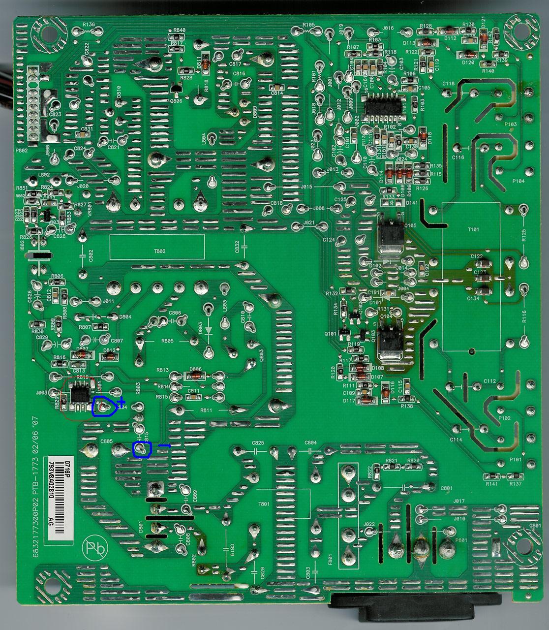

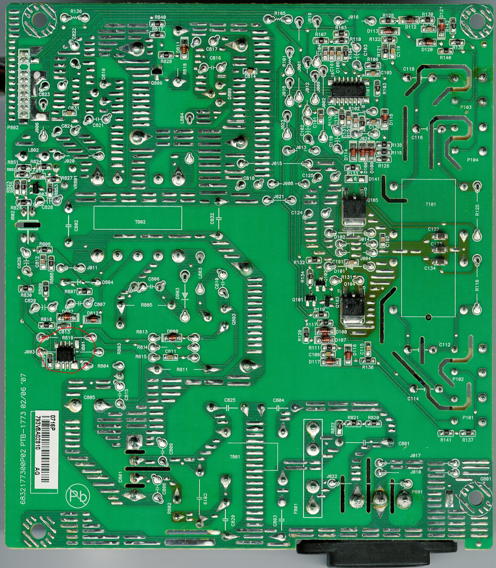

                                      Also, I wanted to make sure, that this was the chip (circled in red)? It has the right number of pins and it says I801 by it (not IC801, same thing?).
                                      From what I can make out the IC reads:
                                      CA 1530A
                                      651D202
                                      MnG7311
                                        #59

                                        Maverick,
                                        It appears this is a radically different power supply board. The most likely part number for the SMPS controller is TEA1530AT. By the way, I have a large magnifier I use to determine part numbers. Even then, it is tricky.
                                        In any event, the first thing to determine is the power supply to the SMPS controller. I've attached an edited version of the picture, check the voltage between the two circled points.
                                        By the way, don't use the metal chassis as a reference when measuring voltages on the line side of an SMPS. I just spent a few minutes trying to figure out what the wave form would be and got a headache.
                                        PlainBill

                                          That measures 160.1 v.
