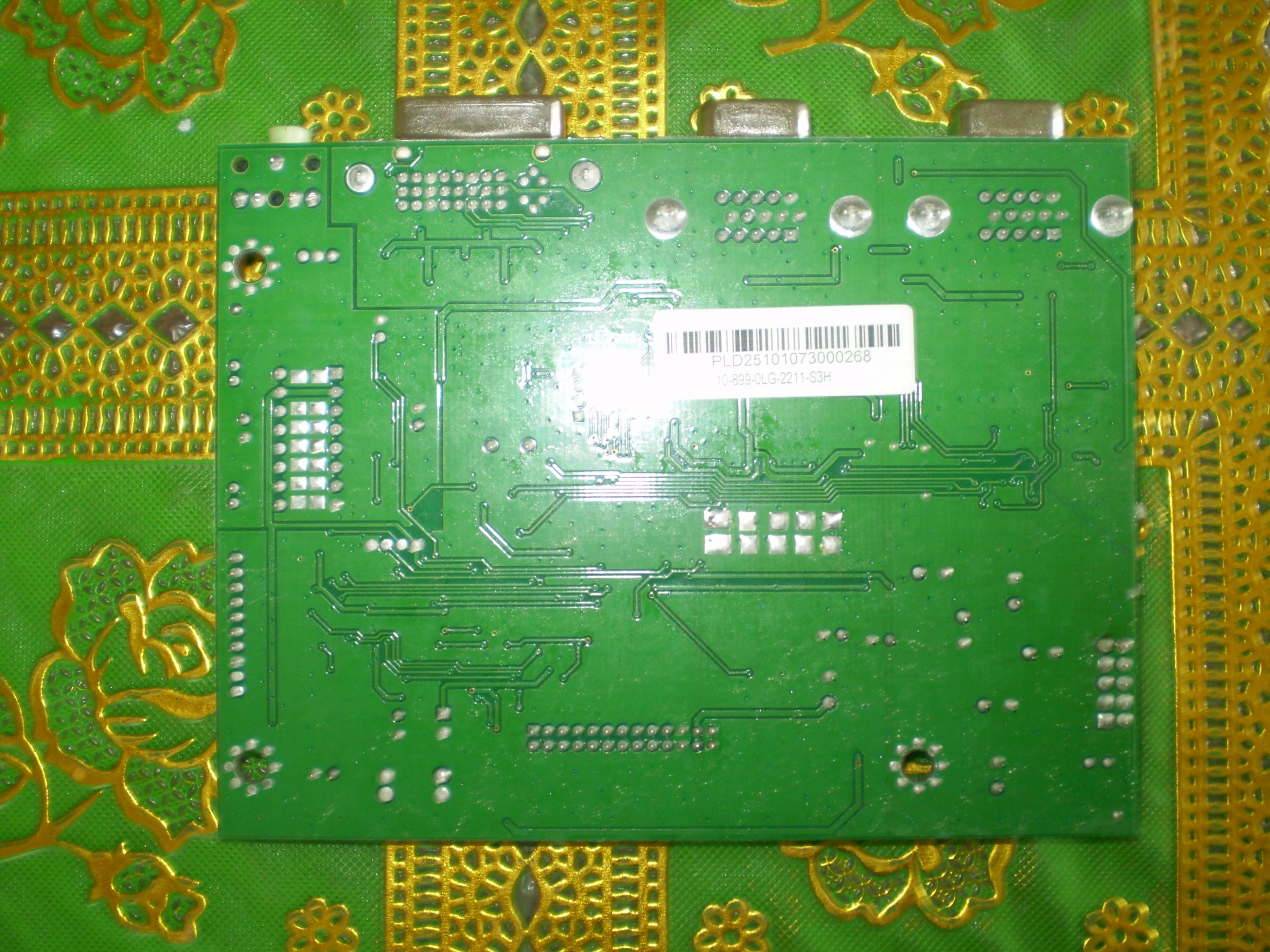

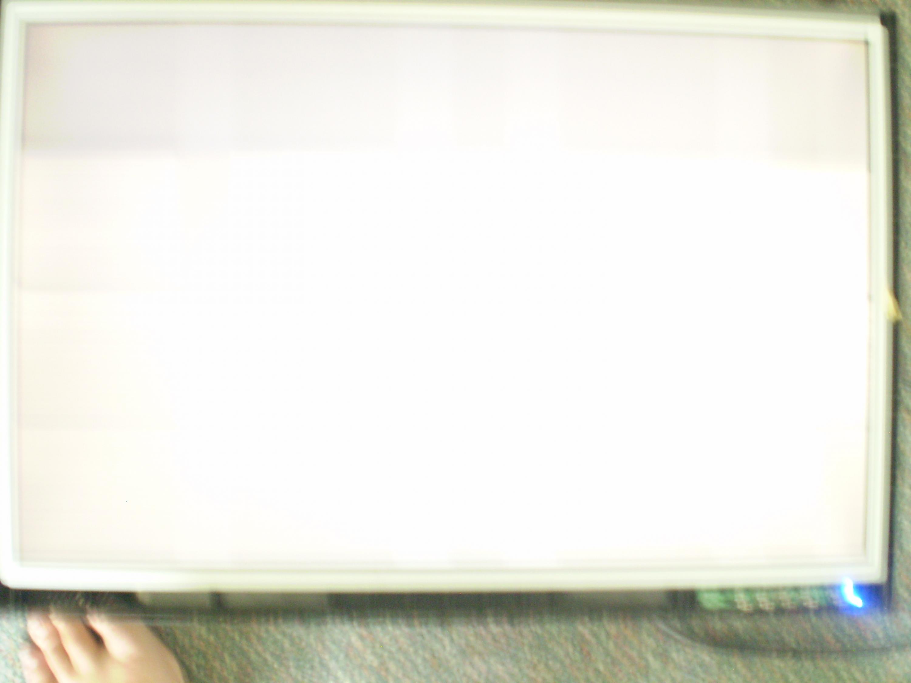

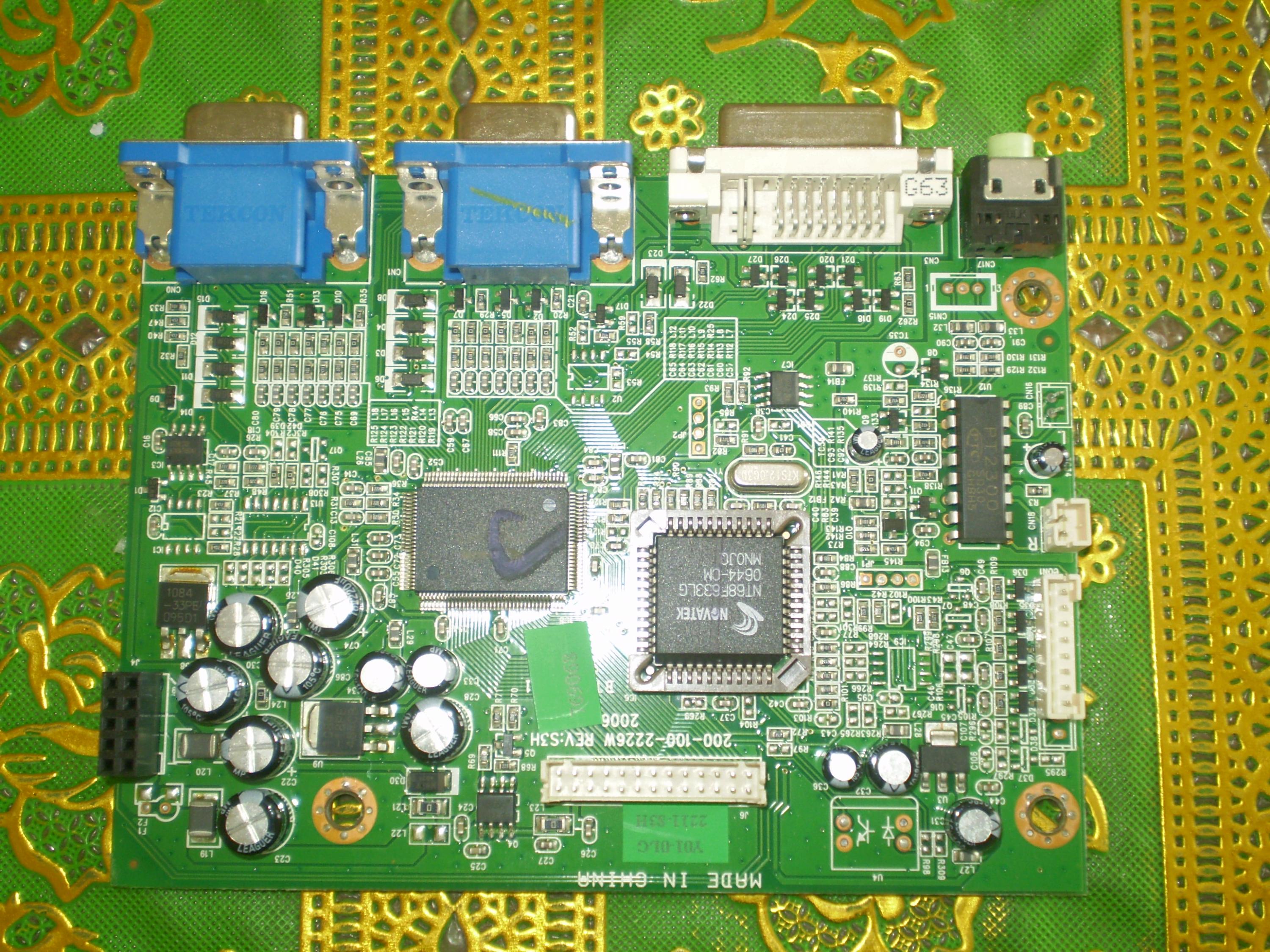

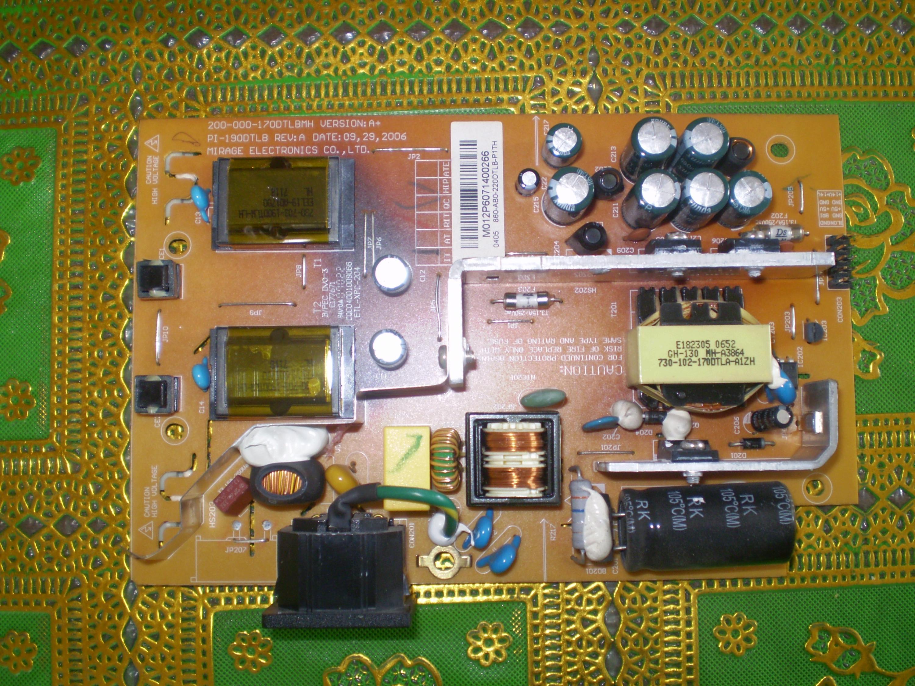

      hi I have a problem with my lcd monitor when i turn it on it goes white for a few seconds and then goes black.
      I have a 200-000-1700tlbmh board the caps look fine.
      any help would be appreciated

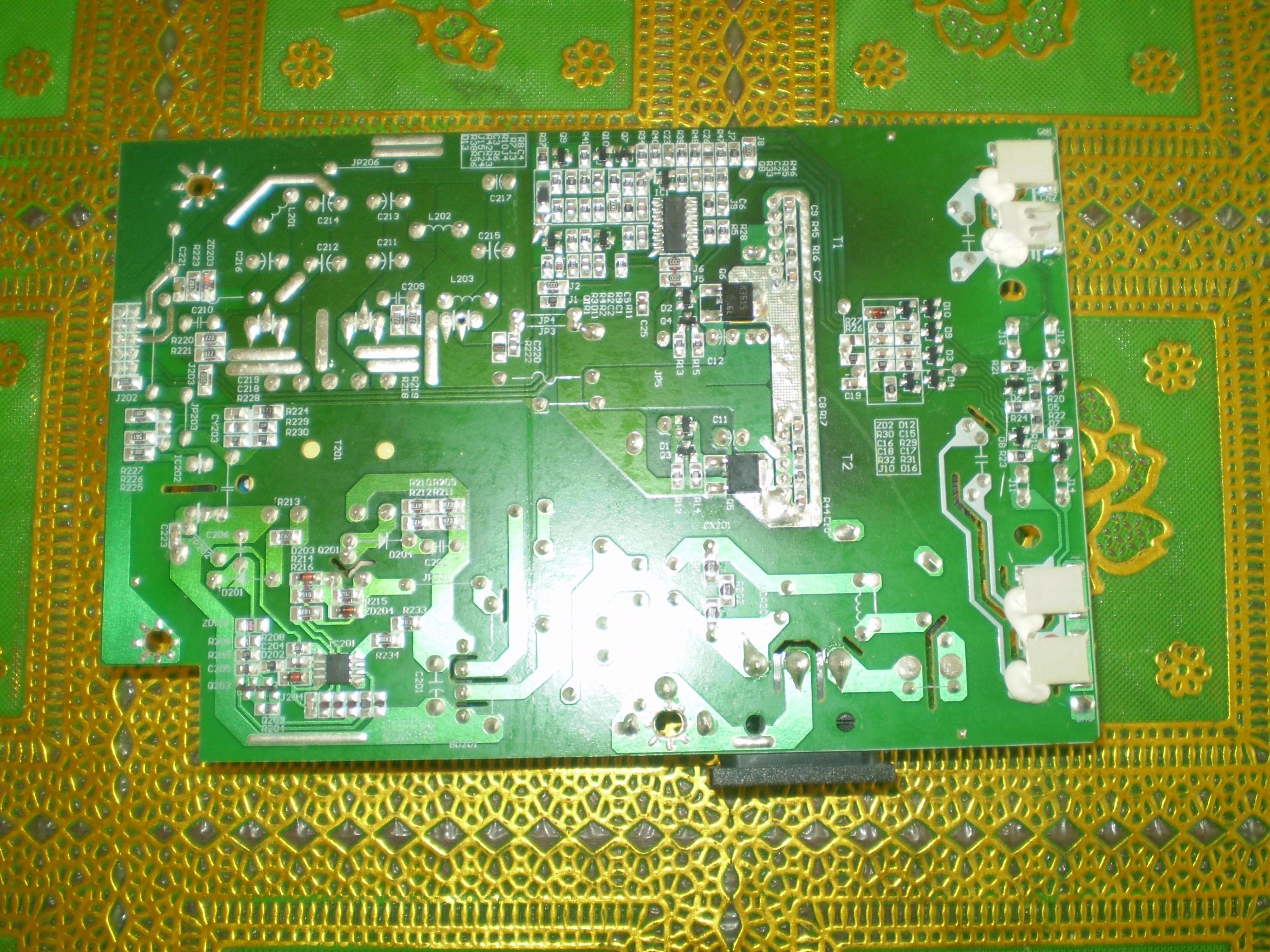

            Green caps, third picture. Those need to be changed.

              do you mean the the caps on the powerboard?
                Re: KDS K-92BW Turns off
                You may have more than one problem, one is that your power supply has bad caps, another one is that your LCD panel T-CON may not be getting the voltage feeding from the main board or the T-CON itself may have problem. You need to at least replace the bad caps first, bad cap can look normal without having domed top.

                  Yes. For a start. You can't really diagnose accurately with those caps in there.

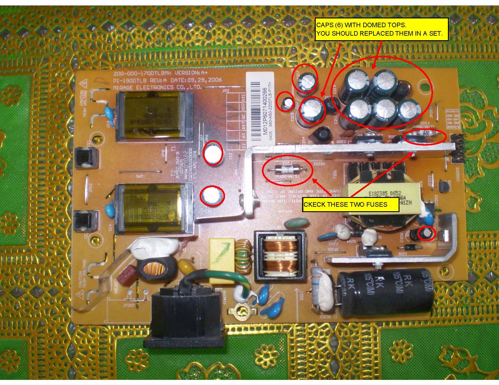

                    where do i but the caps do you know?
                    how do i check the fuses? do i use my multimeter?

                        I have check the fuses with dmm and they both read 000 so im guessing they aren't blown. Is this correct?

                            Hi
                            1where do i but the caps do you know?
                            http://www.activecomponents.com/Page-Contact-Us_3.aspx
                            appear to sell good make caps
                            A lot of NZ members mention Jaycar?
                            Digikey
                            Mouser
                            RS direct.
                            2how do i check the fuses? do i use my multimeter?

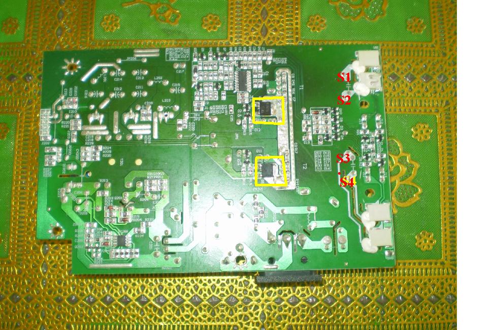

                            Yes - as you have done - but was not required as it would not work as much as it does if the fuses were bad.
                            3 can I check the capacitors with a multi meter?
                            No, unless your meter has a capacittance test on it -
                            even then its not a good test.
                            I think you will need to change all the caps except the large one
                            BUT before you buy caps I want you to test the secondary resistance on the inverter transformers as the board looks
                            a bit browned I will post where you have to test soon.

                              Right Power off meter on ohms 2000 measure S1 >S2 and S3 >S4
                              and post the results.
                              I have also marked in yellow two components Q5 Q6 What is the part Number on them and is the bottom one in your picture burnt or is it just the picture.
                              If you take more try not to use flash and more natural light.

                                which components are marked yellow please
                                how do i test s1>s2 and s3 >s4 are they on the board if so where?
                                The two rectangle like parts on the board say they are T1 at top and t2 at bottom does that help?

                                        when I test s1 s2 s3 s4 they all come up with 000 the part number on the resistors in yellow is k3615
