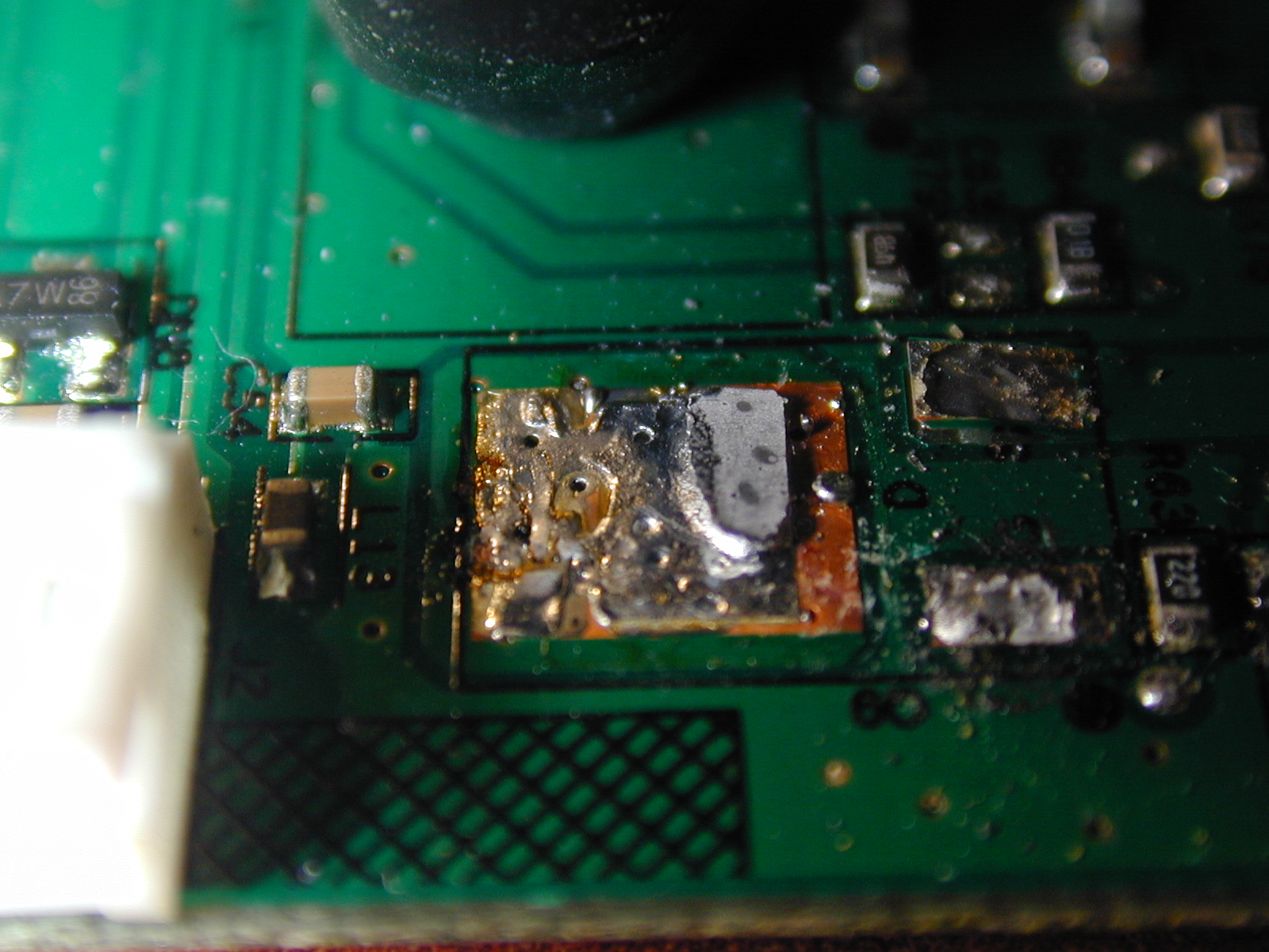

                I unsoldered the zener diode ZD701. It is located just beside the 3 A fuse with my soldered on ugly big wires.
                Diode is shorted according my ohm meter.

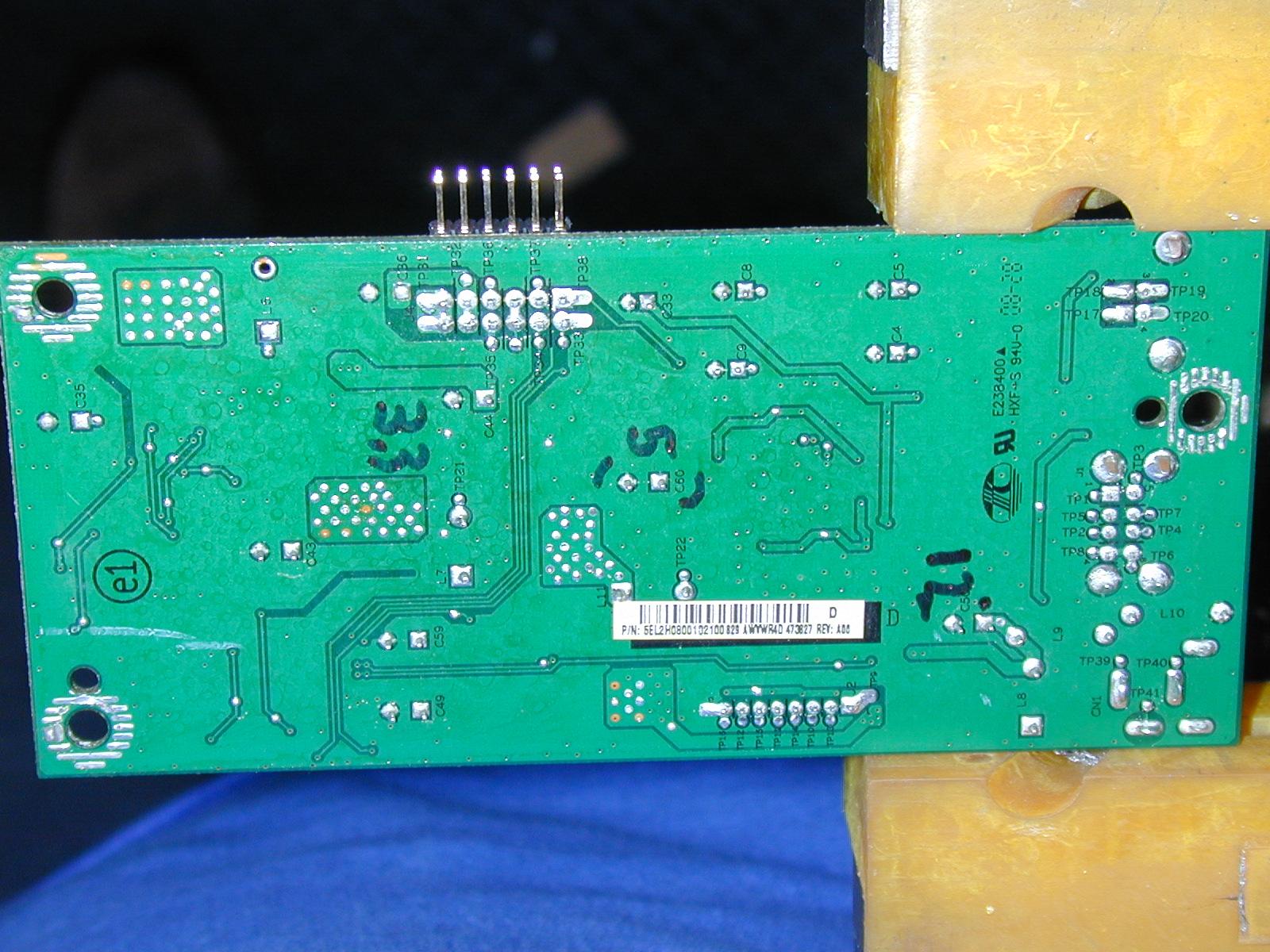

                      After I removed the zener diode, I powered on the board with 19V from the power supply.
                      New fuse did not blow. That is a good news. Some progress anyway.
                      Now the bad news is 3.3V reads 19V, 5V read 5V so that is OK and 12V reads Zero.
                      So that leaves me with identifying two bad components to get 3.3V and 12V. Not to be concerned about the 12V as I understand this is only for the speaker, but I will try to fix it anyway.
                      Back to the reading. If anybody can pinpoint this issue the better.

                          Re: Dell UltraSharp 2007Fp 2nd problem
                          Since the board is fed with 19v now you understand why the Zener failed, it tried to regulate that down to 3.6v or whatever it's rated for, obviously with a power rating of maybe 1/4w that did not work for very long
                          When it shorted out then you have a nice connection to the ground, thus the fuse blows...
                          The reason for the 3.3v being 19v is that whatever Mosfet is on that board to regulate that voltage is shorted too...

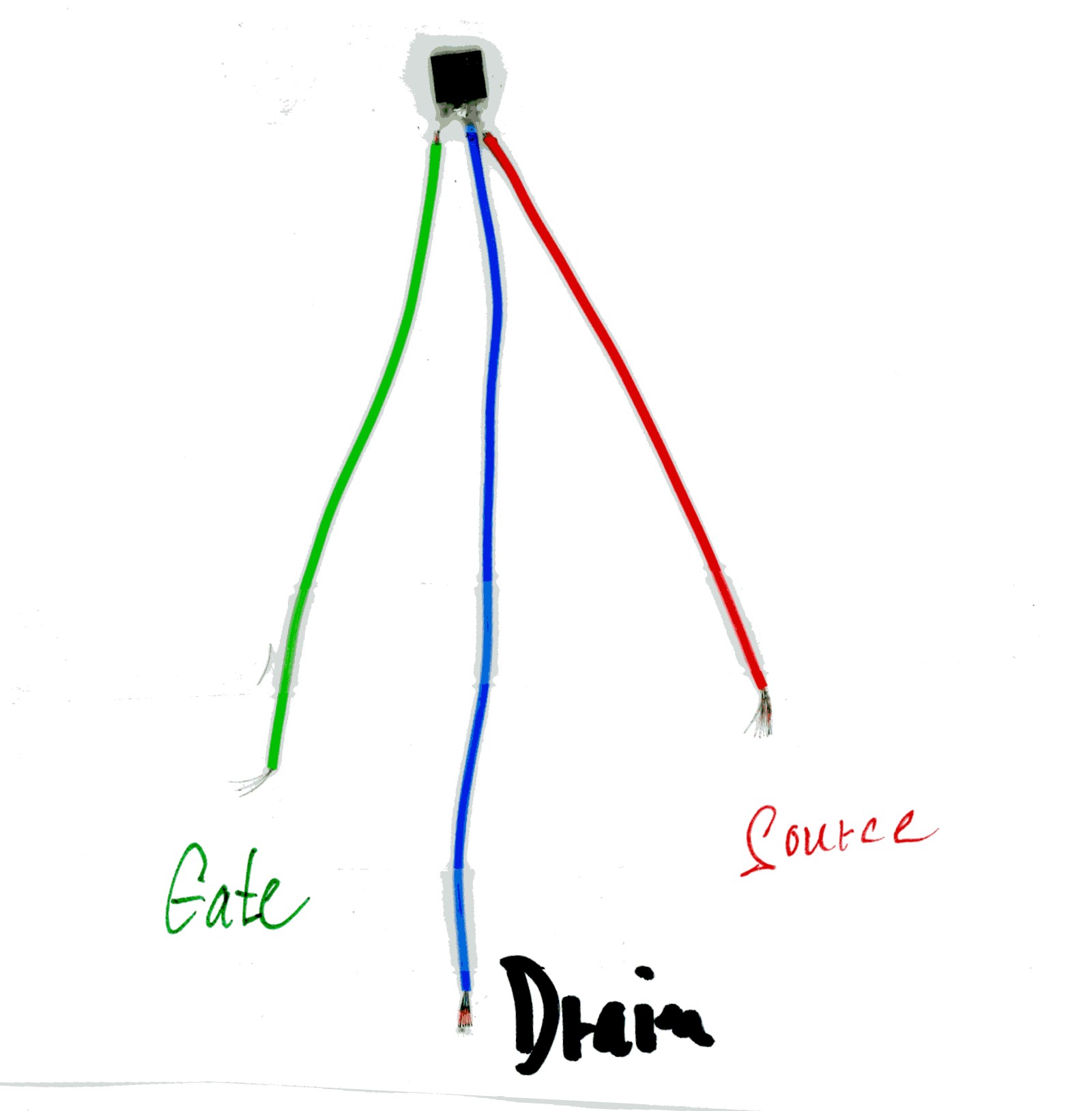

                            Great learning curve. Watched video on YouTube how to remove the MOSFET.
                            It looked much easier in the video clip.
                            Anyhow, removed the Q9 MOSFET for 12V as I figured if I bugger that one all I am loosing is speaker power. Laid it out on a paper (courtesy of YouTube) and tested.
                            https://www.youtube.com/watch?v=mHpY_3tzJTc
                            Did 4 tests and it looked like failed the #3 test not switching “ON”.
                            So now I will order some of the 2SJ590 and replace Q9 for 12V and Q6 for 3.3V and Zener Diode 3.6V 500mW ±5% Surface Mount SOD-80 QuadroMELF.
                              That's because the video shows a P-channel MOSFET being tested, whereas you most likely have an N-channel MOSFET.
                              To test N-ch FET basic "on" function, you put black (-) DMM probe on Source, touch Gate with red (+) DMM probe, and then put red (+) DMM probe on Drain. DMM should show a low resistance (if using a manual multimeter, use lowers resistance scale.) Now, if you short FET terminals with your finger (particularly, Gate to Source), and try to measure resistance between Drain and Source again, MOSFET should appear open (off) again.
                              *edit*
                              Sorry, I was wrong to assume you have an N-ch FET. According to budm's post in that thread, Q6, 9, and 14 are indeed P-ch FETs. But I suppose the above info is still good if you want to check an N-ch MOSFET, so that's why I left it there and didn't delete it with the edit.

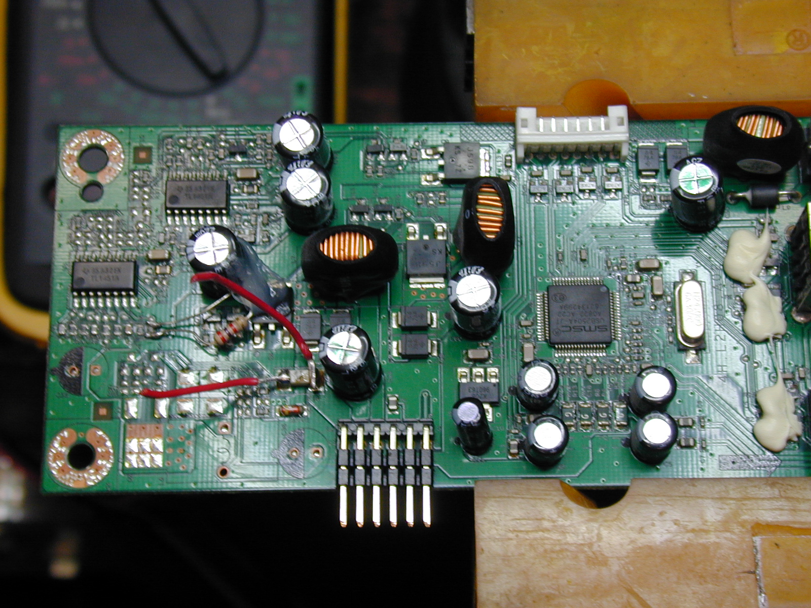

                                  While waiting for the parts, I stumbled on all 4 boards on eBay. So I ordered them all.
                                  Finally I got a chance to replace 3 Mosfeds, ZD701 Zener, replaced FD3 and FD4 previously. Applied 19 Volts to the board and still did not get 3.3V and 12V where expected.
                                  So I plugged all the boards tougheter and connected to monitor. Nothing.
                                  Looks like job for rainy day.
                                  Since I was tired of the mess, I installed the new USB board from eBay, still nothing.
                                  Then I installed the used Logic board purchased from eBay at the same time. and put it together. Well I'll be darn, all lit up the way it is supposed to.
                                  Anyway I assembled to monitor, no screws left over
                                  And it has been plugged in and connected to PC for couple hours and all is well.
                                  So unfortunately I have no magic to report, but as I am not all that good at these thing all I can say that Logic board was faulty, which caused the USB board not to function.
                                  So now I will do more components replacement just to hone my soldering technique as it is atrocious.
                                  Thank you all for being there.
