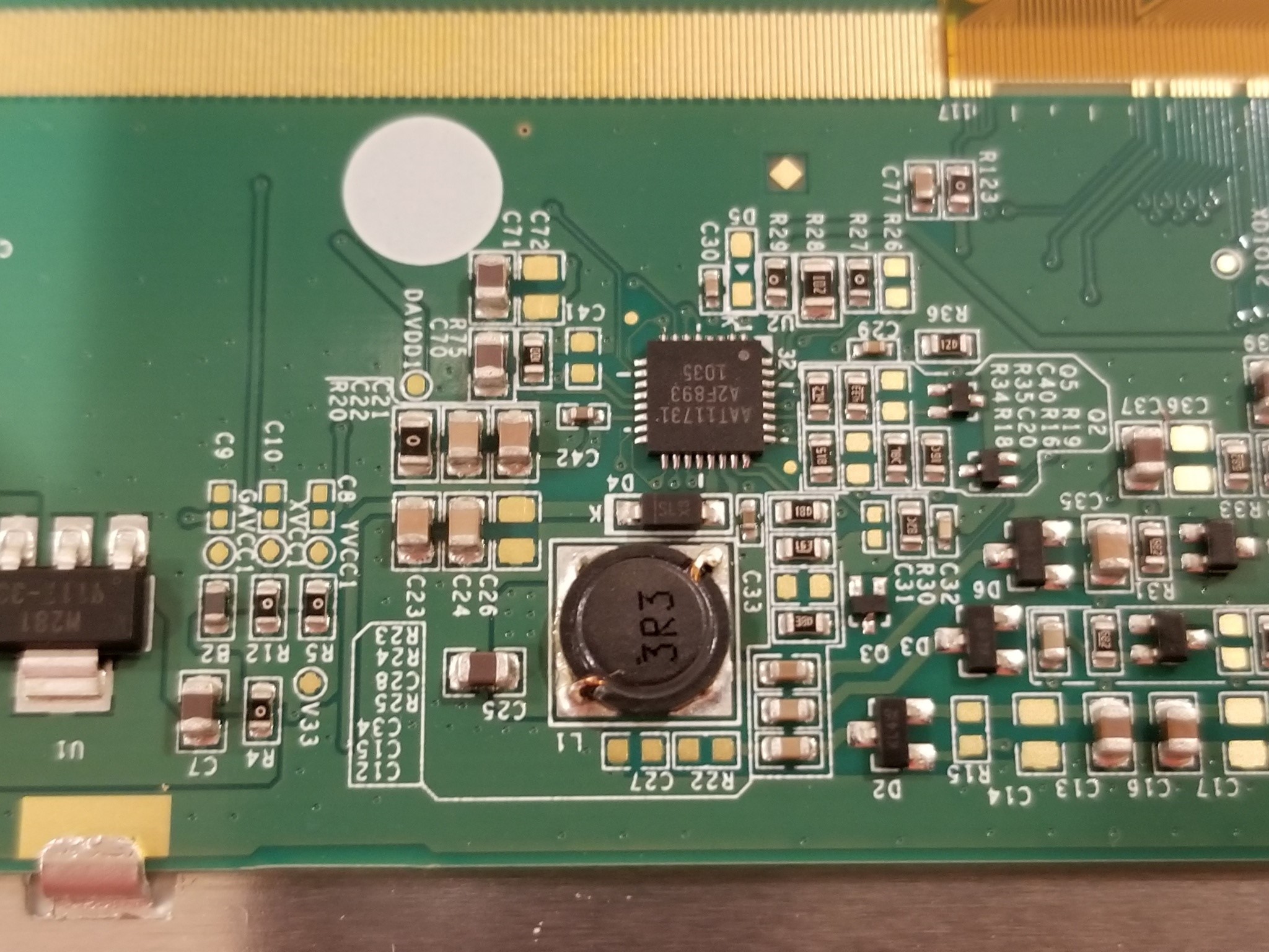

    At this point, some pictures of the monitor's boards would help. Post one pictures showing how all of the boards are connected, as well as some individual pictures of the boards.

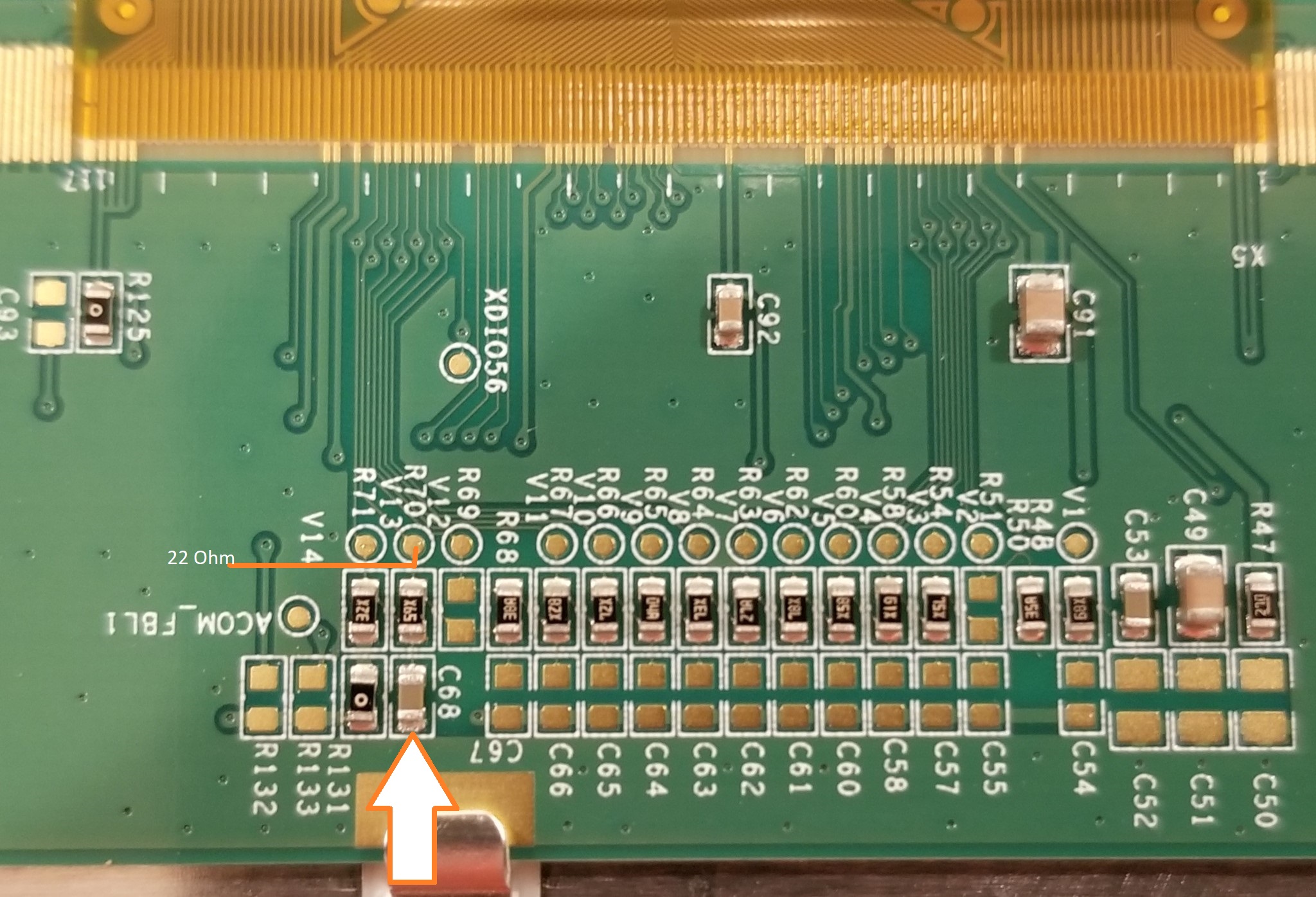

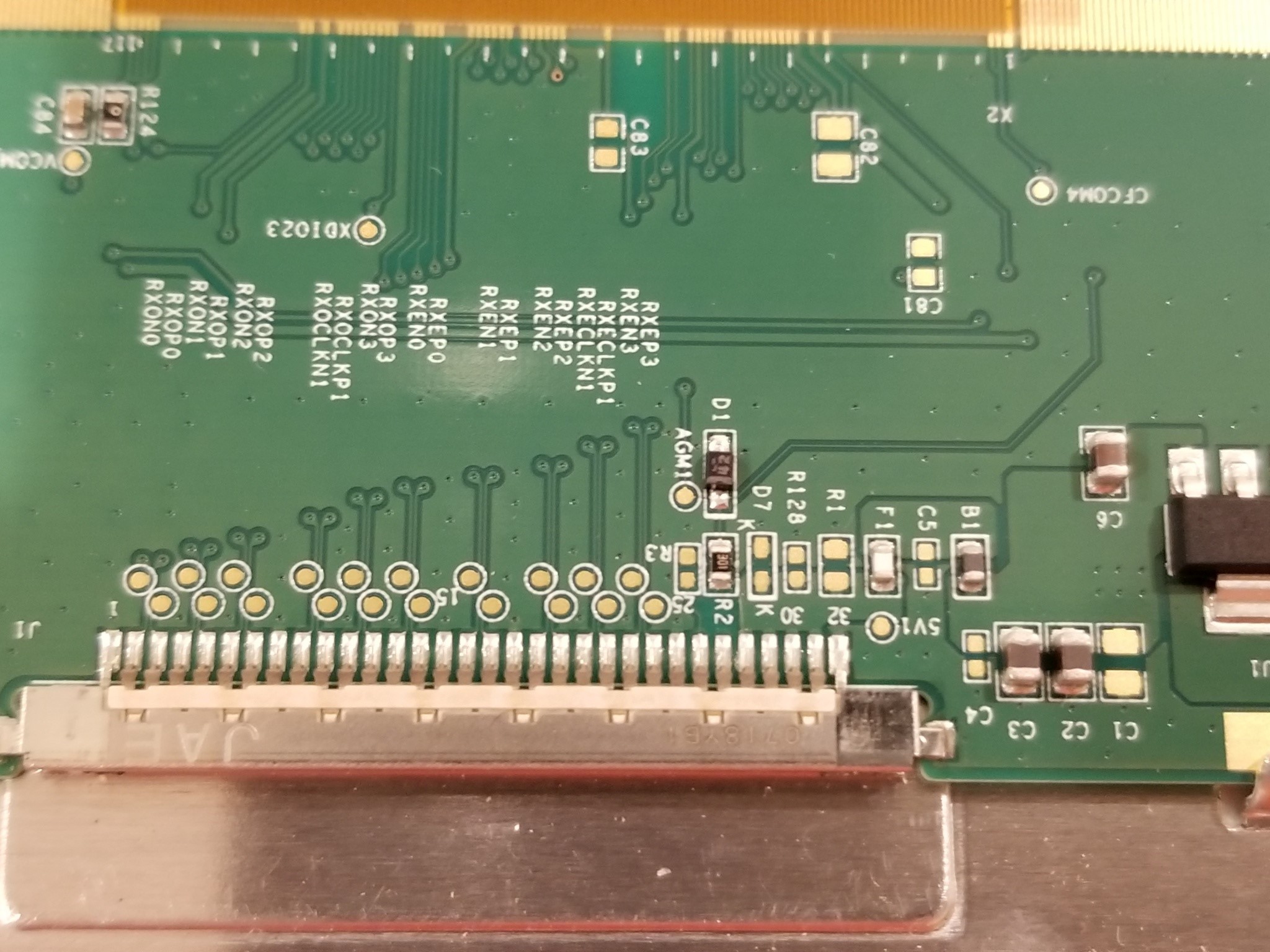

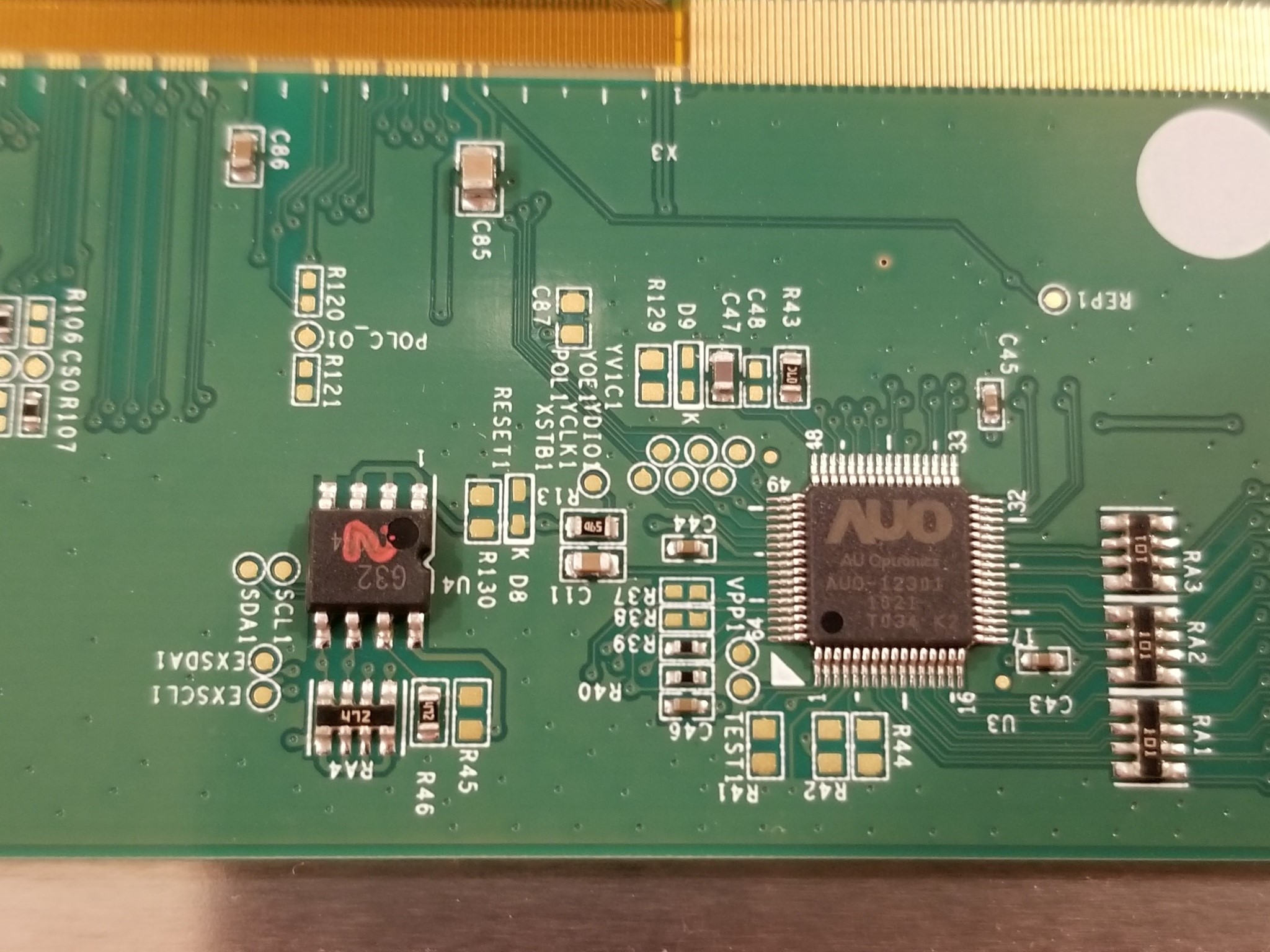

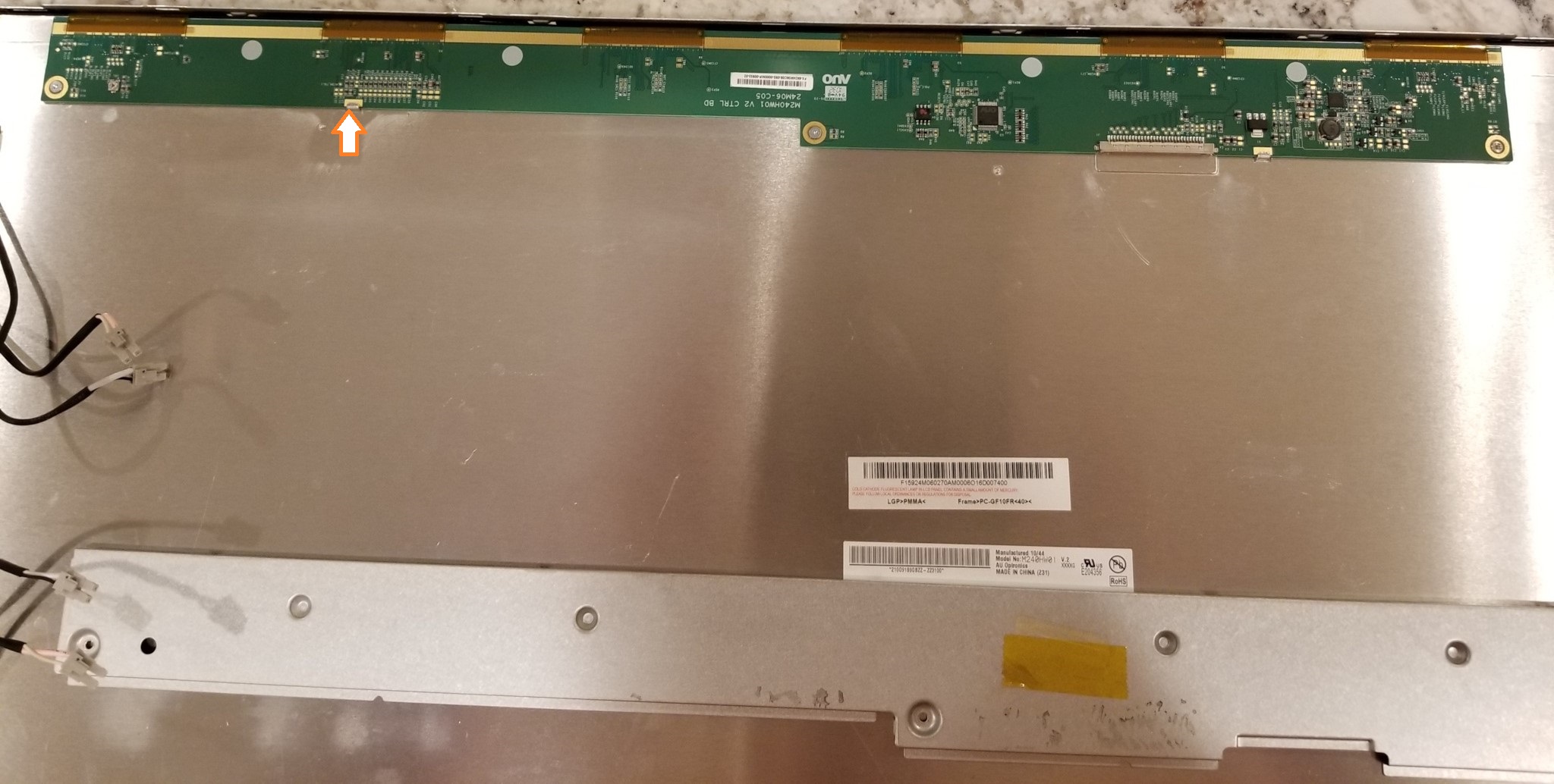

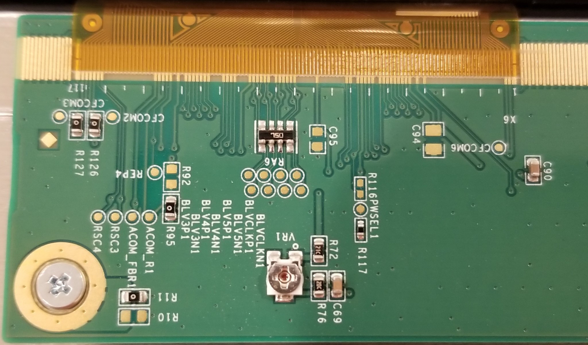

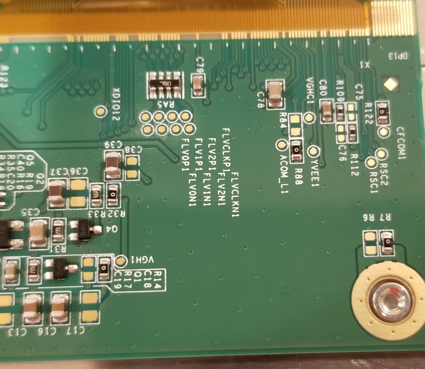

            I have found only one capacitor, that was showing 22 Ohm across it.
            I have also measured the same resistance, next to it(left) on the 0 Ohm resistor as well. It is hard to tell, if they are in parallel, but I don't believe that they are.
            An overall picture and than, from left to right.
            It's been a while, since I have posted a repair attempt and this is my first time, using the Note 8 for pictures. They are very good pictures, right?

              Hard to day if that reading is normal or not (though I think usually low resistance readings like that aren't a good thing.)
              So check the following resistances to ground, first:
              5V1
              DAVDD1
              VGH1
              VGHC1
              YVEE1
              V33
              V1-V14 test points (where you show that 22 Ohm resistance is)
              VPP1
              Post what results you get here.

                  V1 through V14 are for the TFT Gamma voltages (i.e. used for color levels).
                  Yes, V13 and V14 indeed look odd. Though, to be completely honest, I'm not sure if that is normal or not, as Gamma voltages are one thing I never really paid much attention to in the past in my repairs. I hope budm or someone equally knowledgeable sees this, as they might know better.
                  That said, generally my intuition is that if you see a low resistance reading across any MLCC / ceramic capacitor on the t-con of an LCD monitor, then the only way to know it's not shorted is to remove it and check its resistance outside of the circuit. Do that until all caps with low resistance caps have been removed and checked. Of course, save the removed caps, as they might be fine and could be put back on the t-con if they are OK.
