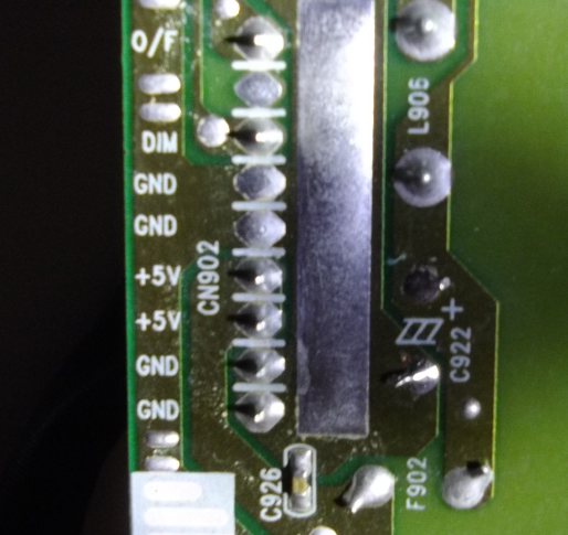

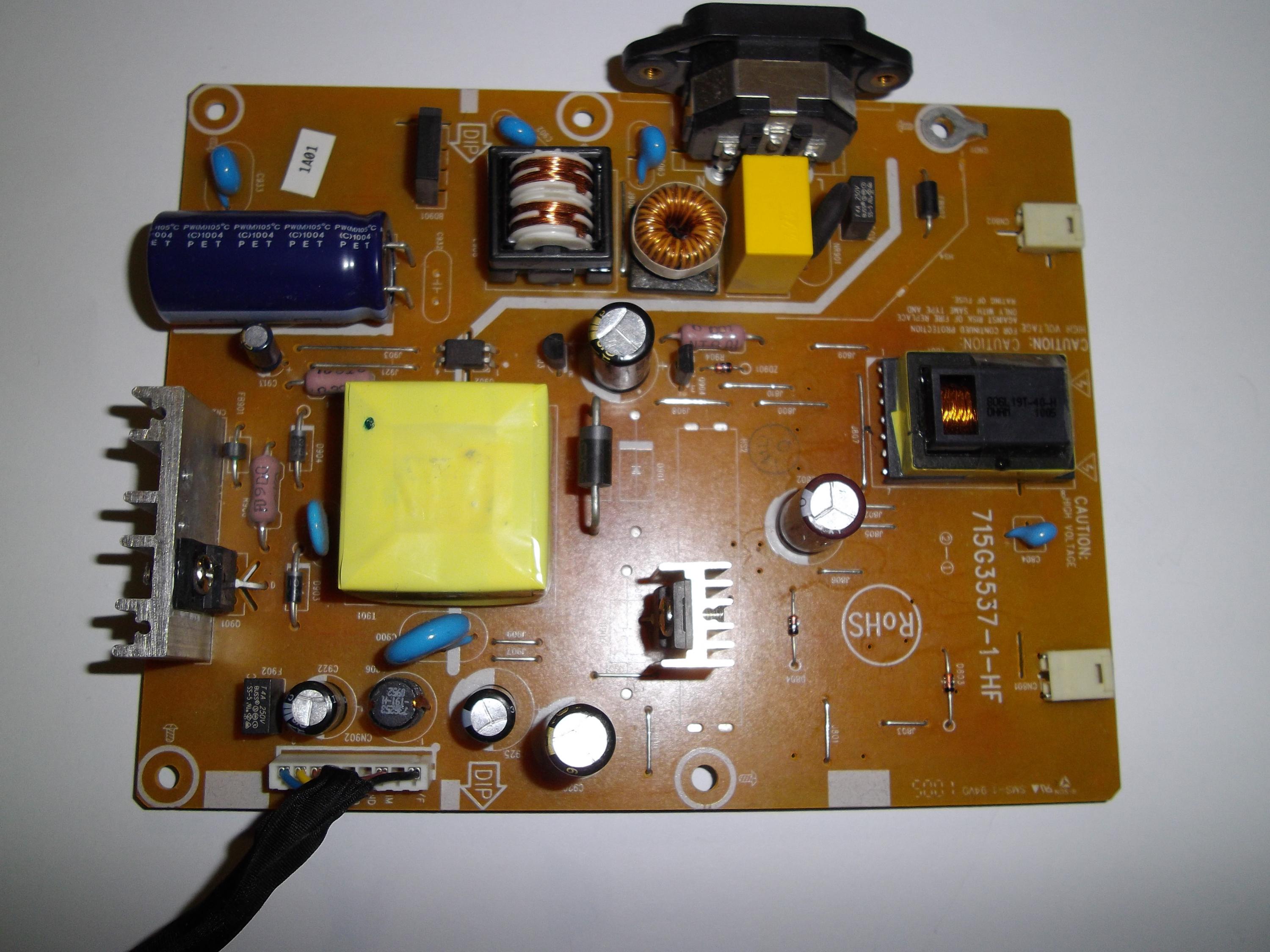

    It's fairly simple. Pin "O/F" on the power/logic board is the backlight On/Off signal for the original inverter. You can connect this signal to pin "ENA" on your new inverter board ("ENA" stands for _enabled_ - i.e. turning your new LED inverter driver board On or Off).
    Likewise, pin "DIM" on the power/logic board is typically an analog voltage between 0 and 3.3V that controls how bright the backlights of the monitor should be. Connect this pin to the "DIM" pin on your new LED inverter driver board.
    "VIN" on the LED driver board is your monitor's VCC rail that powered the original CCFL inverter.
    And "GND" is obviously ground on both.

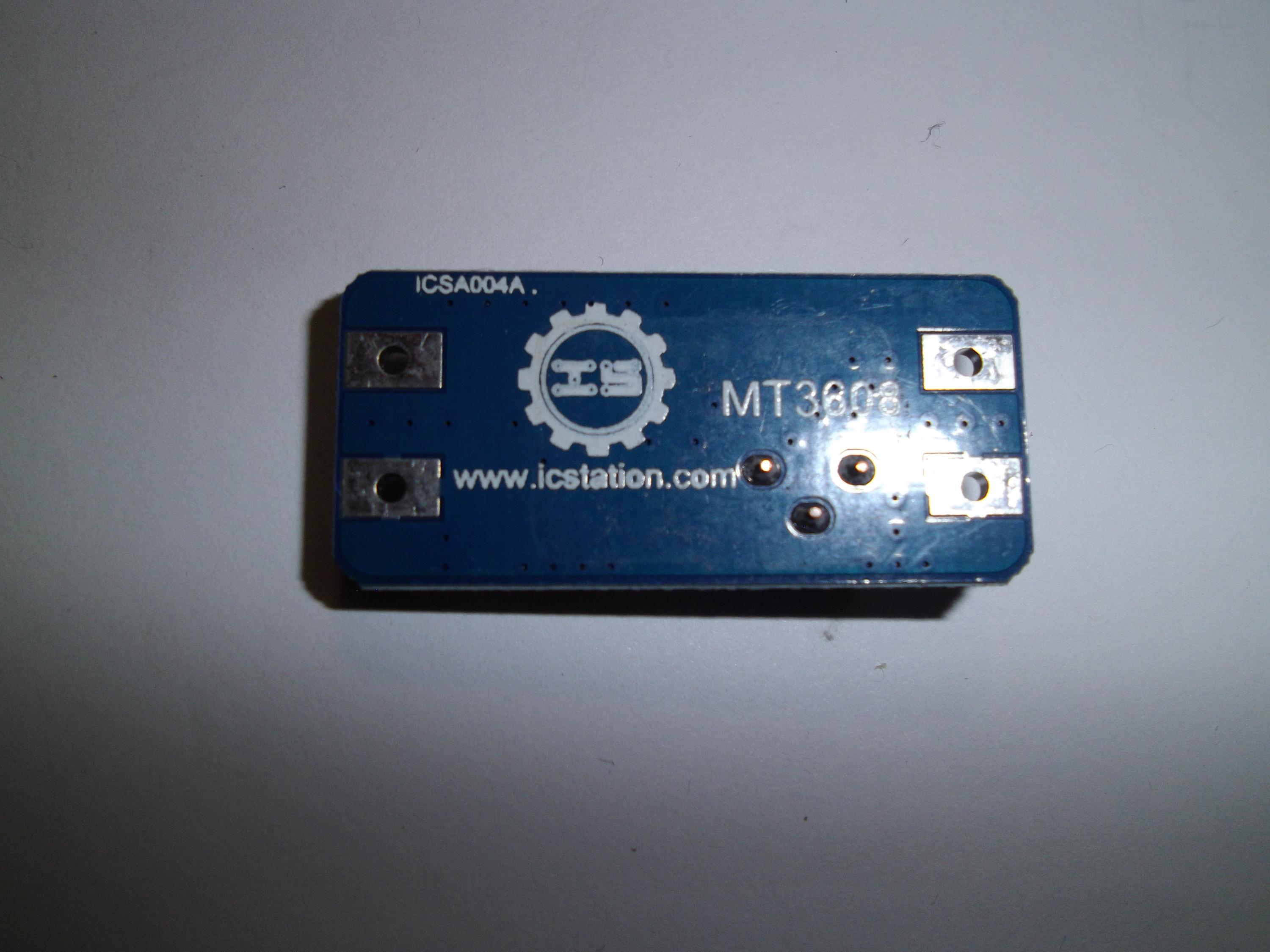

    Last but not least, I'm not sure why you bought mini step-up board to chance 5V to 12V. Your monitor's power supply should have a 12-15V rail already going to the original CCFL inverter. Just remove the jumpers that go to the CCFL inverter and wire the output of that voltage rail to the "VIN" of the LED driver board.

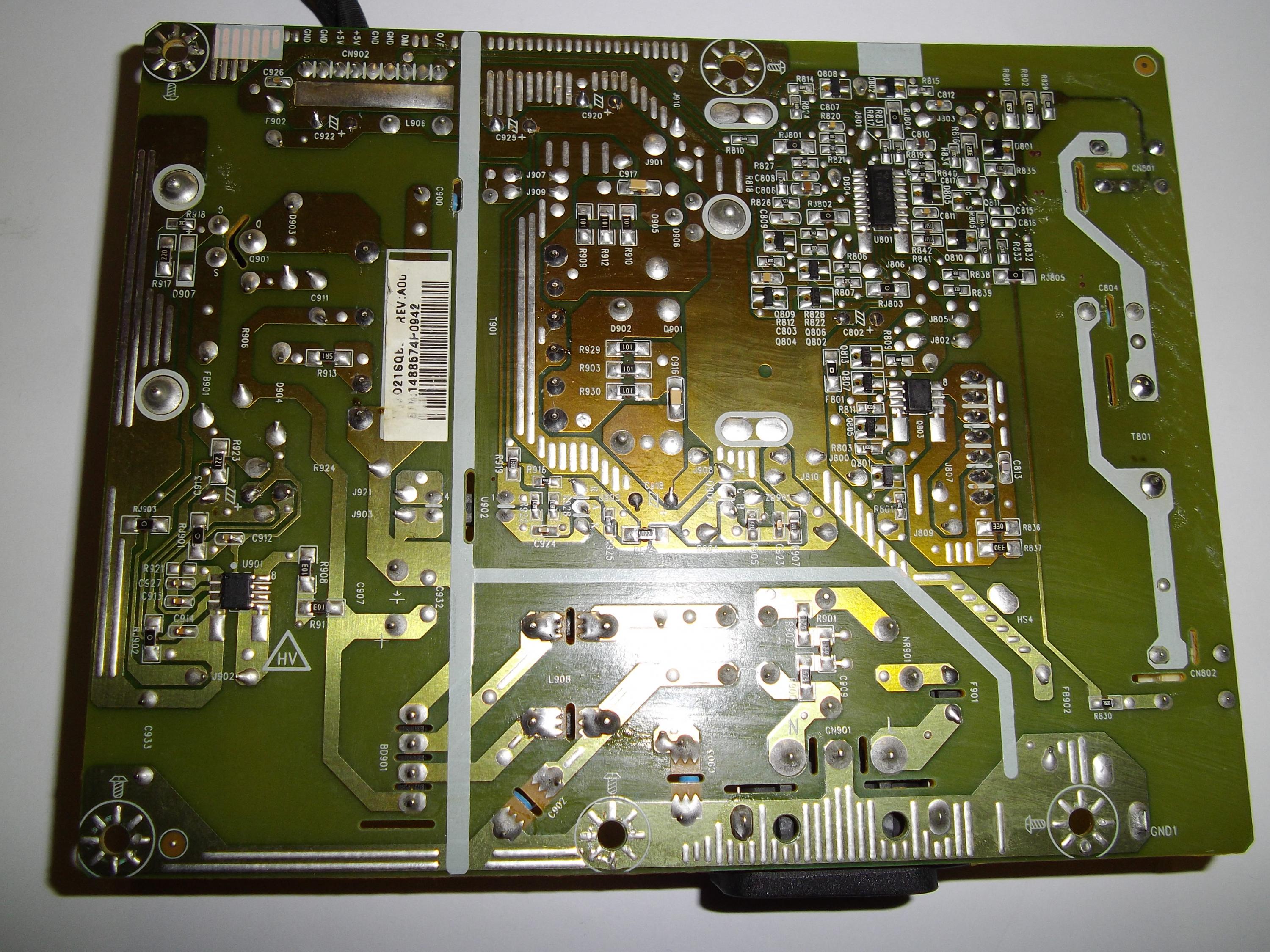

    If still in doubt about what I said, please post top and bottom view pictures of your power board, as well as the other boards you have so that we can give you more precise instructions.

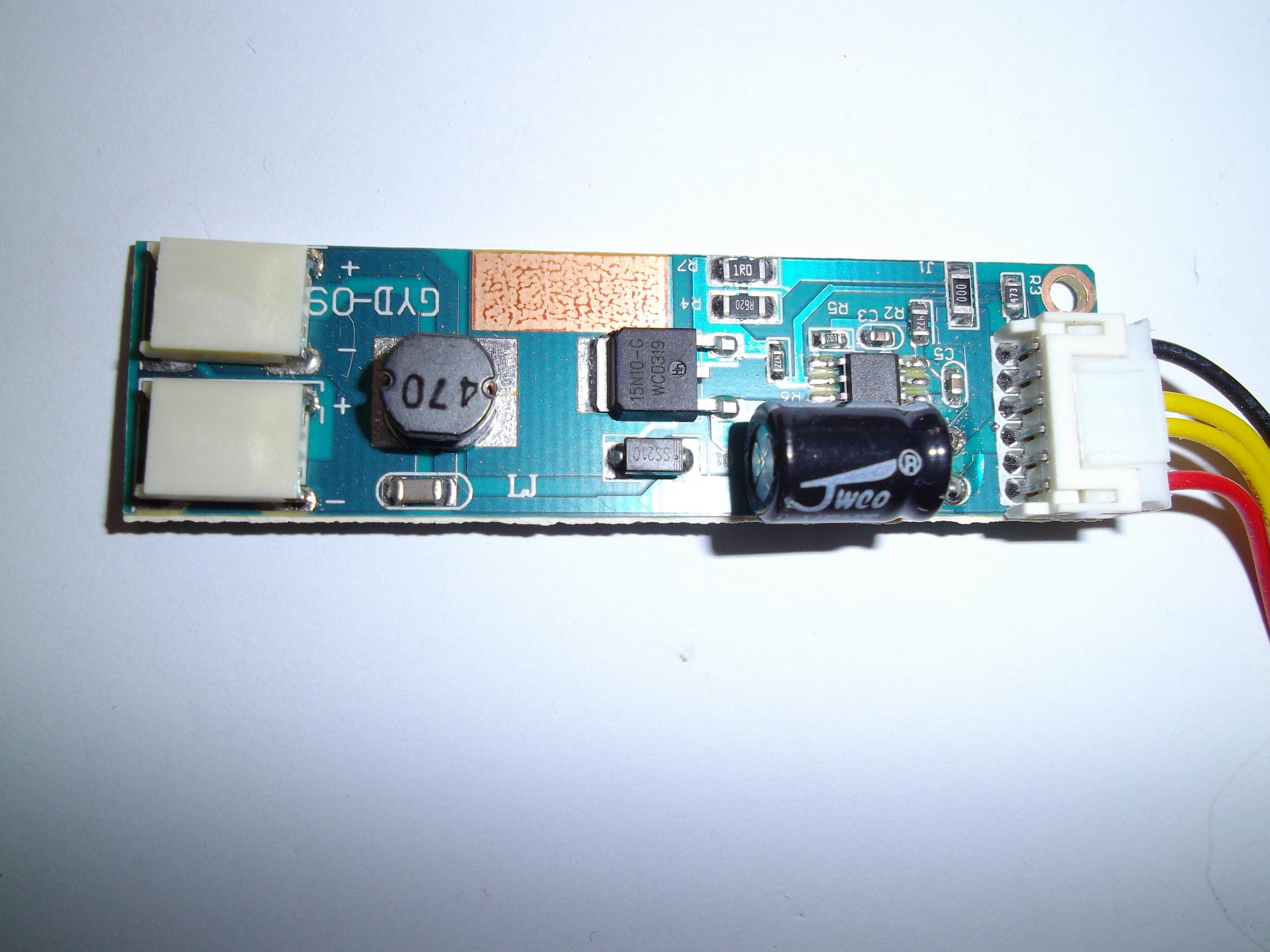

          What is the spec of that LED driver board?
          What is the maximum Input Voltage it can handle?
          It looks like it has the boost converter on it.

            https://www.badcaps.net/forum/attach...8&d=1537834614

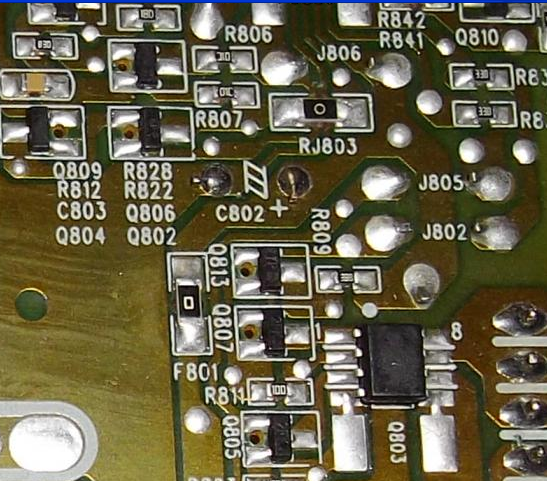

            D902 is the rectifier for power supply (12 ~ 18VDC range) to run the inverter circuit, you can take the Voltage on the output side of the SMD fuse F801 (black body with 'D' printed on top), you will need to disable the inverter circuit by cutting the trace after the + pad of the C802.
              An alternative way would be to remove fuse F801 completely (to me, it looks more like a 0-Ohm resistor jumper rather than a fuse, so no issue in doing that), which would disable power going to the entire old inverter. Unfortunately, this will also disconnect electrolytic capacitor C802 from the circuit. But looking at the LED inverter/driver board, it appears to have a low-quality JWCO cap. So if you do remove F801, you can then remove C802 and use it to replace the JWCO cap on the LED driver board. That would be a simpler modification, IMO, as you won't have to cut board traces. Not that there is any issue with doing that.

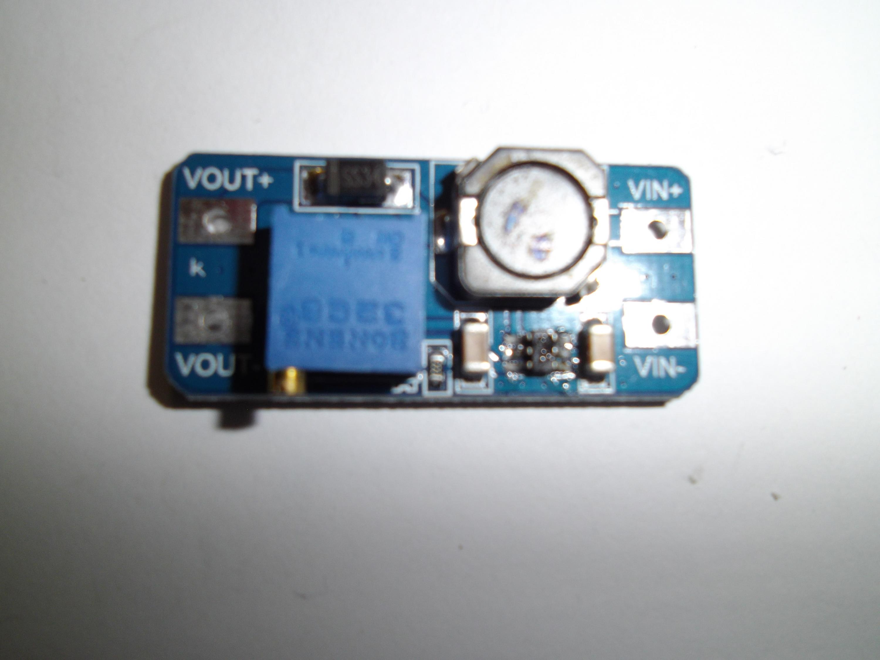

                You would need to use both the LED Driver Bd and the Boost Converter Bd.
                First you would need to identify a good 12V source. This could be found as described by the suggestions made by previous Members. When you have this 12V you would connect the +12v to the Vin+ of MT3608 and GND to the Vin-. Turn on the display and adjust the MT3608 pot tiny screw until the output reads 24V. Turn off the display Remove the O/F and DIM wires from the connector and solder them on to the ENA and DIM wires of the LED Driver. Connect the Vout+ of the MT3608 to the Vin wire of the LED Driver. Connect the Vout- of the MT3608 to the GND wire of the LED Driver. Insulate these connections from the chassis as you don't want the GND connection on the LED Driver touching the chassis GND. Connect the LEDs to the OUTPUT connection of the LED Driver. Turn on the display and with a video input you will see picture.
                I have used these same MT3608 and LED Driver before in my conversions without fail.

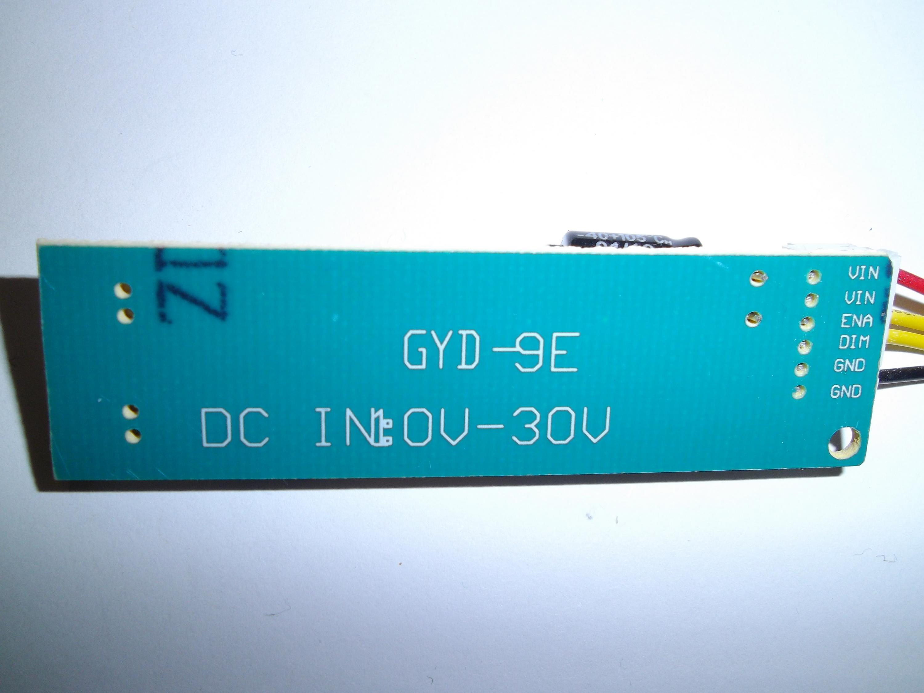

                  Re: Dell E2310Hc LED Conversion Project
                  https://www.badcaps.net/forum/attach...2&d=1537834614
                  So based on the pictures, it can take 10 ~ 30V input so no need for using boost converter board.

                    "An alternative way would be to remove fuse F801 completely (to me, it looks more like a 0-Ohm resistor jumper rather than a fuse, so no issue in doing that), which would disable power going to the entire old inverter. Unfortunately, this will also disconnect electrolytic capacitor C802 from the circuit. But looking at the LED inverter/driver board, it appears to have a low-quality JWCO cap. So if you do remove F801, you can then remove C802 and use it to replace the JWCO cap on the LED driver board. That would be a simpler modification, IMO, as you won't have to cut board traces. Not that there is any issue with doing that."
                    I wasn't planning on leaving that crap cap (JWCO)on that driver board! That will be upgraded. My question is if the inverter is disabled how does the logic board function or is that an entirely different circuit? Can you explain (show/draw) where the fuse has been removed to place a tap for the LED driver board +VCC ?
                      Hello To All,
                      I'd like to start putting some of these modded monitors together. Has anyone looked at my last post picture? I need somebody to please draw or show where to hook up the tap for the +Vcc for the LED driver board.
                        1) Lift either end of the JUMPER J810
                        2) Solder the +VCC wire to the positive leg of cap C918, the GND wire of the LED driver board to the negative leg of C918.

                            If you inspect your power supply board you will see the O/F pin which is for the Backlights on/off control pin, the you also have Dim for backlights dimming control but you never provide the spec of the LED driver board that I had asked for so I cannot tell if those two signals are compatible with your LED drive board or not, you can hook them up and find out.

                              I can't find any real specs on that LED driver board. I bought them on Ebay,
                              There is a 8pin ic on it that has the numbers DF6113 on it. I found a pdf online perhaps that will help? So otherwise try o/f and dim together that might work?

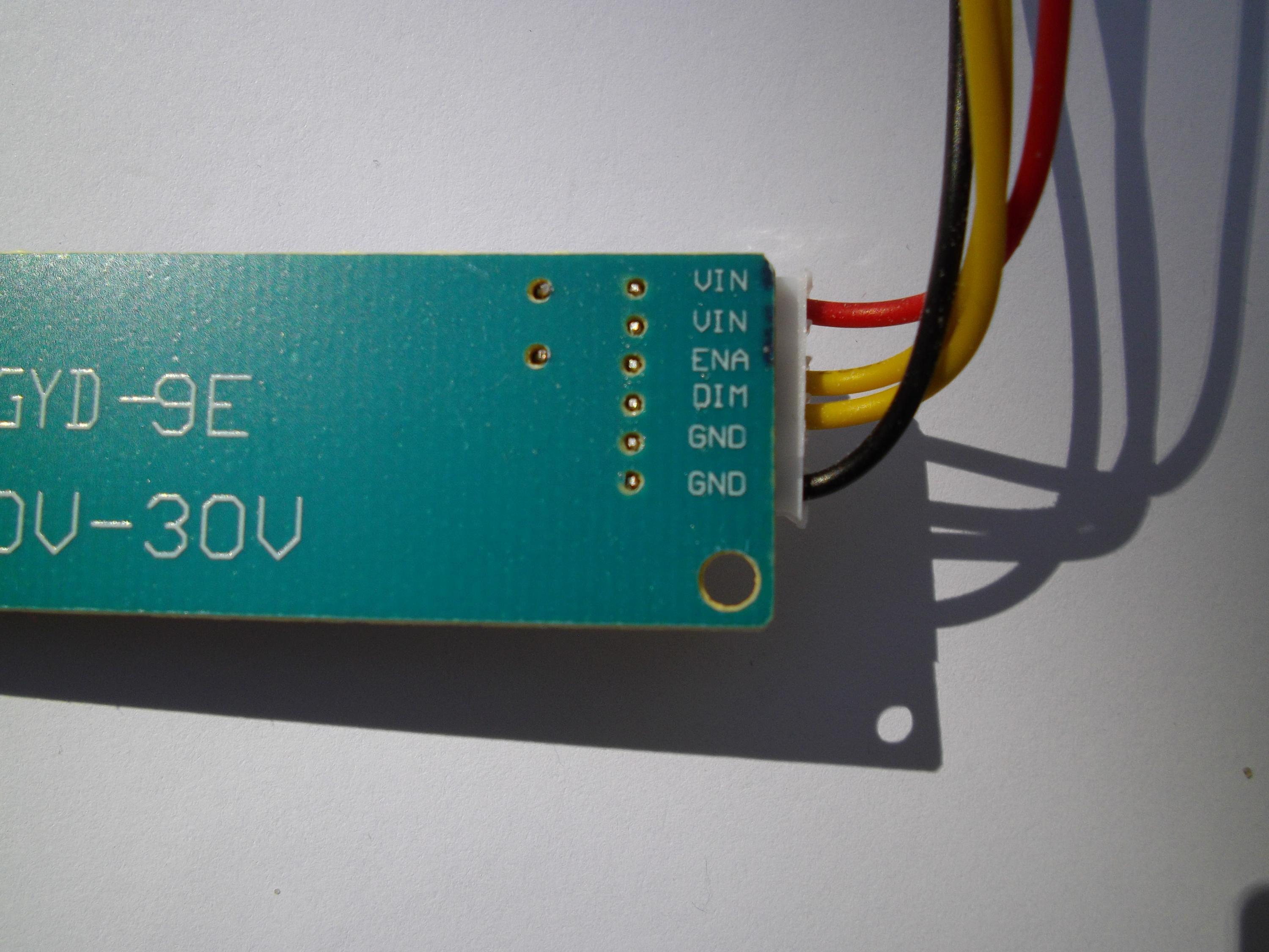

                                  Hello All,
                                  Well I got the one modded monitor going with the LED driver board hooked up. I used the the following connections between the Dell inverter board and the LED driver board/LED strips.
                                  C918 on the Dell inverter board are the taps for + & - on the LED driver pcb
                                  + to VIN on the LED driver pcb
                                  - to GND on the LED driver pcb
                                  o/f to ENA on the LED driver pcb
                                  dim to DIM on the LED driver pcb
                                  Now there might not be any other way to change this. But I can't increase or decrease the brightness of the monitor. Unless I hooked up something incorrectly which is possible. Please advise if anything isn't doesn't seen correct to any of you.
                                  Thanks As Always,
                                  Lcdman
                                    If the LED's do come on but the Dim is not working then the DIM signal may not be DC control that the LED driver needs, it may be putting out PWM DIM signal instead, that is why I told you to check the Voltages of those two signals to see what you are getting. It is bad that the seller does not provide any info about the LED driver board control signals.
                                      Disconnect the DIM on the LED Driver and see if the backlights remain ON. What voltage is the DIM control?
