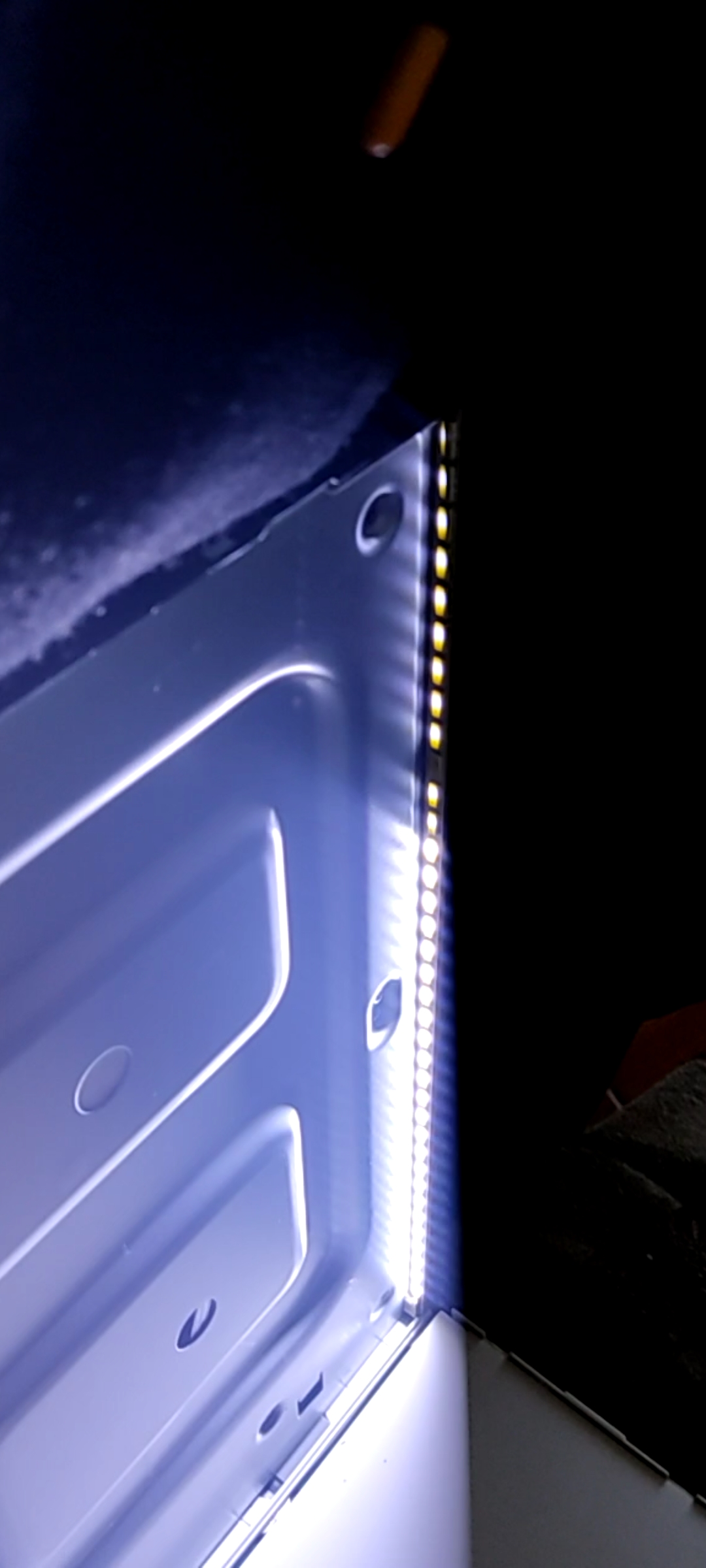

    I just got this nice screen to repair, the first symptom was no backlight, but I could see the image with a light on it. After digging, it appeared the backlight connector was broken at the LED board, the solder failed (it doesn't seem to have been previously disassembled and it needs to be to access this connector).
    After carefully pulling the back panel of the screen to access the led board, I was able to solder back the connector.
    But now there is another issue, the backlight turns on and off a bit irregularly, then there's a hissing sound (coil whine?) and it remains black. The adapter makes a weird noise as well.
    I figure this might be due to the power supply, I'm using a 12V 2A adapter instead of the factory 14V 1.78A PSU, as I don't have it. Could this be the source of the issue ?
    I can hear a light ticking noise on the logic board everytime it turns on.
    I tried unplugging the control board, and the LCD, no difference.
    This is what it looks like inside (sorry, not there now, can't do better).

        Reading the TS post I'd say there's something not right with the LED backlight. Maybe there's a short in there. The connector came loose with a reason. If the monitor's case wasn't opened until now, that cannot have been caused by 'human interference'.
        Maybe the monitor really needs 14V instead of 12V from the PSU. I'd try to get hold of the factory PSU, if only to exclude it from the suspect list.

            The plug I repaired is on the led strip in the panel, I had to carefully disassemble the panel to access it. It's the connector on this exact part : https://www.ebay.com/itm/For-Samsung...IAAOSw24RbES7N
            The behavior seems to be located on the board. When I measure the voltages in various places, it drops whether or not I plug the screen backlight, lcd or controls.
            So it's either a power issue from the PSU, or something on the board.
            Oddly enough, at one point, the backlight did stay on until I unplugged it, butonly part of the LEDs lit up as the top and bottom of the screen were darker.
            But it usually just flickers and everything is lit up.
            Also the Samsung Magicolor chip gets hot when there is power, so I suspect a short somewhere as well. I measured the diodes and mosets but couldn't find something obviously wrong.
            But then again, with the proper power supply, that would be something less to think about.

                  I have the same issue with the same monitor, I fully opened it and looks like the problem are the backlights. One of them don't turns on and maybe this makes that the main board detect and incorrect current and protect itself.
                  I bought a replacement, when I have it in my hands I will change and tell all you if it worked.

                    I'm having the same problem. 1 set of 12 LED turning off, It cycle for 3 times and protection mode shuts down the other 2 set of 24 LEDs but the picture stays ON (checked with flash light)

                        If you got a bad backlight strip, either replace the whole strip, replace the bad LED’s
                        or substitute bad LEDs with zener diodes.
                        You also can turn the backlight down to 50% and the monitor may function for a while longer. Sooner or later it will fail again… unfortunately.

                          Yep. So I gambled on it being a broken backlight strip.
                          Ordered a new strip for $10.
                          Replaced and the monitor is working again.
