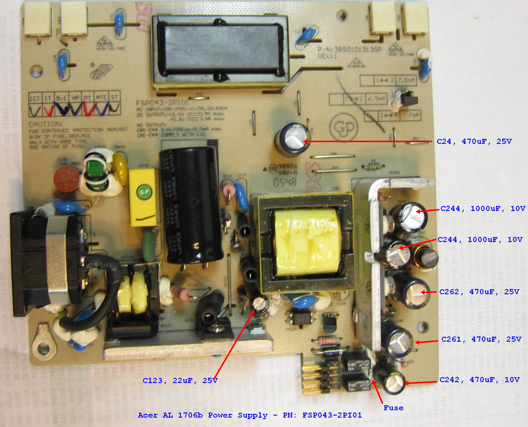

    Re: Dead Power Supply(XAD819AR) for Acer AL1706
    Hi, This thread helped me repair my Acer AL1706b. The power supply is different than the one shown and it uses different capacitors, so I have attached an annotated picture with the caps identified. I ordered the caps needed from Digikey -- with one exception. They do not stock the 22uF, 25 V cap. Also note, in the picture, two caps are identified as C244; the upper one is 244, the lower one is C241 .. they are the same size and voltage.
    If anyone knows the size of the fuse on these power supplies, I would like to know, just in case ...
    Hope this posting helps someone else as much as this thread helped me. Thanks for what you offer through this site.
    Jerry
    Caps for Acer AL1706b LCD monitor.pdf
      You can use the Panasonic FC cap at
      http://search.digikey.com/scripts/Dk...name=P11213-ND
      That red circle just above the AC adapter is your fuse. It looks like 2A/250V
