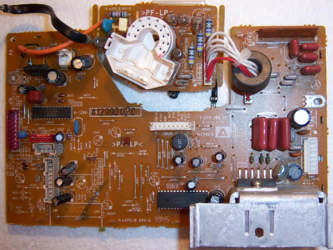

    Originally posted by jdimpas
    Remove the Socket board in the tube and find R459 its actually a 10M ohms resistor.Then go to the market and grab some 4.7M~5M resistors, removed the 10M ohms (R459) then replaced it with 4.7M~5M. Solder it and return back the socket board in tube, just be sure that all cables are plug back. Then turn on you monitor! It should work
    I was less than thrilled with both auto reset and DAS results on my P991, and its socket board is different. I don't see any R459. Is there a resistor fix for this one?
