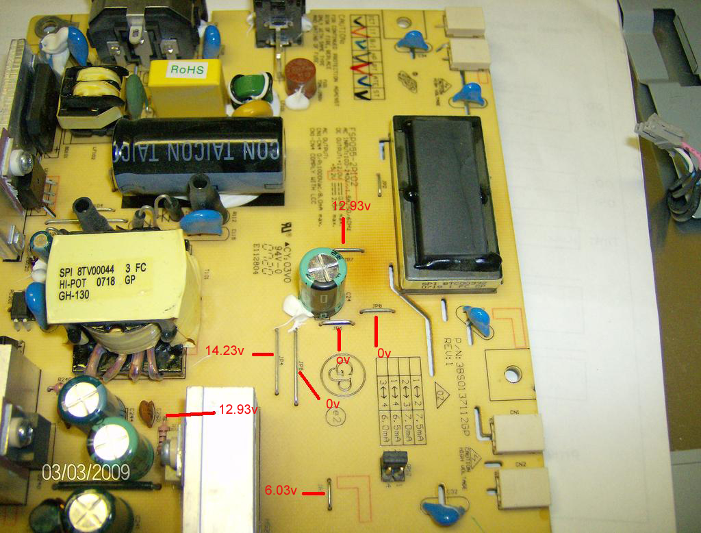

      So I hooked everything back up and it did make a difference. I started to probe the jumpers and I am getting 14V on some of them. I am not sure I will be able to probe the bottom of the board though because flipping them over with everything hooked up will be next to impossible.
      I will use a pic of the top side and label my readings thus far. Should have that soon.

          Ok, here is what I have checked thus far. This is with the monitor hooked up to the pc and the power light is green.
            #45
            Re: The infamous 2 seconds to black
            Well, the inverter part is getting power (14v, 12v readings on jumpers). The lamps had any visible damage?
            They still don't lit anymore?

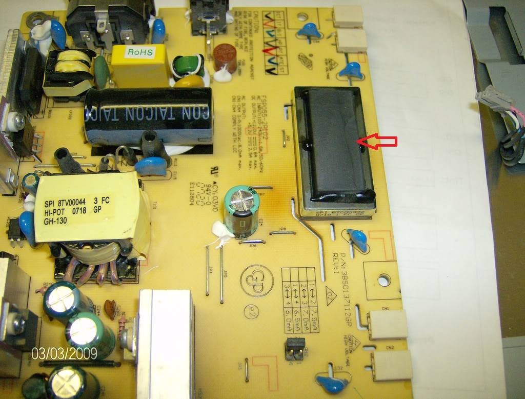

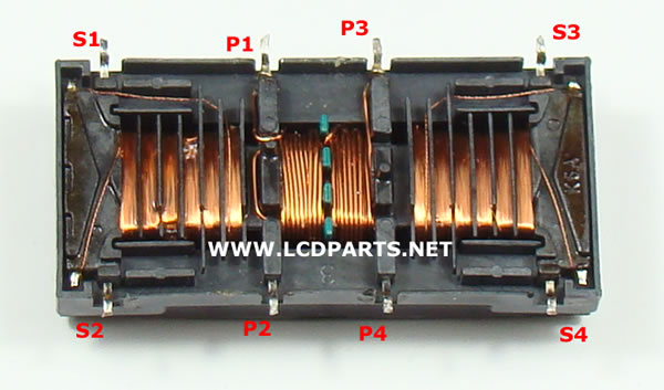

                                      Since I am looking at the transformer I decided to read up on it a bit. I found a website that sells them, and they also list the specs. They say the primary should have about 0.3 ohms and the secondary about 1.0k.
                                      I got the following.
                                      P1-P2= 0.5
                                      P3-P4=0.5
                                      S1-S2=3.95 K
                                      S3-S4=1.01 K
                                      I did this check with the transformer on the board.
                                        #59
                                        I found these 2 videos very useful to test the transformers (about 10 minutes in total). Sounds like you followed this same procedure.

                                          Yep, looks like I did most of the same checks. I am going to remove the transformer so I can get good readings on the primary as well.
                                          I am curious if the deviation in the secondary readings is acceptable.
