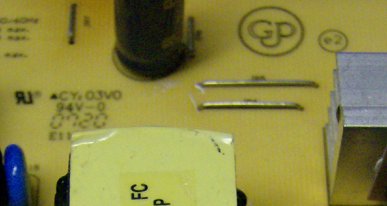

    I can read one Q.
    The top line says LT7215H.
    The second says SBL1060CT.
    The other one has absolutely no markings. Could they have been destroyed by heat?I will have to learn up on where to probe them for voltage.
    I assume to test the transformer that all the outputs are + ? So if I probe any of the wires coming out of it and ground I should be good to go, yes?
    P.S. Thanks for taking the time to explain basic things. I am sure that must get old for those who are experienced.

      Nevermind the explanation.I can explain anything you want or need, even if you think it is a 101 sort of thing. I learned that way, and I can pass that on to the newcomers. Sometimes I post comments or explanations along my posts so people that just browses around and never register to make any question directly, can benefit from the forum.
      I am not that wise as PCBONEZ, Krankshaft, Wizard and many others around here (Toasty has been a great help too), but if in any form I can help, I will.
      Now, back to our patient ....
      The component is a Schottky Barrier (see here ).
      Nevermind the T for now. Look at the picture. Do you have voltage reading in any of those two jumpers, and on the cap in the picture?

        I checked both jumpers and both sides of the cap. In all cases i get a spike to less than 1 volt then it drops off to 0.
          Re: The infamous 2 seconds to black
          I've run out of ideas for now. The voltage that reaches teh inverter area is 12v or more, depending on the number of lamps (I've seen 12,13 & 14 v so far). Check the voltage in the 12 V rail caps (those with 16 or 25v ratings) that you changed. You mentioned that the 12V line fluctuated before. What readings have you now on the 12v line?
          Also, what V do you read on the resistor between the Schottky and a cap?
          at the left):
          Double check for correct orientation of caps and make sure the solder is OK (reflow if necessary). We'll be dealing only with the 12v line only, i guess.

                            See the marked components? those are jumpers. There may be a fuse around that area, as I can't locate any on the other side of the board.
                            Hello Eduardo
                            Those 2 rectangular boxes that are in the Third picture down, by the cap you arrowed, in this link of this thread,
                            https://www.badcaps.net/forum/showpo...09&postcount=4
                            I am 99% sure they are fuses
                              #34
                              Originally posted by Bobdee
                              Hello Eduardo
                              Hi, Bob.
                              I didn't mark it, it was shimjocky. And I can put the remaining 1%, as they are fuses: 5A 250V.
                              They are similar to this
