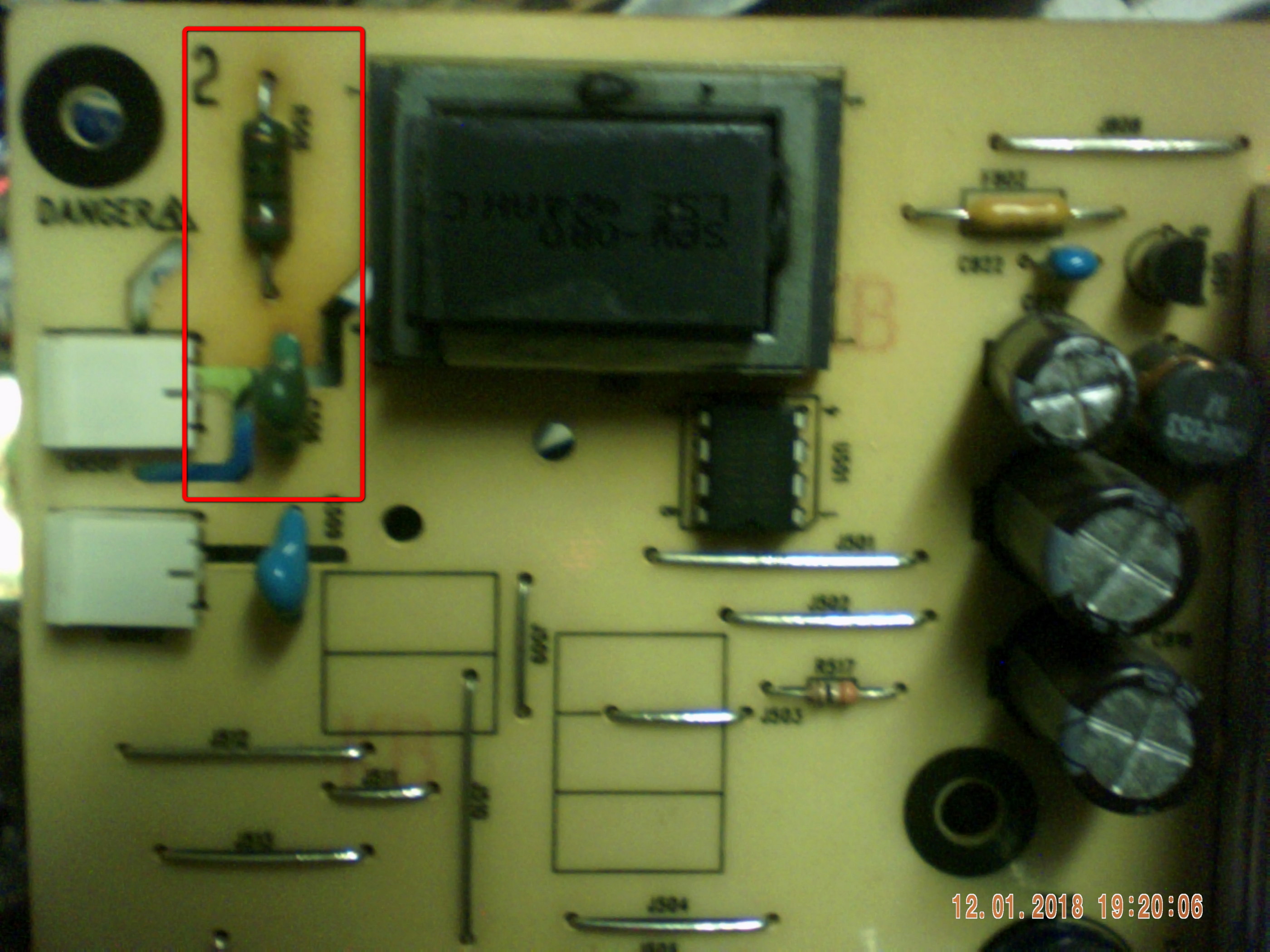

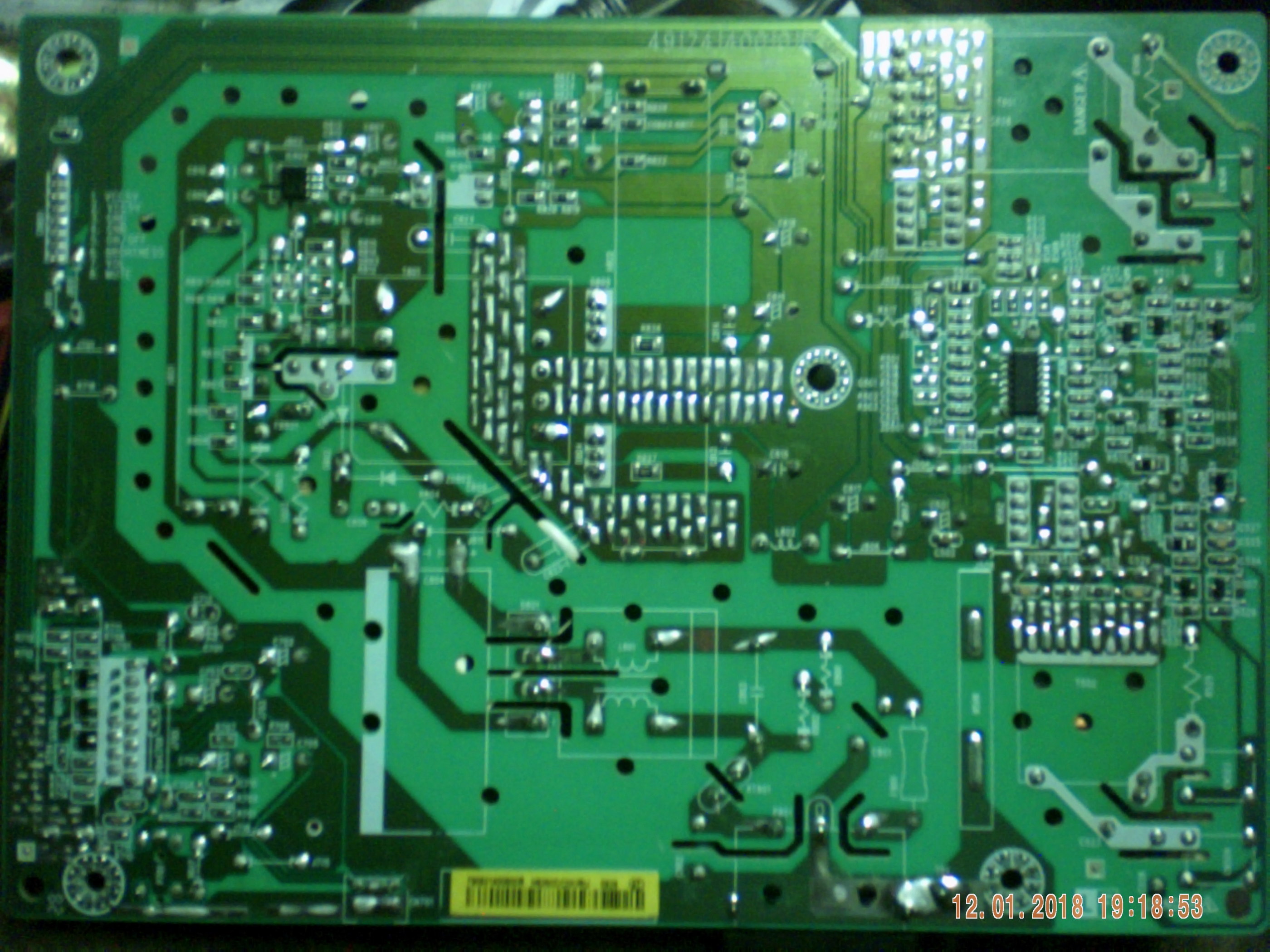

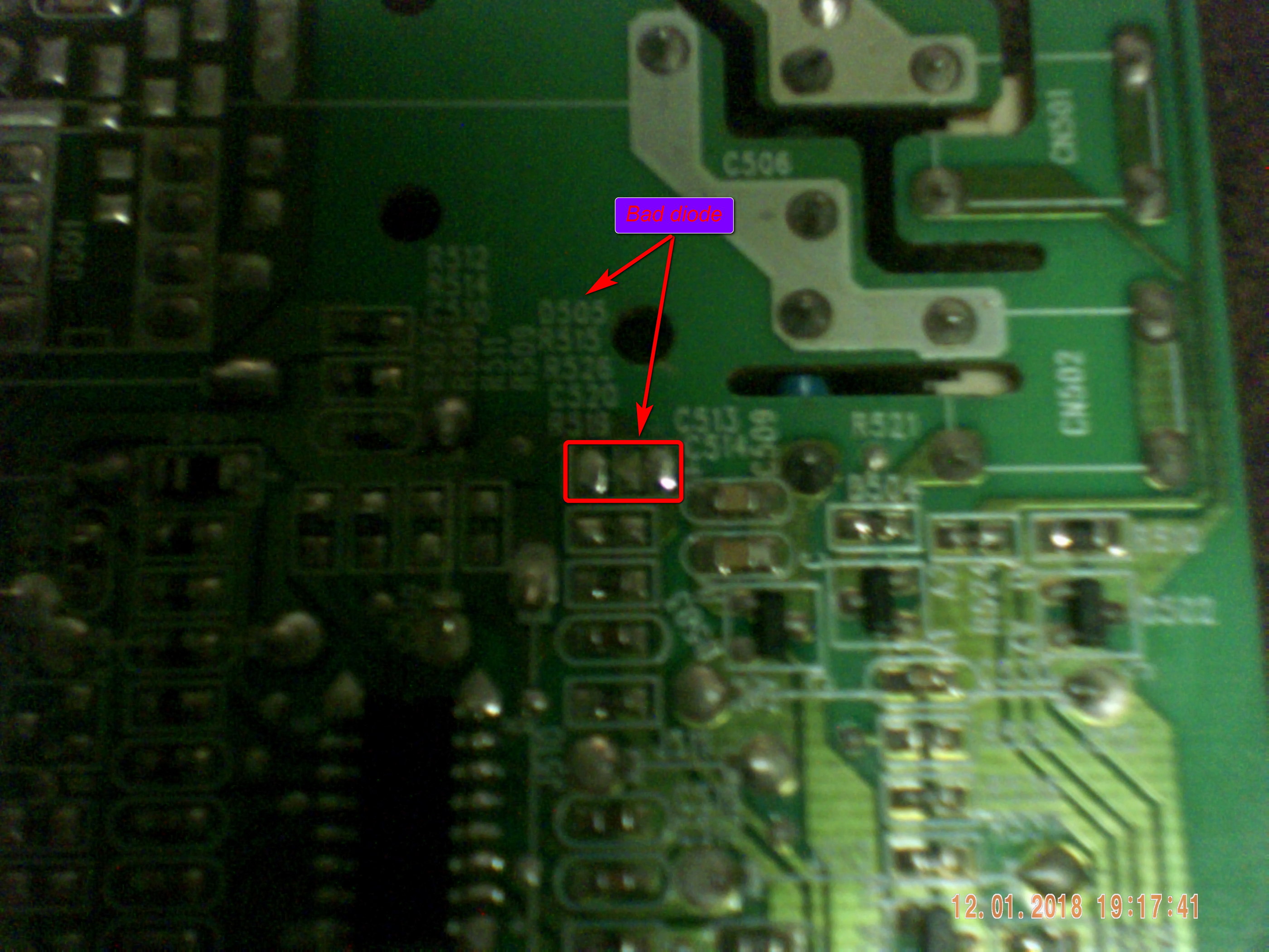

    What I found though is a blown diode that doesn't measure anything in any sense, even on the 2kΩ scale. This diode feeds the overvoltage protection pin 7 of the OZ9938GN driver with positive voltage from the 5V rail while being put to ground when the first lamp of each pair stops working. Considering the schematic I've been able to reverse engineer until now I find it odd for this diode to blow up.
    Problem is, the diode has no marking whatsoever, only a white stripe on a black body, marking the cathode. I've attached a picture of it. (Sorry for the bad quality of the pictures, I don't have a modern camera and my hand is shaking.) There are three other identical diodes on the board and they seem to be alright: one putting pin 10 (ENA) of the driver to ground when in Off state and the other two feeding negative impulses directly from lamp connectors CN1 and CN3 precisely to the faulty diode.
    What I'd like to know is if anyone knows exactly what model could this be and what could I use for a replacement. In the HSG1033 schematic a similar role is played by an LL4148WP (1N4148?) so I was thinking I could patch a regular (non-SMD) 1N4148 instead since I got plenty of those brand new.
    However, logic says there has to be a primary defect somewhere else that led to such unusual defect as a blown diode and a faulty inverter. And by visually inspecting the board there is a corner where a resistor and a capacitor have overheated (as seen in picture). The capacitor is a 10pF/3kV parallel to the upper lamps' transformer output, the resistor is returning the feedback from first lamp of the upper pair. The capacitor seems alright (not shorted, since trafo output is 471Ω, however the 6Ω difference between outputs may rise a question), while the resistor measures 1.5MΩ according to the color codes and comparatively to the one on the other channel.

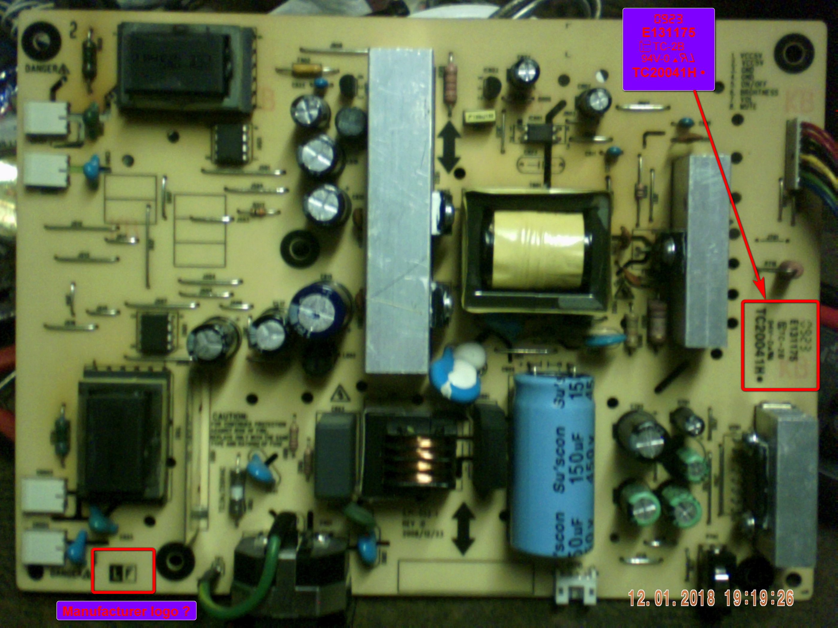

    Additionally, does anyone have any experience with this model/power+inverter board, does anyone know the manufacturer ('LF' logo, dunno who can be)? Original schematics anyone?

    That X capacitor looks very unhappy.
    I'd just chance it and replace that along with jerry rigging the 1N4148 diode and see what gives.

      By the 'X capacitor' you mean the blue ceramic one (10pF/3kV) that got the board brown around it? I wish that was the fault, not the tranny. I'll remove it, measure again the transformer's output resistance and maybe replace it if I can find another one.
      I'll cram that 1N4148 in too, it sounds like it'd fit value-wise.

            Hopefully I won't be speaking too soon but… success!
            Dunno if it was only that cap or bad solders too - which I had already fixed the other day - but as soon as I replaced the cap, mounted the diode and powered on it started working as if nothing happened.
            I had to do a "gypsy job" - as we use to say around here - that is, place two 18pF caps in series since I couldn't find a 10pF on the BenQ spare board, but for now that's unimportant compared to the certainty that neither the tranny nor any lamp are faulty.
            The replacement 1N4148 measured exactly as the other two good diodes on the board (642Ω on the Diode/Continuity scale) so I could say it's a perfect match despite it being regular size (through-hole) not a SMD.
            Strange thing is that cap, once out of circuit, doesn't measure anything even on the 2MΩ scale, so if it was its fault it could only be interrupted, not shorted - unless it only shorts out under high voltage, which is possible.

              That's the job of an X capacitor (safety rated) it must always fail open, never shorted.
              Sometimes regular ceramic capacitors are used instead, with horrible failures as a result!
