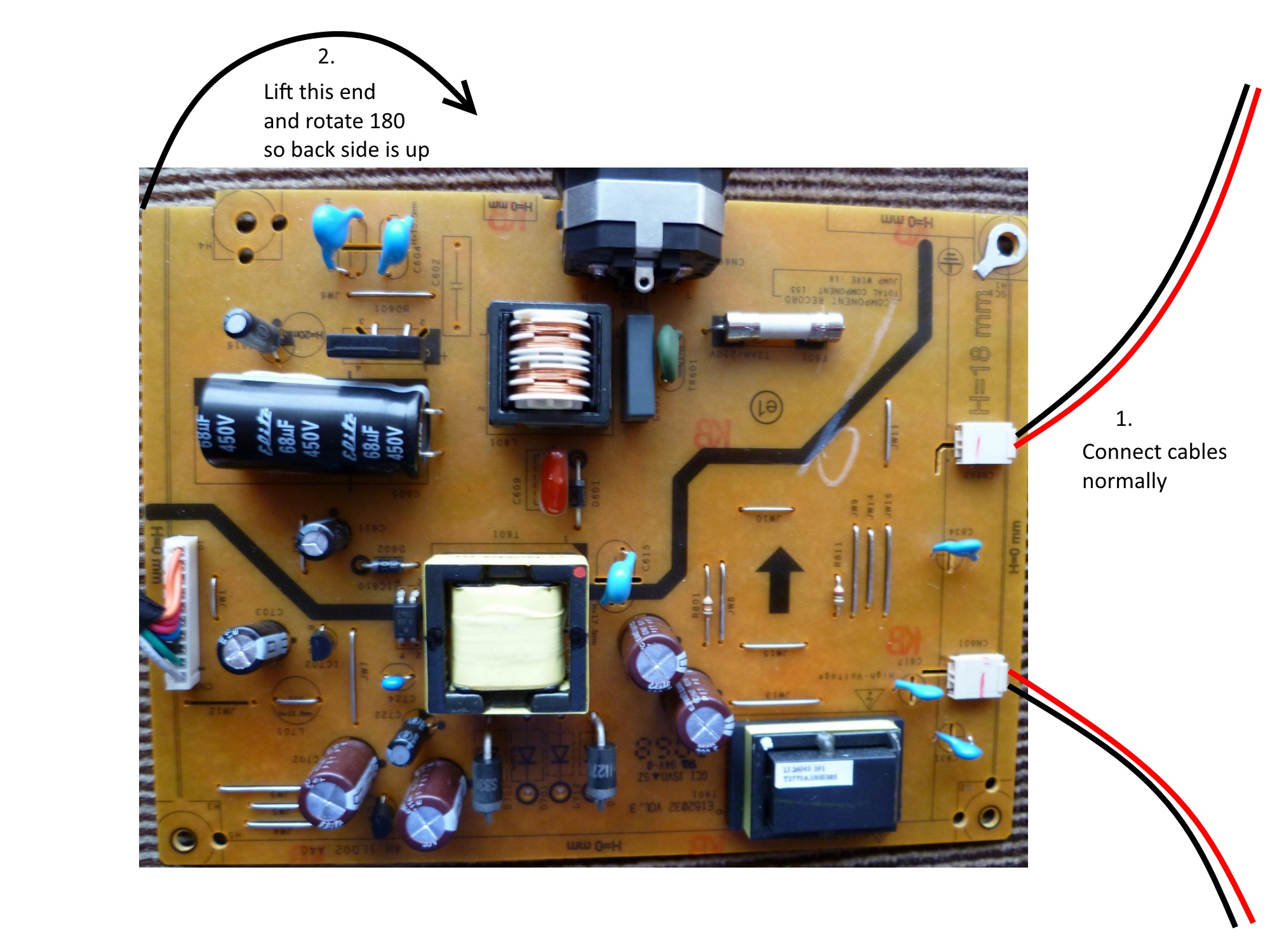

    Do I need to do these tests with the CFL's connected? That would be a little tricky, because the power board needs to be side up when I connect them?
    • will62
      • Dec 2016
      • 229
      • usa
      #102
      Re: Benq G2255 doesn't power on - amber power light when plugged in
      Yes. Panel face down. Use a sheet of cardboard to insulate between panel and power board. I assume that you are using a power strip near your setup, so that you can turn panel on/off quickly w/o having to plug/unplug PB. After you run tests, leave the setup as is (more tests to follow).
        If panel face down, then the CFL's will be inverted in the power board, is that ok (the lenght of the cfl wires are not long enough to plug them in their respective sockets)? Also Will62, the voltage measurements I did in previous post was without the CFL's connected...and you can see that pint 14 is 0V. Should I do voltage readings with the CFL's connected before doing the oscilloscope measures and report?
        • will62
          • Dec 2016
          • 229
          • usa
          #104
          Not sure if connector swap will create a problem, but let's not add another variable to the mix. Lay panel face down. Set power board top side up on panel. Connect your ccfl wires as normal. Now flip the other end of power board over, exposing bottom of board. Insulate with cardboard between panel & PB.

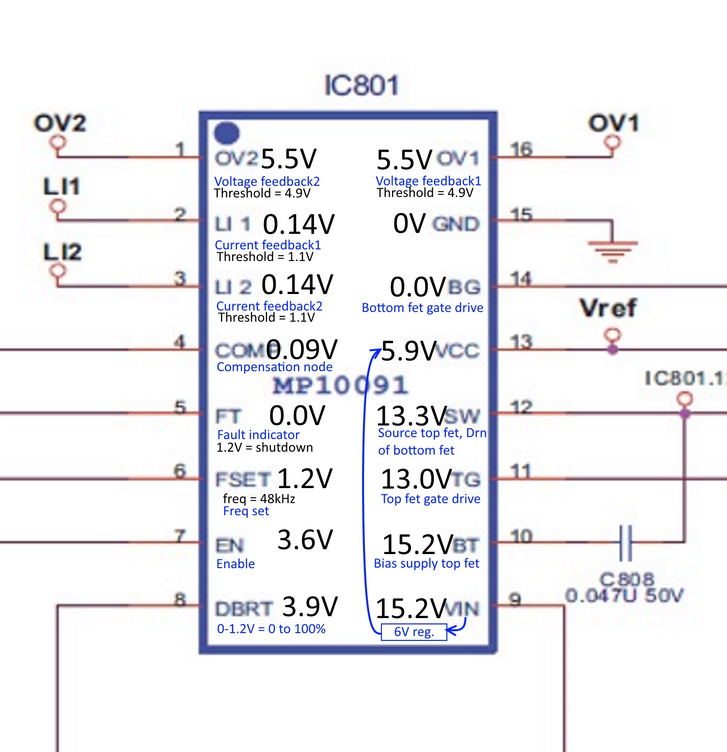

          BG and TG can never have power at the same time without blowing mosfets. There is some dead time between switching.
          Also, please check resistance across C808.

                    #109
                    Ok, so did the tests with the oscilloscope as you explained Will, and this is getting to be fun!
                    First off, pin 11, when I put power on, I get a wave not perfectly square, but sort of conical with about 12-13v amplitude for approx 1 second and then it goes flat.
                    I waited a little until pin 7 & 9 were almost at 0, redid the test on pin 11 and got the exact same result.
                    Waited another while until pin 7 & 9 to 0 volts, then tried pin 14. Got about the same wave (conical) of about the same amplitude but for maybe 1/2 a second, somewhat shorter time than pin 11, and then flat. Did the test a few times and got the same results.
                    So, what is next, I'm starting to like this. I left the setup as is.

                      #110
                      The conical shape may be something related to MPS's Nu-Pulse technology, not sure.
                      Now we're going to bypass the chip's fault protection and take a longer look at the TG and BG signals (same as earlier). Need to jump pin 5 to ground. An alligator clip across C803 should work, if it'll hold. After the clip is on, measure resistance between pin 5 and pin 15. Should be near 0 ohms. Run the test for about 5 seconds to get a better look at the waves. Don't want to run it too long because shutdown may be due to over-current. See if you can display the frequency on your scope.
                      Questions
                      1. Do you have a hole on the back of that panel so you could see the backlight if it came on? If not maybe you could see some glow at the corners where the cables go.
                      2. Does your DMM have frequency function? If so, you could try touching the top of the transformer (not the pins, just the top plastic) with your red probe (black to ground) while you are running the mosfets, to see if you pick up the oscillation frequency.
                      3. Did you check your probe on the scopes 1kHz signal? There's a loop at the top of the scope to hook on to. Pulse nice and square, or conical? (set horizontal to 1 ms).

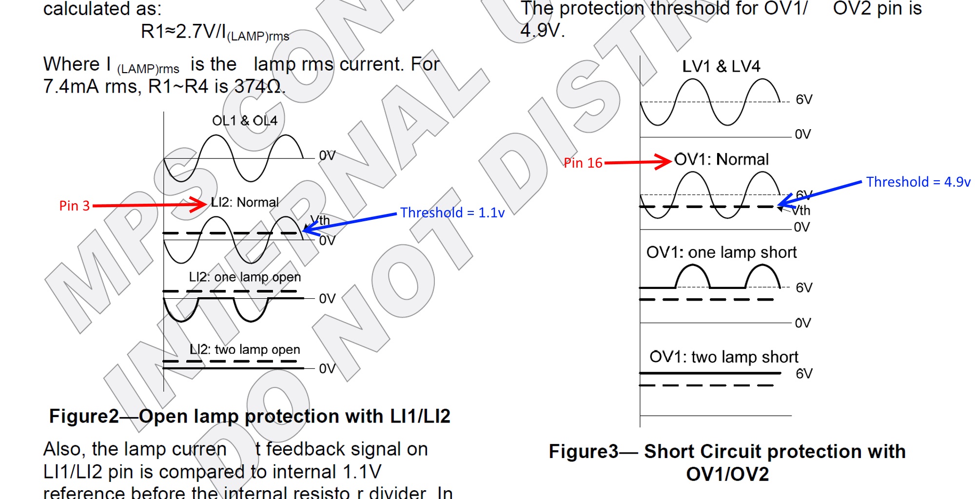

                              Refer back to the MP10091 diagram pic on post #104. You're going to be probing pins 16, 1, 2 & 3 next. Remember to find a near component to put
                              the probe on. Easy to slip while you're watching the scope (pin 16 is next to ground pin). Look at the attached pic and you'll see what we're looking for.
                              Pay close attention to the thresholds noted on the pic. Whether or not the wave stays above or goes below the threshold is the fault trigger. Since neither of the bulbs came on, I have a feeling that I know where this is going, but let's see what your waves look like. Since the bulbs are not on, running beyond 5 seconds on fault bypass is probably not a problem.
                              As for your question about the scope setting, leave it on DC for these tests. After these tests, why don't you watch a couple of videos on checking for voltage ripple with a scope. If you set the scope on AC, you'll only see the ripple component. See if you can estimate peak to peak ripple on your 3.3V, 5V and 20V supplies. Some datasheets will specify a maximum tolerated ripple.

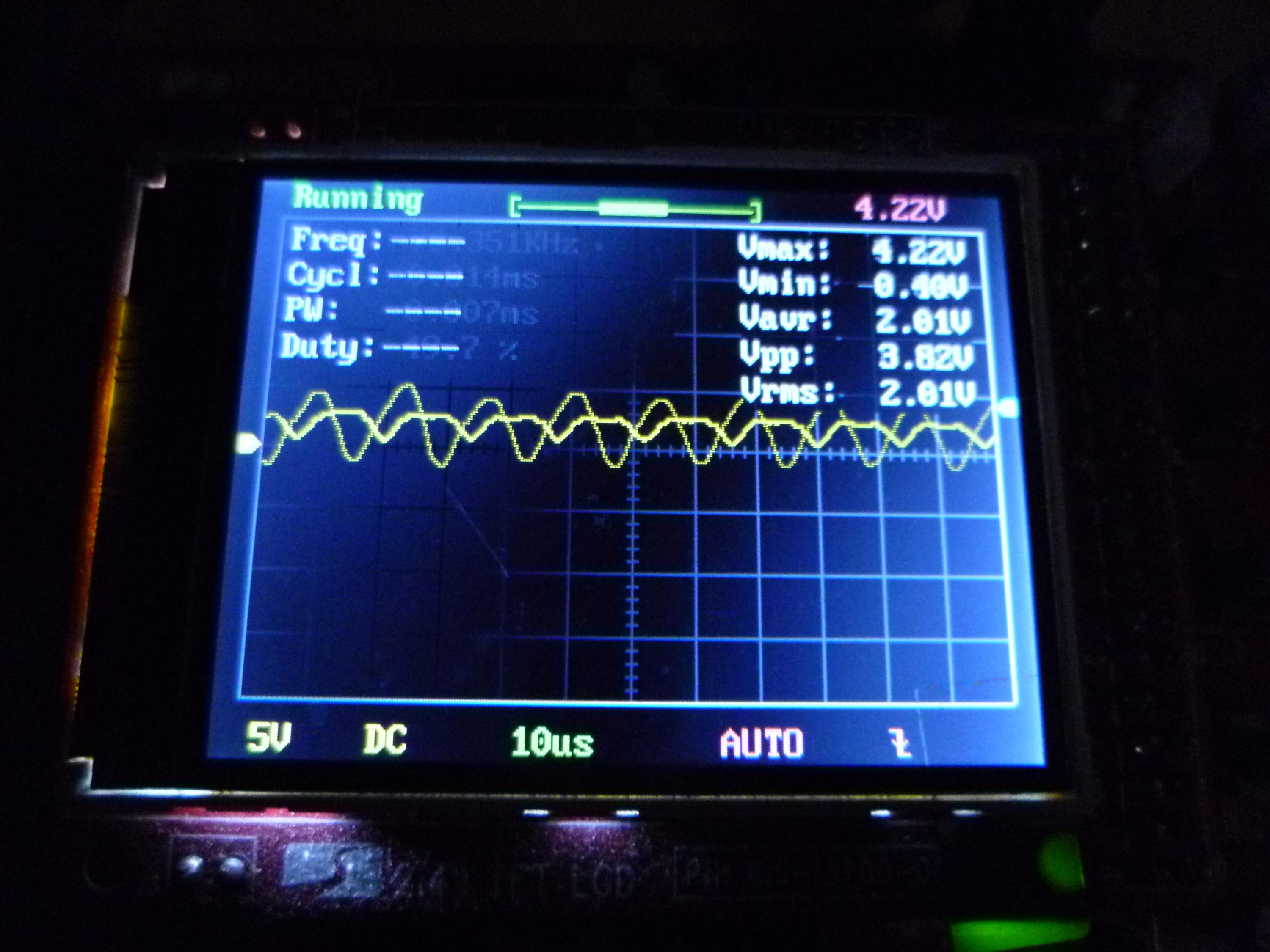

                                    #117
                                    Ok, Will this is so exciting...as I was getting prepared to do my tests, pin 5 to ground, etc. I did a quick test to see if the CFL would light up. Well guess what, they did and stayed light as long as I kept the AC on. But I didn't leave it for too long just in case. I removed the alligator clip that grounds pin 5, powered up and the CFL's came on, but out after about 2 seconds.
                                    I have to admit that the opening to see the CFL's is very small so I might have overlooked it before.
                                    So I put the alligator clip back on C803, put power on and they lit up and stayed lit for at least 10-15 seconds...then I powered down.
                                    I took the attached picture of my oscilloscope on pin 14 for you to see...sorry for the quality, but one hand on the probe, the other putting power on and having to grab my camera etc. You can't see the frequency because it sort of flashes on and off, and I guess the photo snapped while it was off, but it ranges in the vincinity of 71-72Khz.

                                        #119
                                        Hey, that little $20 scope is not a bad one to learn on, is it? It looks like it'll do everything we need on the power board.
                                        Did you notice if both lights came on equally? No flashing or anything? Jump pin 5, turn off the light in the room, then power up the board. Notice any difference on how each lamp starts up (blinks, pinkish hue... etc).
                                        Go ahead and run the tests on pins 16, 1, 2, & 3. We need to narrow down which connector circuit is causing the problem. Then we'll swap lamp connectors, rerun the test and see if the problem moves.
