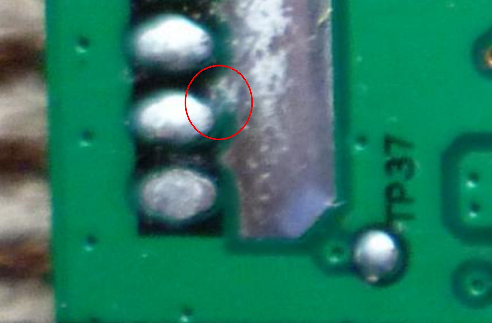

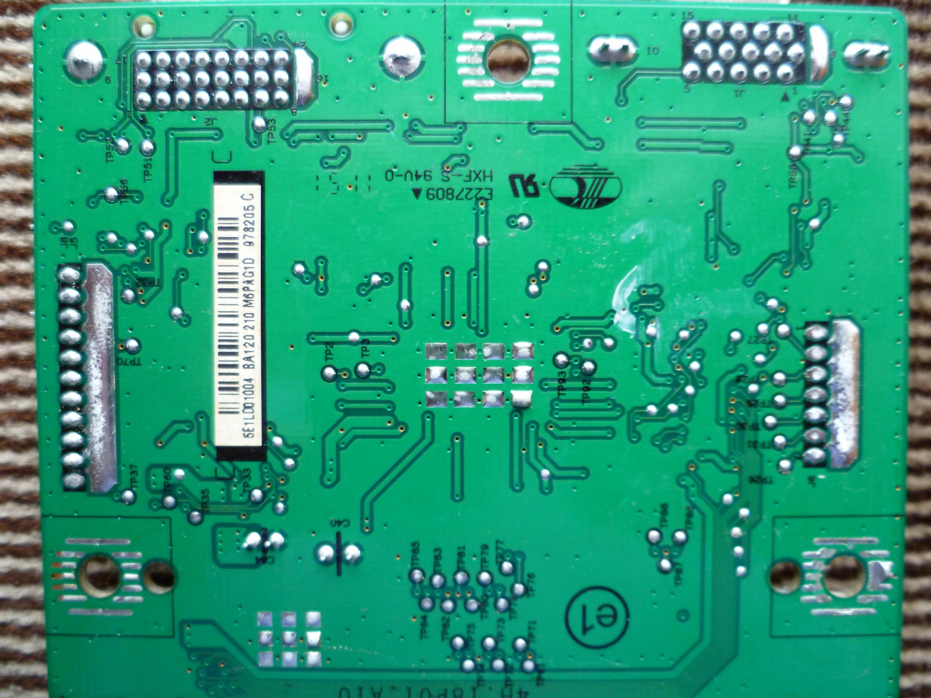

                      The 80 ohms does sound low. Above, you mentioned that the caps measured 85 ohms when removed. That sounds way too low for a good cap. You might want to remove those again and recheck resistance (3V to gnd).
                      Also, please check the area on the back of the board, circled in the pic. Looks like something scraped across the board there.

                        Hi Will62,
                        Tks for hanging in there. What I meant, was that the resistance was 85 ohms on the 3.3V to ground even with the caps removed. The caps I checked with my multi component tester and they tested fine...I also checked their resistance and it was in the kilo ohms, so they are not the culprit. So it has to be something else along the line of the 3.3v rail.
                        As for the picture, here is a closeup of the area with another photo of the underside after cleaning it up with isopropyl alcohol.

                            2. Post 9&10: Over my pay-grade to try to explain it (or understand it), but the tl431 controls the optocoupler's path to ground. It varies the intensity of the led. That feedback returns to the high voltage driver IC, which in turn adjusts the PWM to the mosfets. Someone posted earlier that the blue wire may be the power saving signal.
                            I think they were right. It might just be a high or low signal from the main board, which adjusts the tl431. You read ~.77V, which is enough to "turn on" most zeners. You'll never read voltage (0.04V) on the right side, until the left exceeds the "zener/knee" voltage. They may have used it to protect the main board.
                            3. Russian forum translation: What I got out of that, was that the voltage regulator was for 1.8V, and he was getting 2.5-2.8V (regulator hot). He also ended up having to replace the TSUMU58 chip to fix his problem.
                            4. You may not have a problem with the 3.3V on the main board. At the regulator, you read 3.3V in and 1.8V out. The 3.3V is generated on the power board. If you had a short to ground (or ohms too low) on the main board, I'd expect to see a voltage drop at the regulator.
                            Now, when you get a chance, go back to that 1.8V regulator, and check resistance from the 1.8V to the TSUMU58 chip pins 53,74,104 &126.

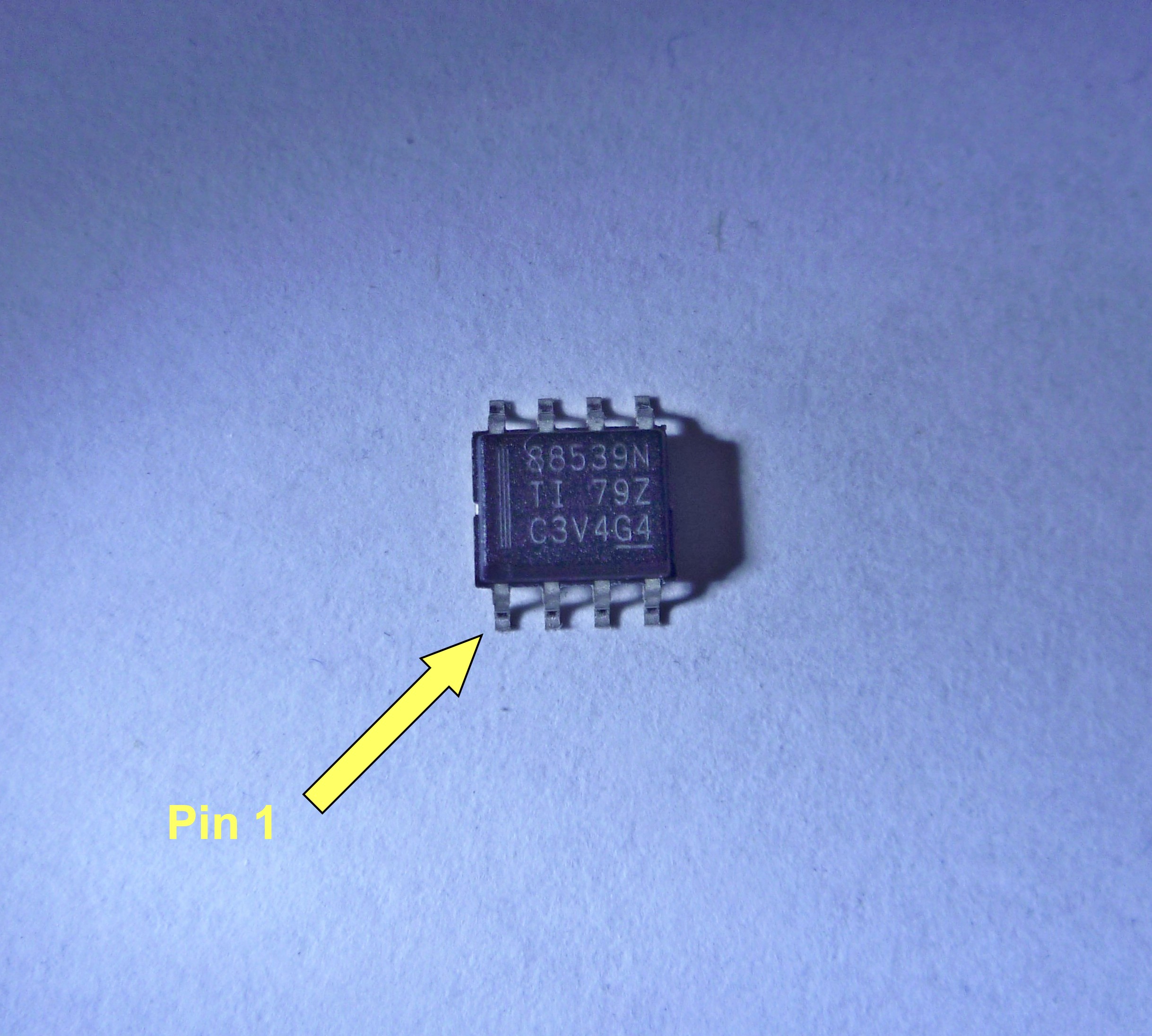

                              Well, total disappointment. Got the Digikey order in, installed the CSD88539ND Mosfet, checked resistance between S1 and D1 - 350K ohms, same with S2 and D2, and gave it a try. Lights did not even flash, nothing.
                              Checked the resistance between S1 and D1 and now get 1.4 Mega ohm...so it's shot.
                              Rechecked the data sheet to make sure I had pin 1 in the right place, but on the datasheet they show a dot but there is none on the mosfet (photo attached). I assumed the line meant the top of the Mosfet which I am pretty sure gives pin 1 where I indicate in the photo.
                              So, this Mosfet doesn't work....shucks.
                              • will62

                                Drain 1, pins 7&8 are tied together, as are drain 2, pins 5&6. They should have 0 ohms between them (7 to 8, 5 to 6). That should tell you where pin 1 is.
                                • rddube
                                  Aspiring Expert
                                  • Jun 2013
                                  • 907
                                  #96
                                  Re: Benq G2255 doesn't power on - amber power light when plugged in
                                  Yep, just checked and that is the way I installed it i.e. pin 1 in the right place. They say in the description for this Mosfet:
                                  This dual SO-8, 60 V, 23 mΩ NexFET™ power
                                  MOSFET is designed to serve as a half bridge in low-
                                  current motor control applications.
                                  Probably not the right one?

                                    Yeah, the ones on ebay from China were closer to the fets that you had. The TI one is closest that I could find from Digikey (60V, 7A, 23m, 2.1w). Let it sit for a while. Then get back and check all your voltages, and recheck the fets to make sure they're blown. Check them the way the guy in this video does. (G=p2, D=p8, S=p1)
