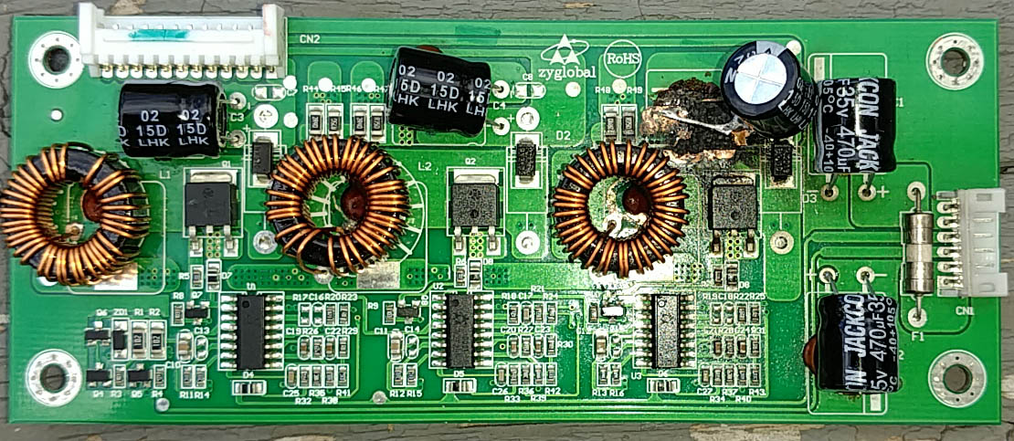

    The screen resolution is 2560 X 1440, so it would be nice to get this working. I read it uses the same panel an an iMac.
    The LED backlight driver board has a blown capacitor, however before it went, it looks like it got very hot. PC board traces are burnt, and even into the board surface.
    I tried cleaning some of the burnt stuff, and replaced all the capacitors. I also added that jumper to an area that looked like the board copper was toasted. No luck
    I'm not sure how many layers the PC board has, so I'm thinking it's too far gone. I tried looking for a replacement, but haven't been able to find one. I did a general search for the board. Also looked on eBay, Amazon and Shopjimmy. The part number on the back is HQ-LED28-1B.
    Does anyone have any other places I could find this?

    You may have bad LED wiring or some shorted out LED in the LED strings so they need to be checked. The board has 3 LED driver circuits thus 3 Boost converter circuit.
    Zyglobal P/N HQ-LED28-1B, it is REV_B.

        Have you tried checking the mosfet Q3 and diode D3 for shorts?

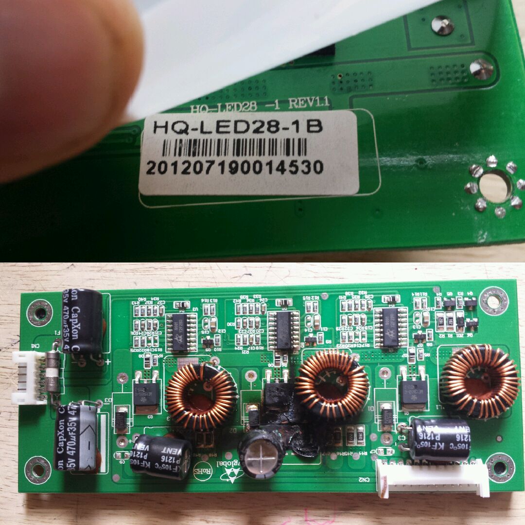

              Sorry, I'm a little out of my element when it come to this, so I'm not sure about the number of strips and leds/strip. It's an Auria EQ276W monitor (2560x1440) and the attached file shows the board and failed capacitor.

                I don’t see any blown capacitor in either case. Looks to me that glue that keeps capacitors in place has played a bad joke to the circuit, as it has been pointed many times in this forum.

                  ok... the underside of the capacitor appeared to be compromised, but again, all I was trying to do is find out if I could find a replacement board since repairing this one looked futile.

                    Can you determine on the board the VCC, ON/OFF, GND and P-DIM pins? If so I may be able to recommend a substitute that works for me.
                      Re: Auria EQ276W - Looking for Replacement LED Driver
                      https://www.yoycart.com/Product/537007292151/
                      If you want to go that route, and just remove the bad glue first.
                      Just search for 'HQ-LED28-1B'

                          I have the same monitor, same problem. Replaced the caps, it worked fine for about 3 days and then died again. Entire driver board looks shot.

                              I never got an email telling me there were replies to this thread, so I never came back. Ironically, this thread came up in a search. I am planning on buying the board from the link in the previous post. One question though, what's the problem with the glue and what's the best way to remove it? Just scrape it off or does it need to be heated?
                              I guess I can practice on the old board since it's trash anyway, but does the glue need to be replaced with something else or can the caps just sit freely?

                                        No need to replace the glue. It was put there simply to prevent the caps from moving while being soldered at the factory and also helps protect them during shipping of the monitor. (A hard drop can make them pull out of their leads).
                                        That said, also scrape away all the black sooth that has burned from that board. Then wipe with IPA. You might have to do this several times until you see a somewhat less charred PCB underneath. The black sooth can be conductive, so that's why it needs to be cleaned.
                                        You may also have a burned MOSFET and diode. Possibly a controller too. Not an easy fix if you don't have much tools and you've never done any soldering before. But not that hard if you have soldered at least a few times before.
