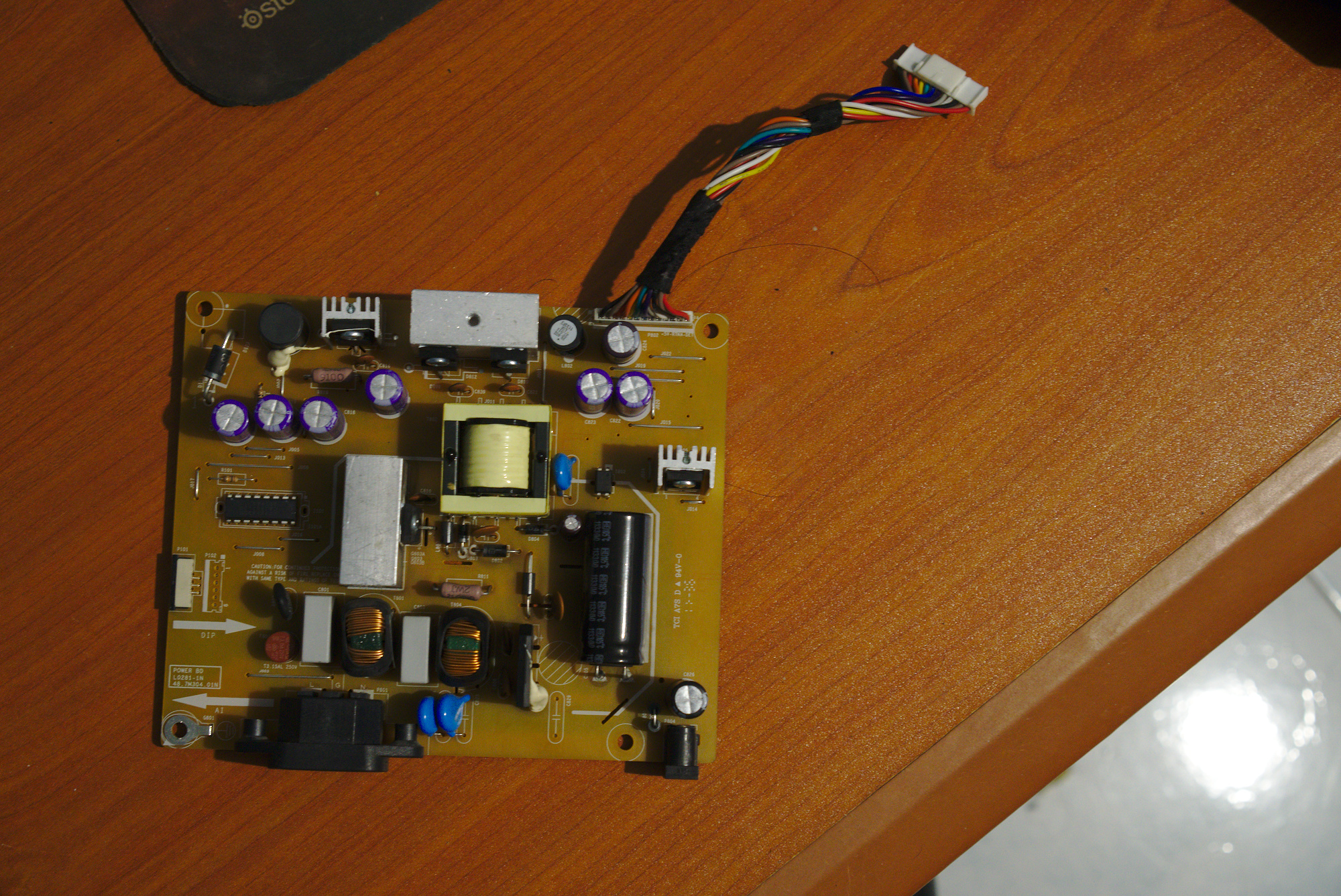

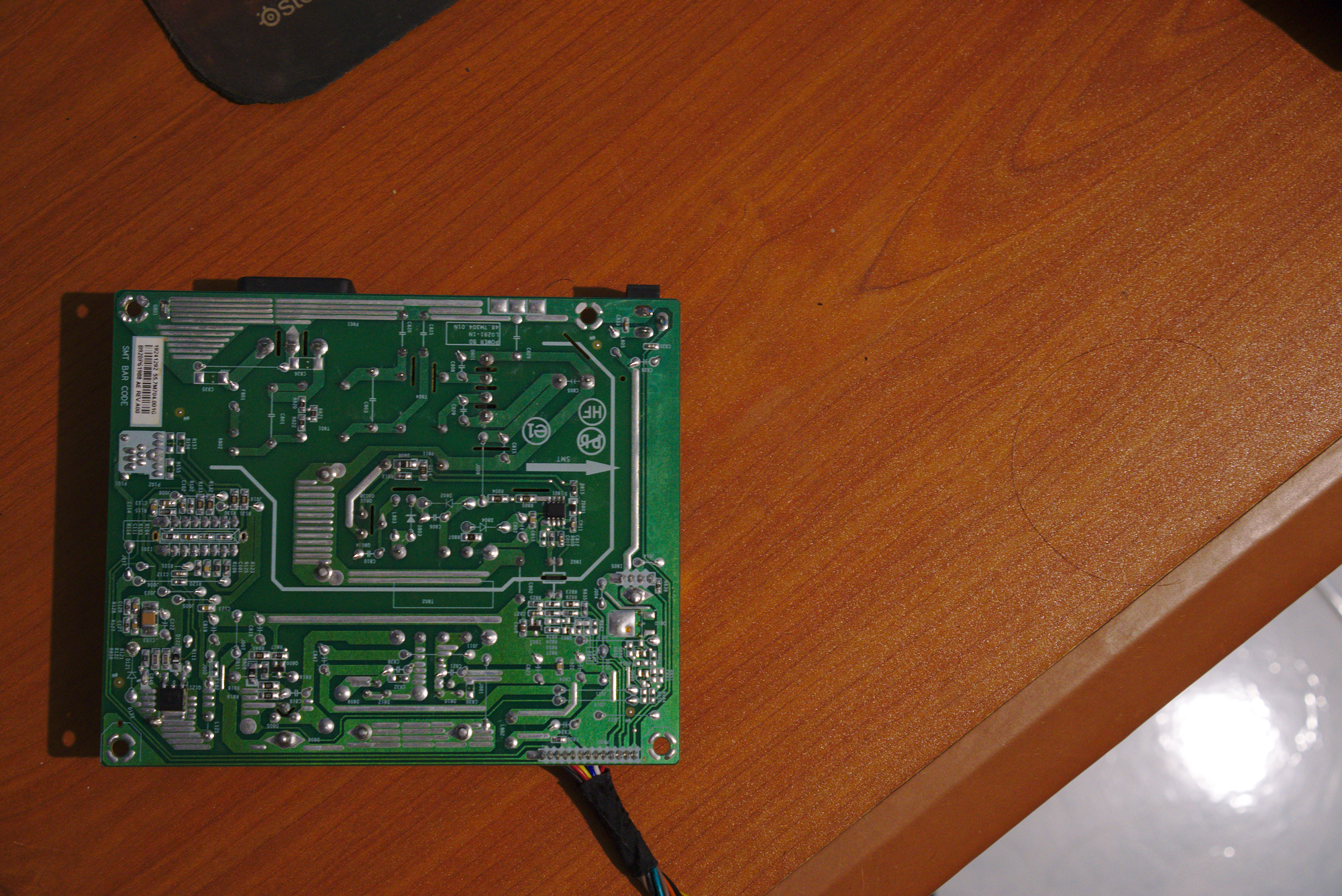

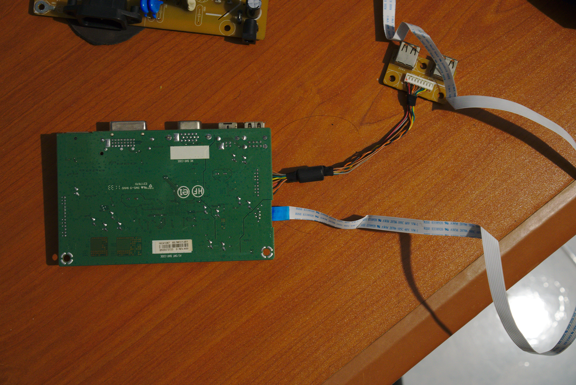

    I have a Dell U2312H that suddenly won't turn on anymore. The display and
    backlight won't turn on; the blue power LED stays off even when I press the
    power button. These have the L0281-1N power boards which are the same ones used
    for the Dell P2312H and P2012H, among others (according to Google).
    Unfortunately I can't find any schematics for this particular board.
    I have made some measurements to some of the components from the power board
    and main board. These were all tested in circuit (i.e. I didn't solder them
    out). Readings are ordered by pins (e.g. 1, 2, 3, etc.). Diodes were tested
    using the continuity tester of my multimeter; however, I don't know what the
    units for these are. I have upload the images of the boards to imgur. If you
    need a close up picture of some parts of the board, please don't hesitate to
    notify me. Thank you!
    Power Board
    I805
    AUK
    81826
    A78R12PI
    12v, 0.8mv, 0v, 0.263v

    Q803
    A
    2761I
    124 125
    Black to S + Red to G: 0.148MΩ
    Black to S + Red to D: 1.2MΩ
    Black to G + Red to D: 1.4MΩ
    R811
    1.1Ω (should be 0.36Ω 2WJ)

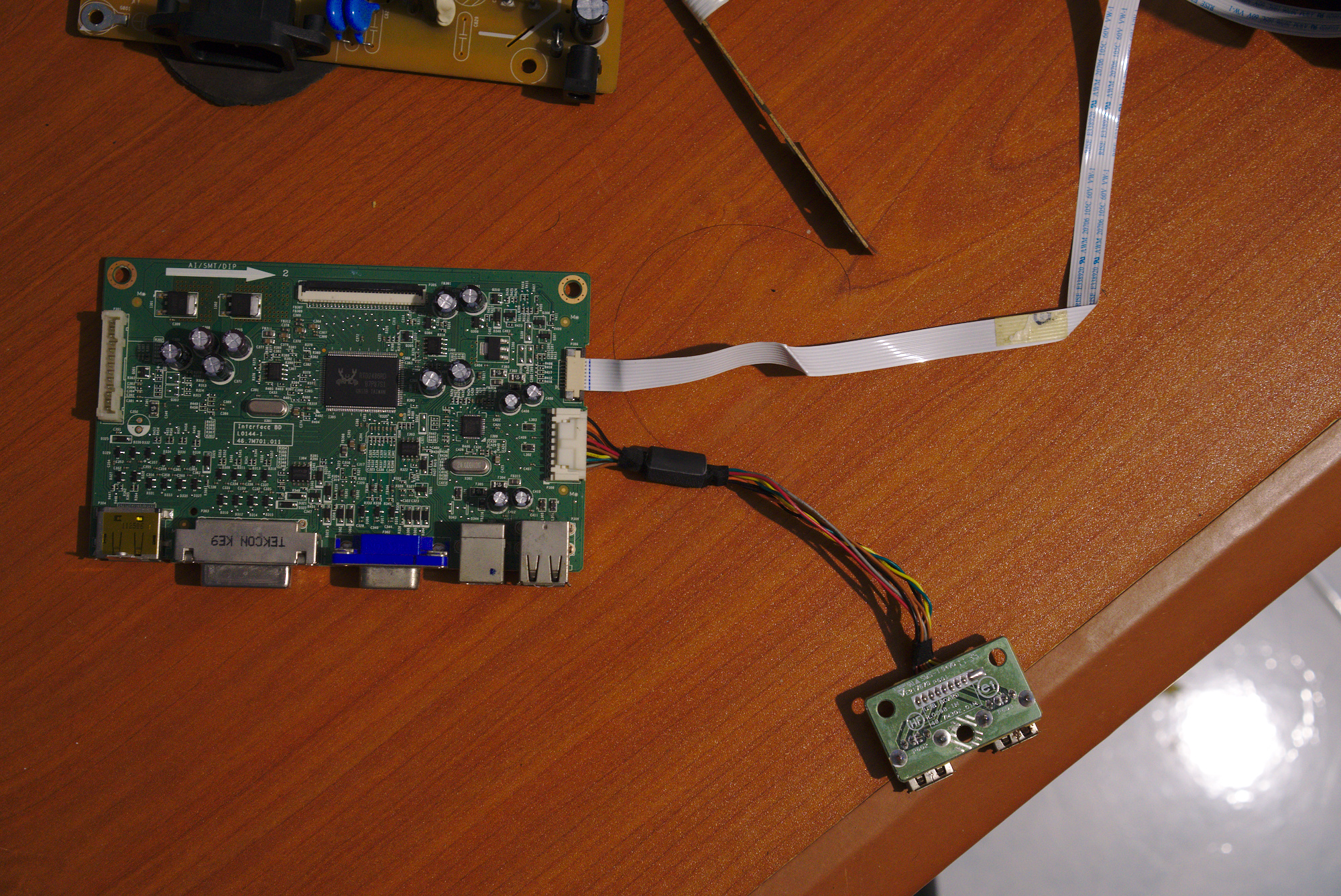

    Main Board
    I301
    N252
    G1084-33
    0v, 0.18v, 5.0v
    I302
    UTC
    LD1117AG
    12A010GTG
    0v, 0v, 0.18v
    I308
    D|| 1fB
    17-33
    0v, 0v, 0v

      "I301
      N252
      G1084-33
      0v, 0.18v, 5.0v"
      So you are getting 5V feeding this 3.3V Regulator but the out put is only 0.18V, it can be bad regulator or the output pin is over loaded.
      You should check the resistance between GND and the output pin to see if it shows very low resistance (<50 Ohms).
      • doomsweek
        • Dec 2007
        • 6
        • Philippines
        Re: Dell U2312H Repair
        budm, I have different readings based on the polarity of my probes:
        Black on GND + Red on Vout: 1.336KΩ
        Black on Vout + Red on GND: 0.353KΩ
          Those are OK, nothing <50 Ohms.
          So at this point that 3.3V regulator is probably bad.

                I302 get the 3.3V INPUT from the output of I301, so you need to replace the I301 first.
                These regulators do fail, lot of them in VIZIO TVs, monitors..
                You should also check the capacitance/ESR or replace those filter caps on the input and out side of those regulators.

                  Hello everyone. The parts I ordered finally arrived yesterday. @budm was right, I only needed to replace the 1084-33 chip to make my monitor work again.
                  Although the monitor already worked without replacing the capacitors, I changed all of the electrolytic capacitors anyway since they were from a known bad manufacturer (Su'scon).
                  Thank you everyone for the help.

                          Where is this G1084-33 located, is it the ic on the top right corner, when looking on the power supply board from the bottom?
                          If so why does mine say D482 GA2428 on it?
                          Got same screen\power supply issue, figured I'd try this cheap fix before I spend on a whole new power supply board.
                            post #1
                            Main Board
                            I301
                            N252
                            G1084-33
                            It is on the main logic board.

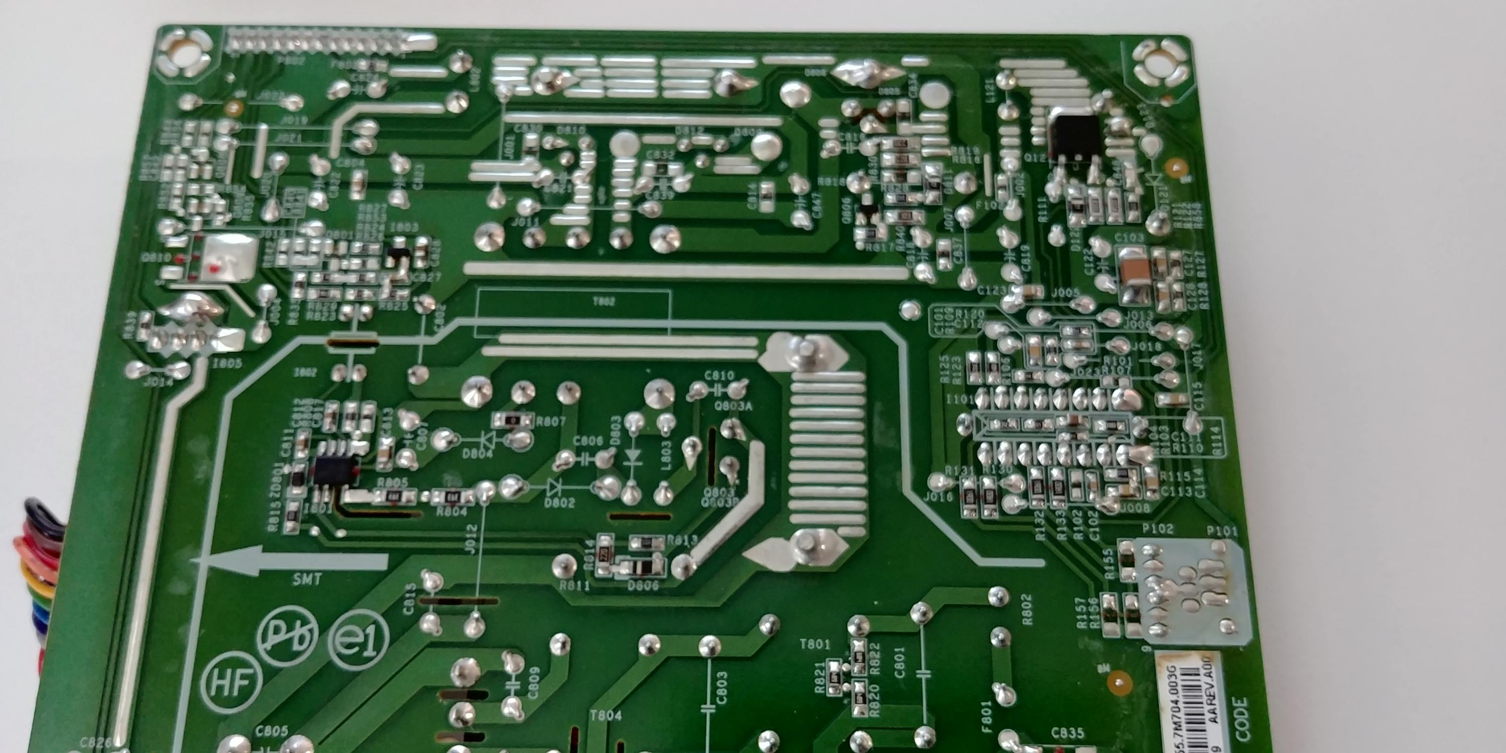

                                  Good evening, forgive me if I insert myself. There was a short on my power board and some components exploded. Could you indicate the values of r815 and zd801? thanks a lot..
