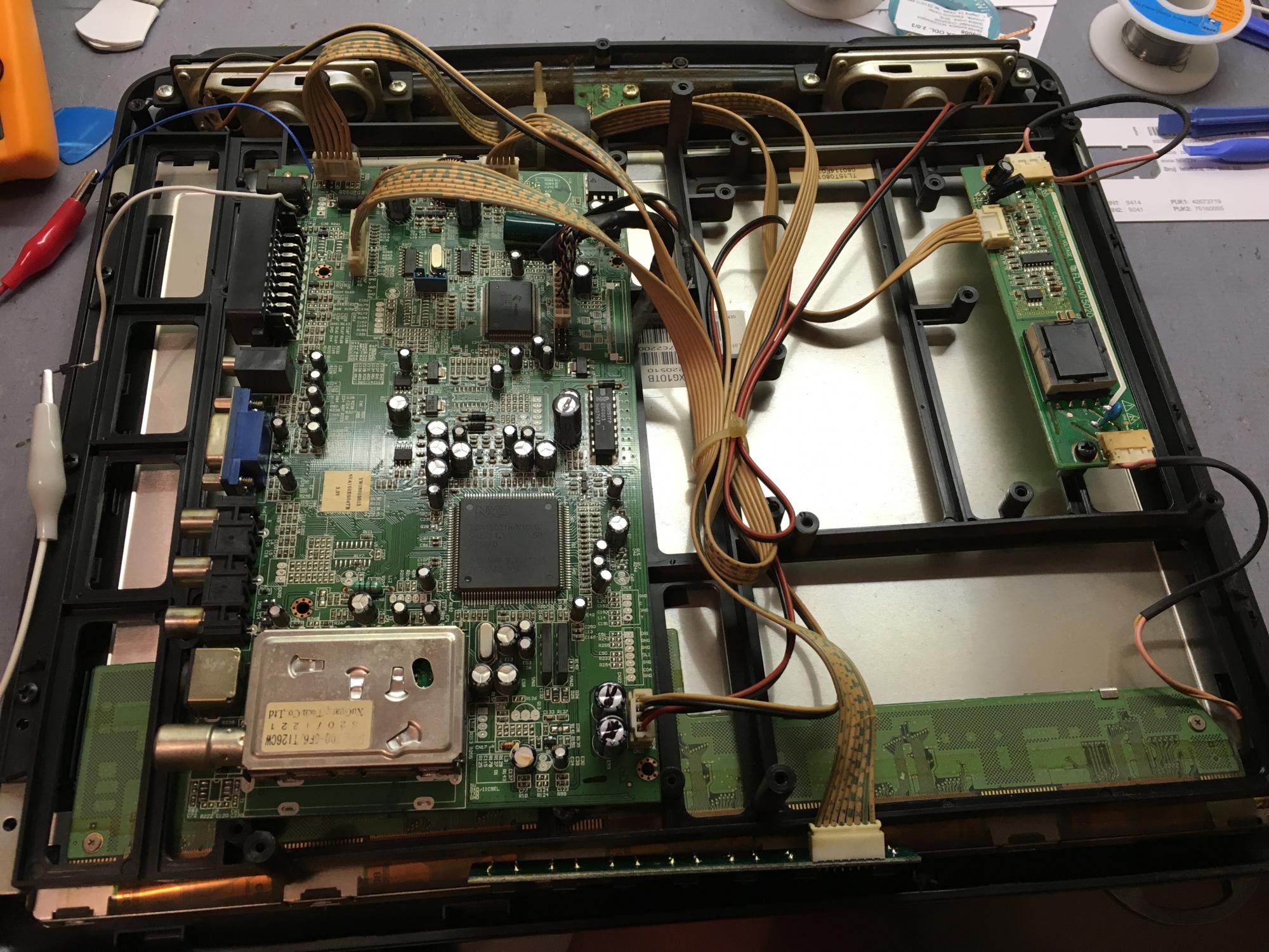

    Hello, i have one small monitor that have 2 CCFL backlight. Problem is that lamps wont turn on. Tha monitor use external psu with 12V.
    I check caps and thay are ok, the inverter board receive 12V but when starting that it drop to 10.8V
    I test lamp with external ccfl tester one by one and they turn on.
    How can i be shure that lamp are ok or defective?
    Interesting thing is when i connect 3rd lamp (external lamp) to the existing two they all turn on and stay on for 10 seconds and then turn off again.
    I think that lamps are bad but how can be sure? What is normal lamp current?

    Well, neighbour, since your lamps turn on eventually, they are obviously good.
    You have a bad inverter. Post pictures of your board(s)...
    You would typically search for shorted transistors, check transformators drivers, and transformators themselves... Of course, caps as always...

          Well i increse voltage to 14V and backlight working
          I do not understand how 12V is not enought when the monitor have a label on backside tjat say 12V input

              Hmm but my Power supply have 3A rail. When i set oitput to 12V and backlight try to turn on the monitor pull 1.4A and then drop to 0.6A
              But when set to 14V monitor pull 1.6A and stay on, does not make sense to me.

                sorry, but if a 3a suppy drops to 10.8 when you give it a 1.6A load then something is not right - either a connector or the psu is not doing it's job.
                if you set the psu to 14v is it still 14v at the invertor when running, or are you still seeing a 1.2v drop?

                  When i set psu to 14V i have 13.5V on inverter in stand by and when turn on LCD it drop to 11.5V

                                  Well i check there is no voltage drop on my lab power supply

                                    Here is the picture of main board and inverter

                                      I think you lab power supply does not capability to handle the in inrush current otherwise you will not see the Voltage drops like that.

                                        it's probably the wires, those croc clips and the wires they are clipped on are not suitable.
