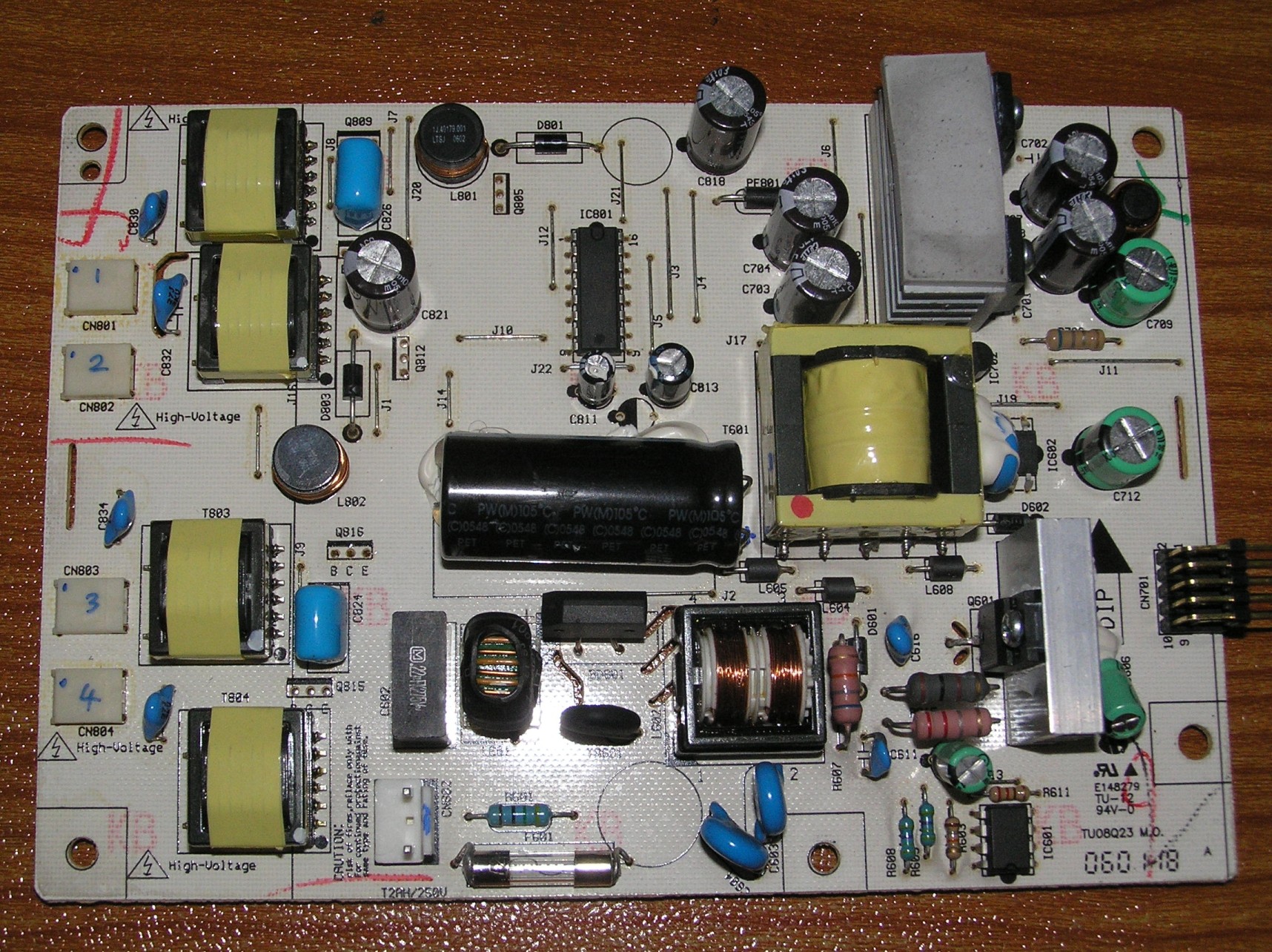

    I have a Dell E176FPb 17" lcd manufactured by BenQ. It will not power on i.e. there is no light on the power button. I have taken the panel apart and examined the power inverter board and found that it does not use the common p channel Mosfet C5707 eventhough the circuit board has blank spaces for them?. There are no bulging capacitors, found the 2A 250V pico fuse burned and one of the Bridge Rectifiers faulty. Replaced the fuse, bridge rectifier and 0.22uf 275V capacitors but still could not get it working. Anyone have any experience with this LCD panel or problem? Appreciate if anyone also has the schematics for this model of inverter board.

    On checking further I found a TL1451 IC in place of the 4 missing 2C5707 mosfet transistors in the inverter circuit...could this be the problem?

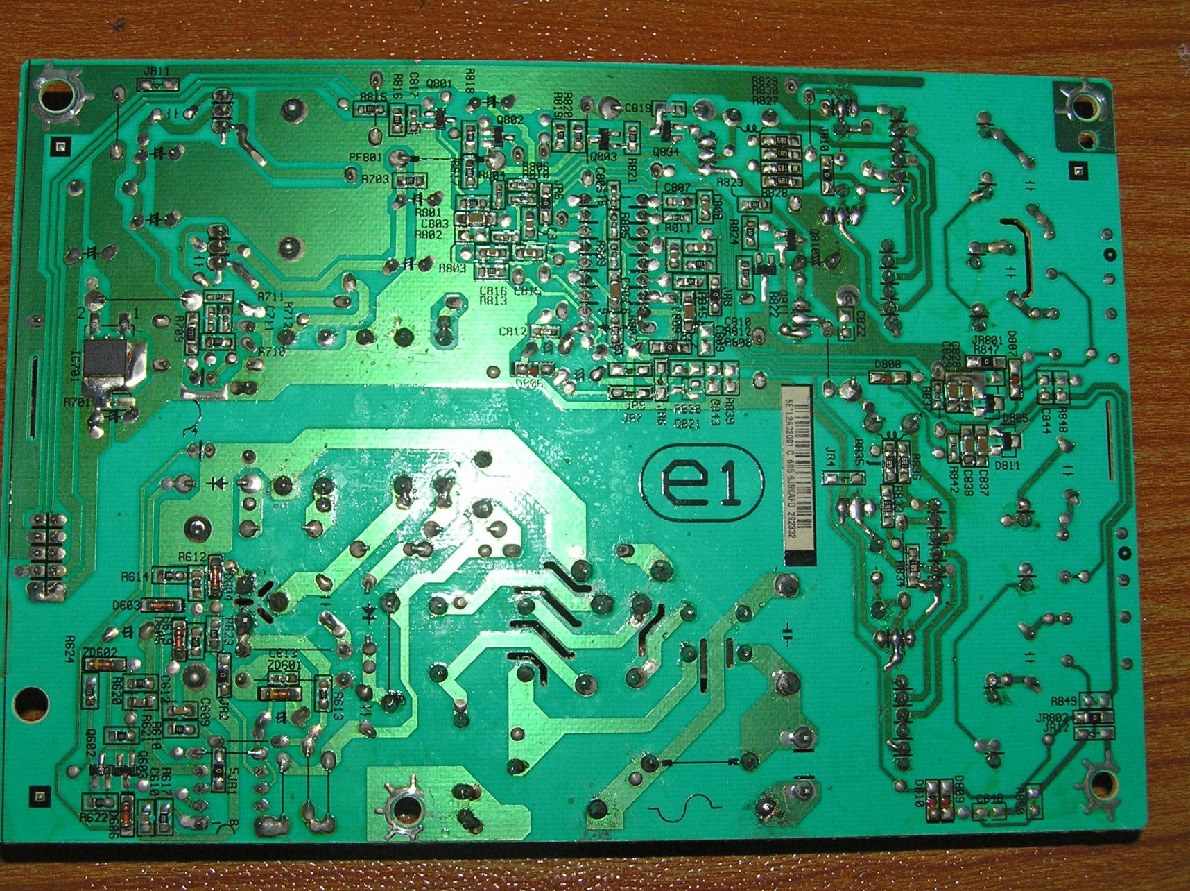

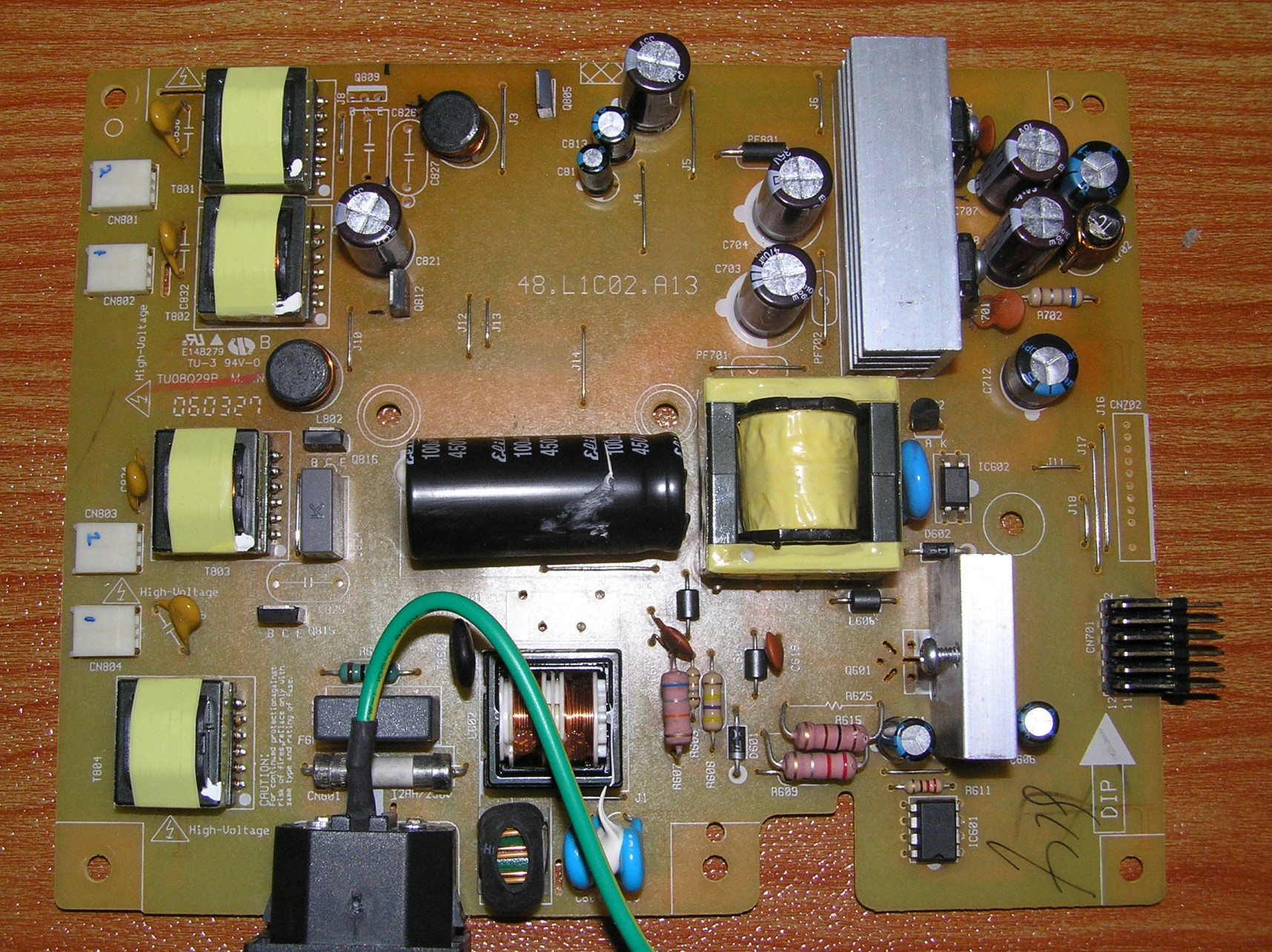

            Attached pls. find the pixs of the top and bottom part of the Dell E176FPb inverter board. I also included for comparison a pix of the Benq FP716G+ (which have similar schematics) most of the parts are still intact except for 2 pcs of C5707 and 1 0.22uf 160v capacitor which I have removed earlier.
            As mentioned, the 4 C5707 and the 2 P-Channel Mosfet IRFU9024 transistors are missing from the Dell board! Can I confirm that this board doesn't need these transistors to work...or my nagging suspicion the an unscrupulous repairer could have removed them...as I remember my friend brought the LCD to a shop for assessment and quotation on repairs before passing the LCD to me.

              Re: Dell E176FPb 17" LCD No Power!
              Whats up with Q602 on the bottom of board?
              Appears to exploded.
              Jim
                Actually...the Dell board is the white one..while the brown board is Benq...if you are talking about Q601 (I don't see any Q602), I forgot to inform that I removed it for checking purpose.
                Pls. focus attention on the first 2 pictures attached, which is from the Dell power board, while the 3rd pix from Benq (Brown color) is only for comparison purposes...
                  No I meant transistor Q602.
                  Unless I'm seeing it wrong, there is only one third of it left intact.
                  It's sitting right next to 603 at lower left corner.
                      I have identified Q602 with marking W06 and Q603 with marking W04. Further checks indicated that SMD transistor W06 is PMBS3906, a PNP 40V 100ma general purpose PNP transistor manufactured by Phillips. The same is for W04, which is actually PMBS3904.
                      My problem is where to buy such SMD transistors as its not available here. Just wondering whether I can substitute W06 with 2SA812 and W04 with BC307 transistors. Any suggestions out there?...
